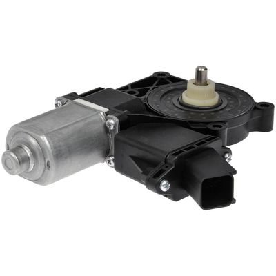

If you remove the bolts you can access the positive and negative post directly to the motor; this is how I tested the original one the other two are brand new with no change in the results.

I have no doubt that the processor can be overloaded but I bypassed it. Regardless the two new motor are doing the same as the original one and it was the only one I checked.
Tuesday, March 31st, 2020 AT 3:44 PM
  • 52,797 POSTS
How did you bypass it?
Tuesday, March 31st, 2020 AT 3:49 PM
ADAMW
  • 15 POSTS
Remove the processor from the motor it is bolted on I tried to send you a picture I assume it didn't come through the motor itself is 12 volts. Beyond that these two new motor do not work still. I'm going to try the relearn process with one of them and see if that helps.
