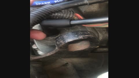

When I put a vacuum gauge to the PCV orifice on the front of the engine, I thought it would be sucking air into the engine, but it is pulling it in the other direction (see video attached) - I'm not sure if that is normal or not, maybe the video will provide some clues or I can make another and test something if you need me to.
Aug 7, 2021 at 3:06 AM
Okay. This is correct. What you are seeing is intake manifold vacuum. Basically the intake manifold us under negative pressure from the engine and pistons pulling in air during the intake stroke. This is what is supposed to happen and when you rev the engine it drops to 0 PSI and in hg showing that there is no vacuum. Then when you hold it at 2000 RPM, the vacuum recovers and is stays steady.
This needs to be under vacuum for the PCV as this will pull in crankcase gases and reuse them in the intake. You may have a clogged PCV so remove it and shake it and see if the valve is free inside.

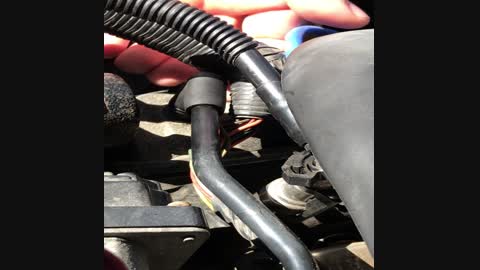

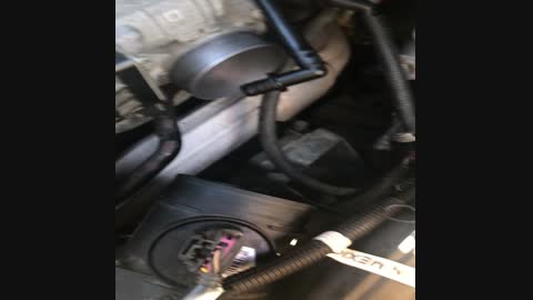

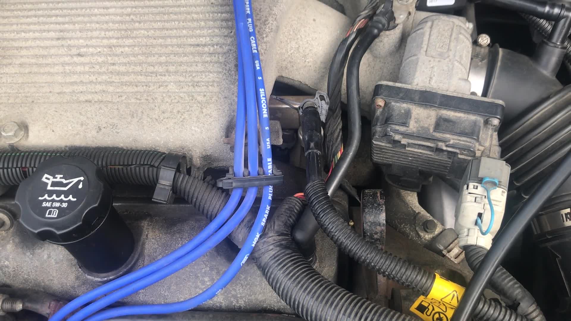

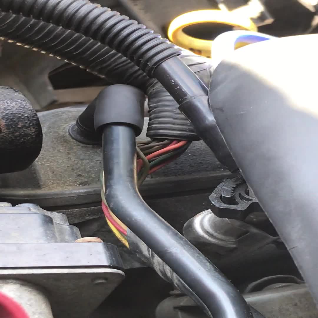

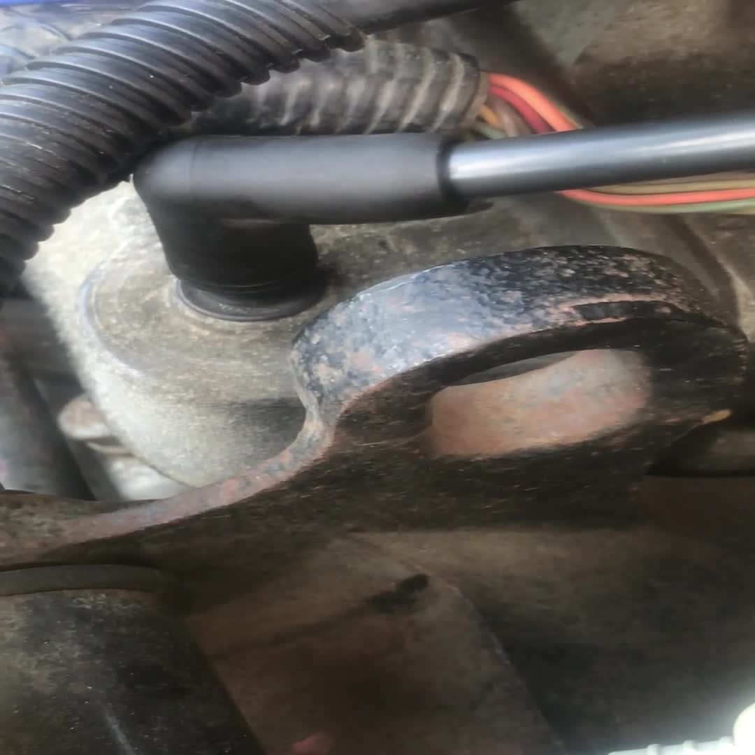

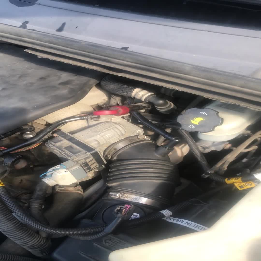

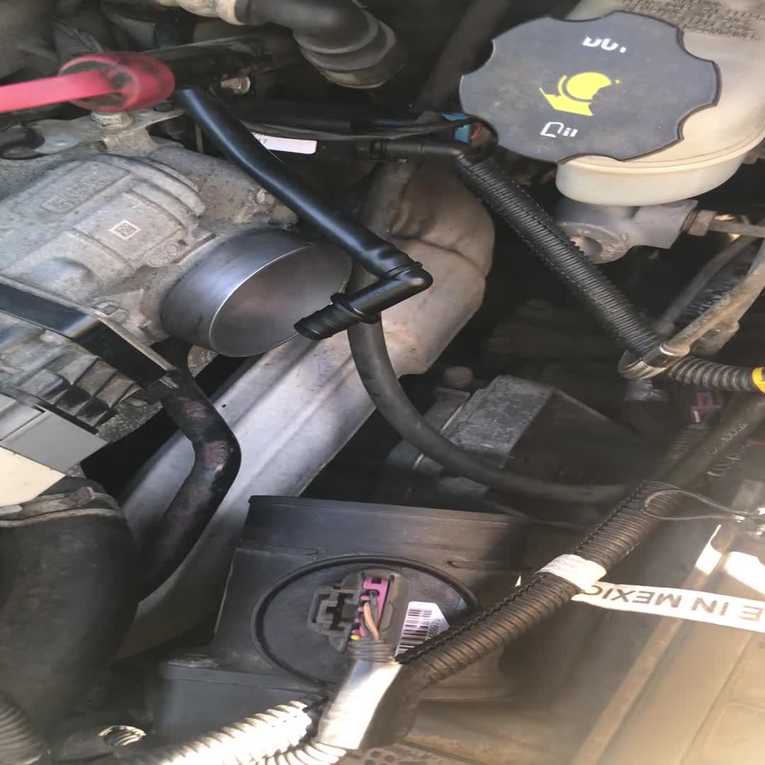

It appears the PCV orifice on the front of the engine connected to the fresh air PCV tube is clean and non-restricted, although I'll inspect further today to double check as I'm not 100% convinced yet (I need to push a slightly smaller item through it tonight to verify).
I'm now wondering about the foul air PCV tube that goes to the back of the engine. In the attached videos I show how it just barely has airflow coming out of the engine through it, although I'm not sure if this is the normal/expected behavior or not?

Okay. That is all great info. To start, that does appear to be normal as the other tube you connected to is just a breather and it will pull air from the exhaust (I believe) as it needs it. It is in front of the throttle body so it is going to have more pressure as the engine revs. It also has a one way check valve so that the air does not go from the intake to the exhaust, only pulls from the exhaust to the intake to reuse any unburned fuel.
Also, the way you hooked to that line, it would have positive pressure (PSI) as the air will be pushed to the intake from the exhaust.
The PCV line is under negative pressure (vacuum) as the intake is pulling fumes from the engine and the engine has positive pressure and pushes towards the intake.
All this to say, that all looks fine. The only thing I am concerned with now is the P0171 is a vacuum leak code. However, you may have tripped that when unhooking those lines. So let's clear the codes, drive the vehicle and see if they come back.
If that code returns then we have air getting into the intake from some other source causing the engine to run lean. Or we have a fuel issue that is not supplying enough fuel causing the engine to run lean.
So let's see if that comes back and we can go from there.

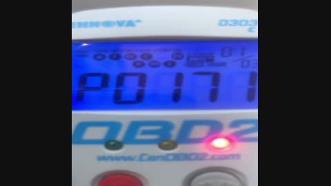

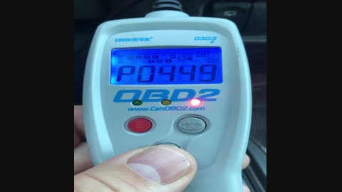

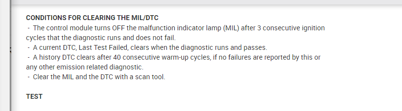

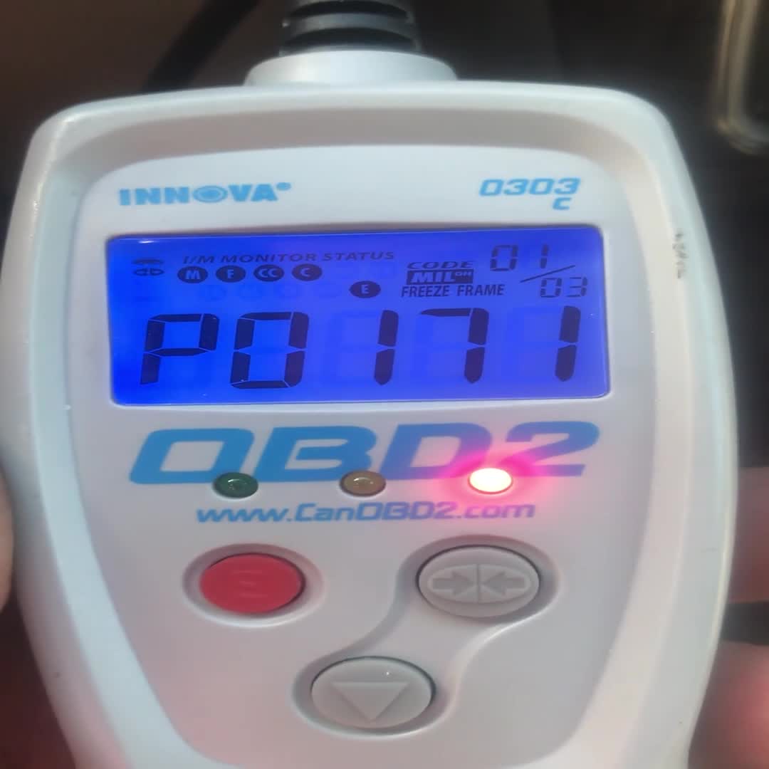

I cleared the codes and took it for a drive. The P0171 didn't return so we must have tripped it when I unplugged the hoses.

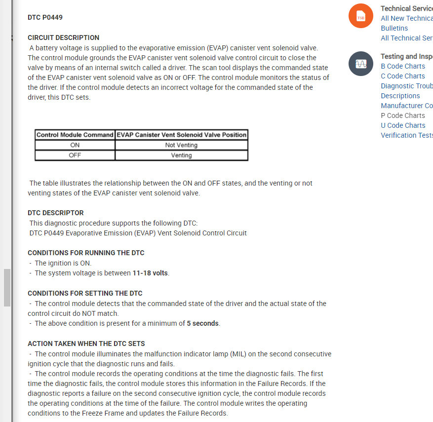

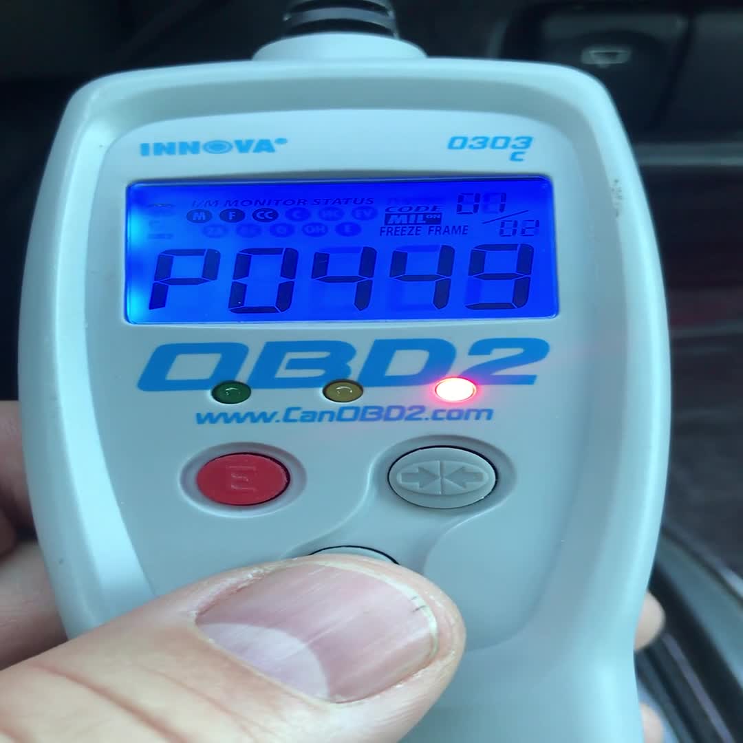

The P0449 did return, although that code has been around for years, so I'm guessing that is not part of the issue?

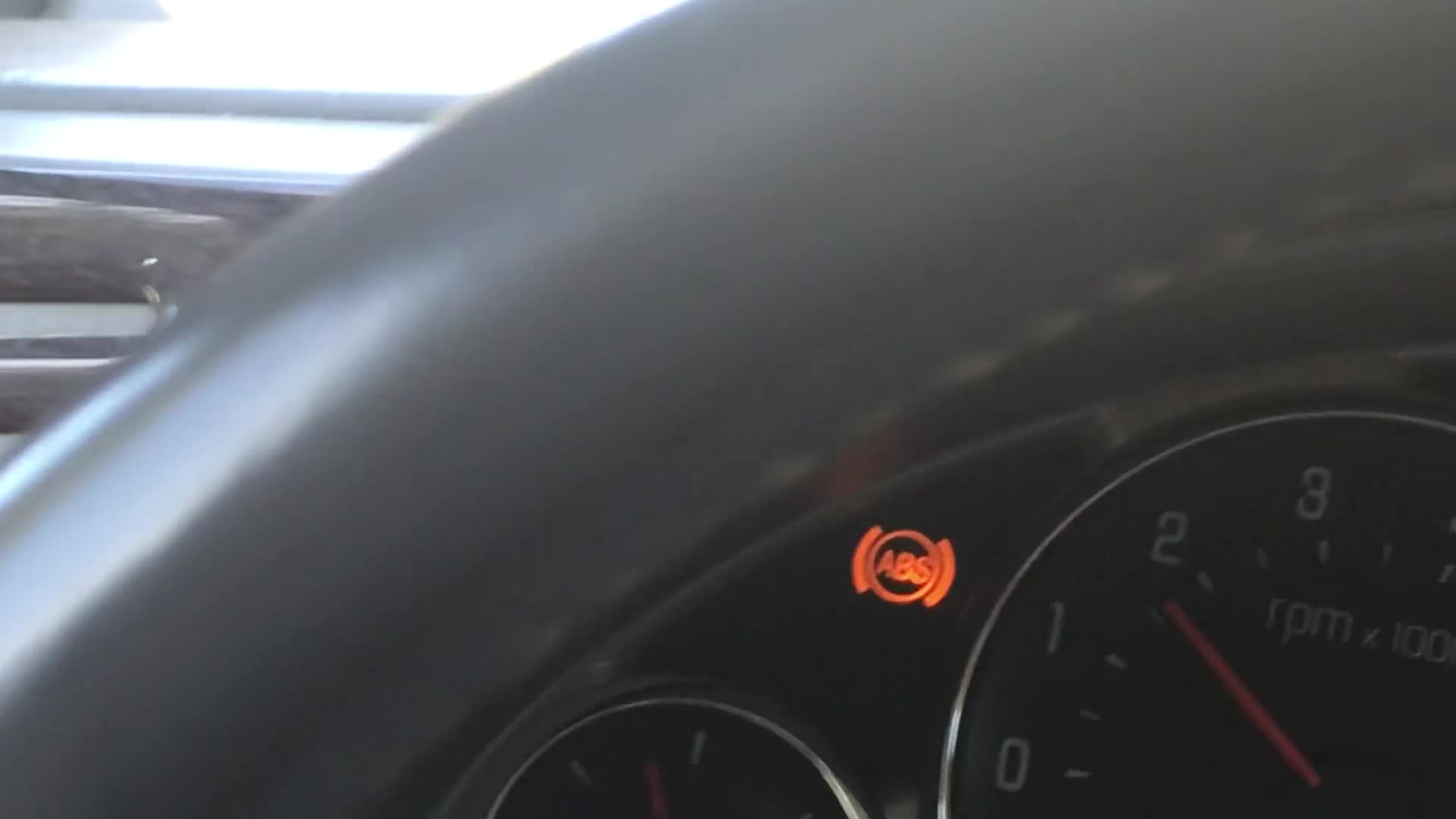

Side note: We redid all calipers/pads/rotors a year ago, although the ABS keep coming off and on intermittently which triggers the ABS light on the dash. I think it's unrelated to this problem but thought I'd mention it in case you need to know.

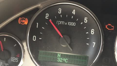

I attached some more videos of the drive I took it on. If you listen closely, you can hear it 'gasp' for air, then the power surges, then it takes another little gasp and gives me a boost of power again.

Great info. I should have asked for that earlier. So that EVAP code may be related and just got to the point where it is causing a surge. However, it is less likely so let's come back to that.
I agree that I hear that gasp as well. That is normally a result of a leak and that gasp is the actual air being sucked in.
However, it could also be the air gasping through the air filter like it is supposed to. But that is a sign that the air fuel mixture is off.

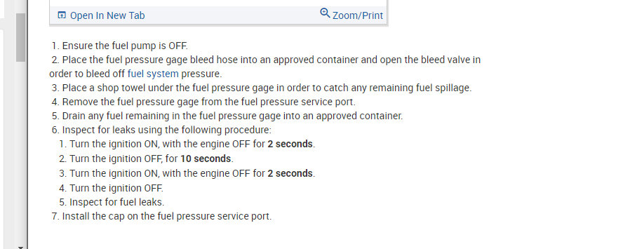

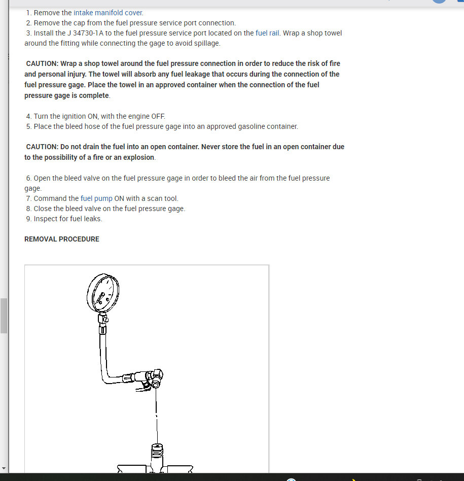

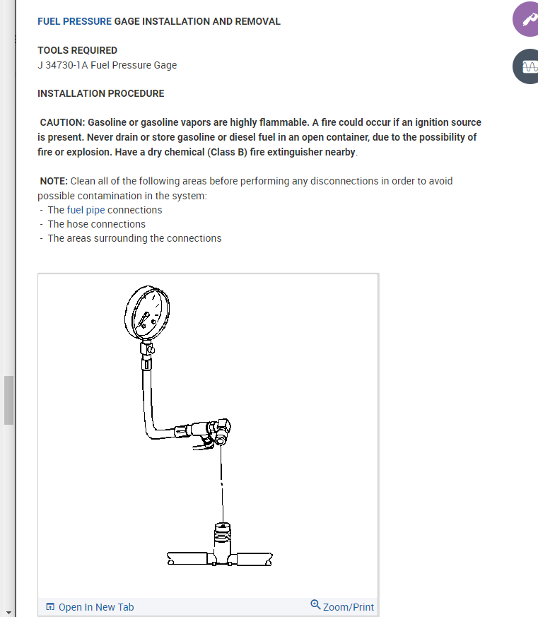

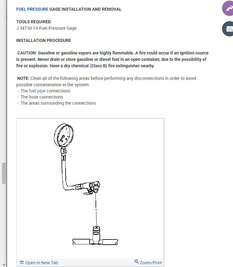

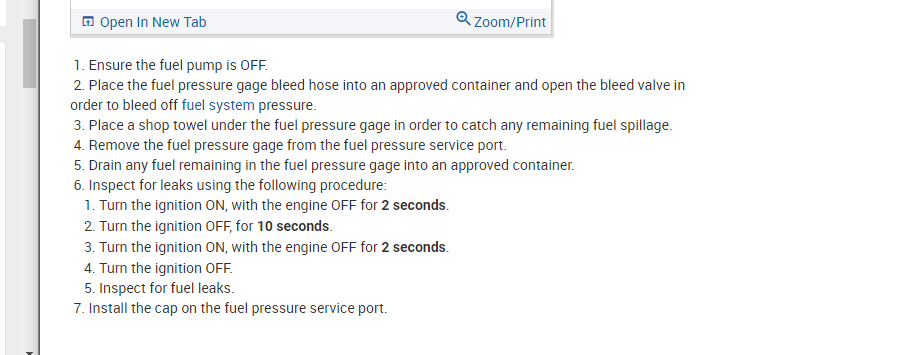

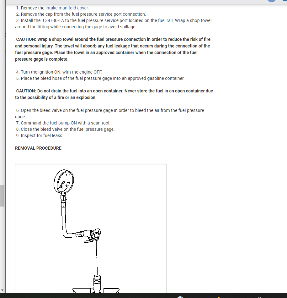

So at this point we have to do two things. First is hook up your vacuum gauge to a vacuum line (that PCV line is fine and cap off the PCV orifice) and then tape the gauge to the windshield so that you can drive it and watch that gauge. Then we need to see what the vacuum is doing as this may be an intake valve issue that is floating.

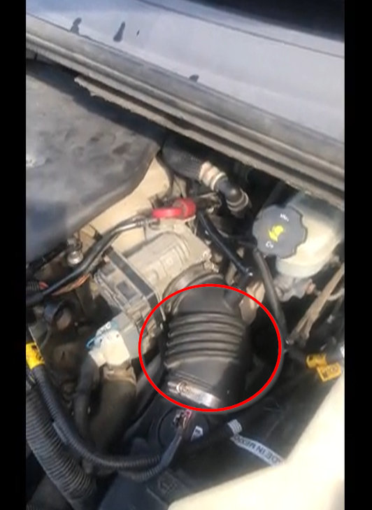

Also have you inspected the accordion tube that goes to the intake for leaks? They crack and don't show up unless under a load which makes sense why it surges going up a hill. Unplug that sensor that is just in front of that tube which should be the MAF sensor and then drive it. You are going to set a code but when that is open circuit the ECM uses a default and the surging would stop if the leak was between the sensor and the throttle plate.
Next is to watch the fuel pressure the same way. Hook the gauge up and tape it to the windshield so we can watch the gauge while it is surging.
See below for the info on this. Sorry for the long note but we will get this. You are doing great work!

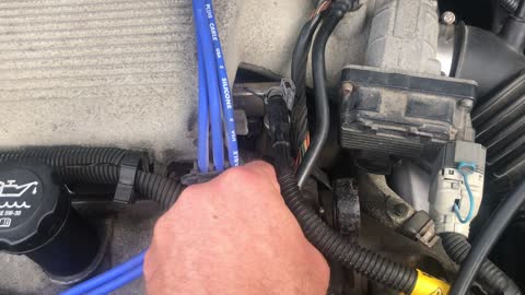

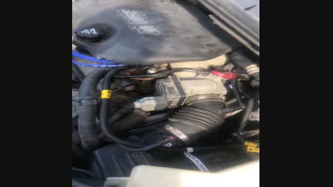

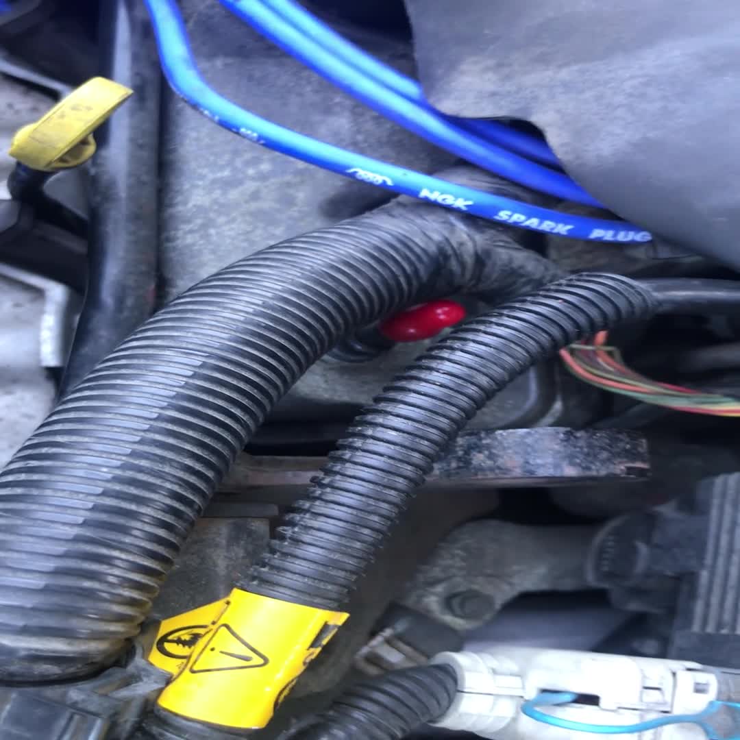

okay. Here is what I tested so far:
1. Valve float test: I capped the PCV orifice and hooked up vacuum gauge to the fresh air PCV tube. Result: It seemed to make no change, needle appeared fairly steady on vacuum gauge.
2. Unplugged the MAF electrical connection. Result: It would stall if I didn't add a bit of pressure on the gas pedal. It didn't have a ton of power, although it didn't seem to surge at all. I could still hear a 'whistle' sound a bit, I'm assuming it was air being sucked in somewhere possibly but no gasping noise and no surging. I attached 2 videos because the fact it didn't surge surprised me so I tried it twice so you can take a look.
3. I inspected the accordion tube and it appears that it doesn't have any cracks/holes.
4. I didn't do a fuel gauge test because I will have to pick up a fuel gauge, and will do that if you think we should go down that road next. I was wondering though if I need to buy one would it make more sense to buy a new obdII reader that reads live data and monitors fuel pressure etc. and accomplish the same thing?
See videos attached.

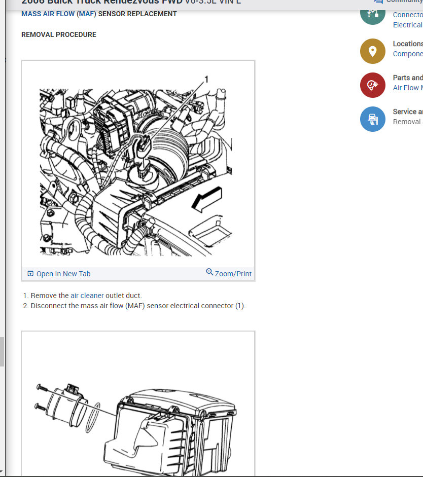

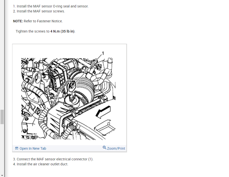

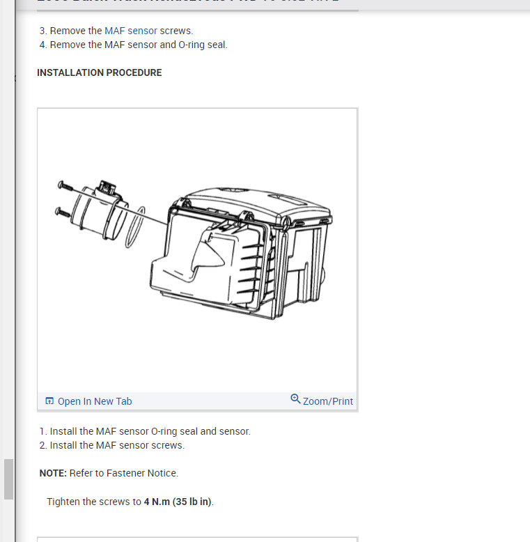

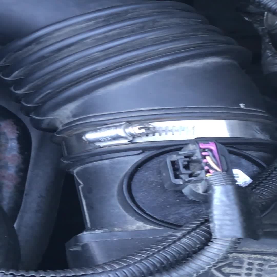

Excellent job. If unplugging the MAF made any difference then we need to focus on that.
Here is a guide that will help with trying to clean it if you want:
https://www.2carpros.com/articles/mass-air-flow-service
Otherwise we need to replace it.
https://www.2carpros.com/articles/how-to-replace-a-mass-air-flow-sensor-maf

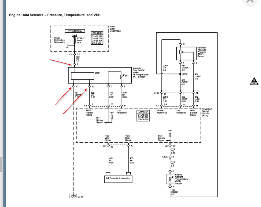

We can check this by checking the voltage at the sensor to see what it is telling the PCM for the incoming air if you don't want to just replace it without proof. Basically we need to check for 12 volts on pin B and C. This is testing the power and ground. If your meter does not show 12 volts then we have an issue with one or the other and we can dig into that to figure out which one.
Lastly A is the signal from the MAF to the PCM so we need to see what this is telling the PCM. Does your meter have a Hz setting? If so, that would be the way to test this.
If we back probe these circuits then we don't need a scan tool to monitor what the PCM is seeing.
Let's try this and let us know what you find and we can go from there.

I just had it replaced at the dealership a week before I started this thread so I'm hoping it's good/new, but will do the testing anyways just to ensure. Thanks!
Aug 13, 2021 at 5:01 AM
Oh wow. Okay, but unfortunately that is all too common. New parts are not good parts. So let us know what you find with that and then we can take the next steps but there is something there.

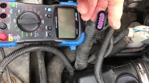

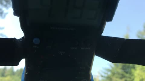

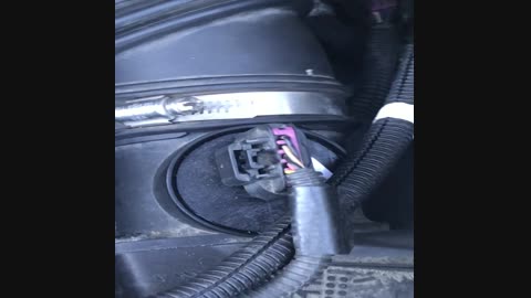

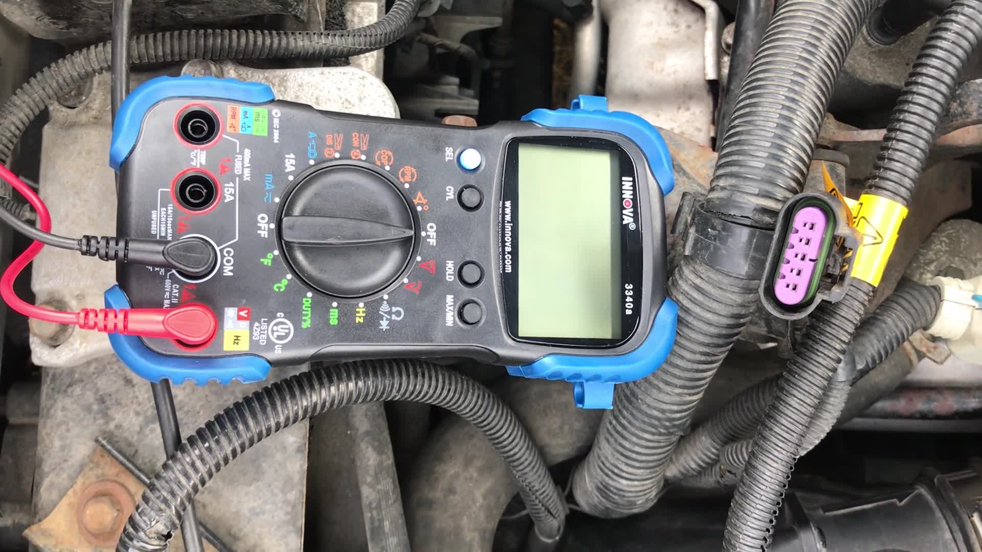

Please see attached video for my multimeter readings.
I don't have much experience in using the meter so if you see any settings setup wrong or if I am in the wrong pin holes please let me know.

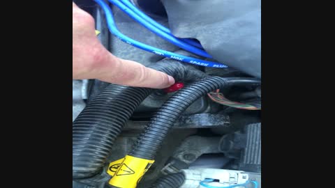

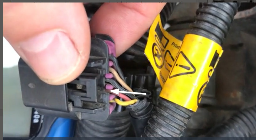

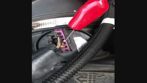

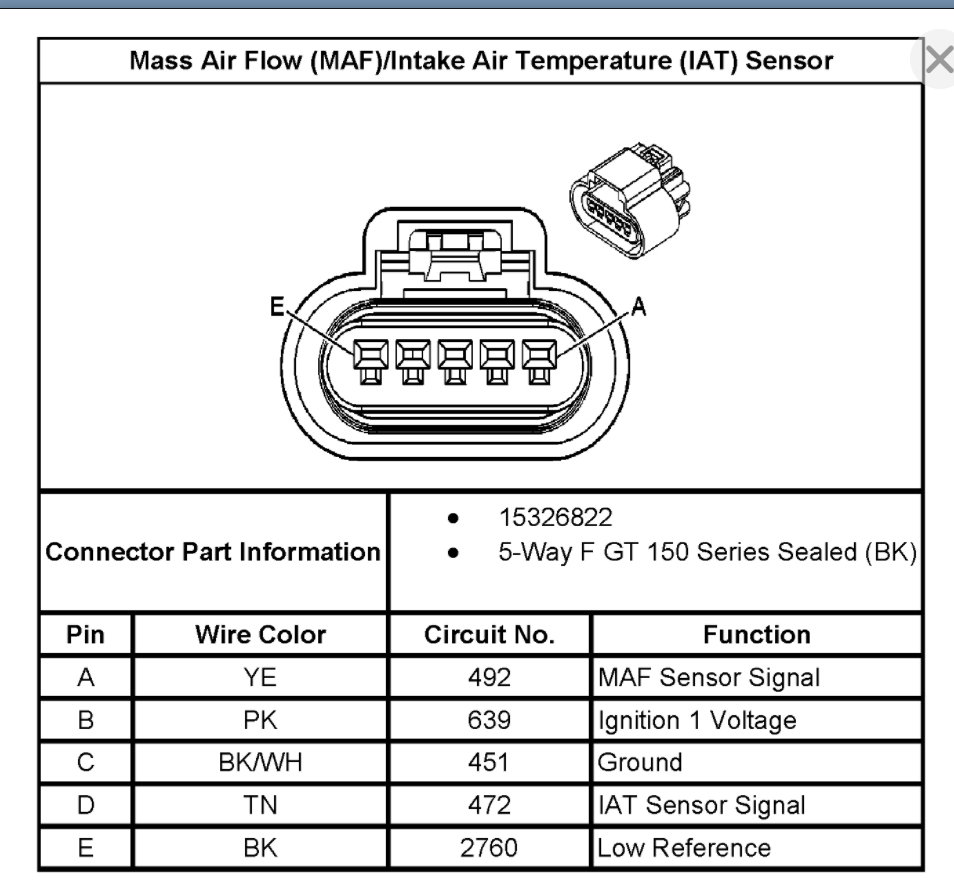

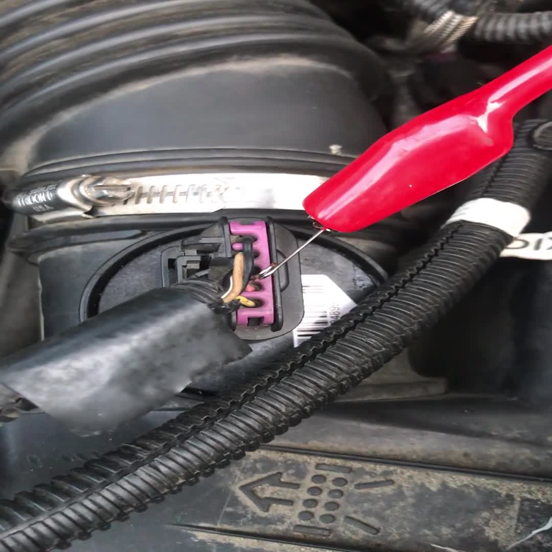

I see two holes on the purple connector for each spot A,B,C,D,E and and wasn't sure which hole to put it in (the small one or the big one). I'm assuming either is fine as long as it touches the connector, but let me know if it isn't and I can redo this test based on your advice. :)
Aug 14, 2021 at 5:14 AM
Okay. That is all great. However, we need to back probe terminal B and plug the sensor in so that we can see what the sensor is telling the PCM.
If the sensor is new, we can assume it is not the issue which would point us to the PCM as the issue but normally when you unplug the sensor and it stops acting up, the sensor is the issue.
I normally just use a T pin or small safety pin to push it in the back of the connector. You will feel it bottom out on the metal connector and then you can just use an alligator clip to connect your meter to it.
If you don't have that then you can tape it to the back probe so that the metal probe of the meter lead is touching the safety pin or t pin.
Then we can drive it and make sure the readings are smooth and steady.
You are doing an excellent job with this. Very impressed.
Aug 14, 2021 at 11:41 AM
RYELANDO
  • 19 POSTS
Thank you. I'm learning lots, you are incredibly helpful!

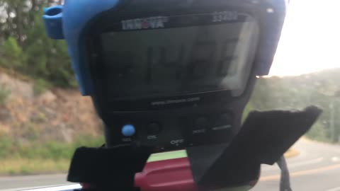

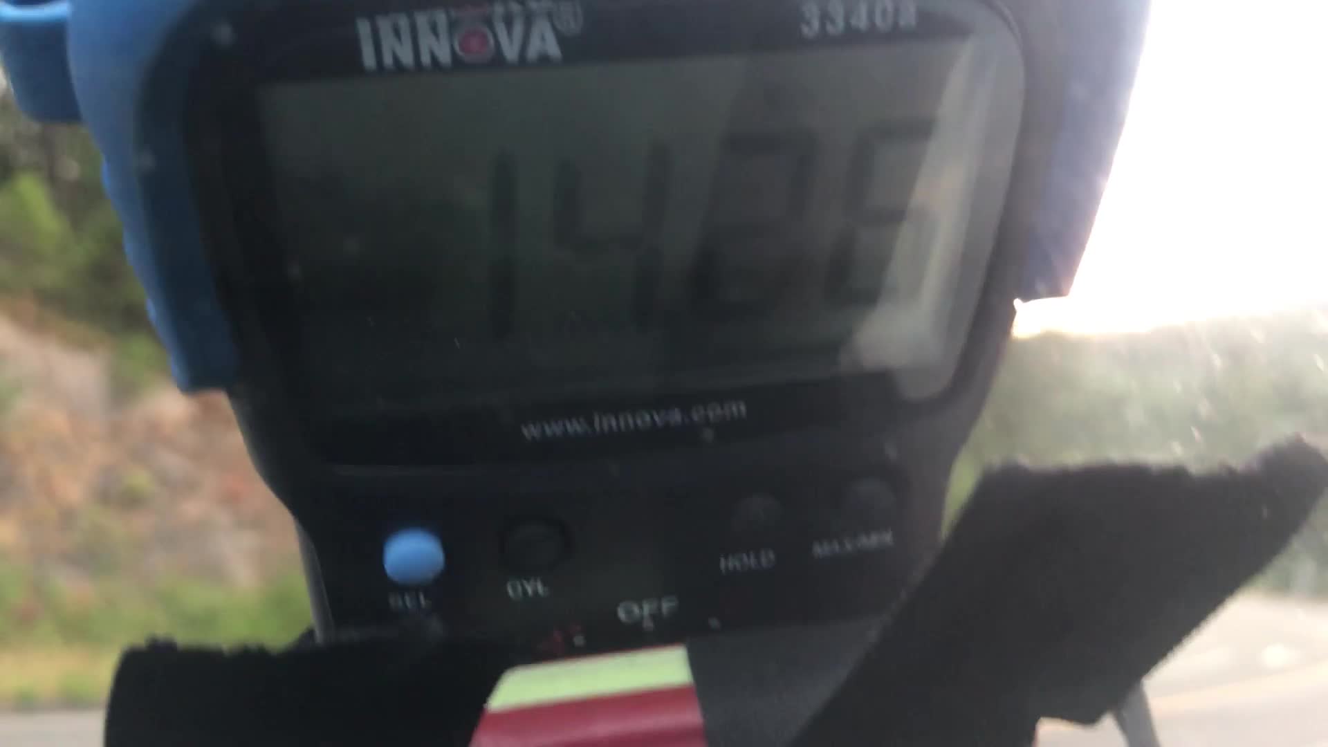

I back probed terminal B with a safety pin and alligator clips.
I turned the key only to the accessory and it showed about 11.85V before starting the engine .
When driving, it seemed to steadily show about 14.35V to 14.37V.
I also added a little 'side-note' video about where the gasping noises appear to be coming from. I think the window seal is opening as we've had record heat here lately and maybe its just hot. Lets stay on track though, I feel like we're making progress, but wanted to add it while it's fresh in my mind.

Awesome. I should have explained my thought pattern better so that you could have gone further in one test, because that is what I expected.
I have seen in the past when the PCM drops ignition voltage on the sensor and that causes all sorts of odd issues. That did not happen so that is perfect.
Now we need to do the same test on the signal wire which I think was A. This would be on the hertz reading but if you can do both hertz and voltage that would be great.
The meter doesn't respond fast enough to be the best tool for checking the signal voltage but it is good to see if anything jumps out while doing it.
Thanks again.

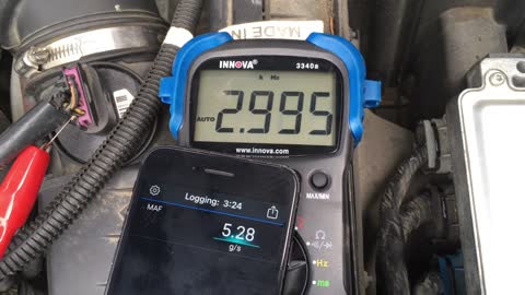

Aug 15, 2021 at 1:54 AM
RYELANDO
  • 19 POSTS

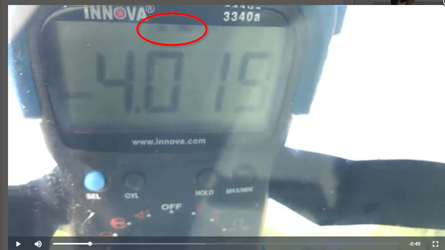

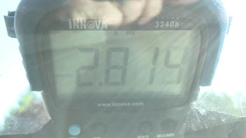

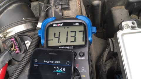

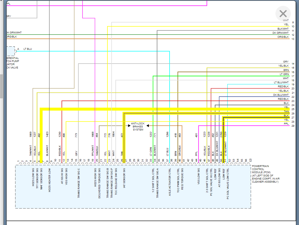

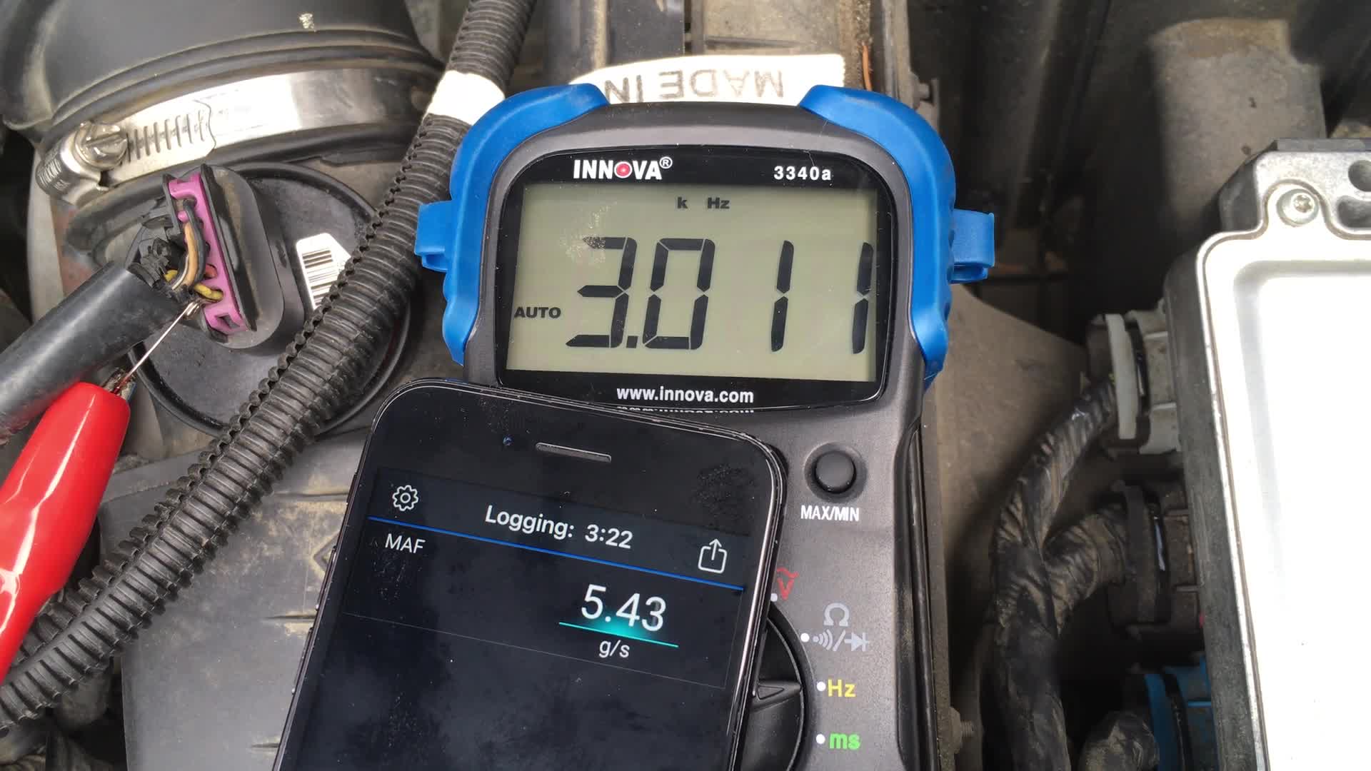

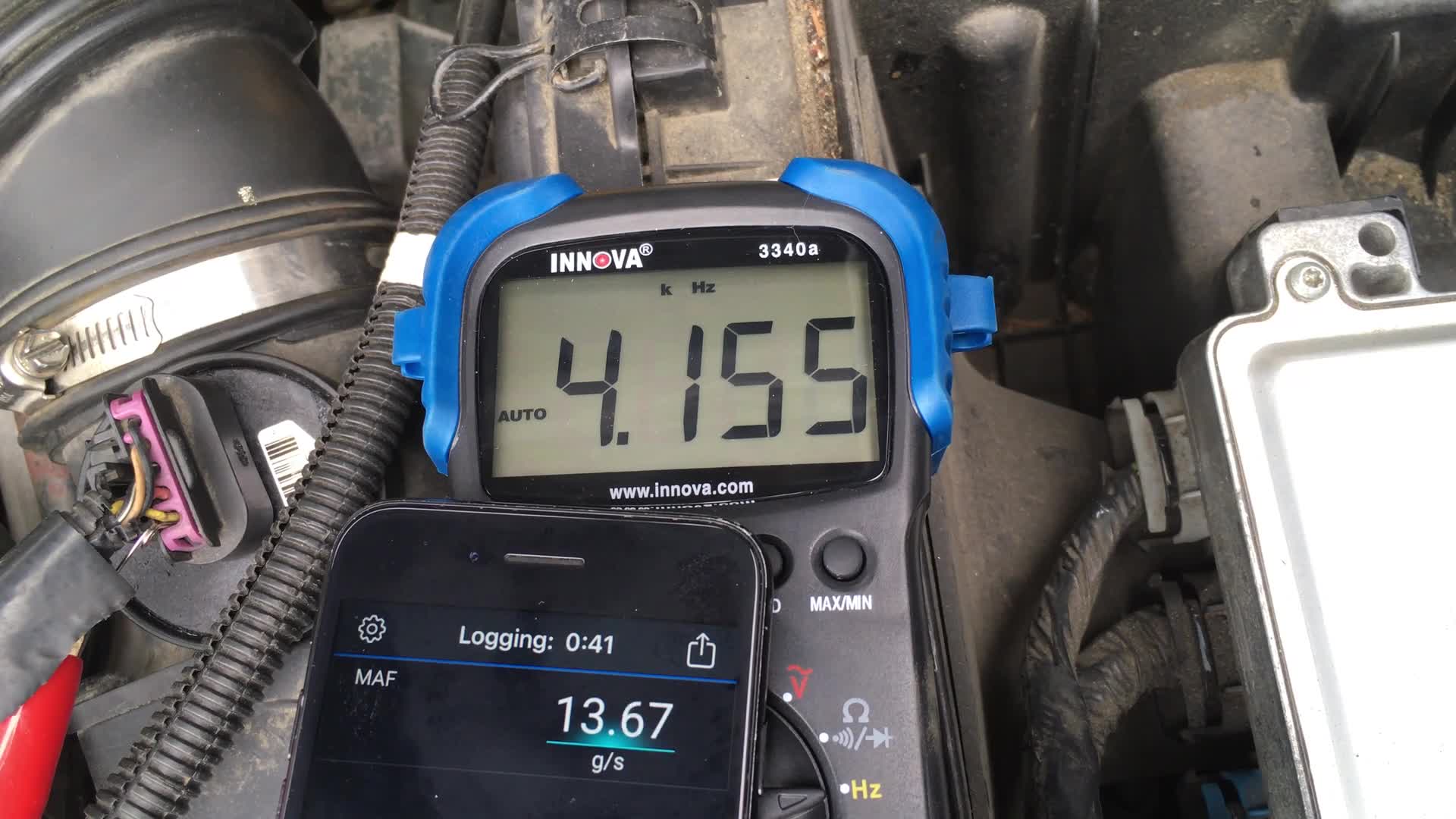

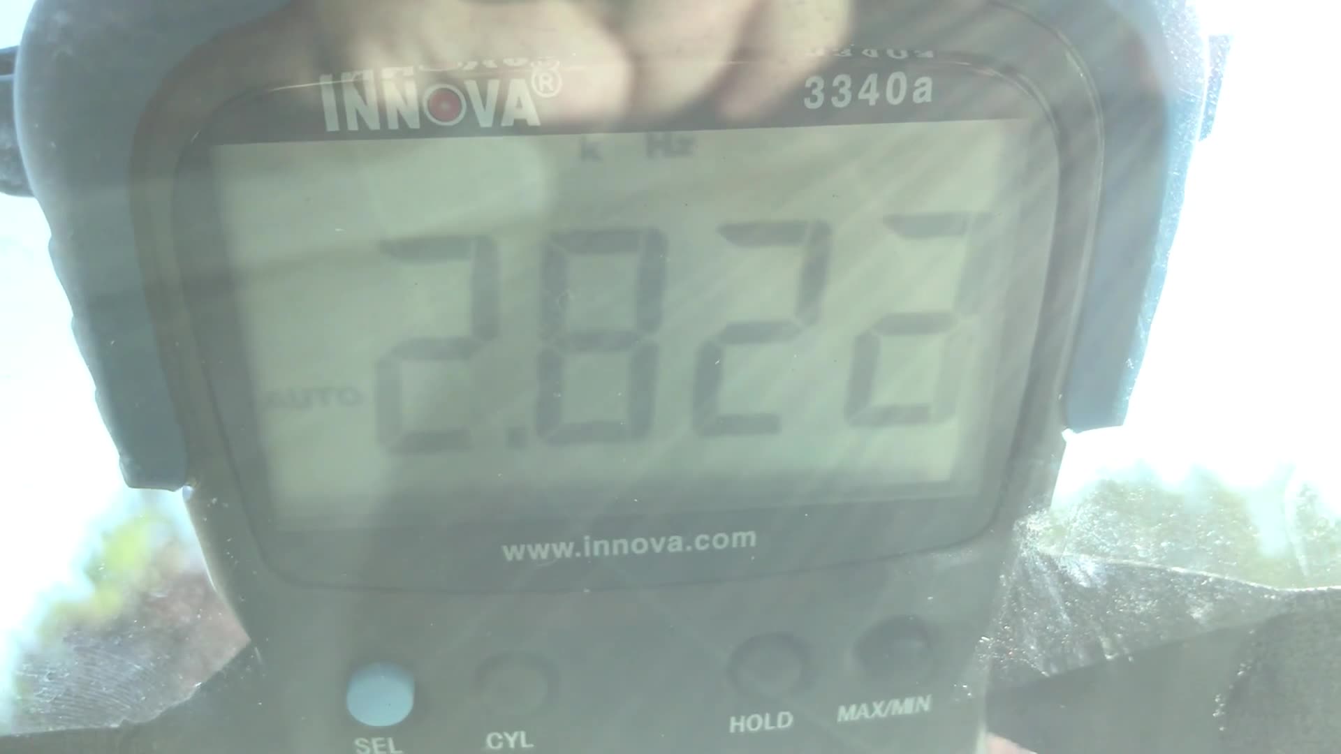

okay great. So I think I back probed the pin in their correctly, if these numbers in the video seem way off just let me know and I can retry it.
It seemed to idle at around 2.8Hz and on the drive went between 4Hz - 7Hz when putting some gas to it up the hill. The more gas pedal I applied the higher the Hz went.
* I think I have longer alligator clips so will try to bring the meter in the vehicle on the dash next time so the sun doesn't make it hard to read.
Aug 15, 2021 at 4:39 AM
Okay. You don't have to get another video if you can just confirm that the number was not jumping around when your foot was steady on the throttle.
So when you accelerate the number should go up smoothly and then when you decelerate the number should come down.
From what I could see that is what was happening. If that is the case then that sensor appears to be fine which is not what I expected.
Just to recap before I recommend what's next. This bogs or looses power when you accelerate up a hill and when you unplug the MAF, it is better?
If that is the case the sensor appears to be fine which means we need to assume the PCM is not getting the proper info due to a wiring issue or the PCM itself if faulty and not able to accept that info. So when you unplug it, and the PCM resorts to its default value then the engine runs better.

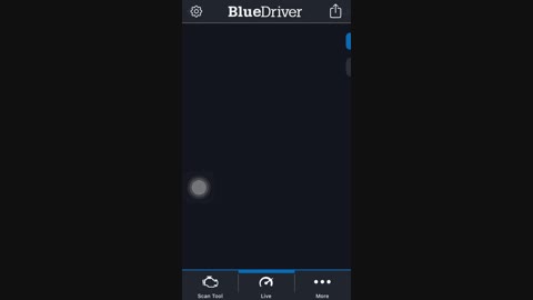

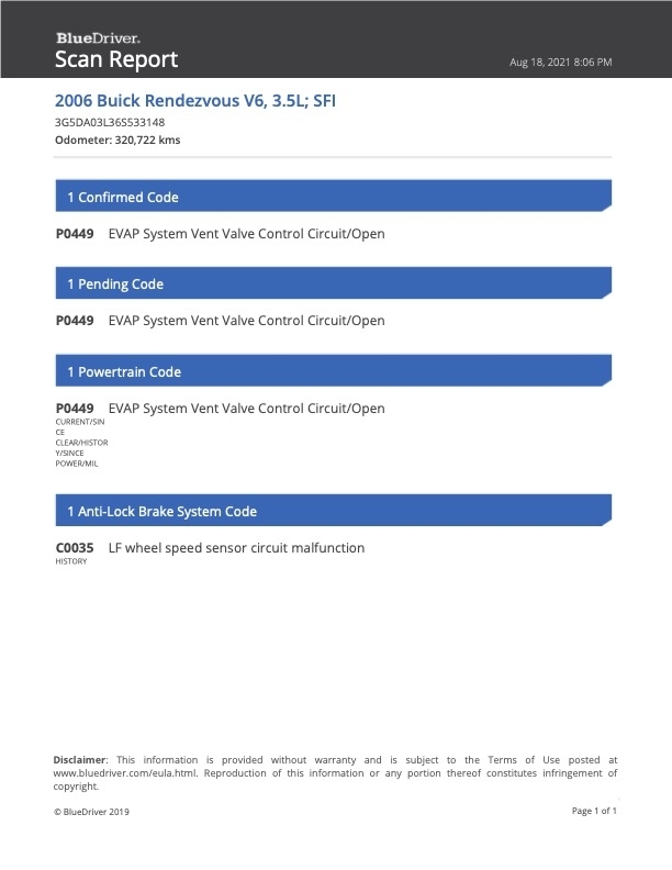

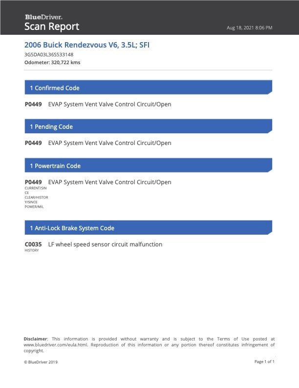

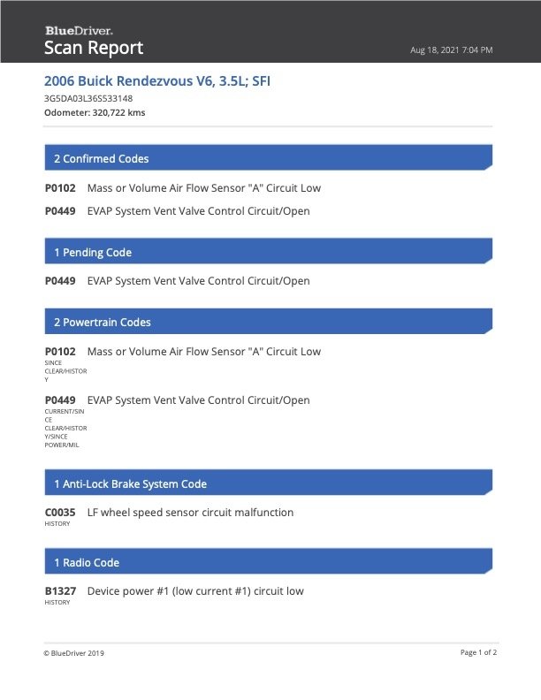

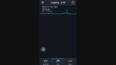

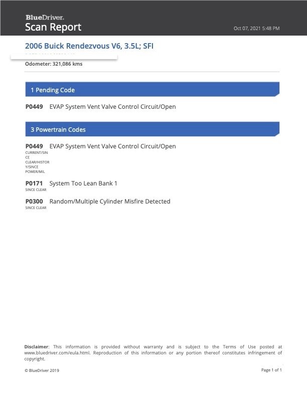

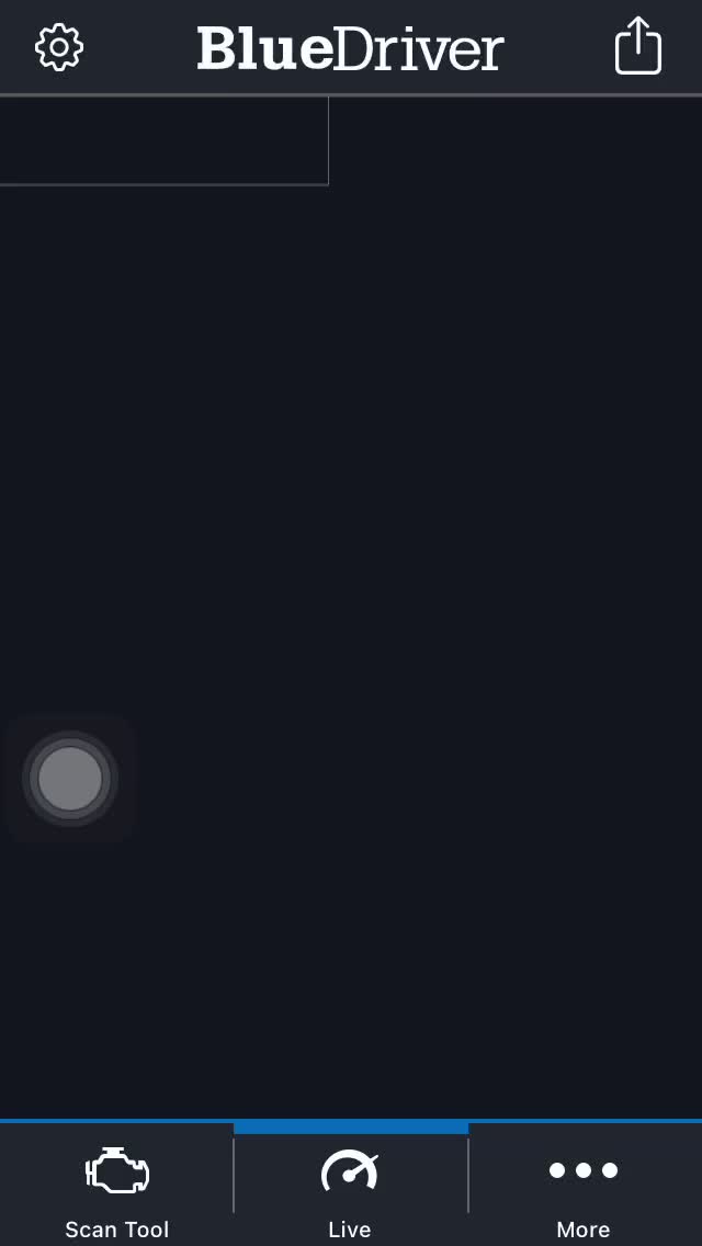

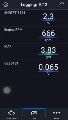

Okay, I'm not sure if I'm doing this right as I'm still learning how to use the new obd2 so please bear with me here...

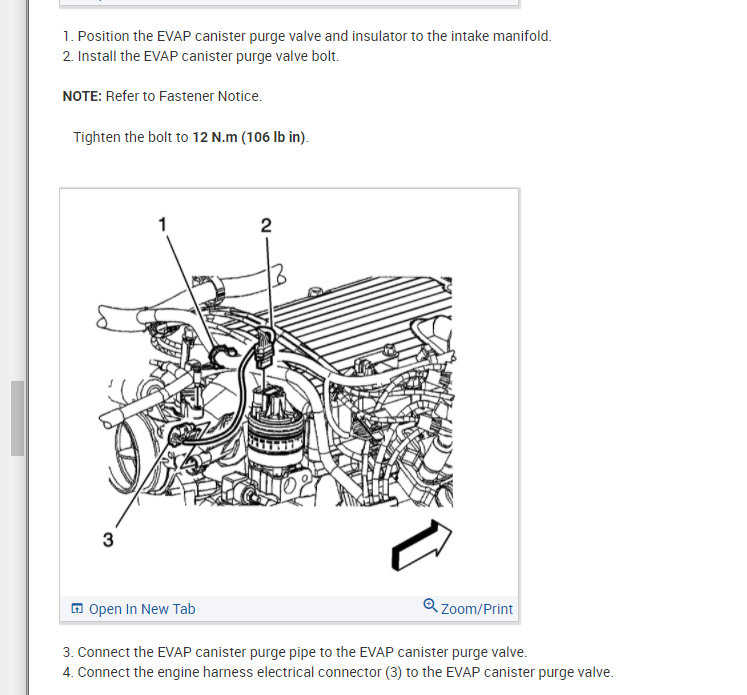

I did a full code scan. I found out my ABS is a circuit/wire behind my front left wheel. Totally cool, I can now fix that as I always wondered what it was.

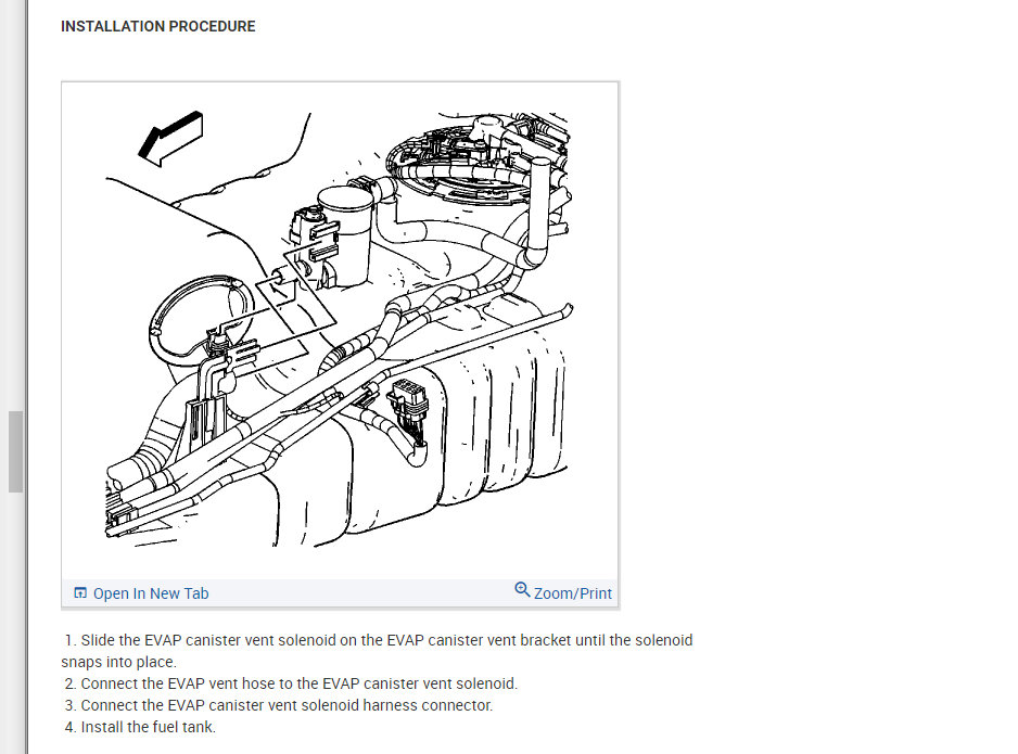

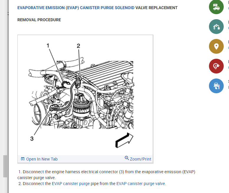

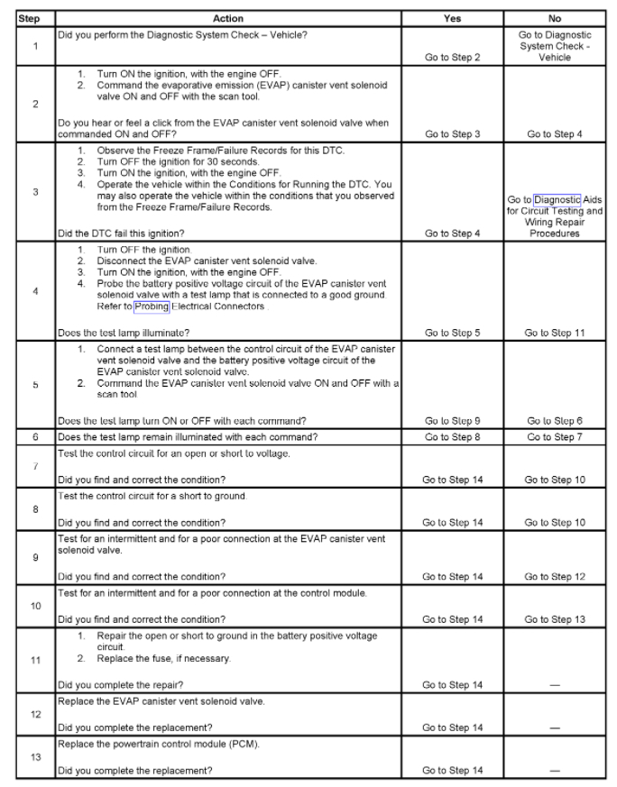

Also, my P0449 says its the EVAP Canister Vent Solenoid circuit, so I might just tackle that as well this month and replace the evap canister vent valve solenoid thing. I may have to drop the tank to do it, but it could go okay if the straps come off easily.
It showed a P0102 (MAF) but I'm guessing that was triggered sometime during all my testing when I unplugging the MAF etc.. so I cleared all the codes and took it for a good hard drive for a while and then rescanned. The results were the same except the p0102 code never reappeared despite it surging badly, so I'm pretty sure that code was from the testing we did earlier.
Lastly, I tried live data. It had tons of options to choose from (see attached video) so I picked what i thought you were looking for (the Mass Air Flow) and screen recorded it as I drove. The grams/second seem to climb steadily as I drove faster, then when it gasped for air it quickly dropped, and when it surged with power again it climbed. You can see the 20 grams spike approx. 20g/s during the test when it was gasping/surging. When it wasn't gasping/surging it was very steady.

Wow. That is great info. I am hoping this is starting to become clearer for me now because I am back onto thinking we have a MAF sensor issue but probably not the sensor itself. I suspect the module is the issue. Here is how we need to confirm this.
I just can't explain why we are not setting a code when this is happening but that could also be due to the module.

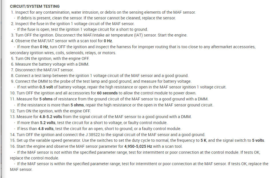

So in the picture below when you were taking the Hz reading, it had a K next to the Hz at the top of the screen correct? I circled what I am talking about.
If that is the case then that is the scaling of the meter which means that was around 4,000 Hz. I say that just to set the stage for the attachment below.

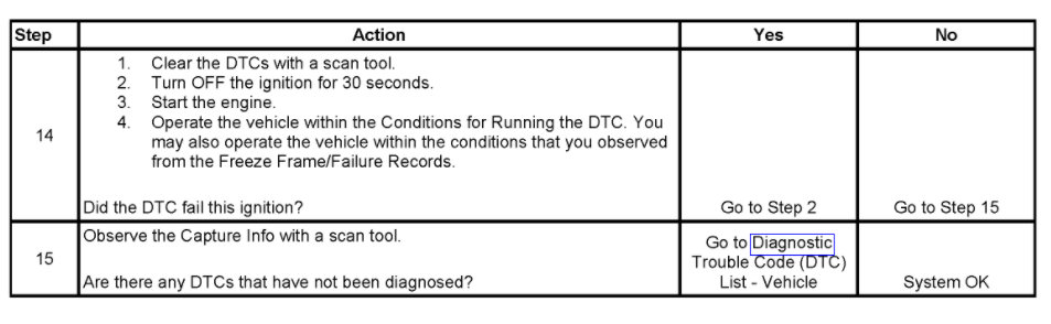

Then take a look at the testing in the next picture. These are the expected operating parameters of the module and sensor.
Granted this is the test for a code that we don't have. However, it looks like were are outside these parameters and that would tell you to replace the module.
Hopefully we can confirm this is a module issue with this testing and we can go from there. Thanks

And yes, to confirm the picture you sent, it did say Khz at the top of the screen so it would be 4000Hz.

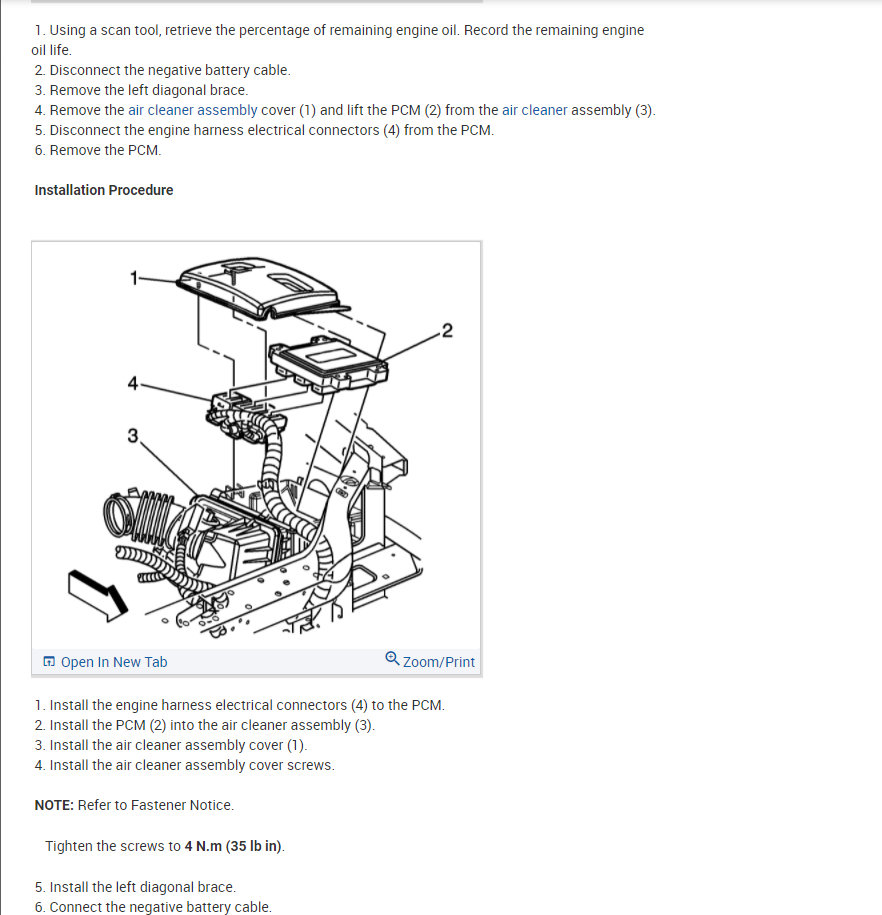

One question before I start my research... when you say 'module', what exactly is that and where is it located? I'm sure I can figure it out when I start researching but thought I'd just ask to expedite the process. :)

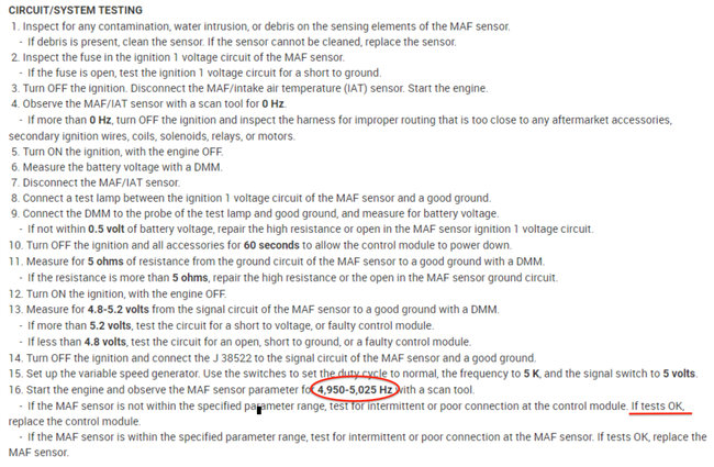

Aug 19, 2021 at 3:30 PM

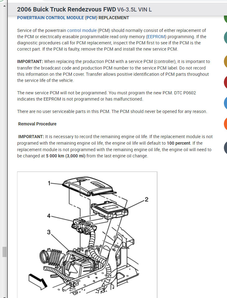

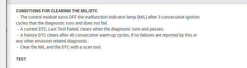

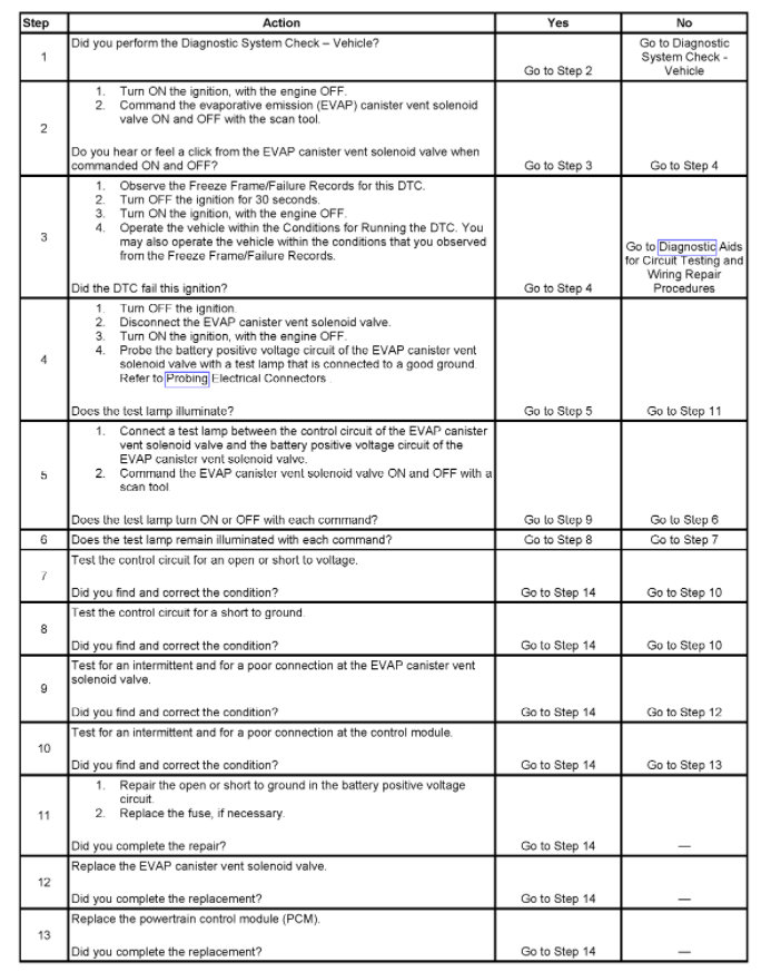

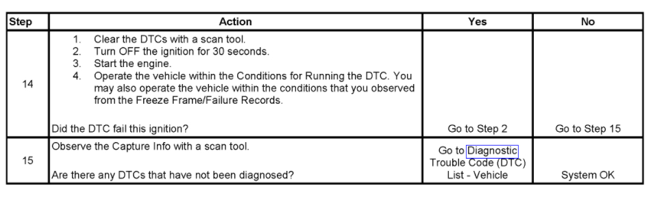

Okay. No Problem. We will be here. The module would be the PCM. I attached the info below for this. Basically the PCM sends 5 volts to the sensor and provides the ground.
So when you unplug the MAF sensor, you should have a steady 5 volts on the wire from the PCM for the 5 volt signal. Then ground on the other. Clearly the signal will not have anything as the sensor is what provides the signal back to the PCM on that circuit.
A quick test is if you have anything other then 4.8-5.2 volts on that 5 volt supply then the module is shorted.
I think we did that but these steps take you through that again and it is a good idea to check it.

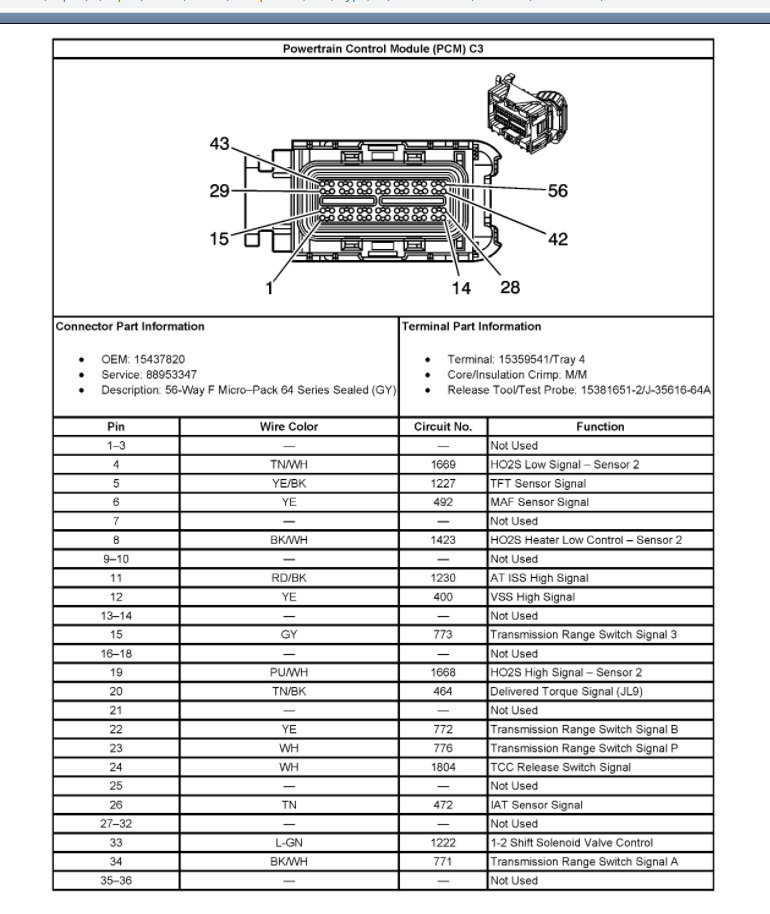

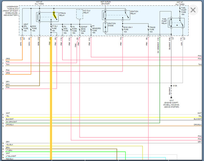

On step 16 of the test document you attached, it said to check for intermittent or poor connection at the module. I have accessed my module and it has 3 wiring connections full of wires going into it. How do we know which wire is coming from the MAF and what it should read where it connects to the module?
Sep 1, 2021 at 4:17 PM

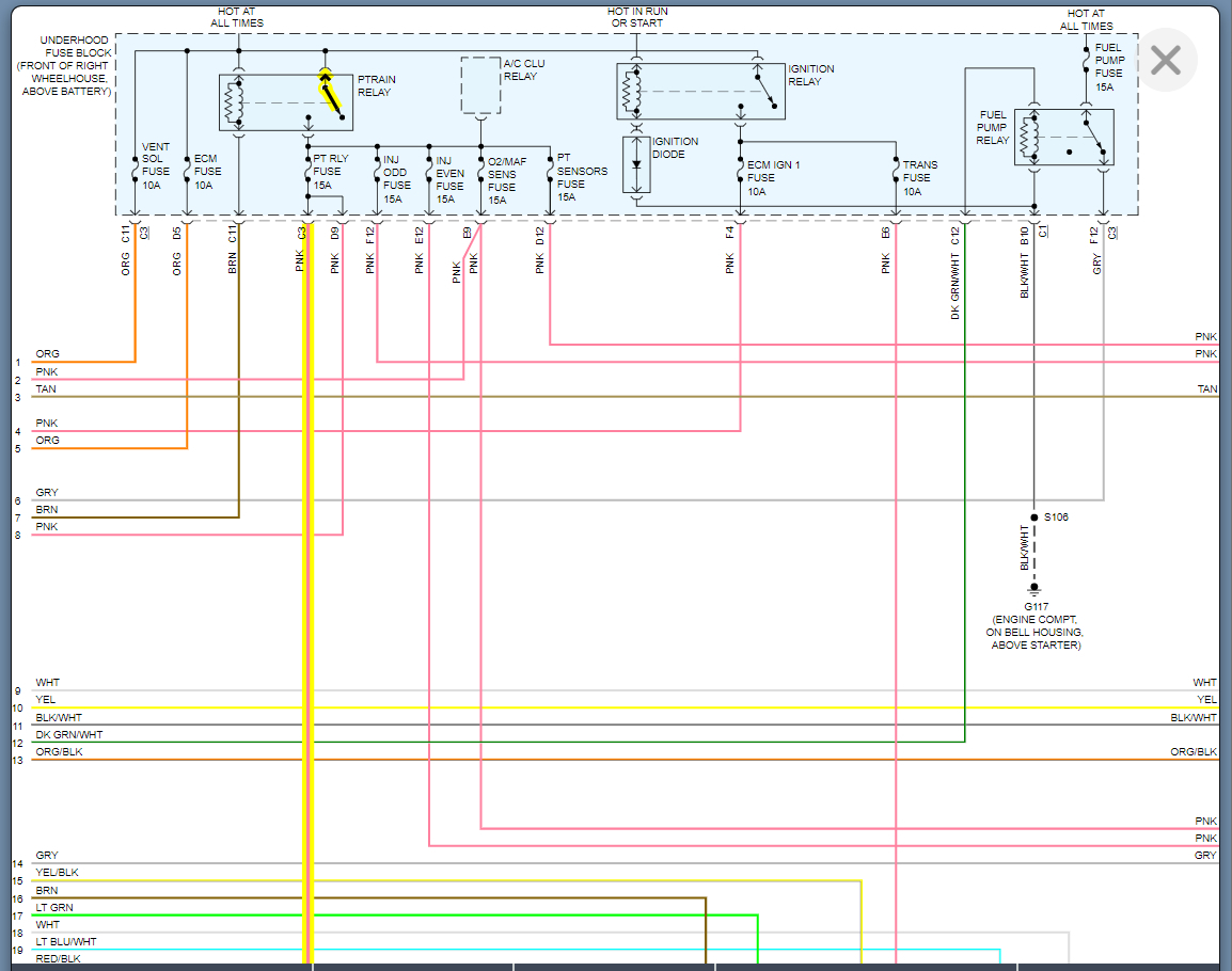

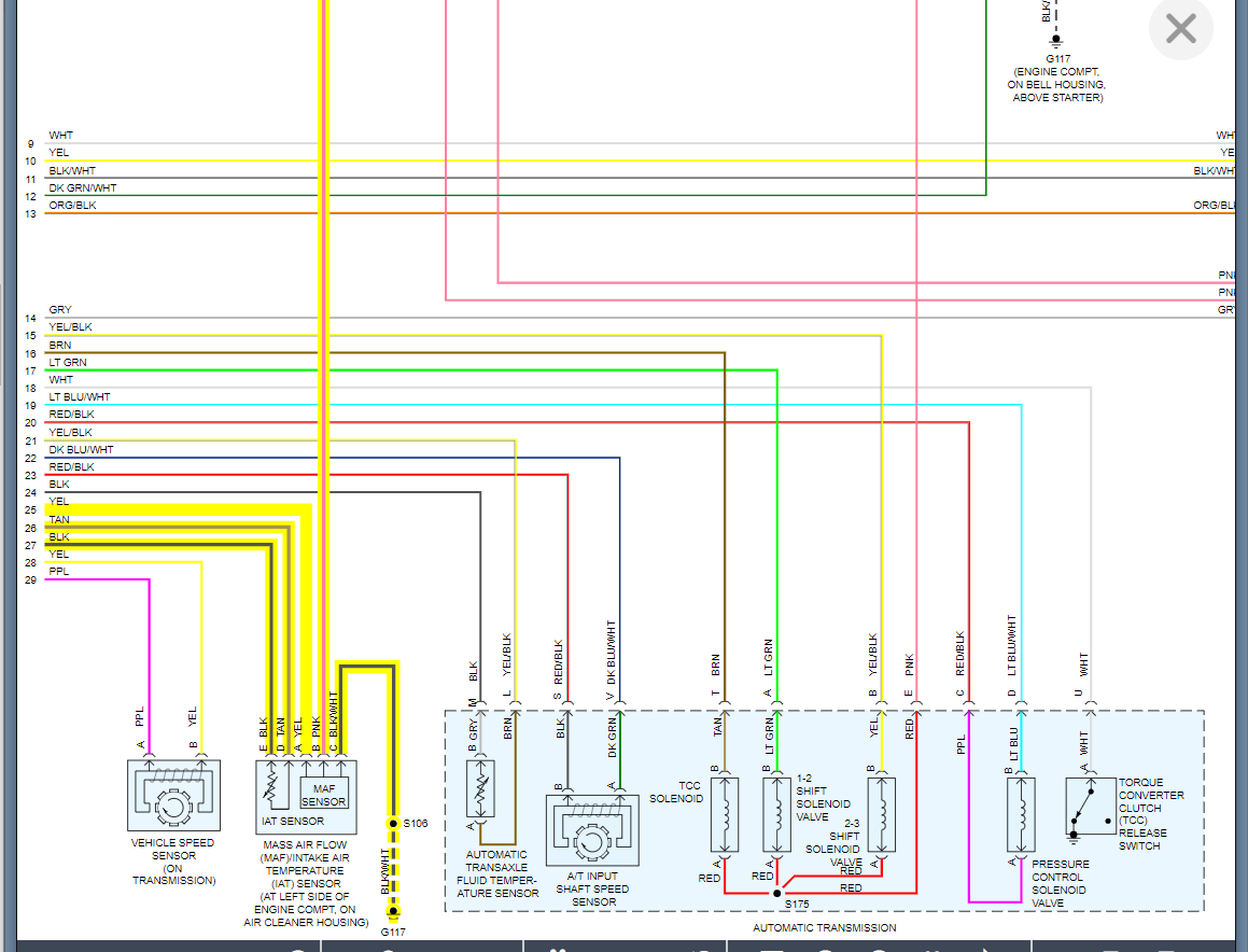

It is not so much inspecting the connection of the MAF but more checking the connector by wiggling it slightly. This will tell us if the code goes active that you have a connection issue.
However, I attached the wiring diagram for the MAF to the PCM. C3 is the one with all these connection in. Looks like it should be grey in color.

I did some more tests today.
First test: I ran the vehicle at idle and used the live scan tool to show the MAF readings in g/s and the DMM to show the Khz. I also wiggled some connections on both the MAF and PCM.
Second test: I did the same thing as the first test but applied some pressure to the gas pedal bringing it over 3,000 rpm's.
I did a full vehicle scan after the tests and it didn't show any new trouble codes other than the usual P0449.
Sep 3, 2021 at 5:32 AM
Yep. So based on that, it looks like the sensor is fine. I agree that the connections are not an issue.
The only thing that gives me pause is that the testing that you circled wants you to set up a generator so that you can take over the control of the sensor and make sure it reacts properly.
This is a dealer specific tool and not generally available. That is why your readings are not in that range however, they are acting correctly.
I say all this to say, if you are getting this code and the engine is demonstrating the issue that you have been seeing, you replaced the sensor already, confirmed the wiring is fine, then I would replace the module.

RYELANDO
  • 19 POSTS
My Module finally showed up today! I replaced it and relearned the keys for the ignition. The replacement works great, and the job went well. Although it didn't fix our issue.
It still gasps for air and sputters. I tried it on the highway twice in the last week (I have only been limping it down the block and back most days) and it was lacking in power so bad it ended up stalling out. It gasps and bucks really bad, it ended up kicking a p0300 code prior to stalling out. I still have the 0449 and 0171, although if I clear them all the only one that comes back is 0449. The 0171 and 0300 only show up if it try to push it a bit harder until it finally yells back at me, haha.
It did immediately start easily once I coasted to the side of the road and put it in park and turned the key.
So unfortunately, I don't think replacing the module solved our problem.
Oct 7, 2021 at 1:31 PM
Based on this info, I am clearly surprised that this didn't fix it. This means we are missing something and the fact that you have the EVAP code returning means we have an issue there that needs to be looked at.
However, a purge can definitely cause sputtering and stalling but the gasping doesn't match a purge valve issue.
Plus, this code is a circuit code so I still don't think that is the issue, but the PCM is telling us there is an issue.

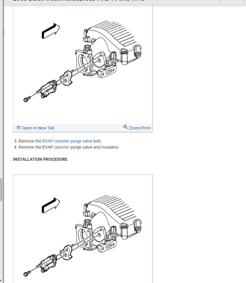

So, let's run through this testing but I would start with pulling the purge valve and seeing if it looks like it is stuck.
The only way I can explain that this would be causing the issue is if the purge is stuck open and it is dumping fuel vapor causing the sputtering and the engine is gasping to try and even out the air fuel ratio.
Again, I have not seen this happen but that doesn't mean it is not possible.
