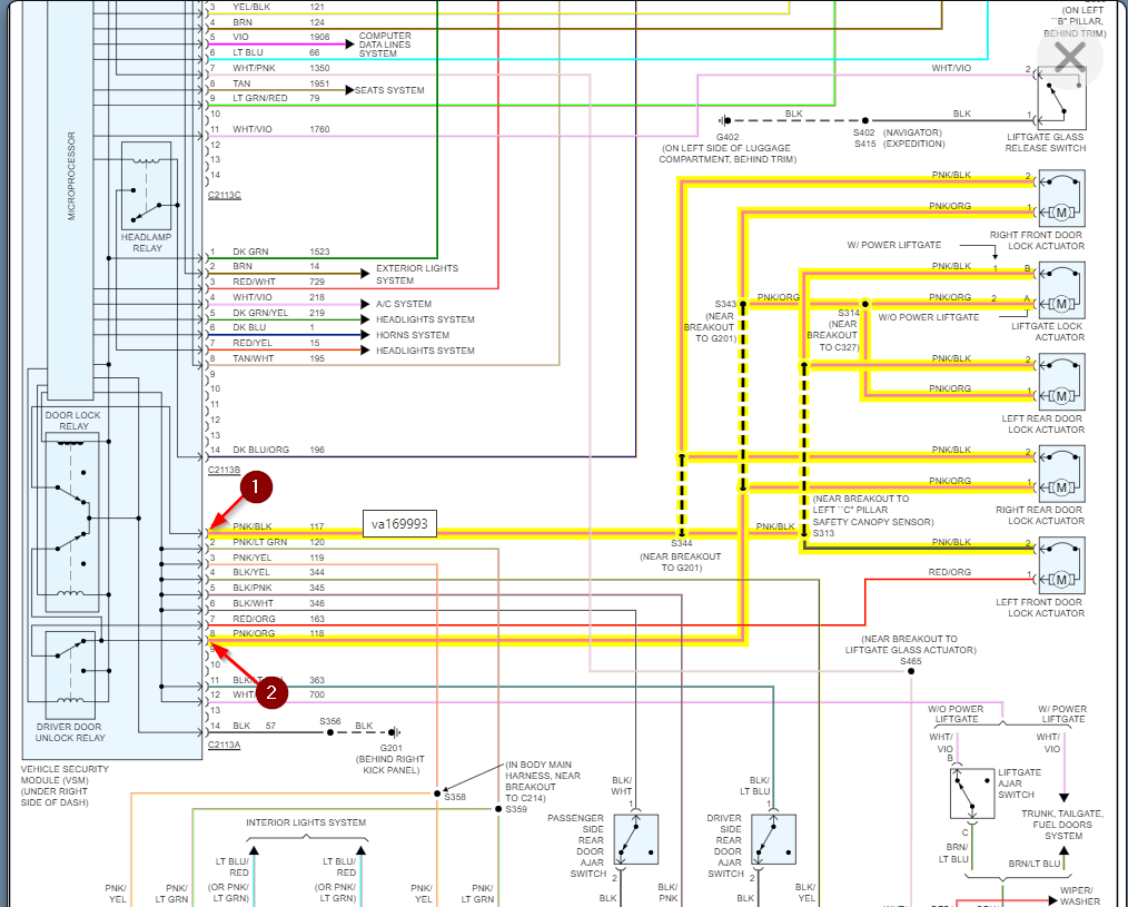

All four doors will not lock or unlock via key fob or using the unlock/lock button on driver's side door, but the back lift gate will unlock and lock using both key fob and unlock/lock button inside the car. Also, all four doors do lock manually. Another issue is I have had the door ajar light on for a few years and the rear door ajar solenoid has been replaced in the past, but it has all of a sudden been off now for a few weeks and only comes on when a door is actually open. Any thoughts would be greatly appreciated.
Nov 24, 2021 at 1:03 PM

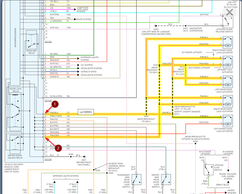

As for the unlock issue I suspect the vehicle security module is the issue.
We need to check power going in and out of the module to find out if this is the cause of the locks not working.
Basically, if they are not working with the button or the fob then this is the likely cause so let's check for power from each of the fuses shown on the diagram below.
Then we need to check power coming out on pin 1 of C2113A.
This can also explain the door ajar switches as they are inputs to the same module.
Let's start with this and go from there.

Okay. So, we need to clarify something. You have 12 volts at pin one when pressing the unlock button? If you look pin 8 is also going to have power when you are pressing the other direction of the button and that will move the actuator in the opposite direction.
However, if you have power coming from both of these and the liftgate is the only one working then there has to be an issue with one of the splices that are tying in the other actuators.
To confirm this, just go to one of the actuators and check for voltage. It is possible to have all these actuators failed but if this happened at the same time then that is near impossible. However, if you just bought this then that may be worth checking first. If you have 12 volts at the actuator, then the actuator is the issue.
If that is not the issue, then what I would do is inspect these splices for anything obvious and then just run your own 12 volts from this wire at the module.
What is happening is you are getting 12 volts to a certain point and then losing it from one of these splices. So, you can create your own splice and run new wires to make sure you have voltage getting to each actuator.

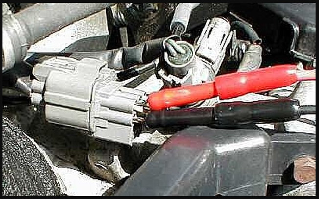

You want the circuit completely intact to plugged in and the door locks will operate with the car on and off, so it doesn't matter if it is on or not.
Then you want to back probe the circuit at the module which means you take a small wire probe tool and stick it in the back side of the connector to touch the metal part of the terminal inside the connector.
So, if you have low voltage and ranging voltage then that sounds like a ground issue.
So, let's check the ground for the module. You do this by back probing the ground on pin 14 of C2113A and then put the other meter lead (red one) on battery positive.
Your meter should read what the battery voltage is as you are checking the ground.
If you have less, than what the battery is then the ground is no good.
Let me know if you are not sure about how to do this and we can get more detail. I am attaching a picture below of what a back probe looks like. Clearly this is not the module, but it will give a good idea what to do.

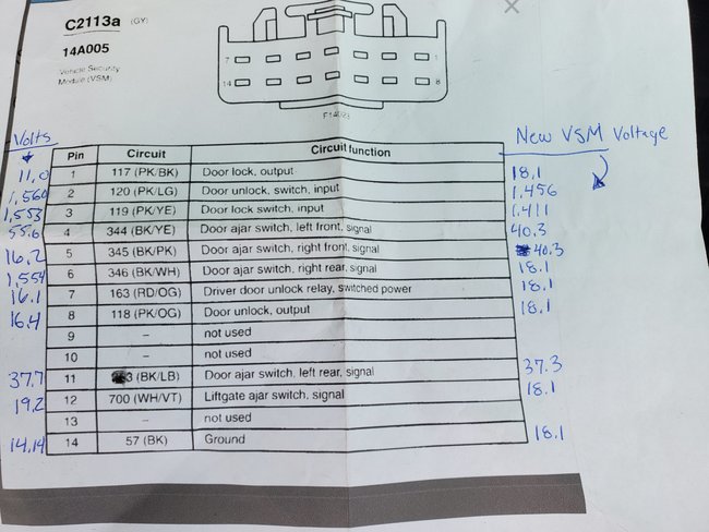

Okay, so I just checked pin one and pin 8 like you said previously while pressing the unlock/lock button and those volts are all over the place and will read 0L. Pin 14 was at 12 volts and that was the only pin steady in the readings. A few other pins were steady at .002. Also, I was trying the button for every pin. I did have the car running and weird thing was the more pressed the button the lights in the cab would dim.
Nov 27, 2021 at 11:06 AM

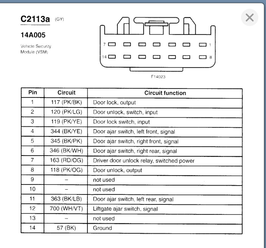

Okay. I am pretty sure we have an electrical issue, and a ground issue would make sense but may not be what we have now.
However, anytime we get into this territory, we need to start at the beginning and that is making sure that you have a good battery because a weak battery will cause all sorts of issues. Just drive by a parts store and have them load check the battery just to make sure it passes.
If it does and the ground for the module checked out, then I suspect the module is the issue.
However, before we condemn the module, let's just run through getting voltages for each of these pins.
Take a look at the diagram below. If you can get voltage on each of these pins that will help us make sure we are on the same page.
Again, 14 needs to switch your other meter lead to battery positive so that it checks the ground just to double check that one. All the others you will have your other meter lead on a ground.
I suspect most of those voltages are correct because these should be door switches and if the door is open or closed then that will change the voltage. So, if you want to test that as well you can by opening or closing the door based on what pin you are on.
The OL concerns me because that is normally a resistance reading and not a voltage reading but that could be based on the meter you are using.
Feel free to print that sheet and write the values on it or just make a list from 1 to 14 and write them down then get a picture of that.
Lastly just make sure you note the orientation of the connector. Use the wiring colors to orient yourself so that we are not recording voltage incorrectly.
I get that you have done this, but I would not like to point you to a module if that is not the issue. Thanks

So, I went and got my battery tested and it passed and also tested it with my voltmeter and read 14.14 volts. Here is the picture I attached with the volts I read next to each pin number. Also, after messy with it so much and trying the unlock/lock the back lift gate now won't lock or unlock. So hopefully this helps. Oh and in the picture is the meter I'm using.
Nov 29, 2021 at 4:38 AM
Okay. That is great.
Those do not look correct at all, so I suspect the module is shorted internally. You actually have 11 volts on the output and 14 on the ground.
So, I would expect to see 12 volts on pin 1 and 12 volts on the ground.
So that again points to a module issue or a possible faulty ground.
Let's do one more test to check the ground. This is called a voltage drop test. Basically, you put your red meter lead on pin 14 of the module. Then the black meter lead on the battery ground and see how many volts your meter reads. It should be less than a half volt.
Basically, you are checking to see how much voltage the ground wire, stud, and cable require to return the current to the ground post of the battery. It should be basically 0. If you have a loose or dirty ground location, then it will require more to overcome that resistance.
If that checks out, then I would replace the VSM module.

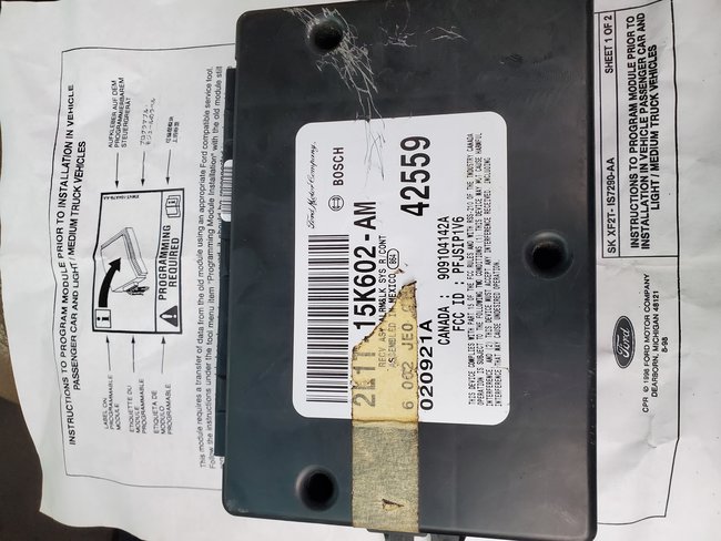

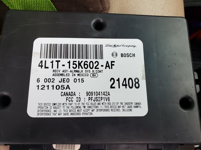

Okay, so the first picture is the old VSM. The new one which is used via eBay and did come in a box with the part number on the box which was the same as you provided me. Also is plugged in the car now. The second picture is the instructions that was inside with the VSM. I haven't tested anything with voltmeter yet.
Dec 6, 2021 at 2:48 AM
EHANNUM89
  • 17 POSTS
Oh, and this is a picture of the new VSM that I got via eBay.
Dec 6, 2021 at 6:14 AM
Okay. That makes sense. That is a little misleading because I think this module is the backup for the theft system.
When you plugged it in, did the theft light go off or did it stay on or flash?
Basically, it should be done because they are just going to pull out the info from the old module and put it in this one but that does not mean that it will not operate the locks.
So, I am curious to see if these voltages are different when this module is plugged in.

The theft light still flashes when all doors are closed but not when I'm driving or when vehicle is on.
Dec 6, 2021 at 6:38 AM
Okay. Then that confirms that the module does require to have it programmed as it is the back up for the theft information. Basically, this is so that when you replace the PCM the theft info is stored somewhere else, and you don't have to replace all the theft components to match the new PCM. You can simply run a procedure with a scan tool that will tell the PCM what info it needs to work with the vehicle as equipped.
So that means we need to treat this the same and check the voltages and find out what is there.

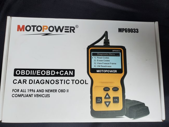

Okay, I will check the voltage tomorrow and get back to you. What scan tool do I need? I do have a basic one so I will send a picture of it tomorrow to see if that will work.
Dec 6, 2021 at 10:07 AM
Unfortunately, you need one that is capable of extracting the info from the module, saving it and then flashing the new module. Those are the high dollar tools that most DIYer don't have. So, if you have a code reader or one that can monitor live data, that is not going to be capable of doing this.

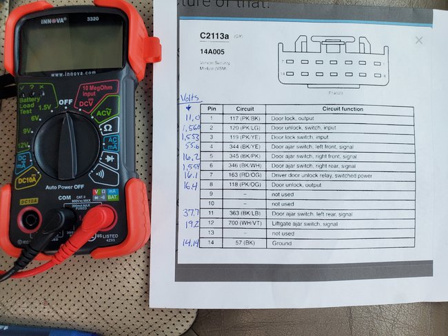

So here is the voltage I got for the new VSM and a picture of the scanner I have. Also, other thing to mention is that my auto lights never worked, and dome lights would come on randomly and now they both work how they should. I'm sure it has to do with the VSM buy didn't know if that helps.
Dec 7, 2021 at 4:48 AM
Unfortunately, the scan tool will not work for transferring this info.
As for the voltage, those voltages are off as well. You have 18 volts on the output and a number of switch inputs on door ajar switches.
Plus, you have 37 volts on another one, so we have to have an issue with either the meter or how we are testing this.
Can you get a picture of the meter hooked up to this so that we can see the settings on the meter and how you have it connected to the circuits?
You should have around battery voltage on most of the circuits or close to 0 volts. So, these are very strange but at least some of the things that didn't work started working again so you know that other module was causing issues.

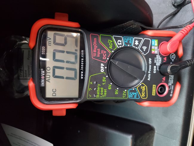

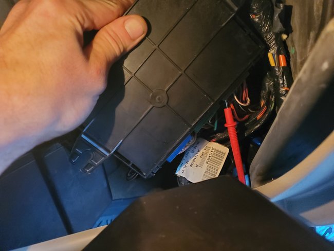

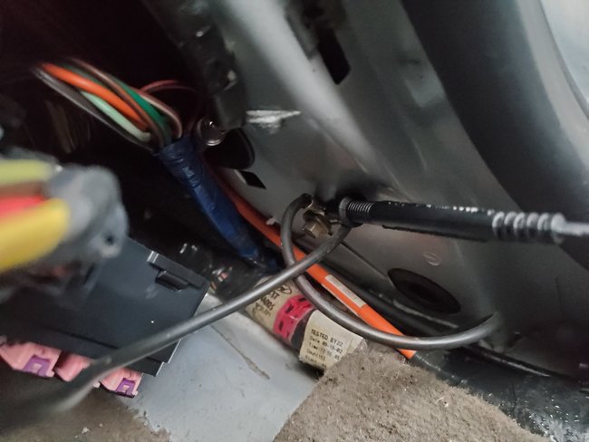

Okay, so I couldn't get a picture of me testing it in one shoot but the first is the setting I've been using and the second is the ground lead on the ground from the fuse box and third is the positive stuck in the back of the plug in the VSM. This time I had the car off and I quickly tested all the wires and got 2 volts or less if I held it there but right when I touched the positive, I would get 13 or 14 volts then if held would go down to what you see in the picture or 1 or 2 volts. Hopefully this helps.
Dec 9, 2021 at 7:50 AM
Okay. I think I see the issue. This meter has an auto scale so when you checked these volts and it says 40 volts or 37 volts, I suspect that was millivolts and not volts.
So, let's just focus on pin 1. Can you hook this up and check the voltage on pin 1 and ground? Then get a picture of your meter when you are pressing the lock button and when you are not?
Hopefully seeing what the meter is saying for these will get us where we need to be. Thanks
