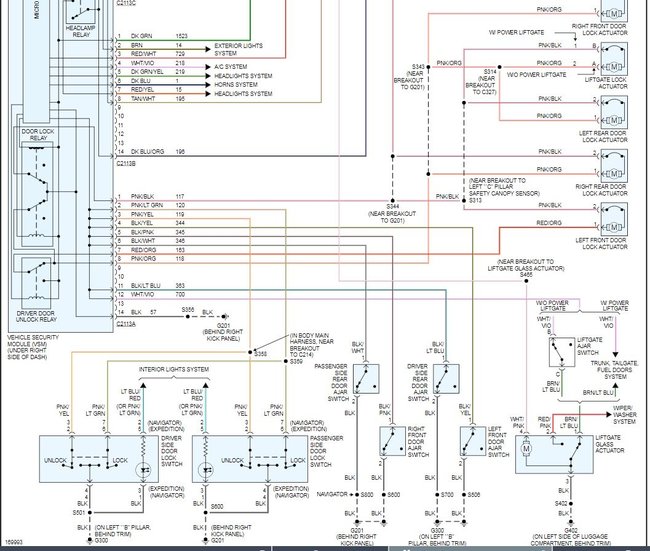

I have a problem with the door locks. 3 of the 4 doors do not lock with the keyless entry or if I lock them by using the lock buttons on the door. Any idea what the cause would be?

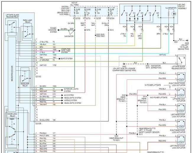

With an issue like this you should check for power/ground at the actuators when operating the switch
See the guide below on using a test light, it will help
Attached below is the wiring diagram for your power locks
