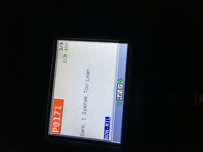

Bank 1 is running lean.

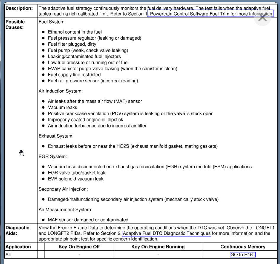

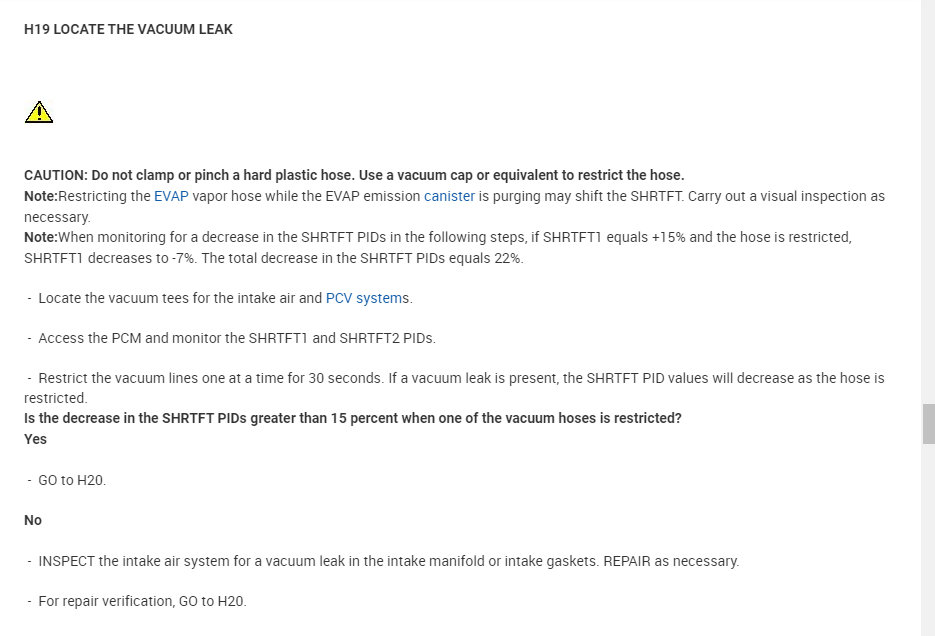

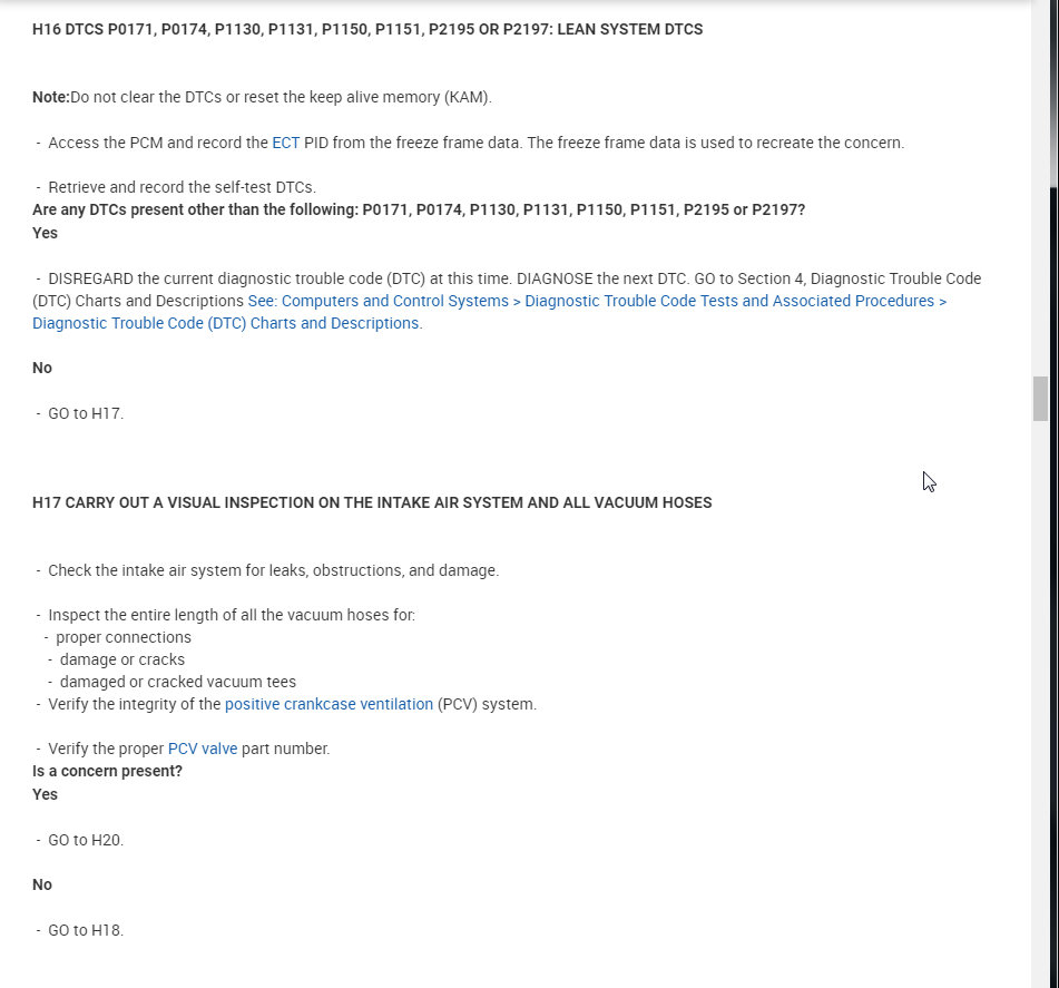

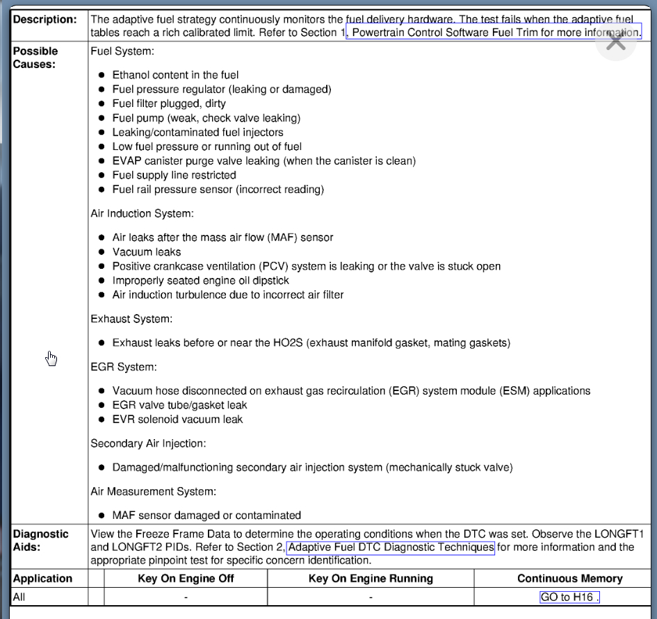

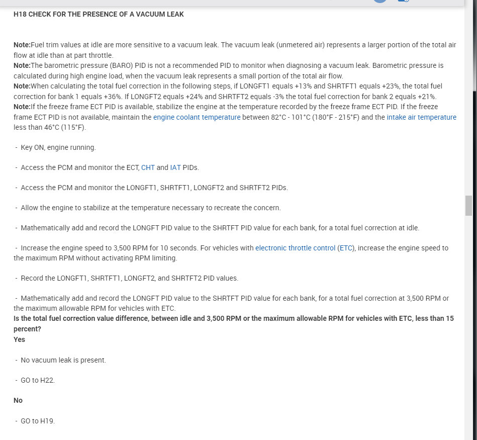

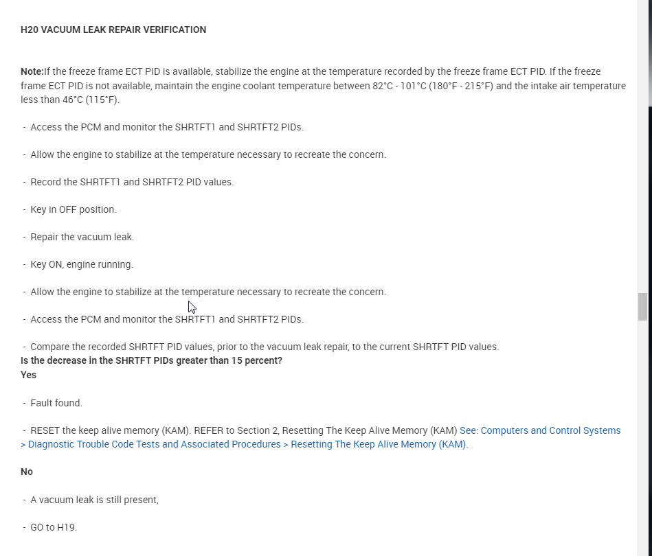

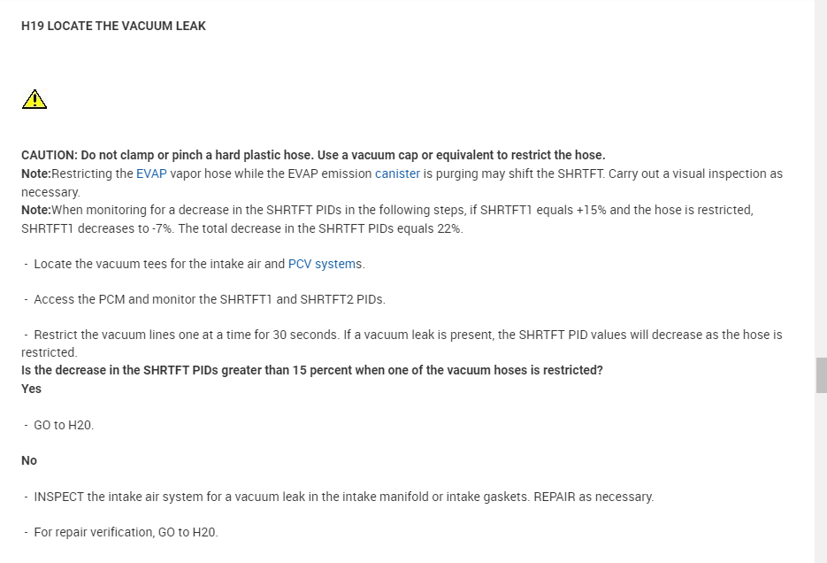

Okay. I attached the testing for this code. They have you focus on a vacuum leak but as I said before the fact that you have a popping as well, I suspect the leak is in the exhaust which is allowing the air in before the o2 sensors which is leaning out the exhaust and it is causing it to ignite.
If we find and fix the cause of this issue, I am sure your popping will stop.
Here are some guides that will help answer any questions but let us know if you have any more. Thanks
https://www.2carpros.com/articles/repair-lean-mixture-codes-p0171-or-p0174-on-some-manufacturers
