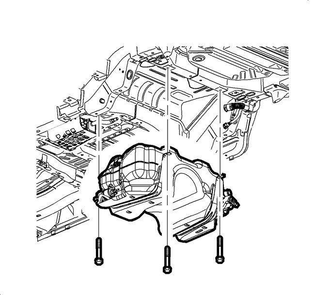

4. Raise and support the vehicle . Refer to Vehicle Lifting.
pic 1
5. Remove the rubber exhaust hangers on order to allow the exhaust system to drop slightly.

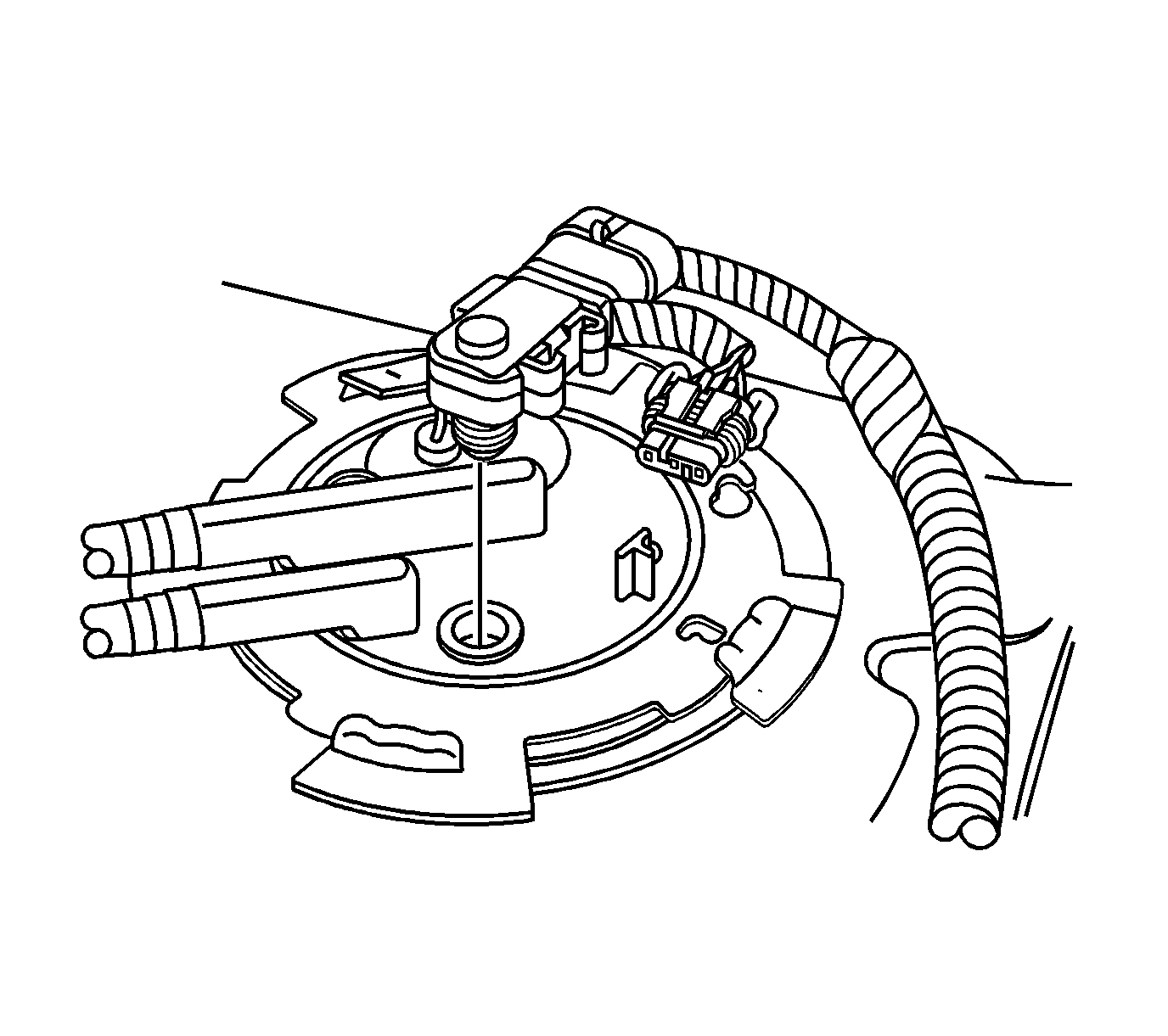

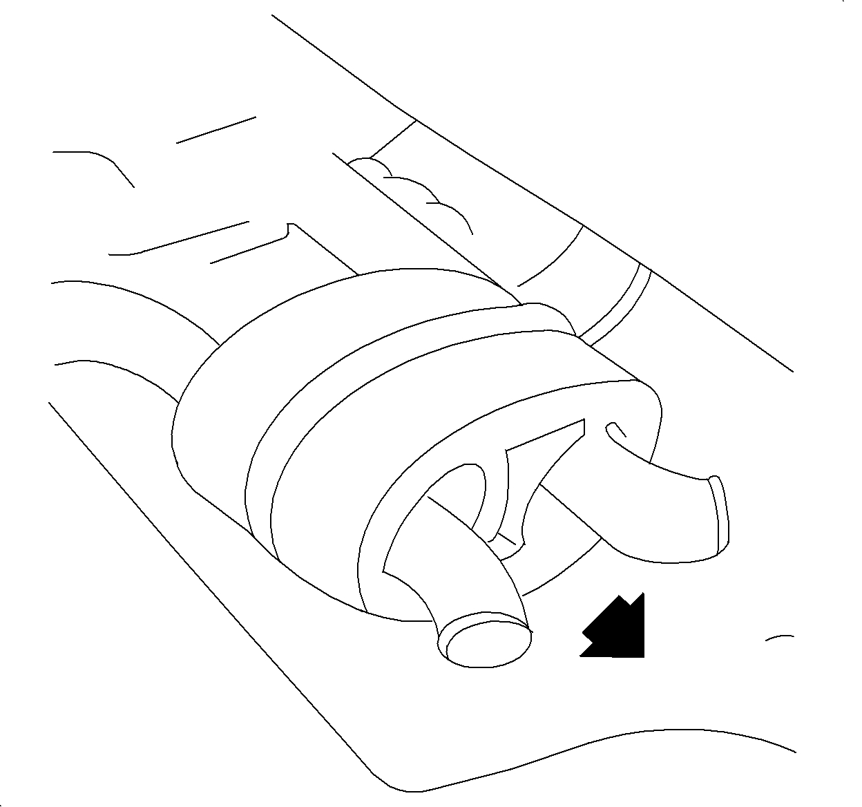

7. Disconnect the EVAP canister vent and fresh air hoses:
NOTE: Clean all fuel pipe connections and surrounding areas before disconnecting the fuel pipes to avoid contamination of the fuel system.
1. Grasping both sides of the quick-connect fitting, twist the female connector 1/4 turn in each direction in order to loosen dirt within the quick-connect fitting.
2. Blow any dirt out of the quick-connect fitting using compressed air.
3. Squeeze the plastic retainer release tabs.
4. Pull the connection apart.
5. Inspect both ends of the quick-connect fitting for dirt and burrs.

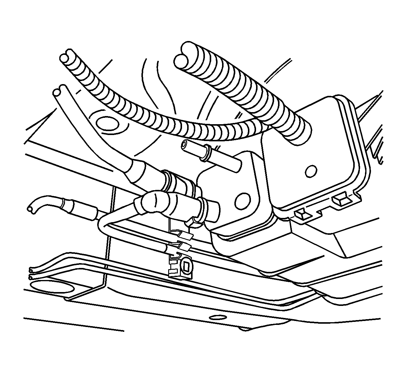

8. Remove the fuel filler pipe, EVAP vent hose, and fresh air hose from the fuel tank.
9. Disconnect the chassis fuel supply line from the tank.
CAUTION: Whenever fuel lines are removed, catch fuel in an approved container. Container opening must be a minimum of 300 mm (12 in) diameter to adequately catch the fluid.

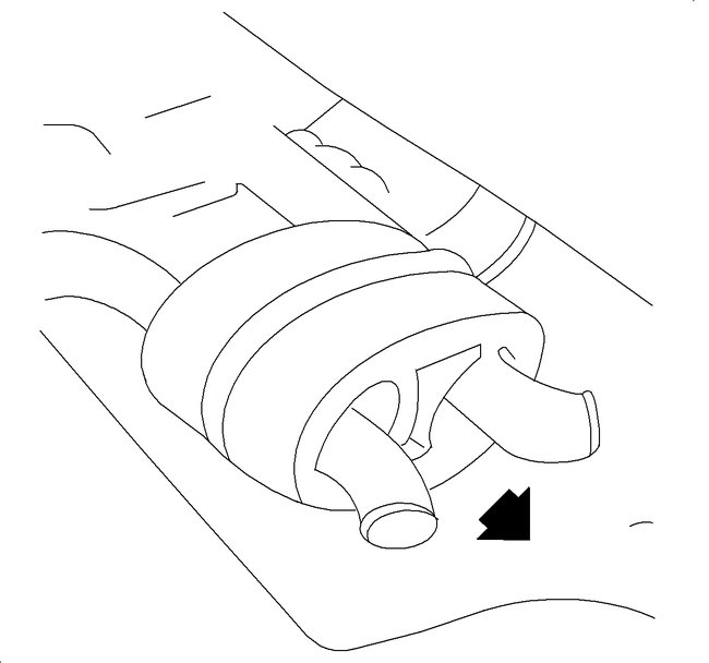

10. Disconnect the electrical connectors:
1. Fuel tank electrical connectors
2. EVAP solenoid electrical connector

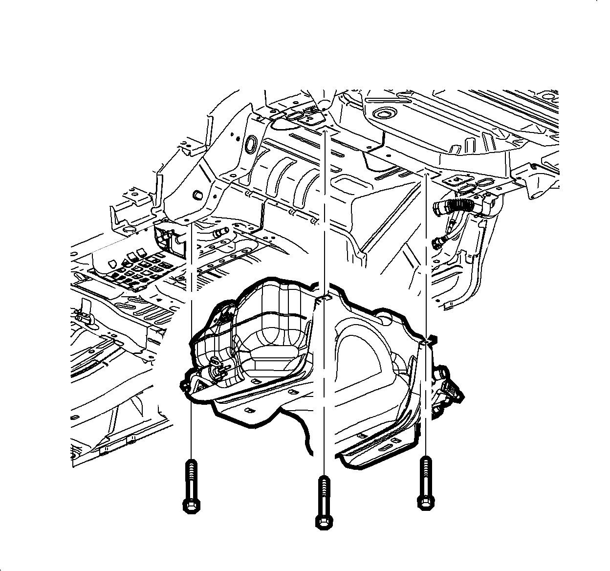

12. Remove the fuel tank strap bolts and fuel tank straps.
13. Lower the fuel tank from the underbody of the vehicle.

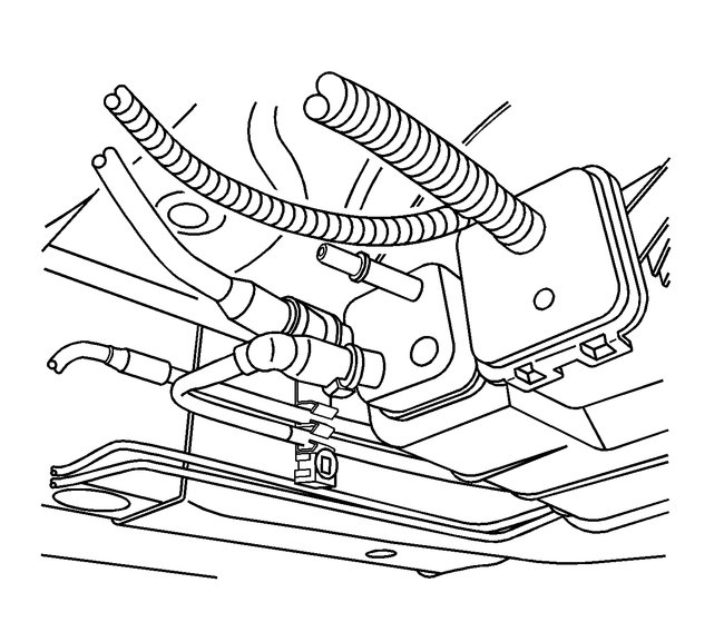

1. Install the fuel tank module assemblies.
pic 5

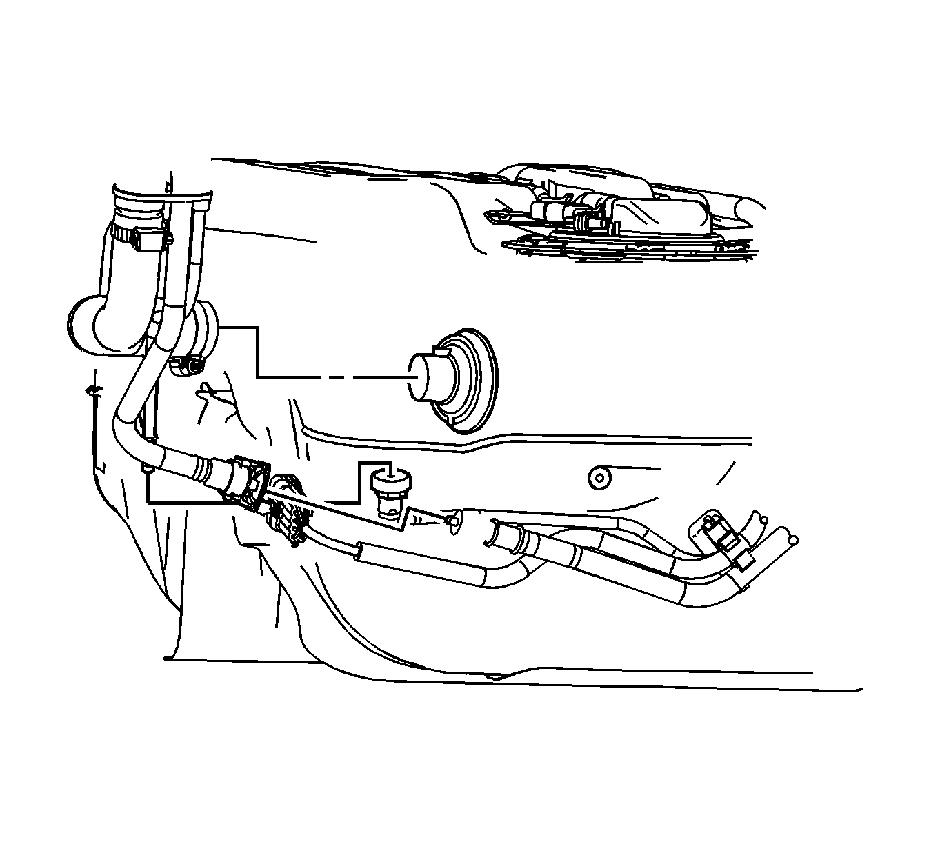

4. Install the fuel filler pipe, EVAP vent, and fresh air hoses to the fuel tank.
5. Connect the electrical connectors:
2. EVAP solenoid electrical connectors
6. Tighten the hose clamp on the filler pipe-to-fuel tank connecting hose.
Tighten the fuel fill neck-to-fuel tank clamp to 5 N.m (44 lb in).

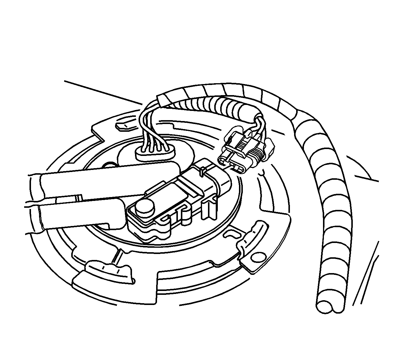

2. Disconnect the fuel pump module harness electrical connector from the fuel tank pressure sensor.
pic 10
3. Position 2 flat-bladed screwdrivers, one on each side of the sensor, near the vacuum port.
4. Carefully use the screwdrivers to lift and release the sensor from the fuel pump module.

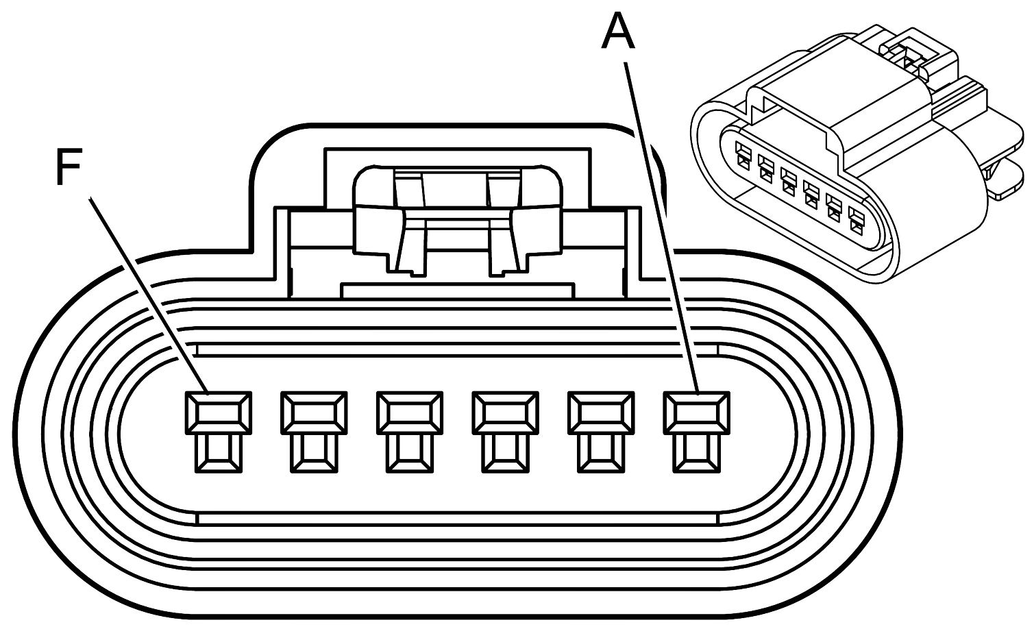

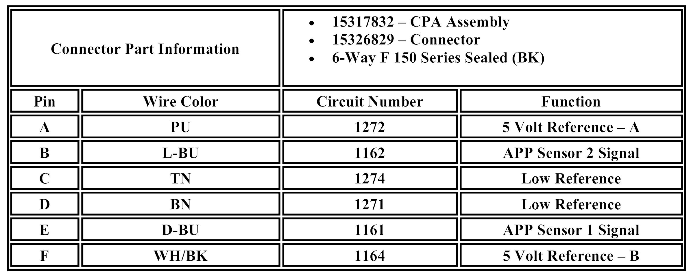

Hi! So, since we last talked, I've changed out the fuel tank pressure sensor, the accelerator pedal sensor, the accelerator pedal sensor connector, the throttle body unit (and gasket) and gas cap. The code that remains: P2122 Throttle/Pedal Position Sensor/Switch "D" Circuit Low Input. Any thoughts?
Jul 27, 2019 at 9:22 AM
  • 110,248 POSTS
Welcome back:
Okay, you should have a 5 volt reference in pin A and F of the connector. Pin A is the suspect for the issue, but check both. For the code to set, the ECM detects that the APP sensor 1 voltage is less than 0.13 volts. What I need you to do is check the connector pin to confirm there is 5 volts. If there isn't, either you have a broken or damaged wire, or there could even be corrosion causing a poor connection at the ECM.
If you look at pictures 1 and 2, they show the connector and what each pin is for. Focus on pin F for voltage.
Check that and let me know what you find. Also, if you find 5 volts, then confirm that pins C and D for continuity to ground.
Let me know what you find.

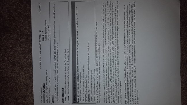

Oh! Duh. I forgot to tell the remaining symptoms: so, I get up and go in first and second, it still struggles in third. I struggle to get up to 4 RPM'S in fourth. Fifth rests at 3 RPM'S. And without admitting to anything, it won't go past 80 mph and that's with the help of gravity (hills). It's a real struggle to get up to speed!
Note: 2004 Saturn Vue 2WD 2.2 Liter 4 cylinder manual has 353,000 miles, 140,000 on the engine, and the spark plugs are about 40,000 miles old.

I just replied to the other post. Take a look through what I listed. It is specific to the code you provided.

That does make sense... would it explain the P2122 code?? Low circuirt. And why changing the pedal, pedal connector, throttle body unit hasn't fixed anything.
Aug 8, 2019 at 2:29 PM
  • 110,248 POSTS
Welcome back:
It doesn't explain that code. Have you deleted the code and seen if it has come back?
