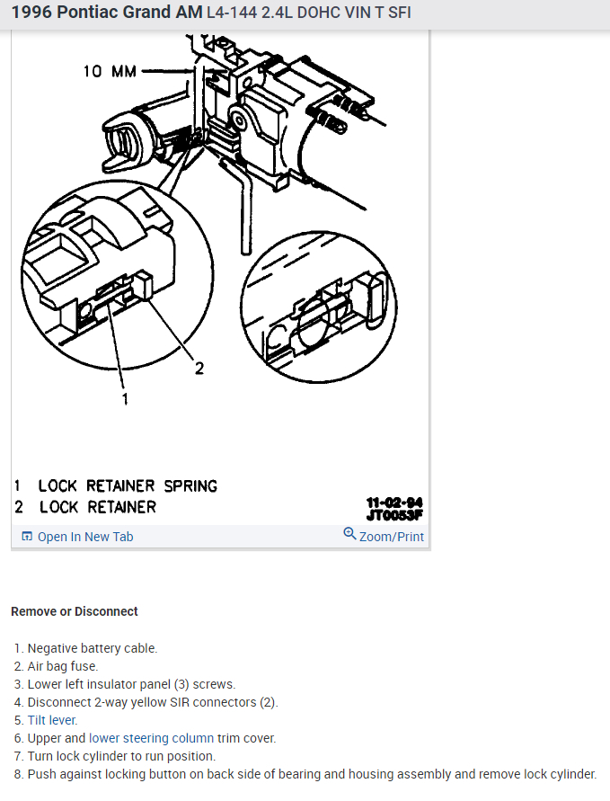

Battery, starter, alternator all good, turn the key and makes no sound at all, lights, radio, dash lights and all that work, why wont it start?
Friday, May 2nd, 2008 AT 1:06 AM
SQM
  • 6,383 POSTS

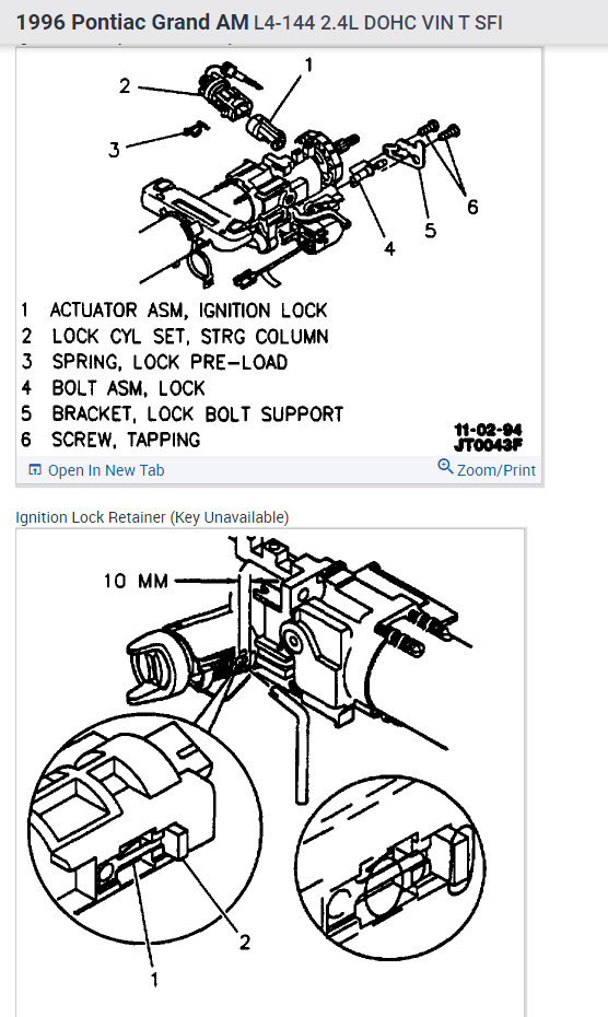

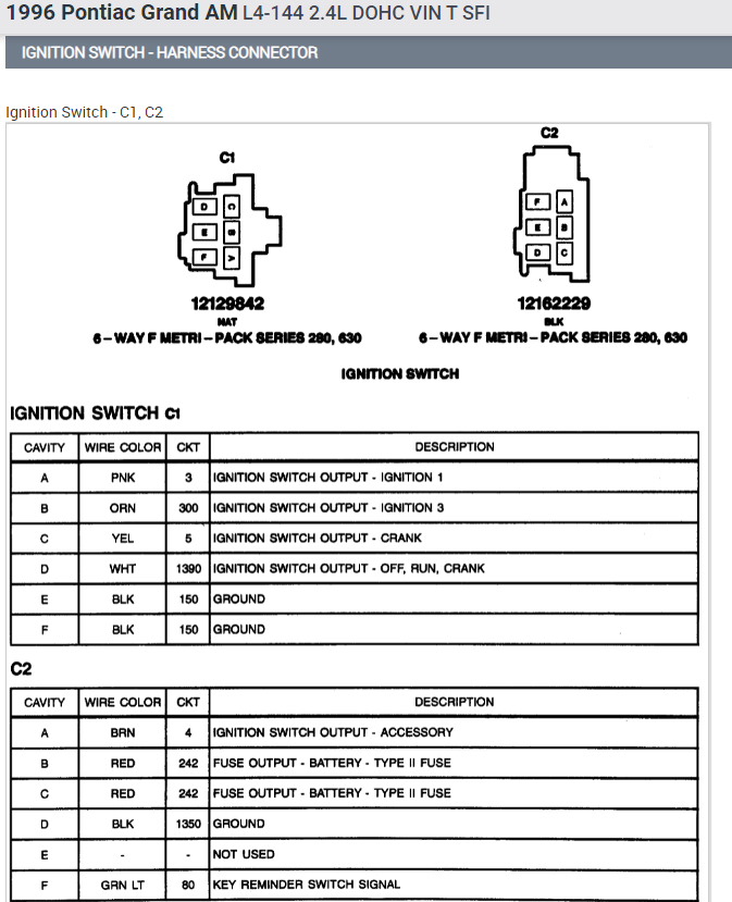

It sounds like there might be an issue with the ignition switch.
The ignition switch is the electrical component where the lock cylinder attaches to.
The switch has several pin and connectors and over time they will wear off and you will get no connection when you turn the key and it will make no sound when that happens.

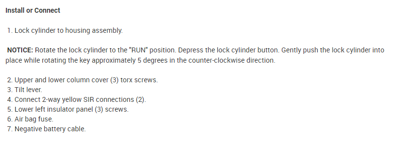

In order to access the ignition switch, you will have to remove the steering wheel as well as the lock cylinder. When working around airbag always take precaution. Be sure to disconnect the battery cable before staring.
