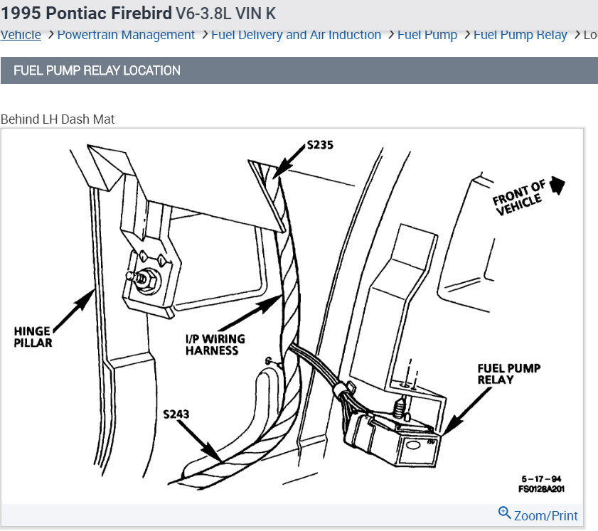

Someone said there is a fuel pump relay? Where is it located or is there one?

Hello, no there isn't one. If you have a fuel issue, check fuel pressure. If you turn the key on, no crank, can you hear the pump run for a couple of seconds? If not check the fuel pump relay here is a guide and the location of the relay.
Check out the diagrams (Below). Please run this test and get back to us.

You might check the circuits at the fuel pump relay. My info says it is located under the dash, driver side, behind kick panel.

I removed the kick panel on the driver's side and believe I got the fuel pump relay, grey box, P&B VF28-31F14-Z01, is that the right one? I was told the fuel pump is going out by a mechanic and another told me to check the relay first. Car has trouble staying running, dies while driving, etc.
Should I do something else or am I giving way too little info? Thanks for this site by the way, I appreciate any help at all.

What liter engine?
On the 3.8L the Fp relay is in position N in the relay center
