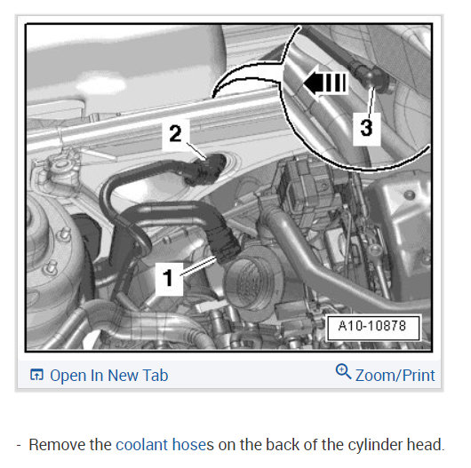

I bought a used car just 3 weeks ago. After 2 or 3 days of purchasing the car, car started shaking on driving. Once the car had sign of engine and stopped, was moving to mechanic by a tow truck. The mechanic changed 4 spark plugs and it was pretty good for a few days, however, it start shaking a bit. The mechanic said it would be a piston ring problem. When he scanned the car, the compression was low in second cylinder and the spark plug was with oil. I don't know about a car at all and I'm in panic now. Please give me some information about what I should do. Thank you.

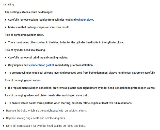

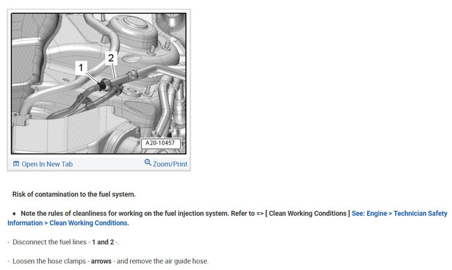

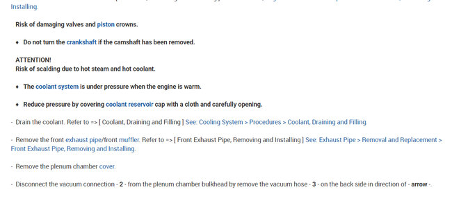

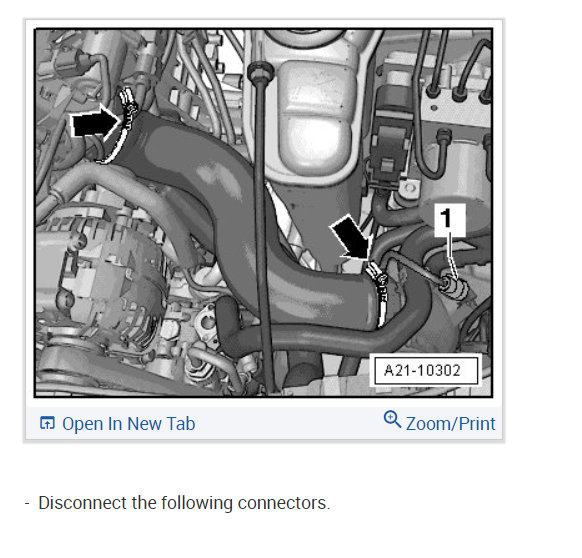

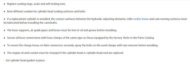

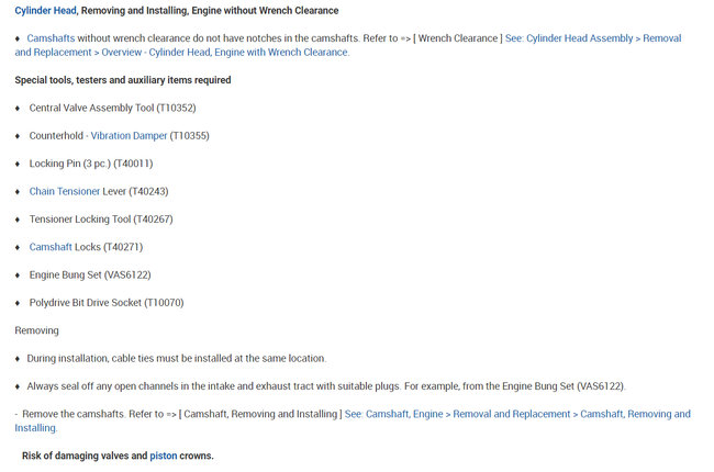

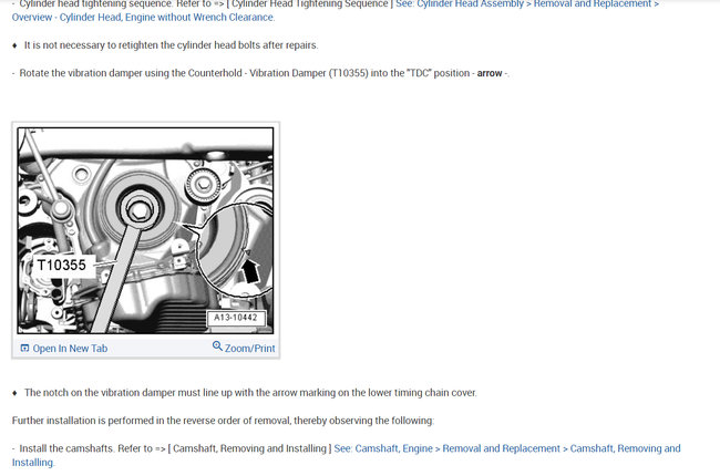

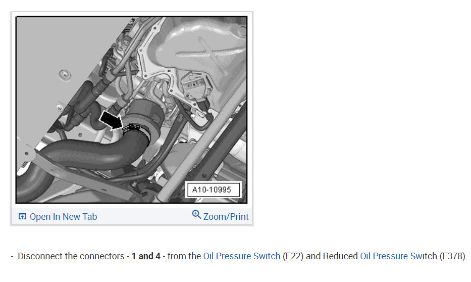

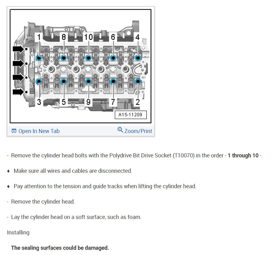

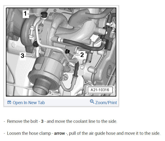

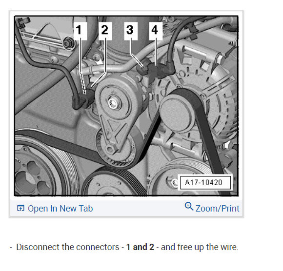

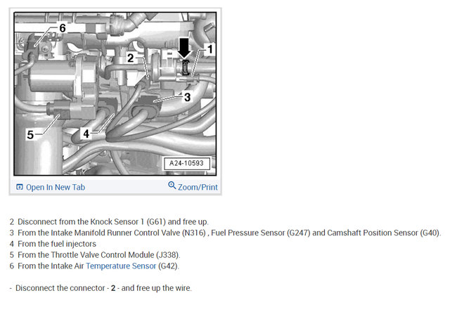

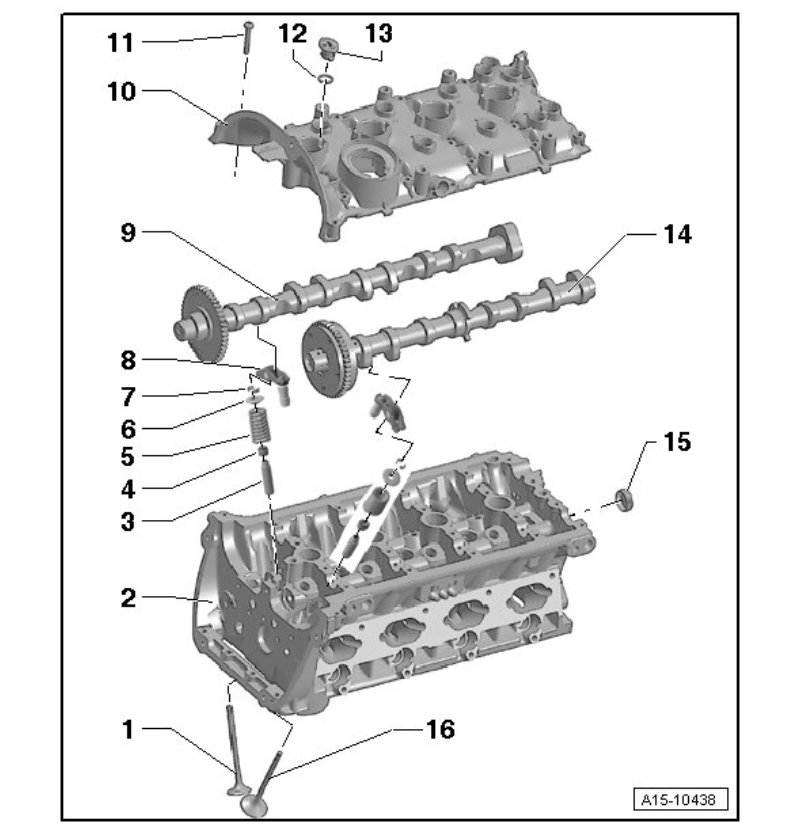

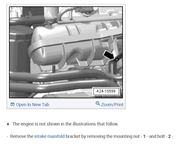

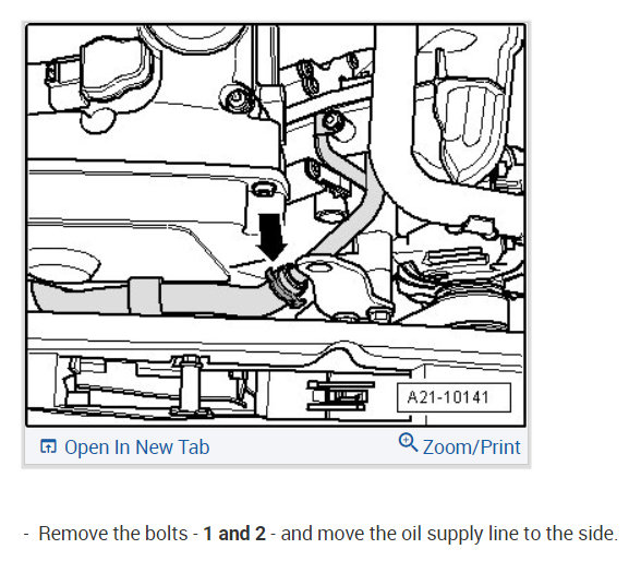

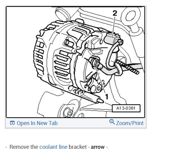

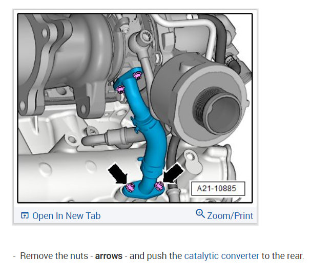

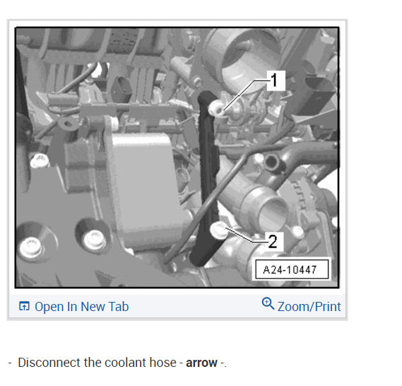

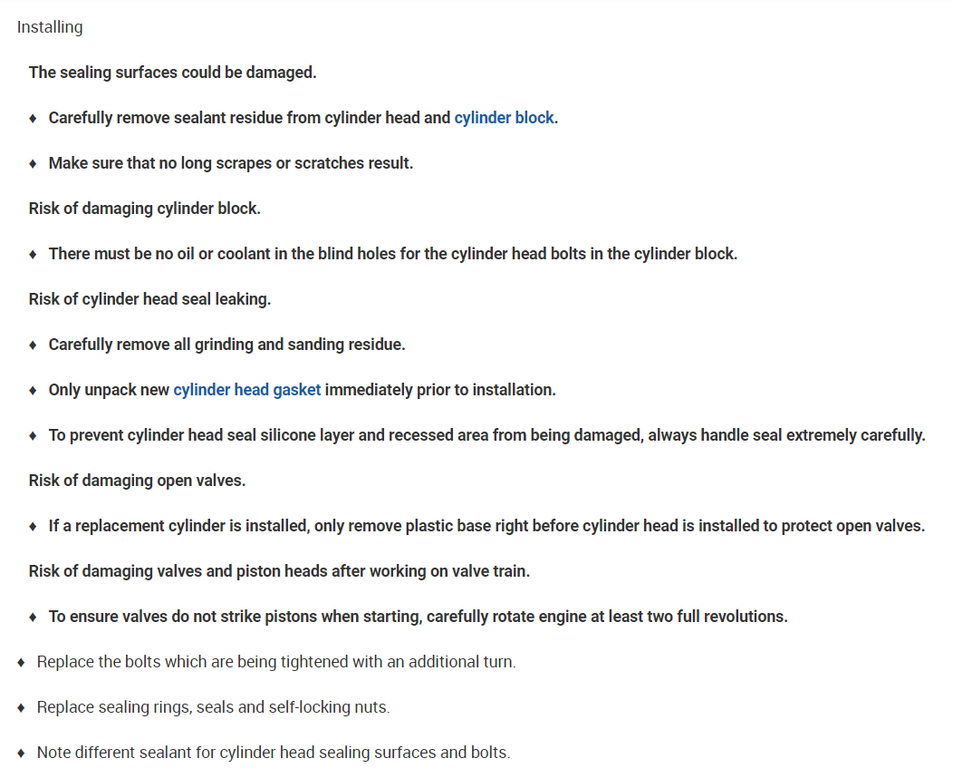

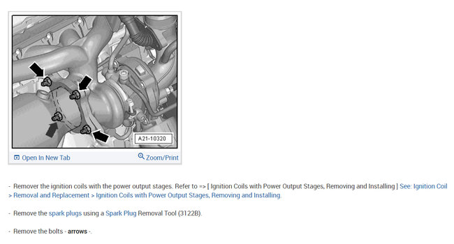

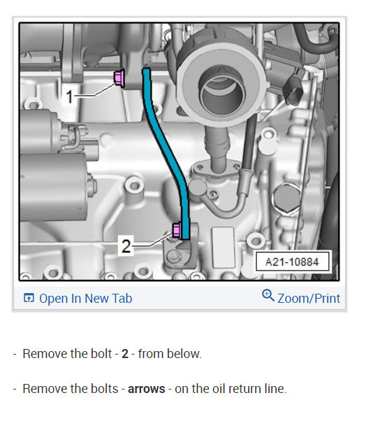

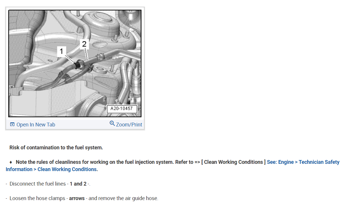

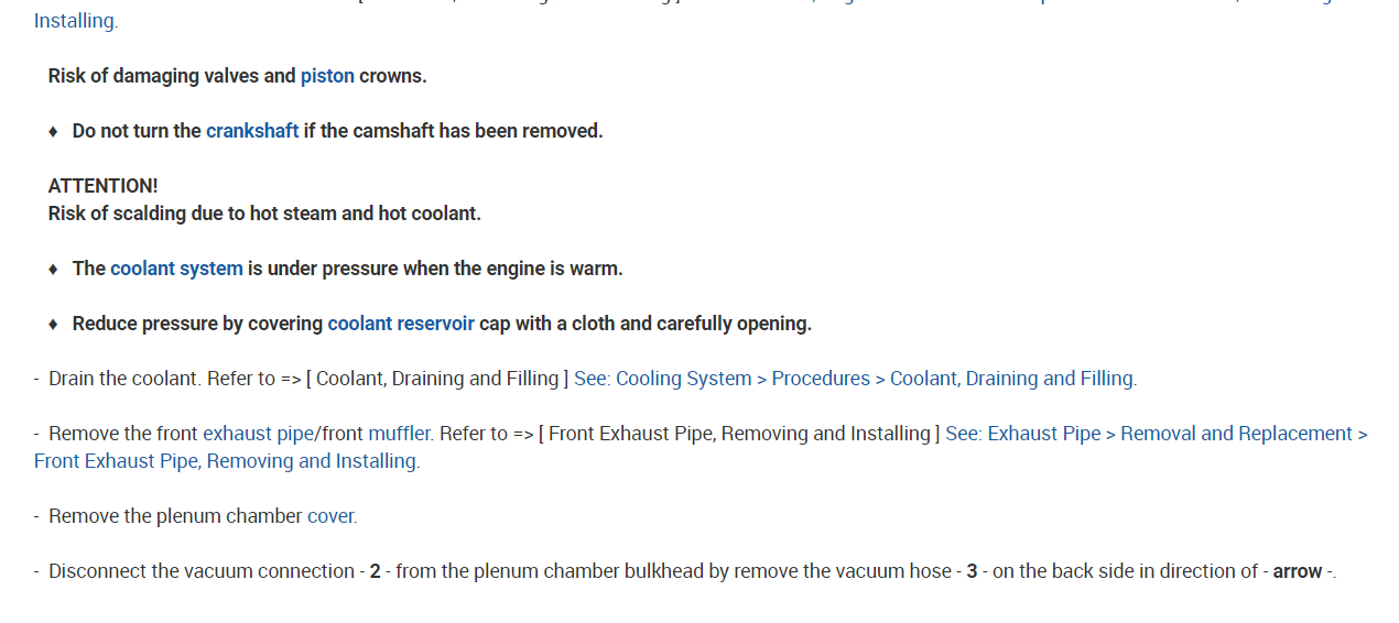

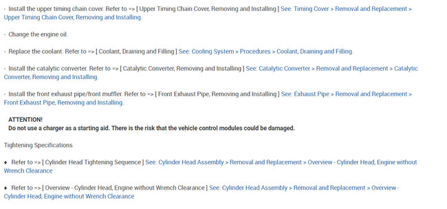

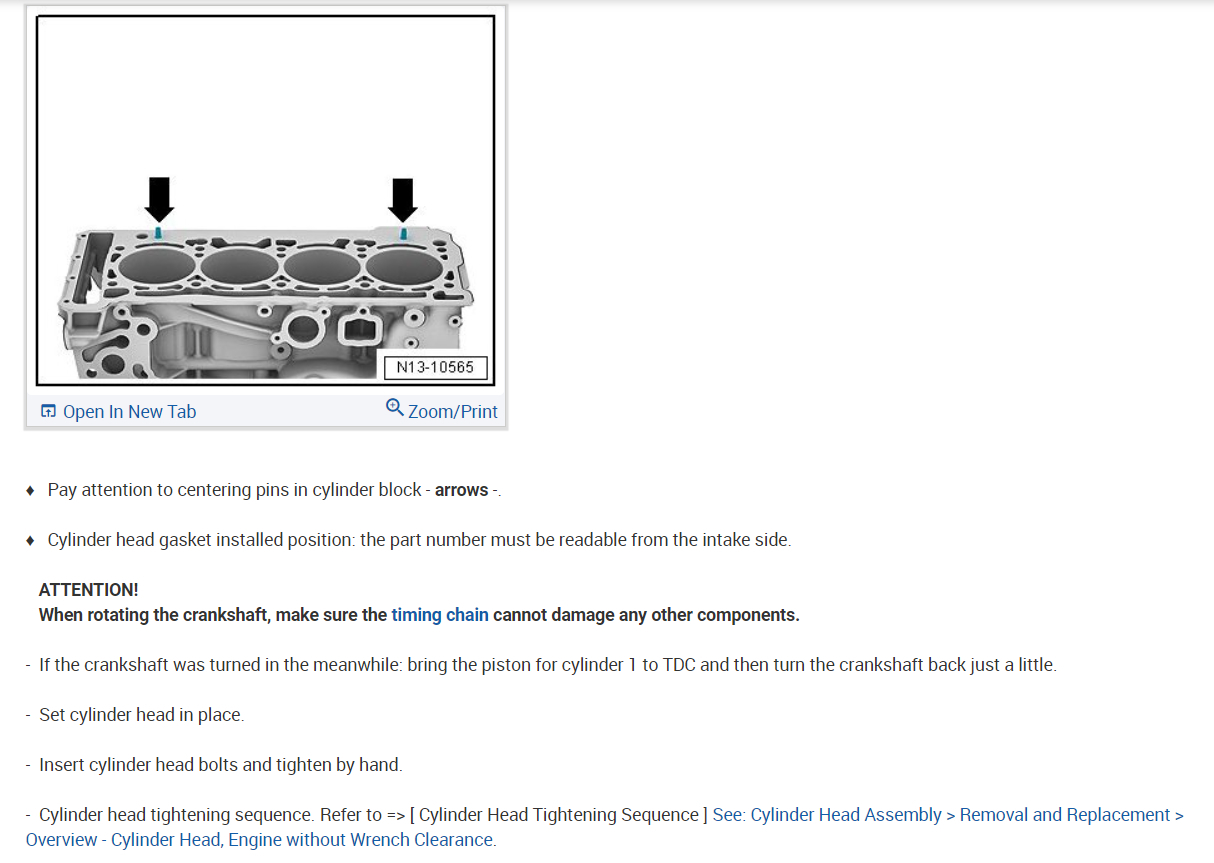

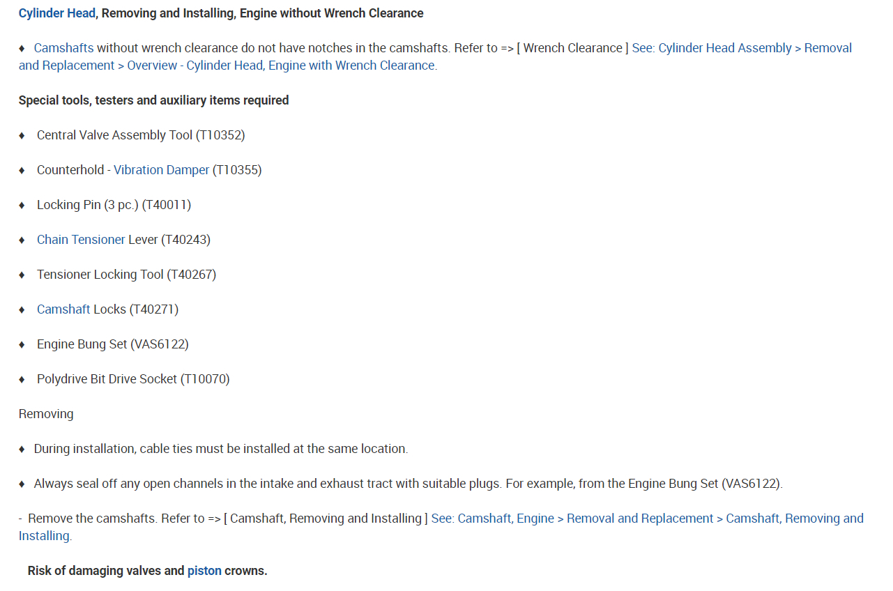

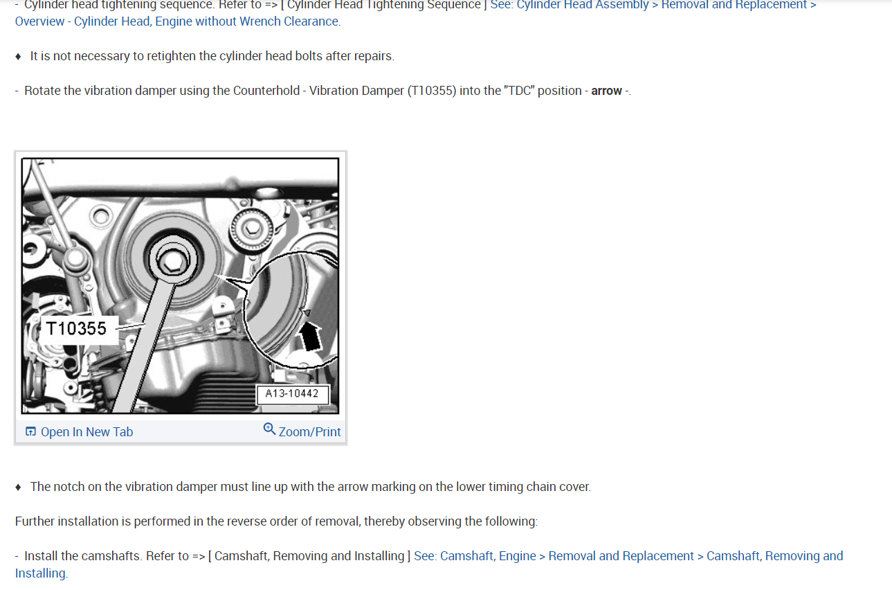

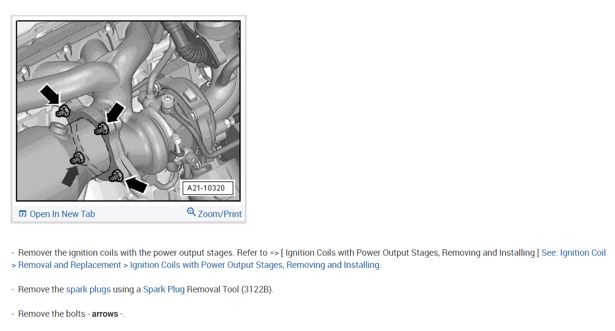

Is it only has 100,000 on it I would start by removing the cylinder head to see if any of the valves are leaking, you can also find out more by having a leak down test done which puts pressure into the cylinder to see where it is going. A valve job may fix it. Here is how to remove the cylinder head in the diagrams below. Check out the diagrams (below). Let us know what happens and please upload pictures or videos of the problem.
