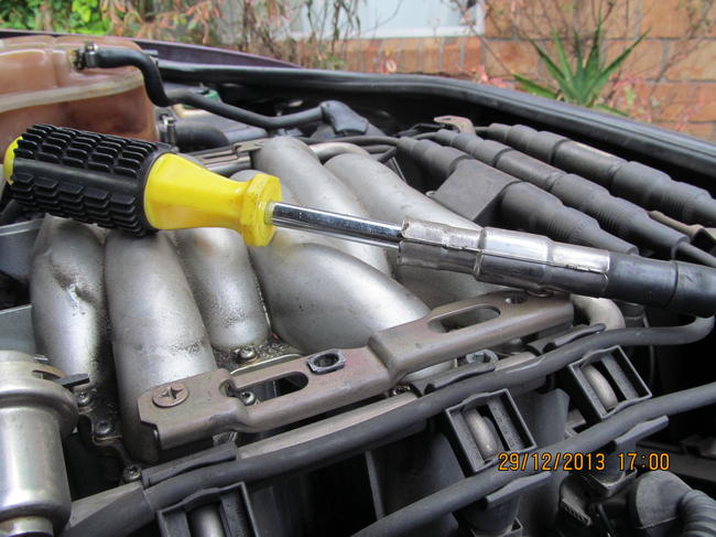

Hi Exovcds, I just checked for spark by putting a screw driver into the lead and placing next to the top inlets ontop of the motor and saw no spark see photo.

Do you have any code reader to read codes?Or a multi meter to do some testing?

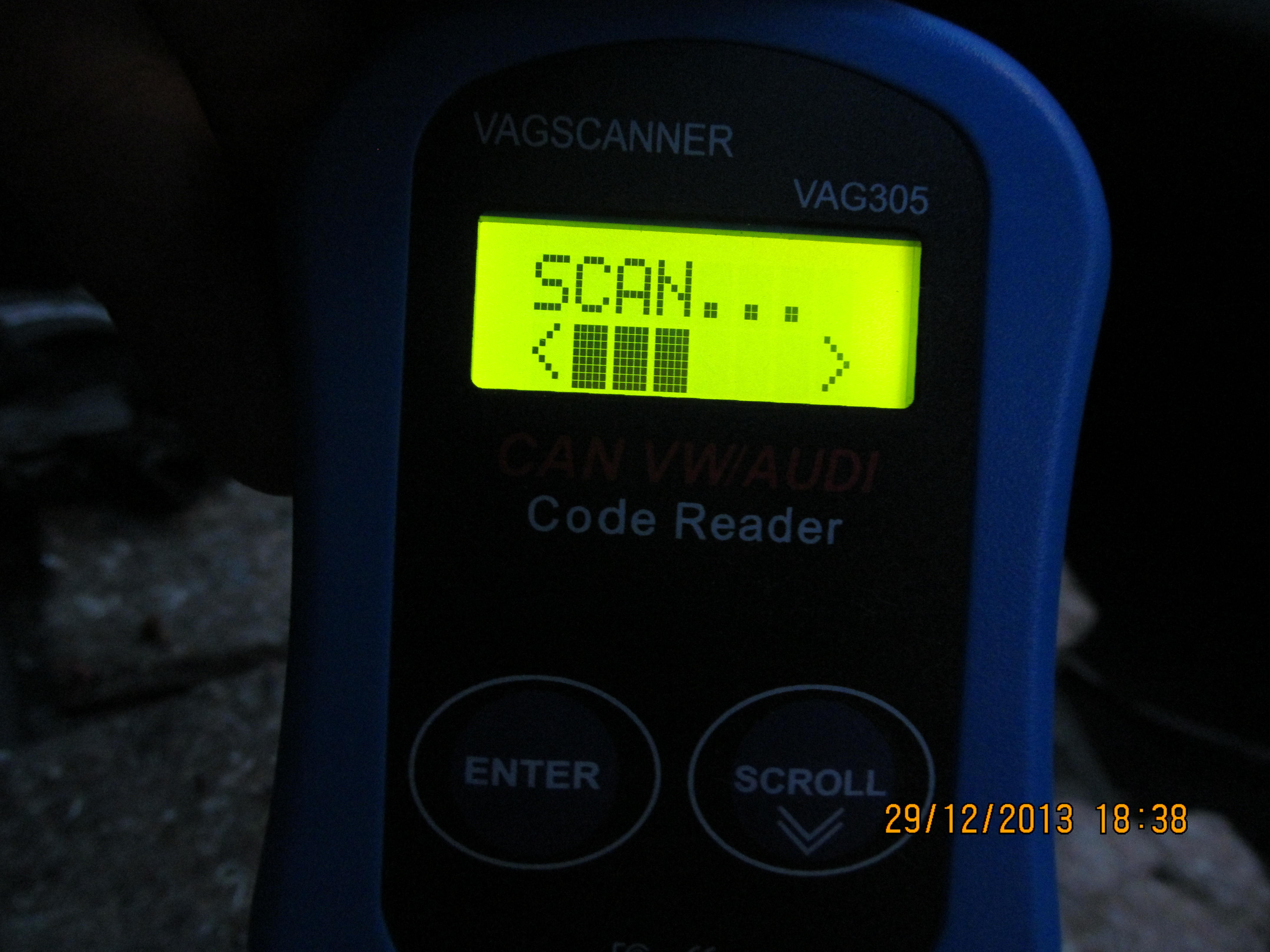

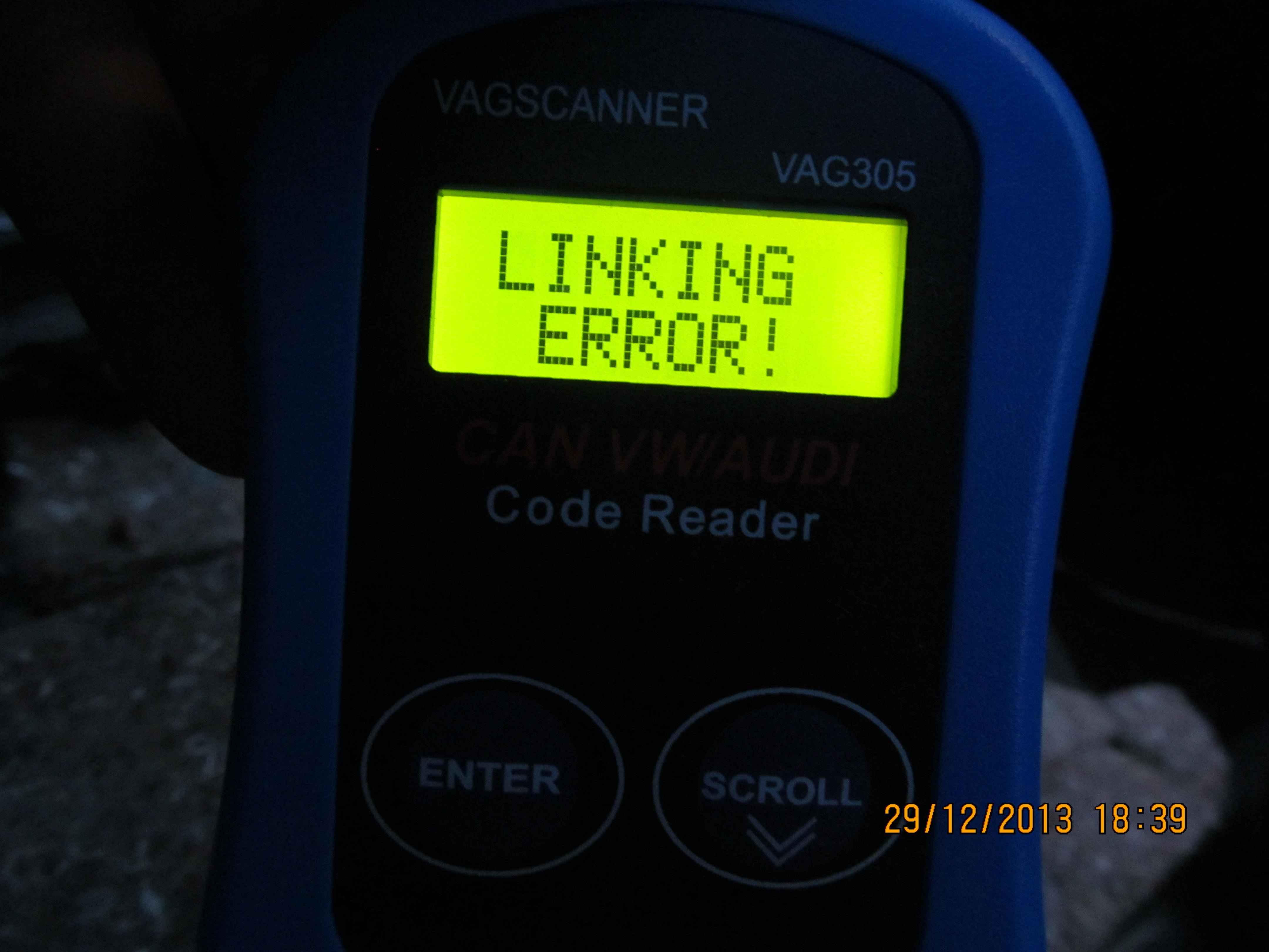

Hi Thomas, my reader will not connect keeps coming up with error can not connect ?
This in itself worries me that I may have a computer failure?

Hi Thomas, please see pictures of scan.

See if any of your fuses are blown if you have a blown fuse and there isnt power to the diagnostics link connector you will be unable to read codes like you have now.Have you tried sraring it with the code reader plugged in?

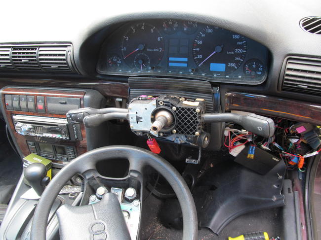

Hi Saturntech9 thank you for the assistance I have checked all fuses under the dash (see earlier pictures) and all seem ok! I even removed all relays and checked them all seem to be ok, is there a specific fuse that you may know that links the computer?, Thomas, sorry have been at work so unable to check ! will do today the checks you recomend.

Hi Saturntech9 I will check today! the scanner does have power as I do get the individual selections come up only when selected they do not connect? I will take some more pictures to show set up of wiring etc,I do have power to the ignition switch and I do have lights indicators and air-con fan, I don't have spark at plugs no power electric windows or sunroof.

I have no dash lights at all ? I only get the mileage to show up if I turn on the lights otherwise nothing is showing on the dash,
Jan 3, 2014 at 5:47 AM
SATURNTECH9
  • 30,869 POSTS
Have you checked all the fuses?Also why did you tear everything apart?The radio wires look like a mess.What happened there?I know with a aftermarket radio install on a volkswagon you have to be careful using a scan tool on the car.Not sure about the audis are like that.Hey thomas you can jump in anytime you work on these cars everyday.
Jan 3, 2014 at 6:28 AM
AUSSIEMICK63
  • 14 POSTS
Hi, that small black box with all the wires is a security alarm I was checking the fuses to it to make sure it had not mobilized the car, I have also checked the key barrel connector to make sure it was OK.I have checked every fuse and relay I could find but all seem good.

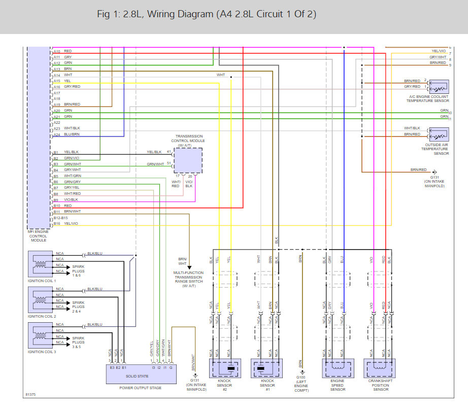

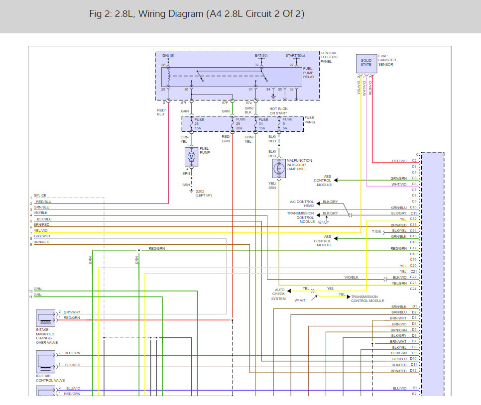

Hi Michael,

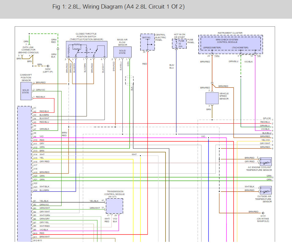

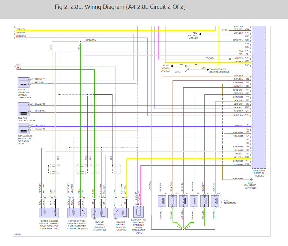

The closest wiring info I could find for your vehicle, is for the 2.8L AFC
engine... here is a PDF that includes ECM & Instrument cluster.
You will need to take some time and go through the pages to find all the
fuses that apply to the ECM & Instrument cluster, check those fuses and
replace those that are bad.
If all the fuses are OK, check the ignition switch.
I'm not sure how much different the wiring is on your right hand drive vehicle
and idealy you would want to source the correct one.
Fuse S5 (fuse 5) supplies power to the instrument cluster warning light. The
fuse gets power from the ignition switch.
The ignition switch has big red wires... they should have power all the time.
Ignition 15 circuit is the black wire (sw on page No. 1/10).
Thomas

Here is a guide to help you check the wiring and the engine and fuel injector wiring diagrams below.
