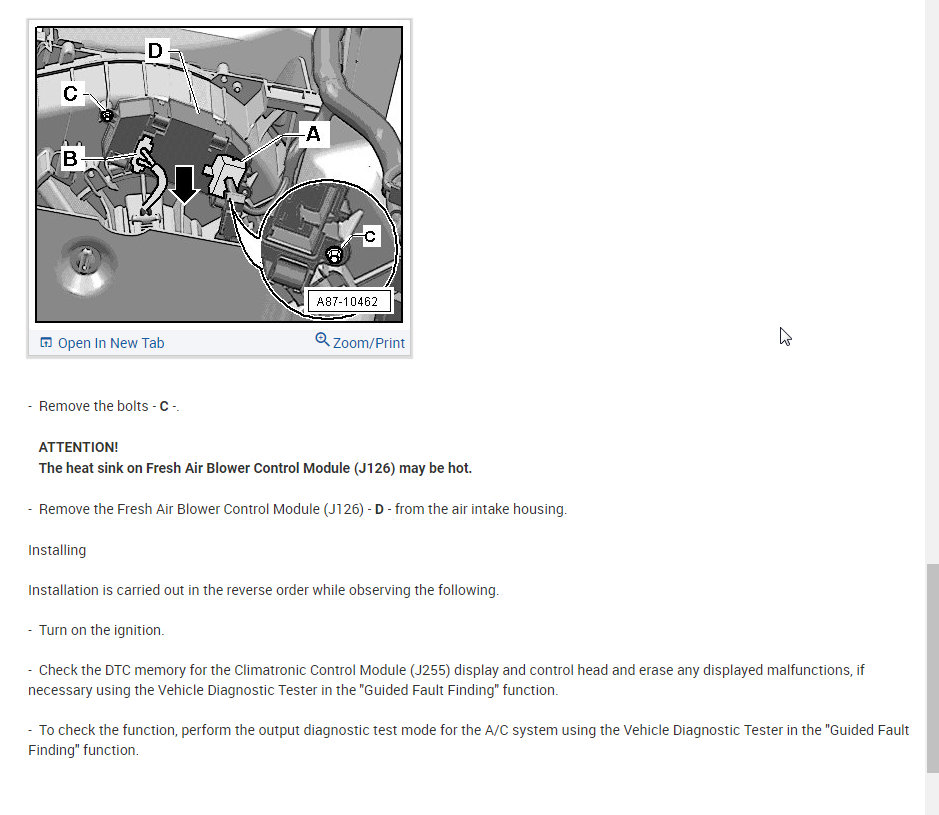

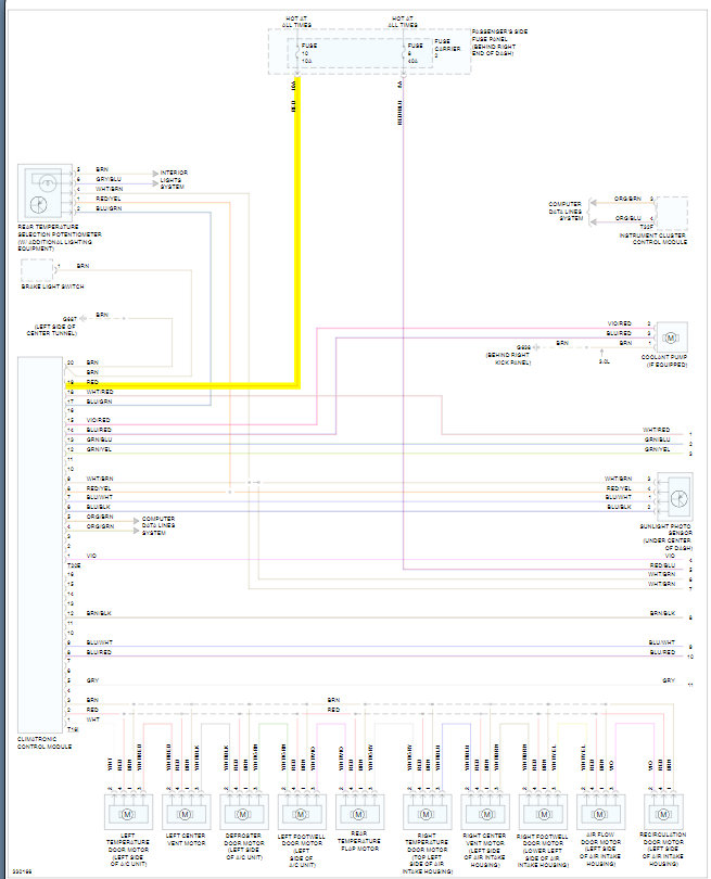

My climate control unit has no power, my radio works perfectly but the climate control compartment does not light up or has any problem going to it.. Help!
Apr 21, 2016 at 2:09 PM

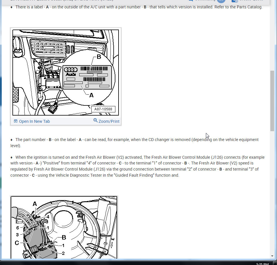

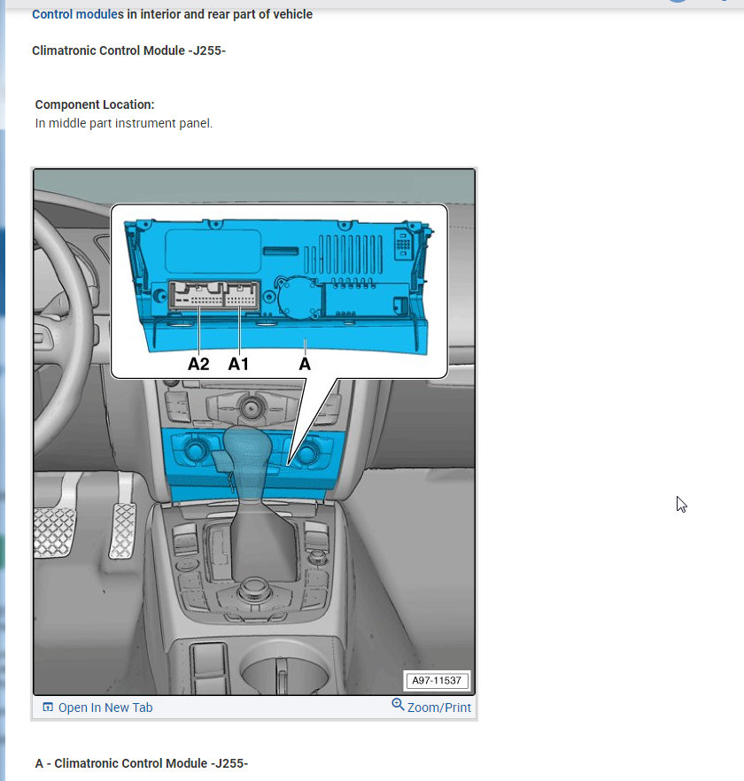

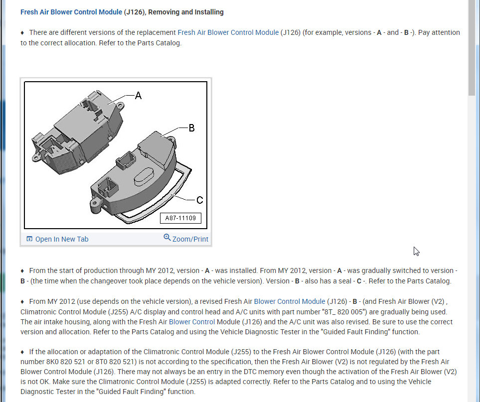

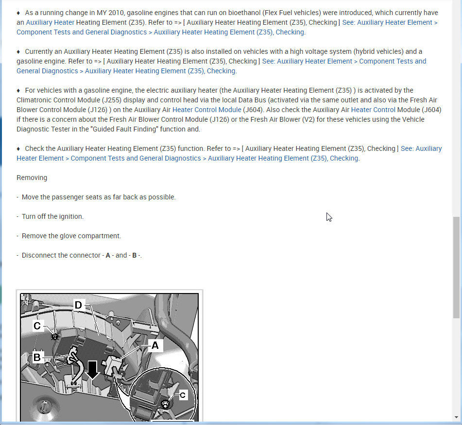

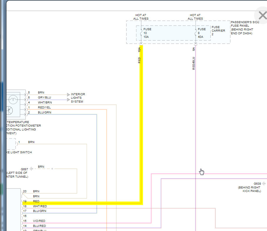

We need to start with checking fuse 10 on the passenger side fuse box. Just make sure there is power and if there is then you will most likely need to replace the Climatic control module.
I attached the process below and other info below on how to do this. Let us know if you have questions and we can go from there. Thanks
