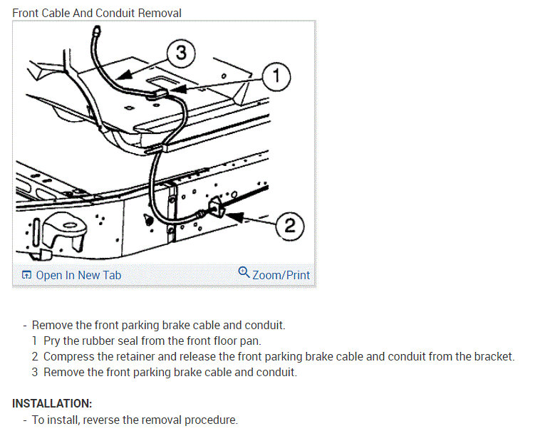

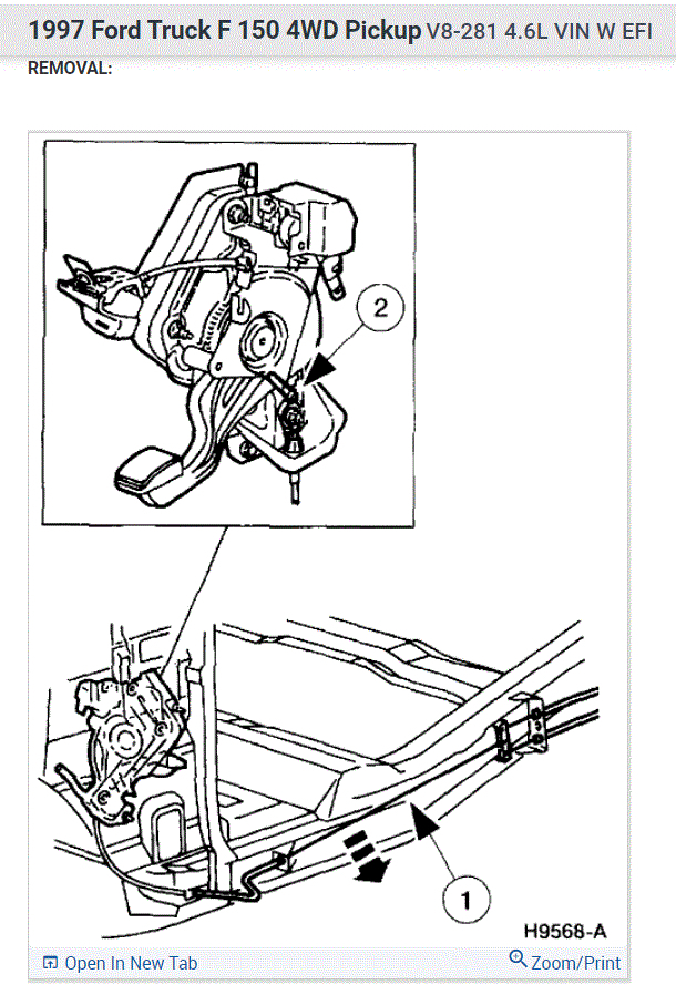

I have the truck listed above XL, Extended Cab. The front emergency brake cable broke a couple of weeks ago at the parking brake assembly. I removed the broken portion of the cable from the assembly, and removed the remaining part that run through the floorboard and to the equalizer. Talked to Ford parts got the part number based on the VIN and production date. It calls for a 95.6 inch cable. I have fished the cable around and secured the cable to the assembly and have ran it through the floorboard and connected the other end to the metal bracket on the frame. The cable seems to be about an inch or so short so I'm unable to connect it to the equalizer. I've changed the rear brake shoes and have made sure the star adjuster has been turned all of the way counterclockwise so as to provide enough slack in the cables that run from the rear brakes to the equalizer. I have made sure all of the slack has been pulled out of the cable running from the brake assembly.. still about an inch or so too short. The sheathing on the front cable is bowed, but since the sheathing stops at the cable bracket under the truck I can't pull any slack out of it. If I remove the entire cable from the bracket and attach the cable without it running through the bracket there is more that enough slack in the cable to connect to the equalizer, but it has to run through the bracket and it comes up about an inch short. Any advice? Sorry for the length and thanks for the help.
Aug 20, 2021 at 12:27 PM
  • 110,244 POSTS
I'm trying to picture what you are experiencing. If it reaches with it disconnected from the bracket, I'm not sure why it's short when it's attached. Is it possible for you to take a couple of pics of what is happening so I can see exactly what you are dealing with?
As far as replacement, you mentioned you adjusted the brake shoes, so I assume it has rear drum brakes. So, I attached the directions from the manual for replacing this cable. Interestingly, the directions show step-by-step removal and end with replacement is the reverse of removal.
Take a look through them to see if there is anything you could be missing.
I have one last question. They told you the length made a difference. That is true for the rear cables because of the different wheel bases., but the front is the same. Here is the original part number. F75Z2853AA
If you go to eBay and type Ford and then the part number, they are available.
Let me know if you have questions or if I can help in some way.
Aug 20, 2021 at 3:28 PM
SWILSON3828
  • 112 POSTS
Thanks for the reply. Yes, you are right about the length of the cable for the front. although, I believe, a couple of places list the length as being something like 95.13. but since that would be shorter it's irrelevant.

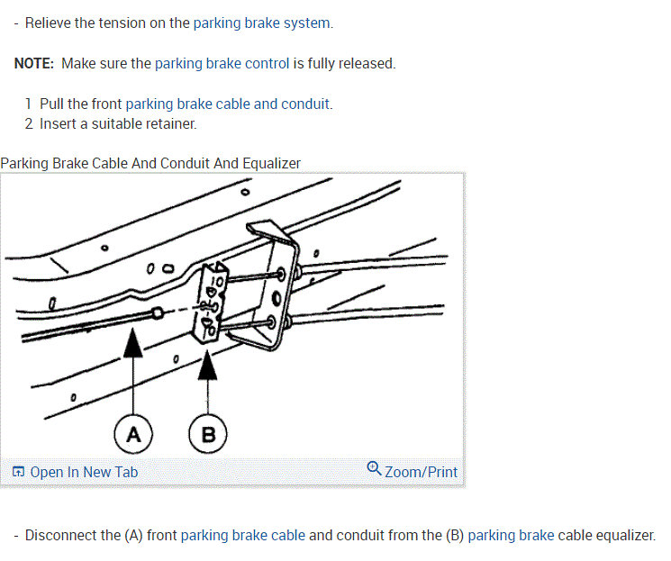

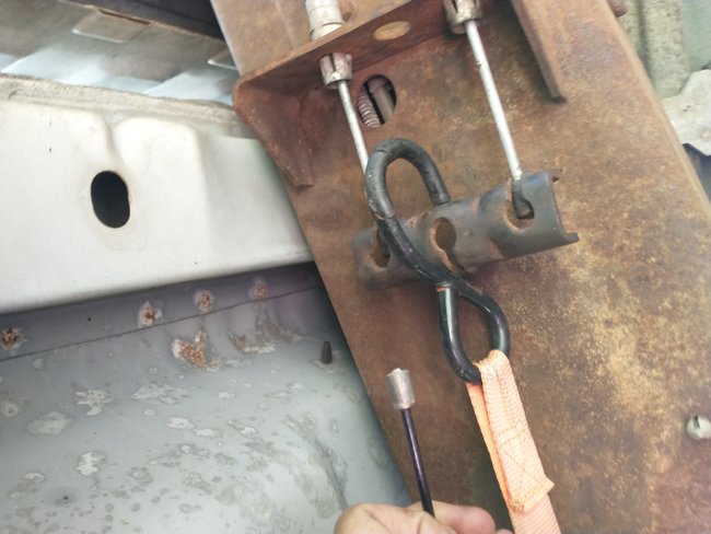

Anyway regarding the cable there is the cable that connects to the assembly and to the equalizer, and then there is the black rubber shroud that protects the middle part of the cable. That shroud has a push through fastener clip on each size, one to secure it at the hole on the assembly right there as it comes through the floor board and before it goes up and around the interior of the assembly. The other connects to the bracket welded onto the frame on the underside of the truck. Once that shroud is connected to the points you cannot move or slide it because the fastener clips keep it in place. Of course you're still able to move the cable back and forth through the shroud.
Once connected the shroud itself has a fairly decent bow in it but you can't pull the bow out if it because it's secured in place by the fasteners on either end. That bow takes up two or three inches of cable that can't be pulled out because the shield wont move and the cable, itself, is inside of the shroud. That's why when I remove the shroud from the fastener underneath I can pull the slack out of the bow in the shroud and the cable comes along with it, and that is where I get the extra length from the cable to be able to attach to the equalizer.
The best way to visualize what I'm saying is to take a string pull a few inches tight with both hands where there is no slack. (this would represent the shroud and cable disconnected from the underneath bracket and secured to the equalizer) and then move the right hands closer to the other. As you do that the string will lose tension in the middle and start to dip in the middle. That dip is similar to the dip in the shroud when it's secured to the bracket underneath. Since the cable is housed in the shroud the cable will follow the exact path of the shroud. That immovable portion of the shroud contains a couple inches of cable that can't be pulled tight. when I disconnect the shroud from the fastener I can pull the bow (slack) out of the shroud and since the cable is within the shroud that allows me to pull enough slack out of the cable to attach it. It seems to me that the shroud is an inch or two too long. A little bit of slack pulled out of the shroud would allow the actual cable to reach the equalizer.
I've heard of people using a ratchet strap to pull the equalizer the final inch or so, but the first time I did that the cable on the brake shoe side popped off of the holder where it connects to the emergency lever and I had to disassemble the brakes to get it back on.

I can picture everything you mentioned except the bow in the shroud. That doesn't sound right. Can you take a pic of it and upload it for me to see?

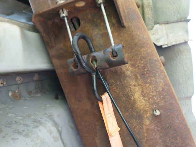

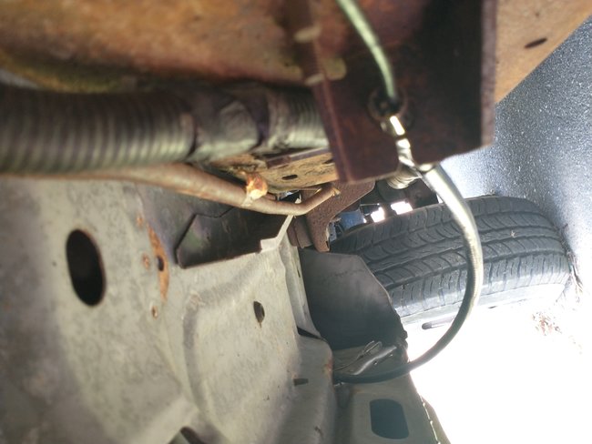

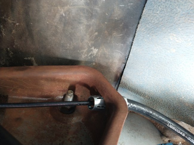

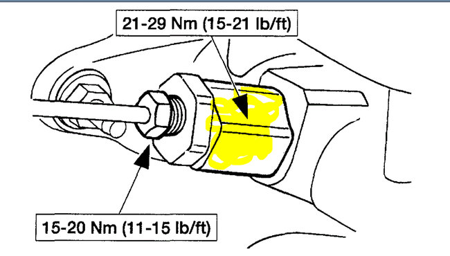

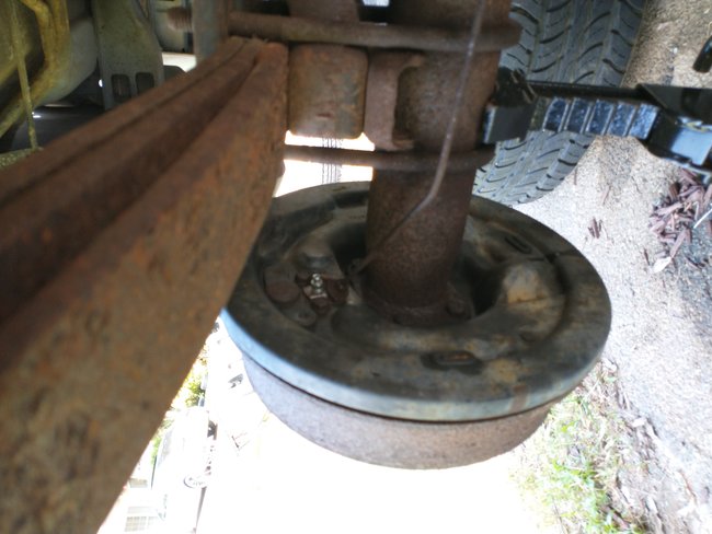

Sure thing. I've included a picture of the cable secured at the fastener on the assembly, a shot of the cable underneath with the bow while fastened to the bracket on the frame, a picture of how short the cable is to the equalizer, a picture of the cable disconnected from the underneath bracket, pulled tight, and secured to the equalizer. The pictures uploaded such that you'll have to flip the first two to the right once and the last three to the left once to get the proper angle. Sadly I wish now this was my only issue, lol. After replacing the rear brake shoes and bleeding the lines the brake pedal goes all the way to the floor and my ABS light is flashing. I'm guessing the brake booster has gone bad as the brakes should still operate without the ABS system working properly (at least I think lol).
The one thing I didn't do but will do tomorrow is adjust the star controllers on the the rear brakes. When replacing the brakes I screwed both of them all the way and when I replaced them I never adjusted them back out. I hope this is the reason for the spongy brake issue. Anyway, thanks for all of the help. You have a great site here and have helped me quite a bit in the past with other issues, things I likely wouldn't have figured out had it not been for your help, so thank you!
Aug 21, 2021 at 1:36 PM
  • 110,244 POSTS
Everything I see looks correct. The only thing I can think of is someone sold you the wrong part. What is the brand and part number of the cable they sold you? Does it cross to the part number I provided above?
As far as the brakes being spongy, that is because the rear brakes are totally out of adjustment. However, the pedal to the floor is another issue.
https://www.2carpros.com/articles/brake-pedal-goes-to-the-floor
Let me know the part number or if you already cross-referenced the number.

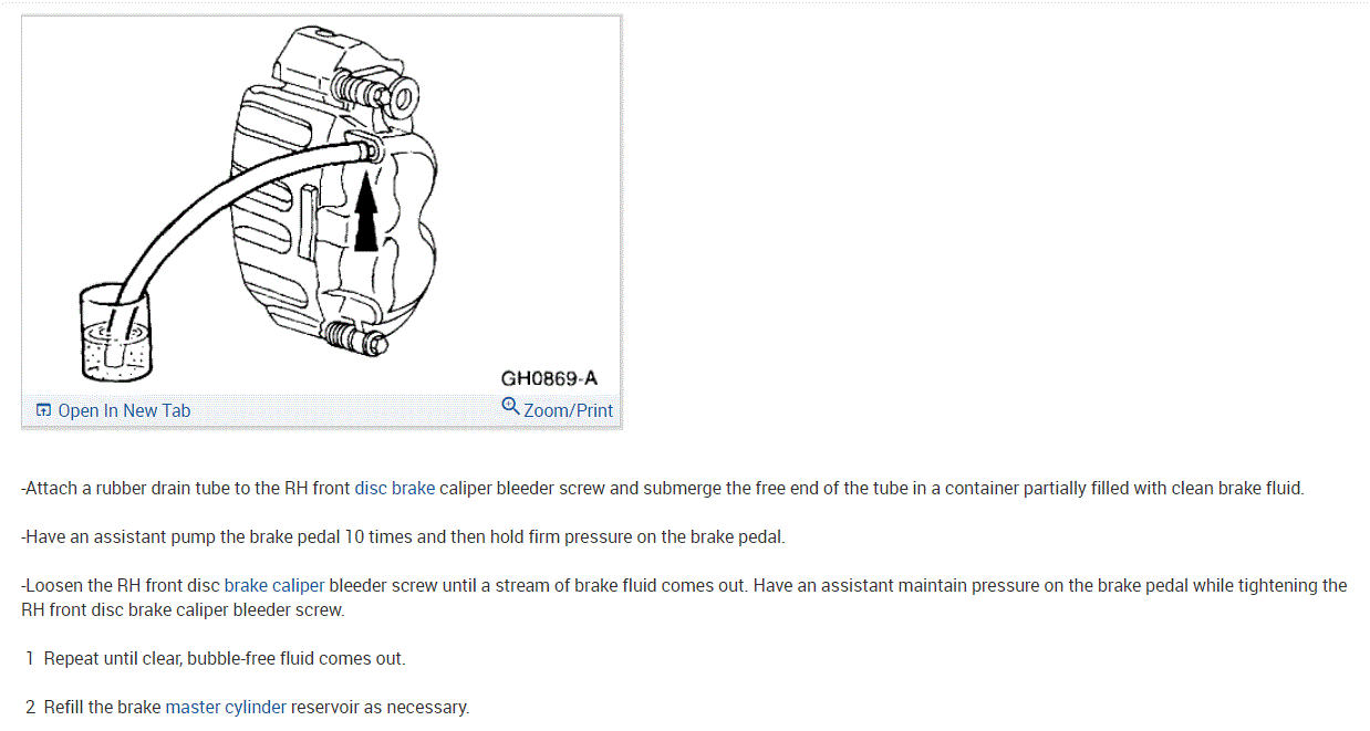

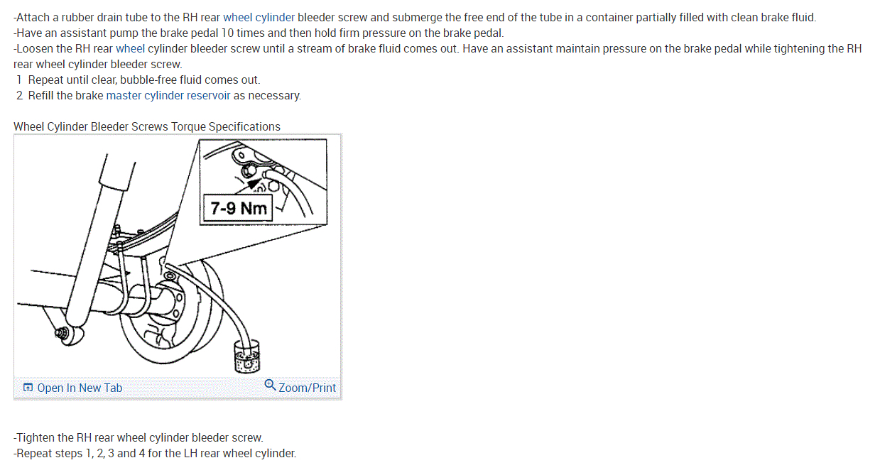

I attached the directions for bleeding the system. Take a look through them and let me know if that is how it was done.
Also, let me know if you have 4 wheel ABS (if I recall, that is only 4 wheel disc systems), if you have only rear ABS, or no ABS.

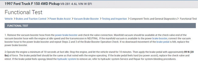

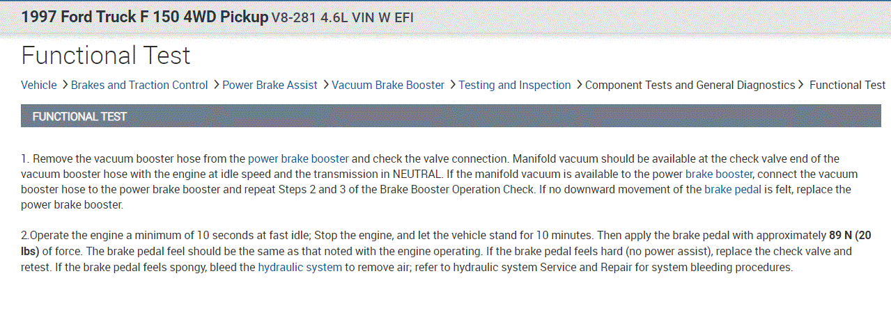

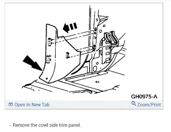

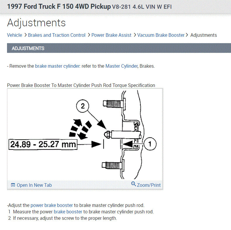

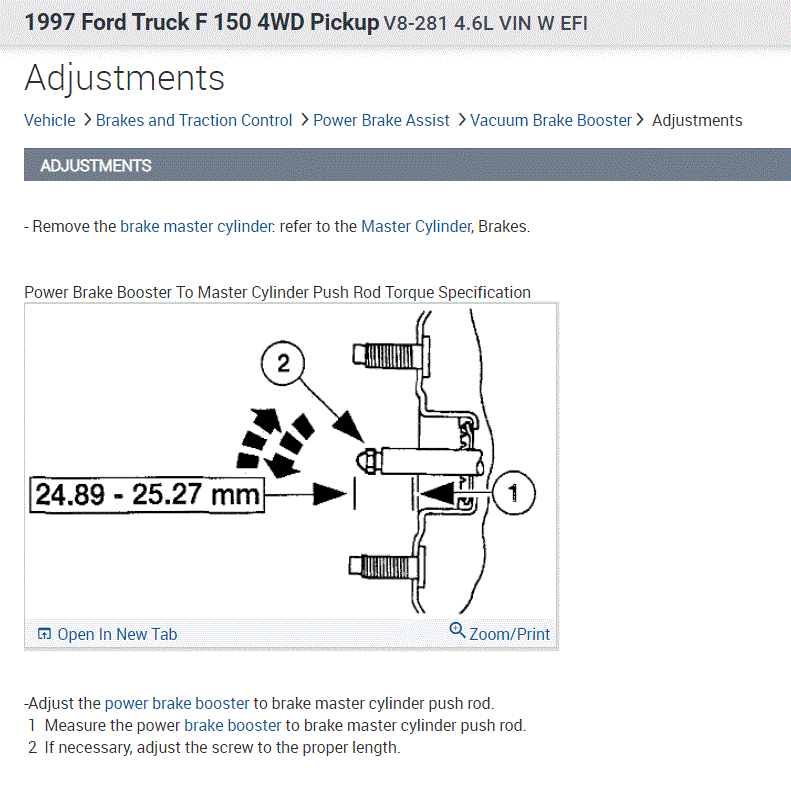

I attached a pic below that explains how to test the brake booster. I don't think that is the issue, but anything is possible. See pic 1.
Also, pic 2 explains how to adjust the push-rod between the booster and the master cylinder. That could be off as well.
Let me know about the ABS and if you checked the adjustment.

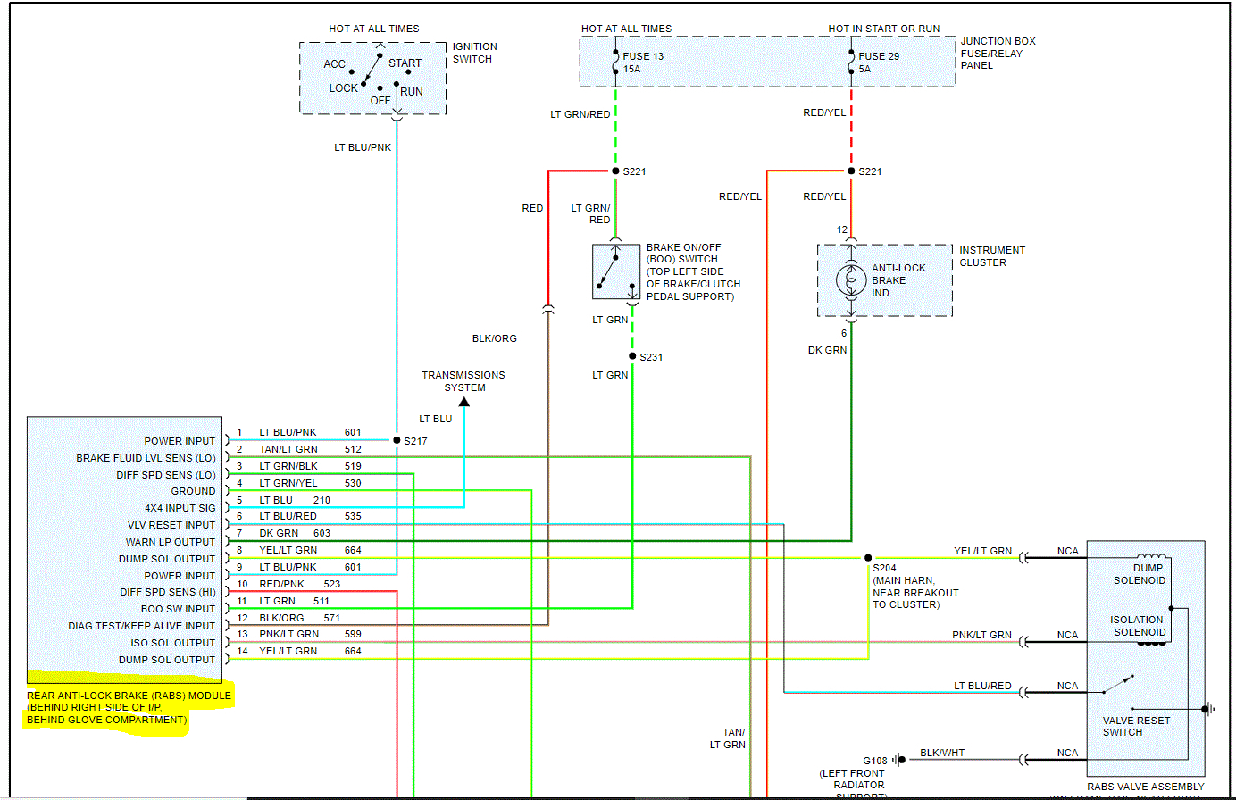

Sorry, thought I had mentioned with was rear wheel ABS. I think 4 wheel ABS was an option on this truck and 4 wheel ABS the standard must have been in one of those replies that didn't post. The adjustment of the booster rod.. I honestly had no idea they were adjustable, but truth be told the ease of pressing the brake pedal to the floor now is the exact same as it was prior to replacing the master cylinder. Not sure how I would have gotten air in the ABS only changing out the rear cylinders but I guess it is possible. I've actually specifically looked for the ABS module but couldn't find it. I thought it was under the air filter housing but it wasn't, and then I thought it might be mounted in the rear and it wasn't lol. I don't know where that module is unless it's directly under the master cylinder. There was a bracket holding some sort of device onto the bolts that the master cylinder is attached to the BB with. Two screws holding the master cylinder onto the BB and then two screws on top of these holding that bracket on.
Aug 24, 2021 at 1:06 PM
  • 110,244 POSTS

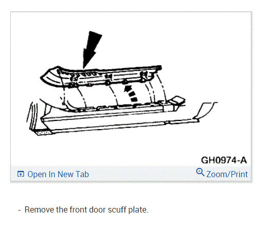

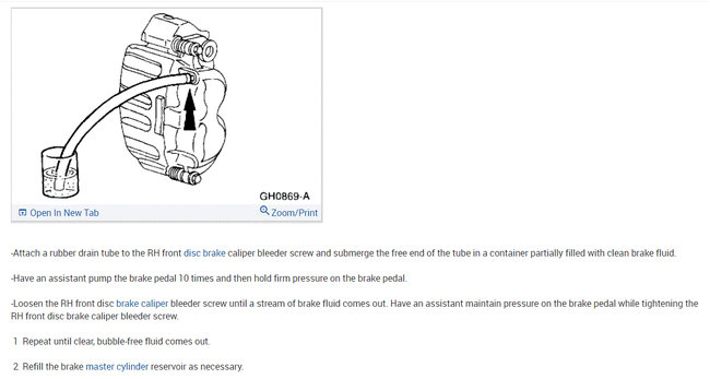

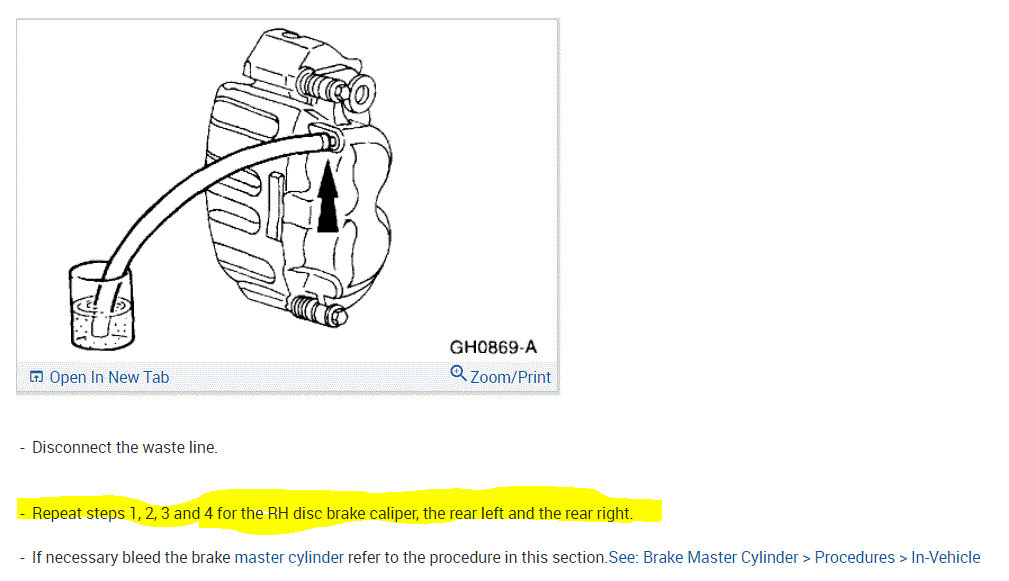

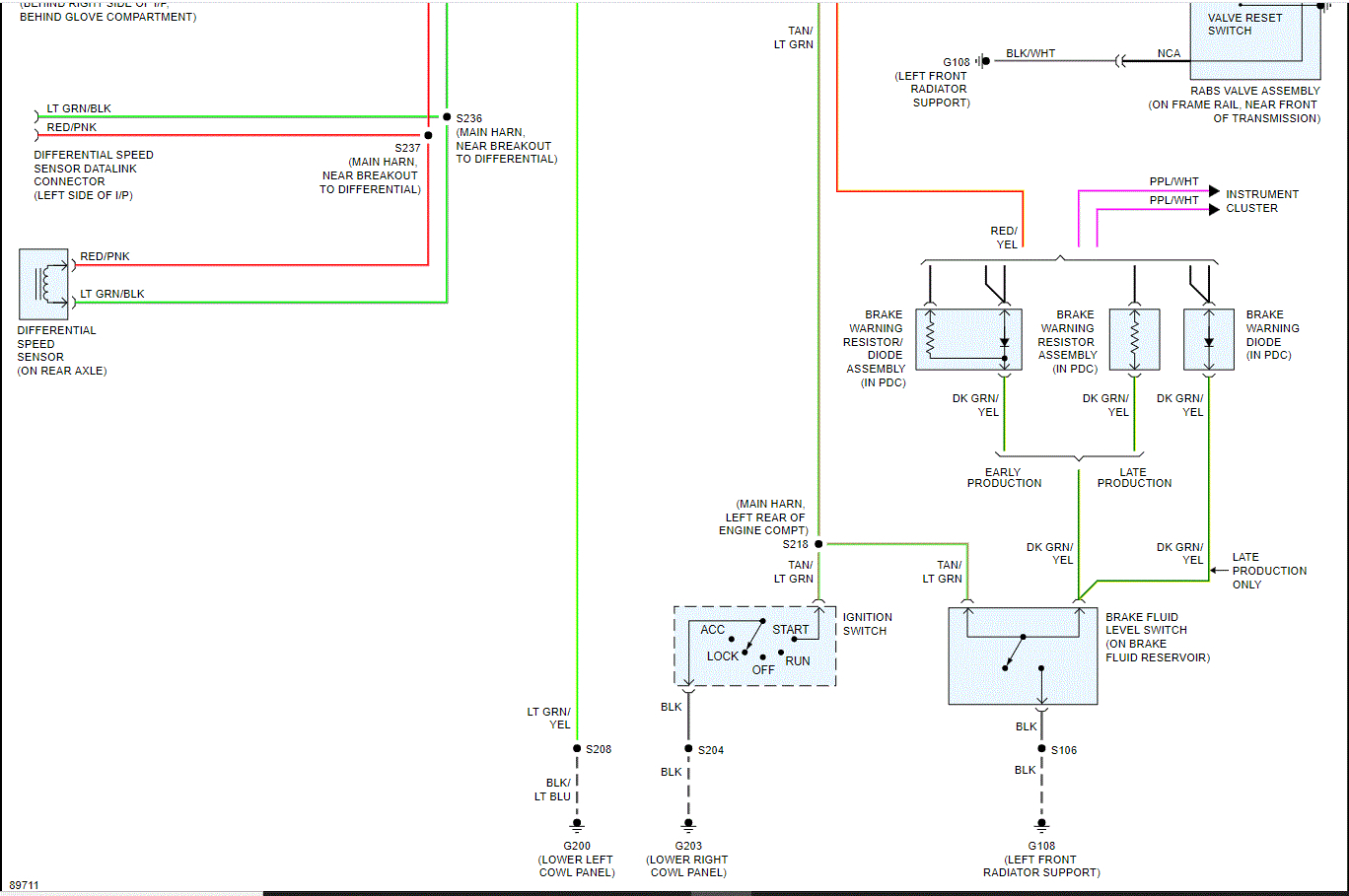

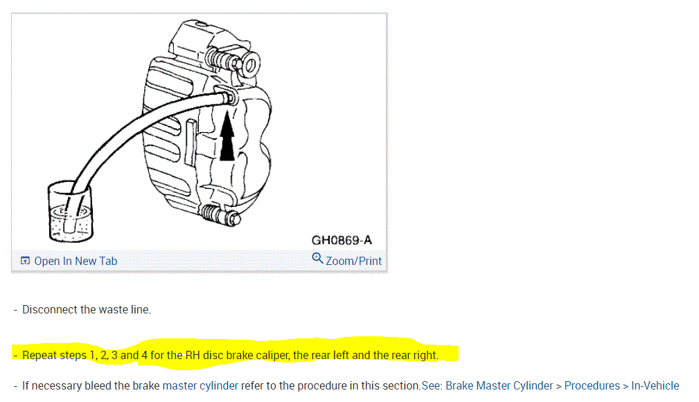

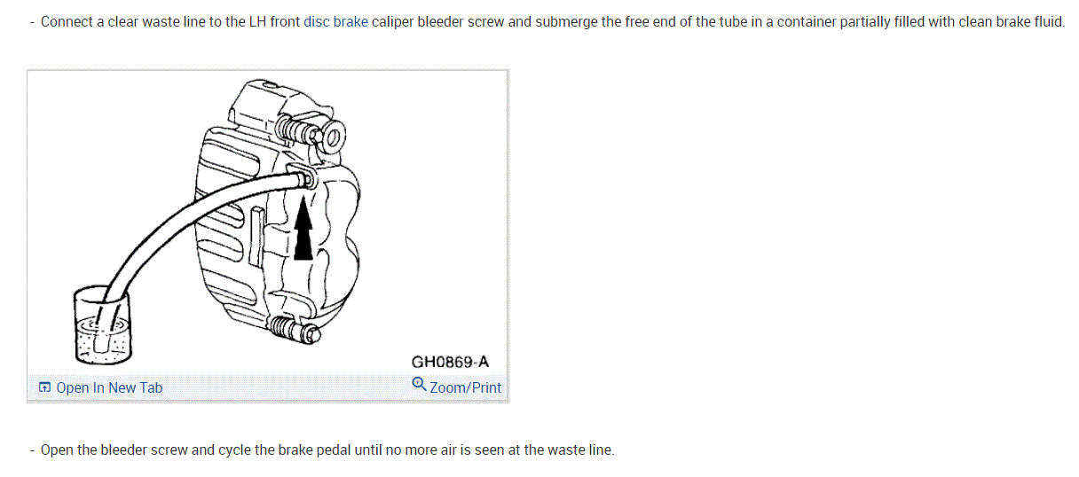

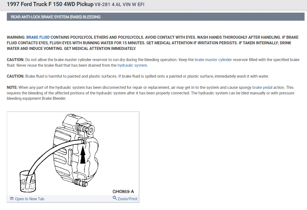

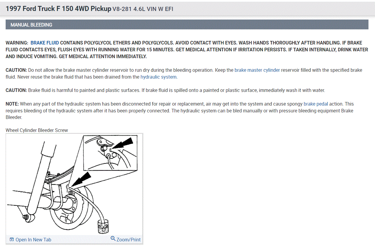

The module for rear-wheel ABS is behind the glove box. If you look at the attached pics, I included the wiring schematic for this system. I had to cut the pic in half to make them readable. I did overlap them so you can follow from one to the next.
The remaining pics are the bleeding procedure for this system. Interestingly, it is in the reverse order (LF, RF, LR, RR). Take a look through them.
Let me know if this helps.

Thank you. This is interesting. I read somewhere that the bleeding procedure was done opposite of normal if the ABS module was mounted in the rear lol. I'm guessing it was a misprint of some sort and that it was meant to say rear ABS system.
So all I have to do is bleed the brakes opposite of how I've been doing it and it will get the air out of the ABS? No scanner to activate the ABS is needed? I'll definitely give it a shot and let you know how things turn out. Hopefully this solves the issue. Thanks again and take care.

To add, regarding testing the BB. It mentions a repeating of steps 2 and 3, but I'm not sure what the third step is. Also, it mentions idling the engine high RPM for 10 seconds, turn engine off and let sit for 10 minutes and then press pedal and it should feel the same as it does with the engine running. I'm assuming these testing instructions are based on the ABS working properly, is that correct? Reason being is that I already know the pedal goes to the floor when running, but firms up when off. The BB check valve.. I disconnected it from the booster, and drew a suction on it. It allowed air to be sucked in, but wouldn't let any air exhaust from it, so I'm guessing the CV is good.

Okay, so I followed the instructions for bleeding the brakes for ABS of my truck. I have to ask how much brake fluid can go in a vehicle because each front brake bubbled and bubbled and bubbled some more... almost such that I'm thinking air may have been seeping into the tube from where it was attached to the bleeder screw. In any event after bleeding the front calipers I started the truck to see if I would get any resistance. Still goes right to the floor. No difference whatsoever. Being that each front caliper if fed from a separate line, and the rear two wheels are fed from a third line I would have def thought I would have felt some resistance in the pedal. Just to verify; when bleeding the brakes I cycle the brakes continuously until bubbles disappear. I'm taking that means with the engine off and with the cap.in the master cylinder open a bit. I attach the hose to the bleeder screw, put the other end into a jar half filled with brake fluid, open the bleeder screw and pump the brakes slowly and continuously until there are no more bubbles, and then repeat for each wheel? Thanks

What you described is correct. When you replaced the brake hose, did you remove the caliper or replace it? Is the bleeder on the top of the caliper or toward the bottom?
Also, did the excessive amount of air come out even though it was already bleed or did you open the system again?
As far as the bleeding, close the master cylinder when doing it. Also, do it with the engine off.
Let me know about the caliper. If the adjustment of the booster push rod isn't an issue and there are no leaks, there has to be air or another bad master cylinder. The system is sealed and hydraulic. If there is no air in it, the fluid has to push the calipers and wheel cylinders to work. If that isn't happening, we may need to open the primary brake line (for front brakes) at the master cylinder and see if there is enough pressure to push your finger off the opening.
When you installed the new master cylinder, you did bench bleed it first, correct?

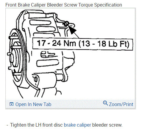

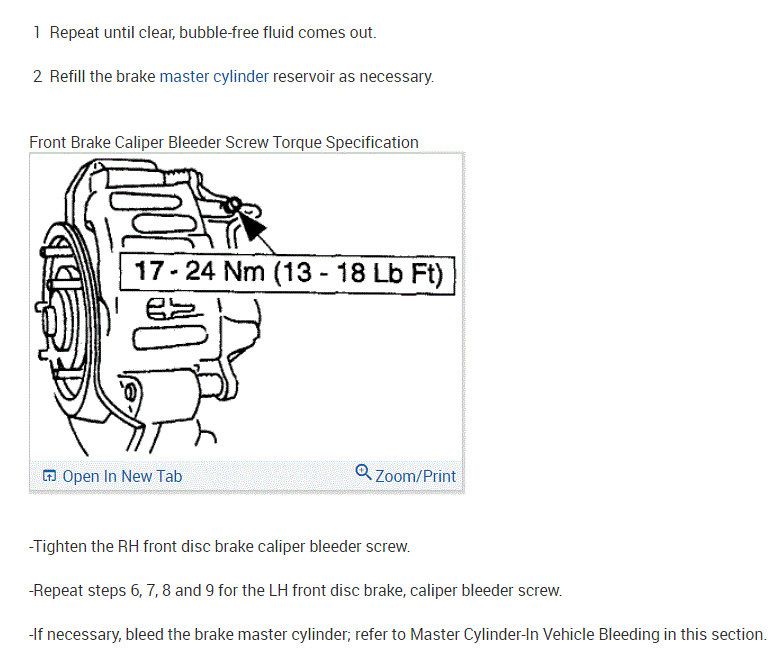

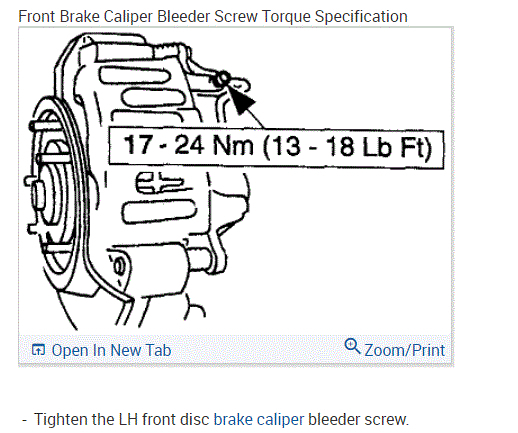

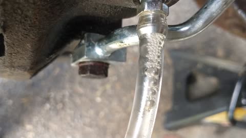

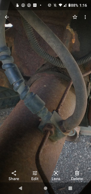

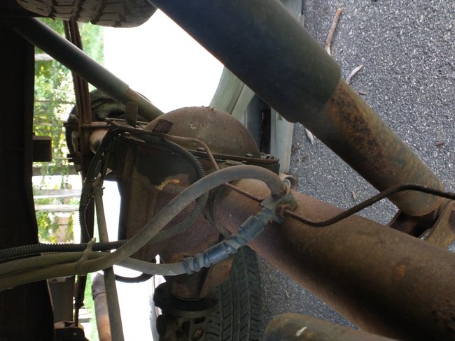

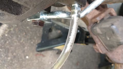

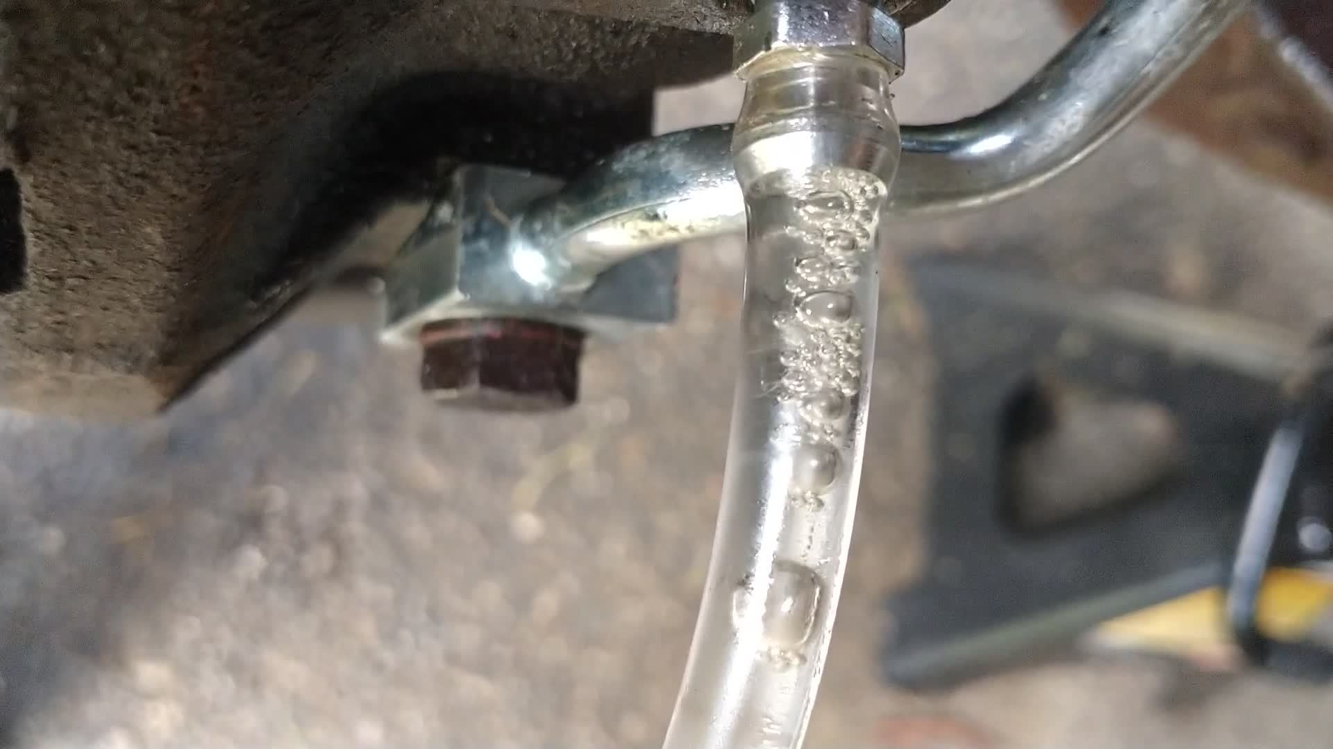

Hi Joe. Just to keep you up to date. Today I replaced the bleeder screws on both front calipers because they had become rounded. I did make sure the pedal was pressed to the floor before replacing the screws.
That being said I've attempted again to bleed the front brakes and all that happens is what you will see in the video I've included. I continually topped the master cylinder off with close to 24 ounces of DOT3 before I tightened the bleeder screw. 24 ounces is enough to fill the entire line plus some, yet all it did for 20 minutes straight is what you see in the video. I did, once again check for leaks and couldn't find any. I just cannot comprehend any way that much air could be in that one line.

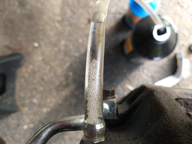

Aug 26, 2021 at 7:17 AM
SWILSON3828
  • 112 POSTS
Sorry, not sure why that video I initially uploaded is playing like it is. Here is a better video for you:
Aug 26, 2021 at 7:38 AM
SWILSON3828
  • 112 POSTS

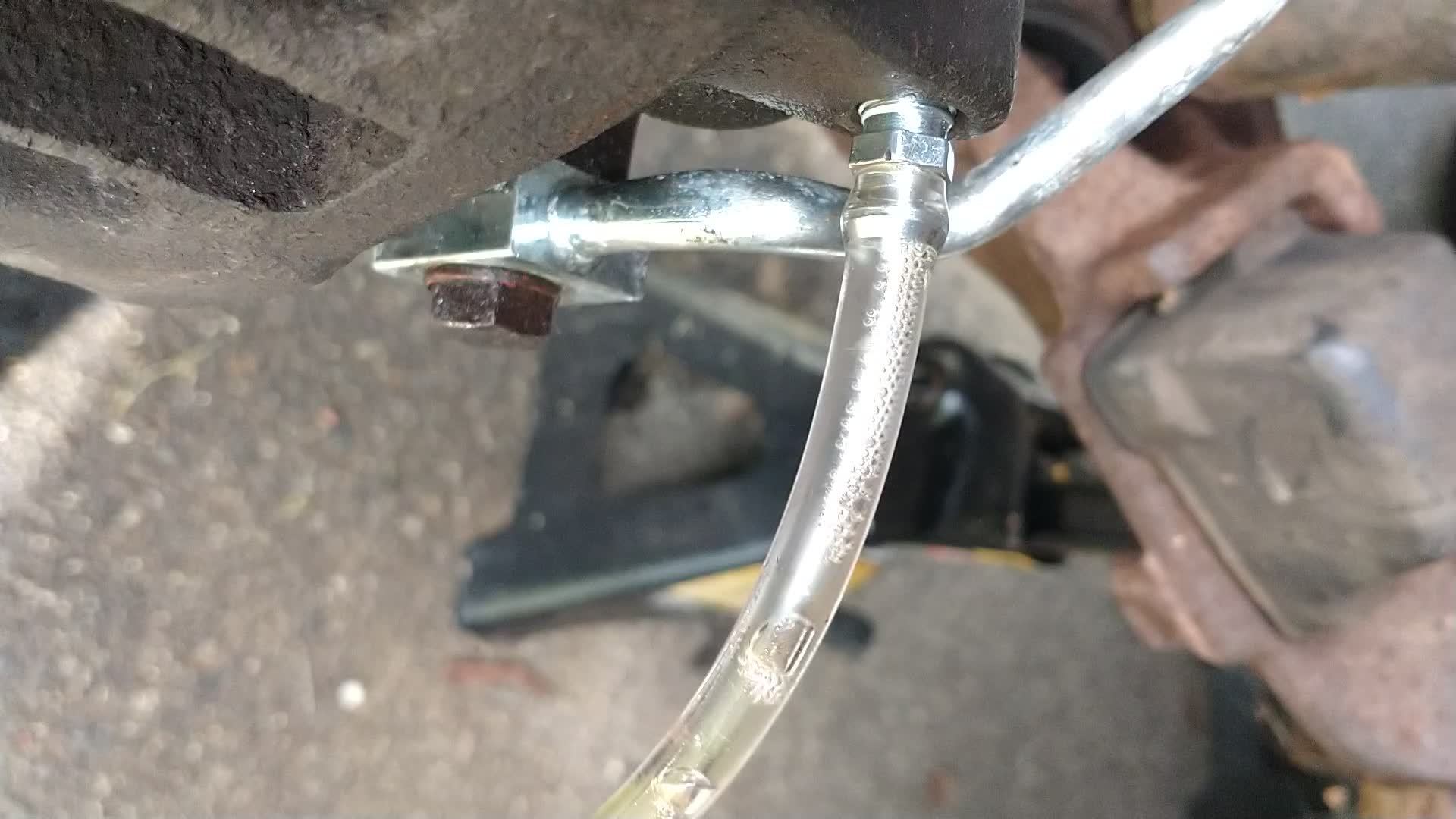

Here is a picture since the videos aren't showing properly:
Aug 26, 2021 at 7:51 AM
SWILSON3828
  • 112 POSTS
Sorry man for all of the messages. Just trying to keep you up to date on what is going on. Okay, so I removed the front two calipers today. On the drivers side only one of the two cylinders in the caliper pushed out, the other remained stuck in place and didn't move, and on the passenger side both valves barely moved, so obviously the driver side caliper needs to be replaced. Not sure if that would be the issue because it seems to me if a caliper was bad it would be leaking. Is there any check valve anywhere that might would let abnormally high pressure off of a braking system? I know there is one on the BB. Thanks yet again.
Aug 26, 2021 at 10:17 AM
  • 110,244 POSTS
It doesn't have to leak to be bad. It sounds like it is though. Also, what do you mean by both valves barely moved? Do you mean the caliper pistons? If they are barely moving, it sounds like either it is bad or there isn't enough pressure.
Let me know that. Also, can you get a helper. We are going to try bleeding in a different way and you need someone to help. Take a look through this link. It requires a scan tool that to open the valves on the ABS. If you can't do that, try the bleeding procedure indicated. Basically, with the engine off, pump the brake pedal to get a good pedal. While holding pressure on it, have the helper open the bleeder until the brake pedal hits the floor. Before releasing the pedal, have the helper close the bleeder. Do that until no air comes out.
Also, I spoke with the site owner regarding your truck. He also indicated a bad hub bearing can allow movement in the rotor. When you release the brake, it can actually push the pistons back in causing the pedal to go to the floor again. See if you can see anything.
He also suggested providing this link for you. Take a look through it and see if anything helps.
https://www.2carpros.com/articles/how-to-bleed-or-flush-a-car-brake-system

Thanks for the info. I can do everything you mention, but have no ability to bleed the ABS module with a scan tool. Do you have an idea of what might be a good but inexpensive scan tool that would allow me to do such? Also, I've looked for the ABS unit. I know you mentioned that it was behind the glove box but I cannot locate it. I see what I figure is the ECM, but I see nothing with brake lines coming off of it, unless the ABS module and the actual hydraulic portion of the ABS are at separate locations. I guess I'm simply going to go through the system again in addition to replacing one or both front calipers. Also, yes I was referring to the pistons in the calipers when I mentioned about the left one only having one piston working and the other stuck, and the right with both pistons barely moving. Didn't see any issues with the hub. No vibration in either as far as I could tell. I do know this whole mess started when I replaced the rear wheel cylinders and brakes shoes. Should have just left it as is and not messed with it. Thanks

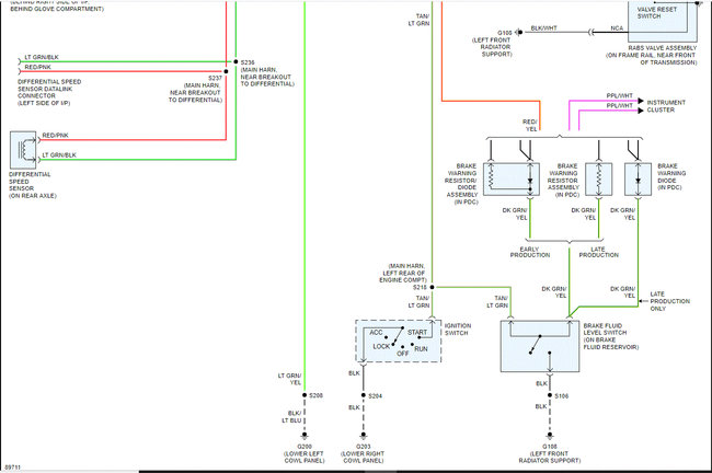

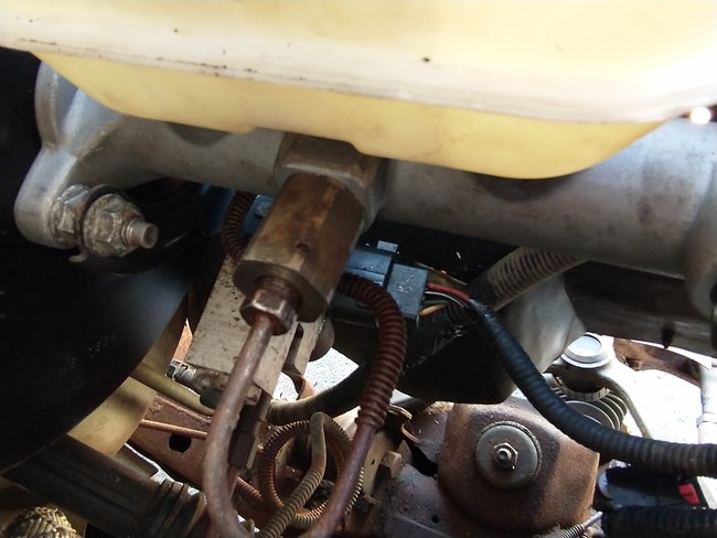

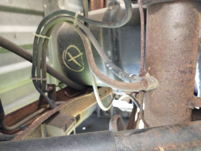

Also, I know you said the ABS module for my truck is behind the glove box, but I can tell you I've looked and looked and looked some more and do not see any type of brake line coming from anywhere other than the master cylinder and the contraption underneath it that I mentioned in the previous message. I have searched the entire vehicle for the brake lines coming off the ABS pump and I see none anywhere. Noe under the hood, and none underneath the truck in the front or back. Now I do know that this was a wrecked vehicle when I bought it in 1998 so I'm not sure if there was anything changed on it or not because I've never needed to do anything with the brakes other than changing the pads and shoes. On none of the wheels is there an additional line going to the back of the wheel that you would normally see with ABS. The only lines are the brake lines going to the front wheels, and the brakes lines and parking brake cable going to both rear wheels. There is a contraption that is sitting to the left of the hogs head that has both rear brake lines running from it and what appears to be electrical connections coming from it, so this may be associated with the rear ABS, but I'm not certain. I do know the ABS light is flashing rapidly, but that could be because there is an issue with the braking system itself, and there have been a couple of times where I've brakes a little hard and felt what feels like the abs kicking in. Not sure if it being a 4WD manual trans has any bearing on the issue. I've included a two pics to explain what I'm talking about. Thanks
Aug 28, 2021 at 3:23 AM
SWILSON3828
  • 112 POSTS

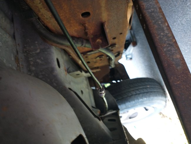

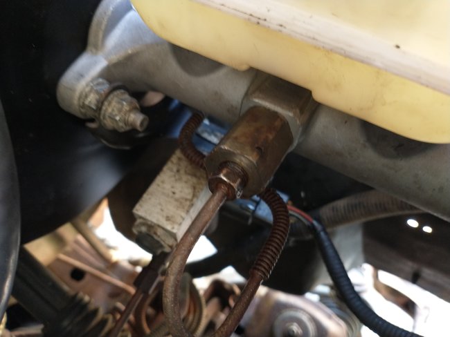

Also wanted to include these images of the master cylinder, along with the contraption underneath it.
Aug 28, 2021 at 5:04 AM
SWILSON3828
  • 112 POSTS
Good evening. Well, I finally have driving brakes. Still have a broken emergency brake, so that is the next project. In any event I did go ahead and replace the booster and re bled the lines afterwards and I finally got brakes. Not sure whether it was some fluke problem with the BB, or it just needed one more bleed. The BB was in bad shape as the springs and the like where the rod goes from the pedal into the BB was all rusted and corroded, and the protective boot was gone. The extra bleed had a tiny bit of air on one line but overall it appeared the lines were in pretty good shape. Now as far as the ABS working I don't know, but I do know the flashing ABS light went off and is no longer flashing. Now if I can get the emergency brake replaced I think everything will be in good shape. I do have another emergency brake cable that I ordered before I realized my driving brakes were gone, so I guess Ill attempt to fix that tomorrow. I appreciate all of the advice and help with these issues. I'll be back in touch to let you know how the emergency brake replacement goes. Thanks again and take care.

I have no clue how or why it started working other than I adjusted the BB shaft out just a hair and that little bit of difference may have pushed the valves in the MC just enough to get a tiny bit of air out that was trapped in the MC itself because a tiny bit of air did expel on that last bleeding. That's the only thing I can think of other than some crazy leak in the BB somewhere.
Aug 28, 2021 at 4:10 PM
  • 110,244 POSTS
That shaft could have been the problem. Regardless, I'm glad it's working.

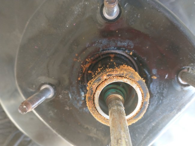

Thought I would share this photo with you of the old BB.
Aug 30, 2021 at 11:48 AM
  • 110,244 POSTS
That doesn't look too healthy. LOL Did you have any issues replacing it?
Aug 30, 2021 at 1:35 PM
SWILSON3828
  • 112 POSTS
Haha. a ring of pure rust that looked like a huge washer fell off when I pulled it out, but no, no problems replacing it at all. A very easy repair.

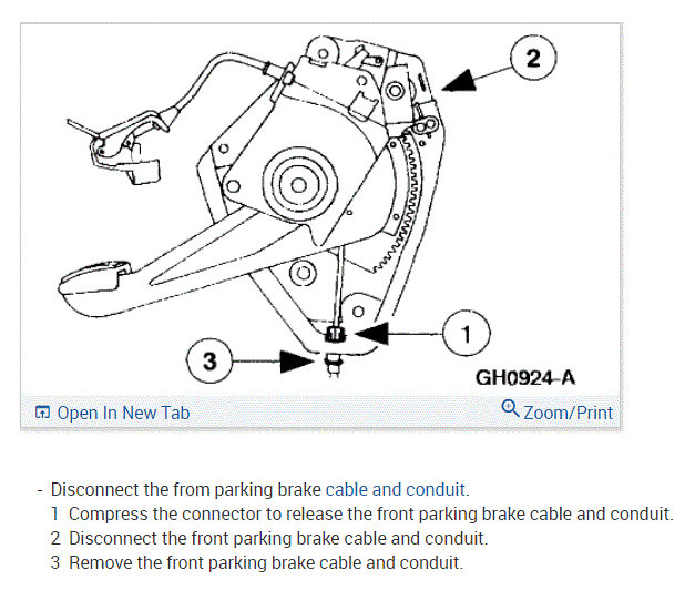

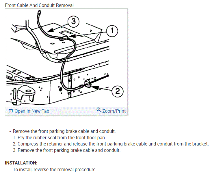

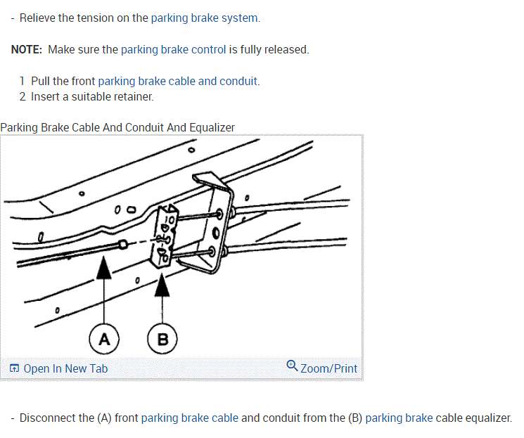

Now, as far as the parking brake cable goes. I'd hoped the first cable was just a wrong part sold by accident, but the new cable I just got is identical in length as far as the cable and the shroud are concerned. Not exactly sure how it make it fit as there really isn't anything different I would or could do compared to the first time. I'd hoped the new cable would be about an inch longer, but no luck.
Sep 2, 2021 at 10:04 AM
  • 110,244 POSTS
By any chance, have you confirmed that the part number of the product crosses to the OEM part number I provided? Also, is it the same brand as the first one?
