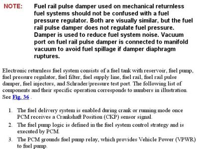

SERVICE WRITER
  • 9,123 POSTS
HAve you checked the fuel pressure?
https://www.2carpros.com/forum/automotive_pictures/30961_explfu_1.jpg
IF there is too much pressure the regulator may be bad.
https://www.2carpros.com/forum/automotive_pictures/30961_exp33_1.jpg
https://www.2carpros.com/forum/automotive_pictures/30961_exp34_1.jpg
https://www.2carpros.com/forum/automotive_pictures/30961_exp35_1.jpg
https://www.2carpros.com/forum/automotive_pictures/30961_exp36_1.jpg
https://www.2carpros.com/forum/automotive_pictures/30961_exp37_1.jpg
+1
