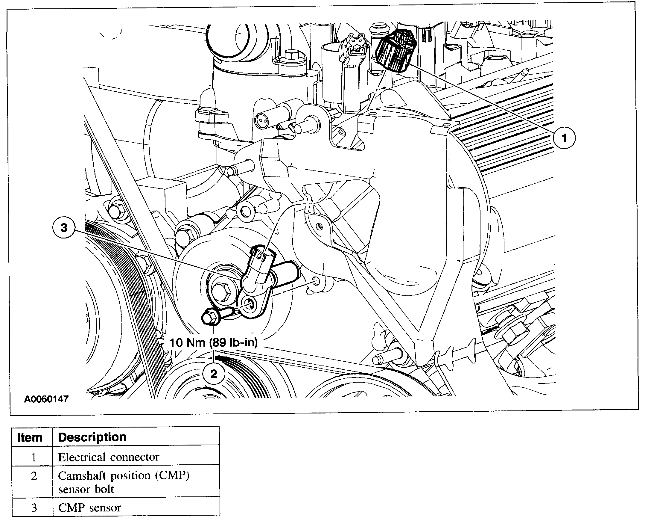

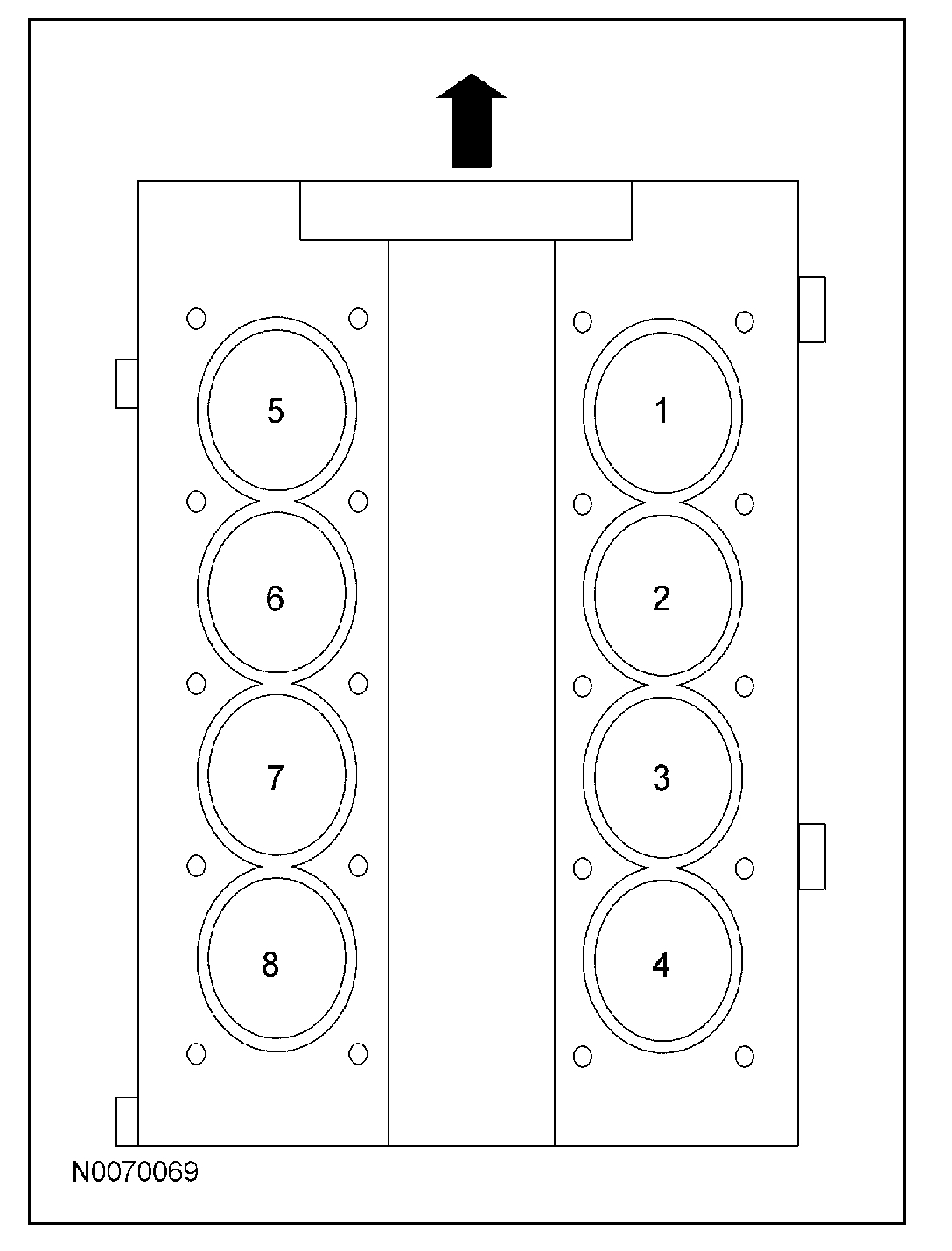

Not start. Crankshaft position sensor where is it located. Do I replace all the plugs coil etc? Don't know what to do. Any help would be great.

Based on the codes you provided, I feel the problem is related to the camshaft position sensor and not the crankshaft position sensor. The codes indicate a misfire on cylinder 6, a misfire within the first 1000 revolutions of the engine after starting and a camshaft sensor failure, which leads me to the P0340. That indicates a camshaft position failure bank 1. That will cause the misfire (p0306) and the P0316 to set.
With that, and I can't be 100% certain without being there, it seems the camshaft position sensor is causing all of the codes.
With that in mind, I would start with that sensor. Here are the directions for replacing it. The attached picture shows its location.
___________________________
CAMSHAFT POSITION (CMP) SENSOR
REMOVAL
1. Disconnect the battery ground cable.
2. Remove the components in the order indicated in the illustration and table.
INSTALLATION
1. To install, reverse the removal procedure.
____________________________
Now, on your vehicle has two sensors. You need to replace bank 1, which is on the side of the engine which has cylinder 1. If you are facing the engine from the front of the car, it will be the left side. I attached a picture of cylinder locations. The arrow points toward the front of the vehicle.
It will be located below the valve cover as indicated.

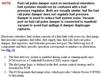

Can you shoot a quick video of what the engine is going when you try and start it? If you dont hear the fuel pump and don't have any spark at the plugs I would say it can be the crankshaft angle sensor which when they go out they will not set a code for the problem.
This guide will give you some possibilities to get us started.
Please run some tests and get back to us.

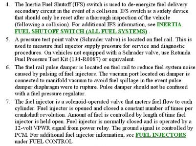

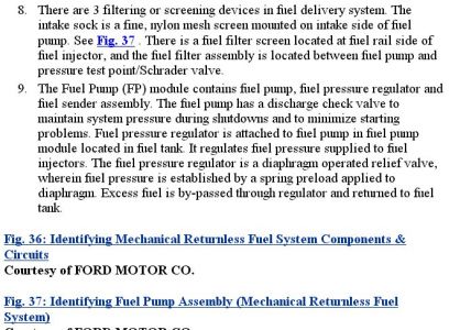

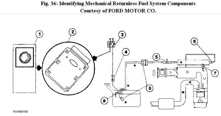

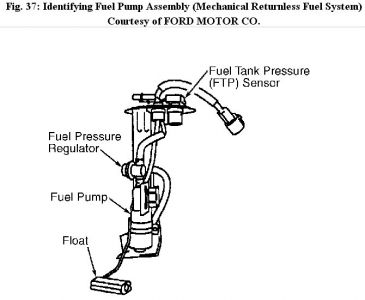

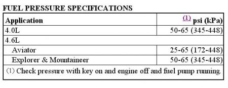

Hi, I have a 2003 Ford Explorer Eddie Bauer 4.0. Ever since recently the truck has been giving me a problem when starting up on cold days. After sitting over night, or sometimes after a temperature drop the truck will crank but not start. When it doesn't do that, it makes a loud humming noise and clicks, and then on the second try, it will start right up, I've recently taken it to ford and they said that the fuel pump was faulty, we've had the fuel pump, fuel filter, battery, and starter changed but the problem is still persisting. I don't know a lot about cars, but I'm hoping to find a solution to the problem, I appreciate all of the help in advance, thanks.
Tuesday, December 29th, 2020 AT 11:55 AM (Merged)
HMAC300
  • 48,601 POSTS
Check fuel pressure with a gauge should be 60-65 psikey on engine off it may be a connection like the oil pressure switch is bad or loose.
