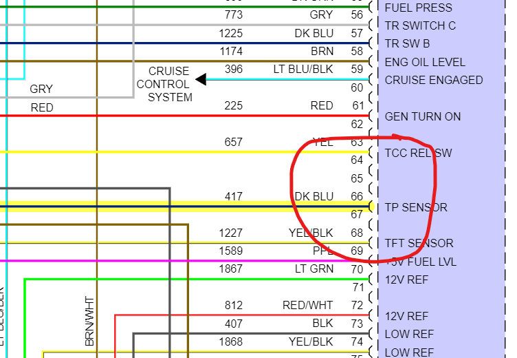

If this is where we are at, and you're still reading 0volts on the Signal wire at the ECM (Pin 66) dark blue wire? The 5 volt ref is good,? And the ground is reading 0 volts going to battery negative?
Note: If that's our case here then its obvious there's an issue with the Signal wire somewhere between the TPS and ECM.
That's what you're chasing if all the above is correct..
There is a connection (p100) which is the Harness plug going through the firewall.
If you have followed that wire all the way to the firewall and found nothing wrong, then you need to start checking inside the car for a broken wire somewhere.
I'm really hoping you had a good ground connection with your meter when you were checking the ECM pins.

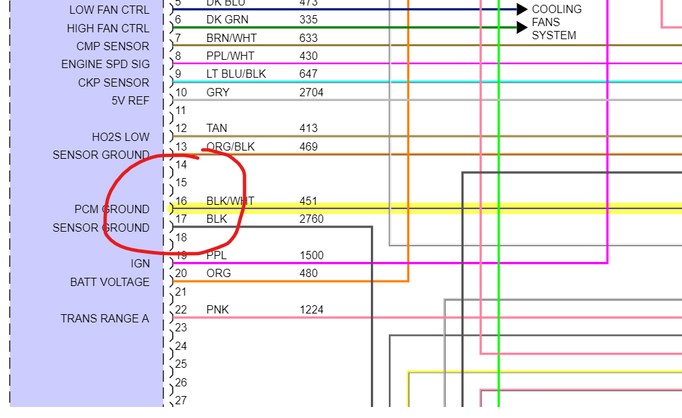

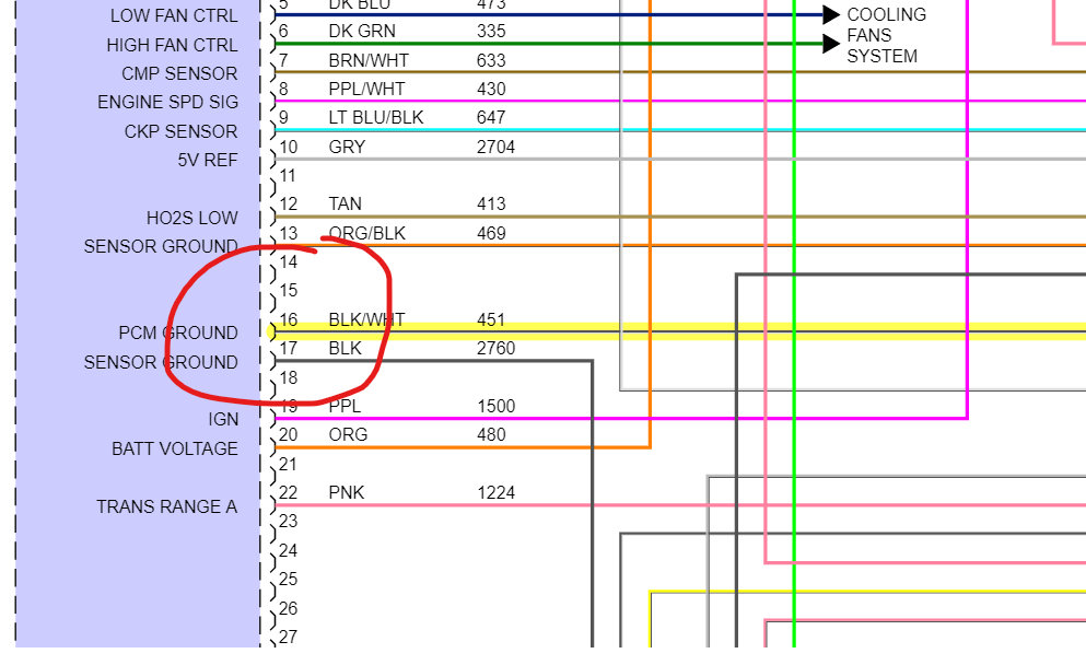

Another method is to use the ECM ground while checking Pin 66.
So put your black meter lead on Pin 16 Connector 1 (ECM ground black/white wire)
Red meter lead to Pin 66 Connector 2 (TPS Signal dark blue wire)

I would really like to know if you are getting no reading on Pin 66 of the ECM, while you are getting a reading at the TPS dark blue wire. If the car needs to be running to get a reading, then run it. But the code p0122 is there for a reason, There are other TPS codes it could have set, but its a low input code and you're reading a low input. I would retest again.
This would explain the code and the symptoms. I know you have done a lot of testing and are probably exhausted because of this. But if these 2 readings differ. Then we can try somethings to verify a broken wire.

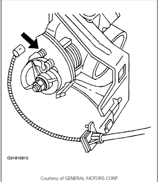

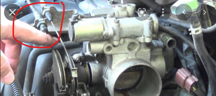

There should be a nut you can loosen up to give the cable some extra play. Can you send me a picture of your throttle body close up so I can which kind you have. The picture i'm leaving is a basic setup. I wondering if you need to replace the throttle cable. It may be binding up somewhere. Or there is a problem with your gas pedal.
Amazing huh, the problem may have been the throttle cable this whole time. But I would give the gas pedal a real good inspection too, see if you can pull it up or if is staying up by itself.
If there is no adjustment at the throttle body or on the pedal, then the cable needs to be replaced. If it is binding up that bad, its going to be a safety concern driving. You don't want your cable to get stuck and lose control of the car.
The 2nd picture is what I found for GM throttle cable. Is this what your setup looks like?
