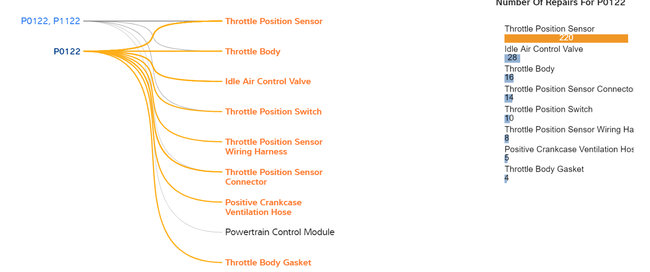

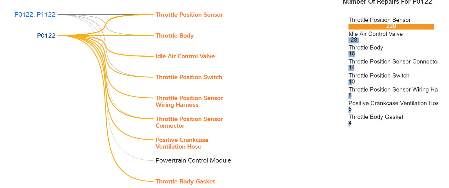

Code P0122
Very very weird. After running the engine I pressed on the throttle and it went up to 4.50 when before it didn't budge.
Just tried back probing dark blue wire again and when I turned it to on it was 1.63. I opened the throttle and it went to 4.50 then down to 1.64 I guess I'll take everything out and recheck the dark blue wire again at least to the firewall and go from there.

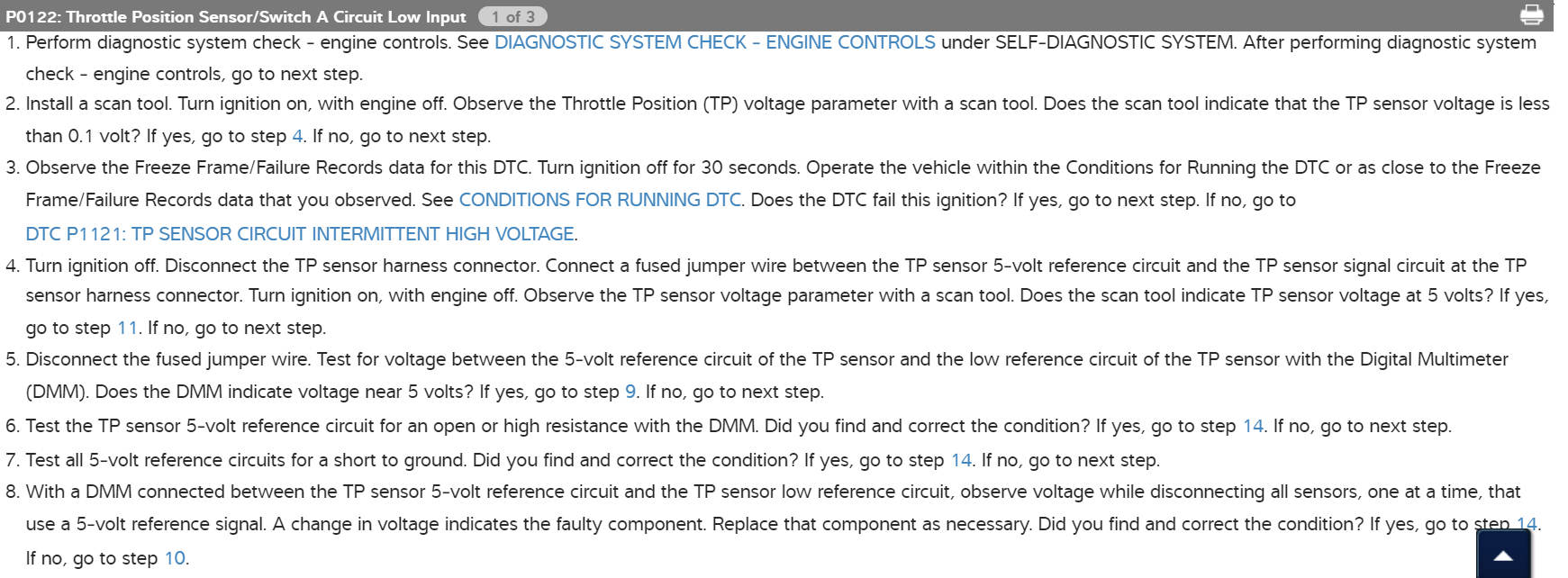

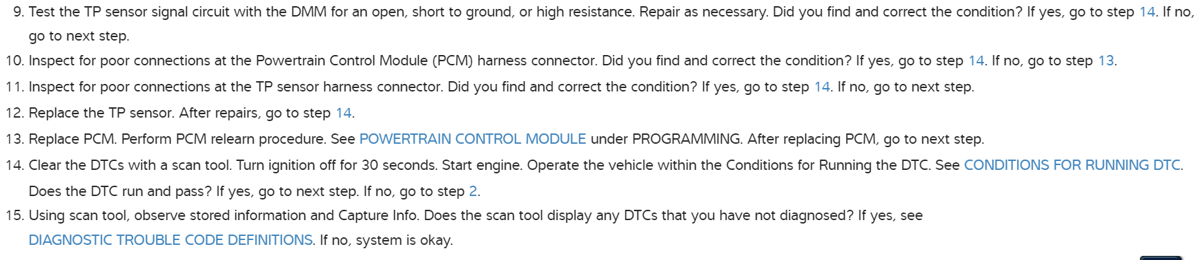

Please do that. 1.63 volts at closed throttle is way too much. it should be below 1 volt at closed throttle. Your throttle plates not closing all the way is causing that 1.63 volts and that is incorrect. Disconnect the cable and see if the plates close all the way.
You may have a faulty cruise control module or something holding those throttle plates open.
Disconnect the cable before you do anything else. Then take another reading on the dark blue wire at the TPS with the cable disconnected, it only takes 5 minutes to unhook the cable, especially on this car.
We're just going around in circles here. You have to figure out why its not closing all the way.

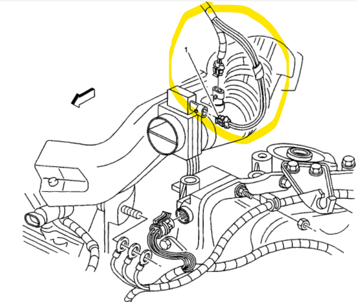

I took off the air idle control valve and I'm going to try another one but I have to walk and I'm in Arizona and Wifey doesn't want me to.

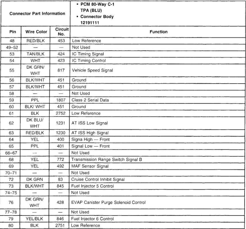

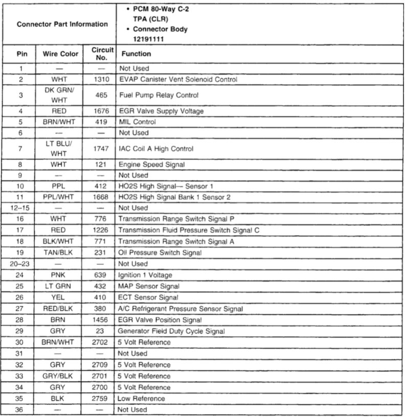

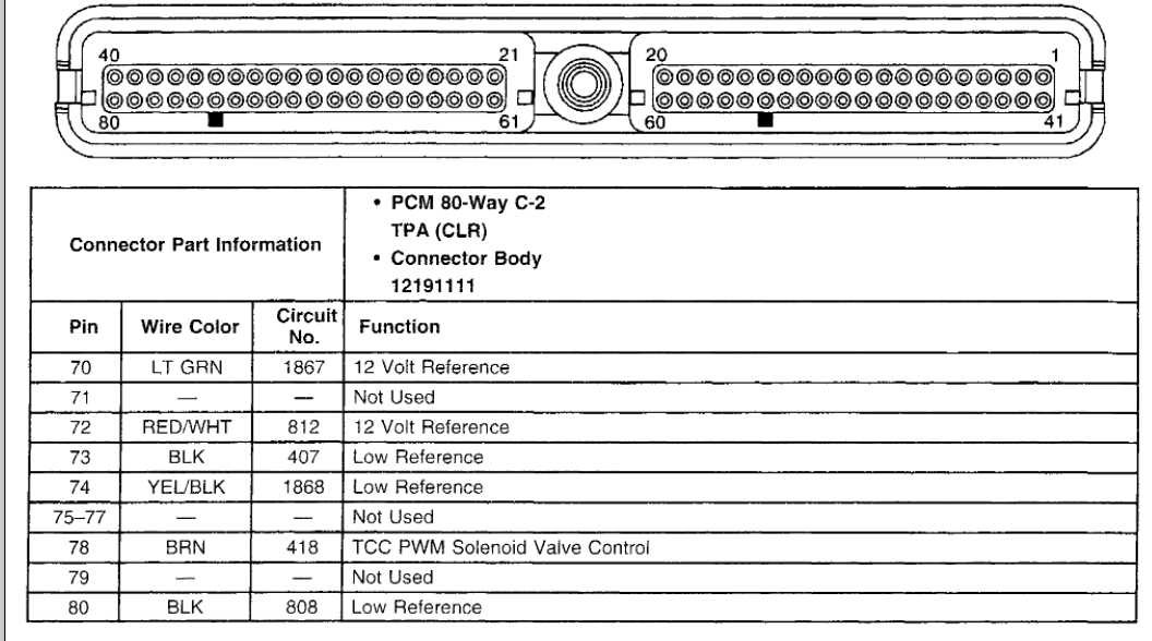

Yes, unfortunately you ruined the IAC by pulling the pintle out, that's something you should never do. Do you have the old one you can put on there? or get a new one.

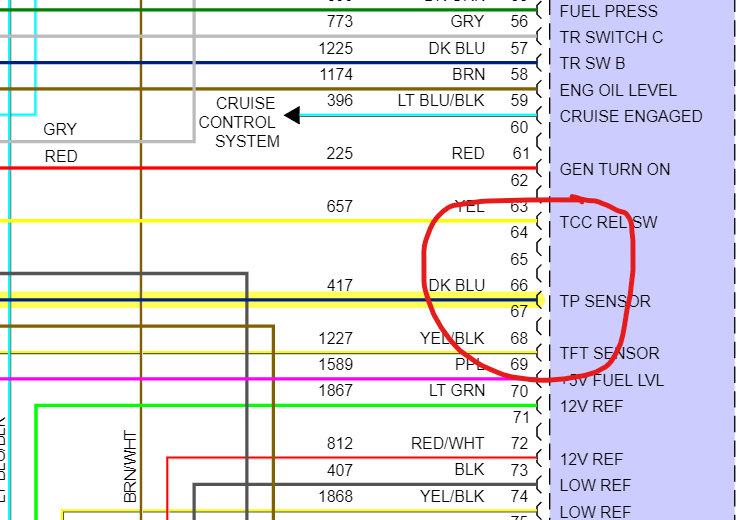

So we're at, the throttle plates are fully closed, the TPS reading is 0.63v with them closed.
So lets leave the throttle cable off for now so those plates stay closed.

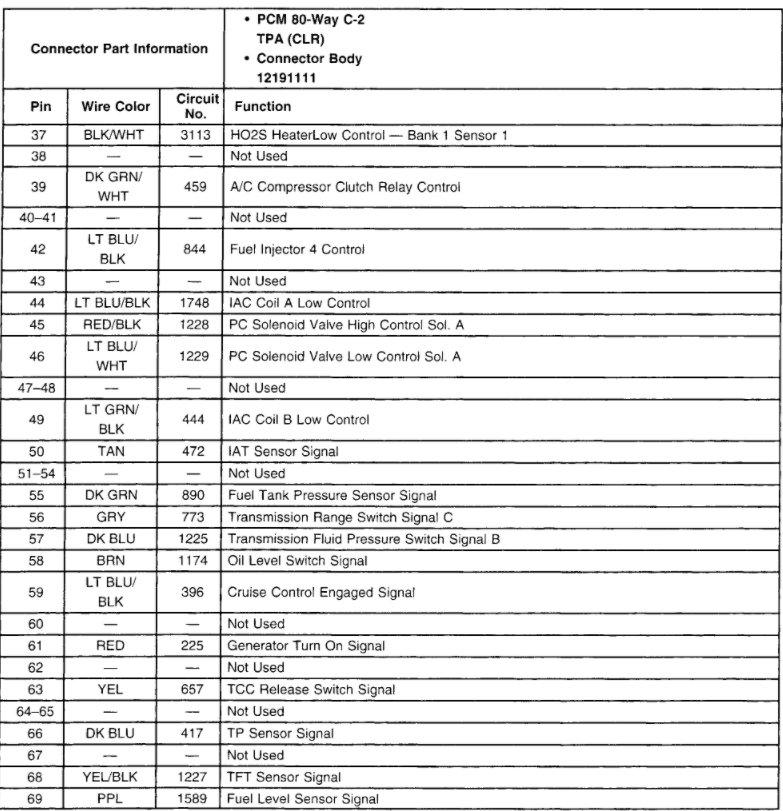

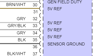

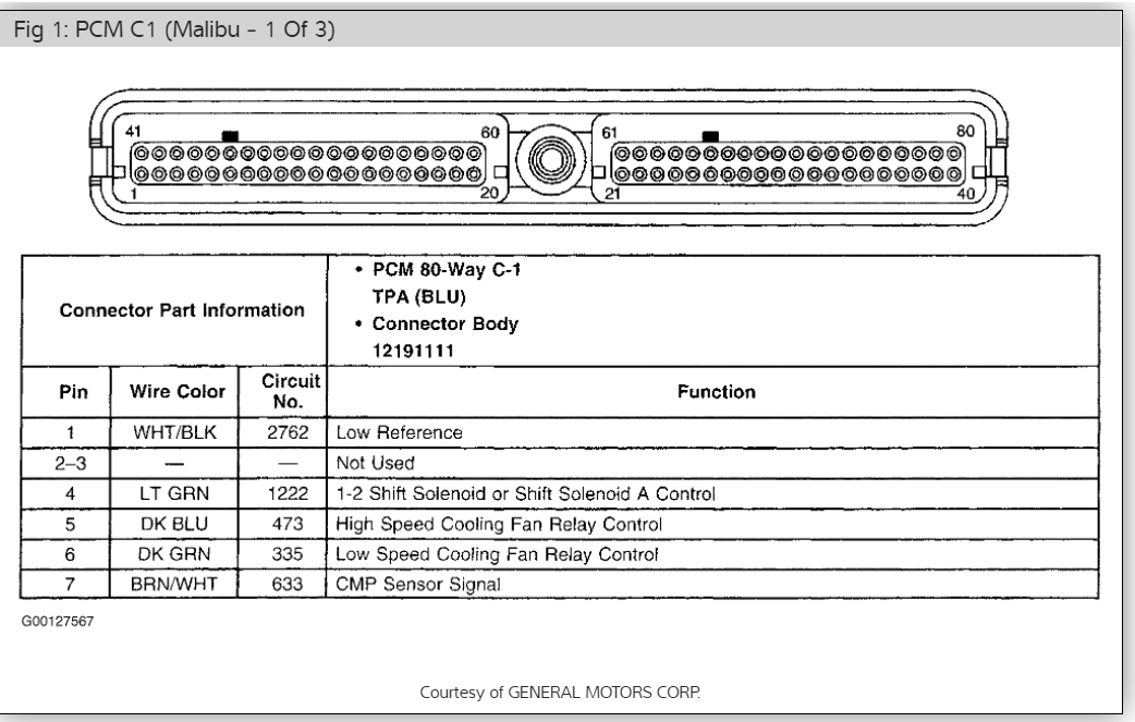

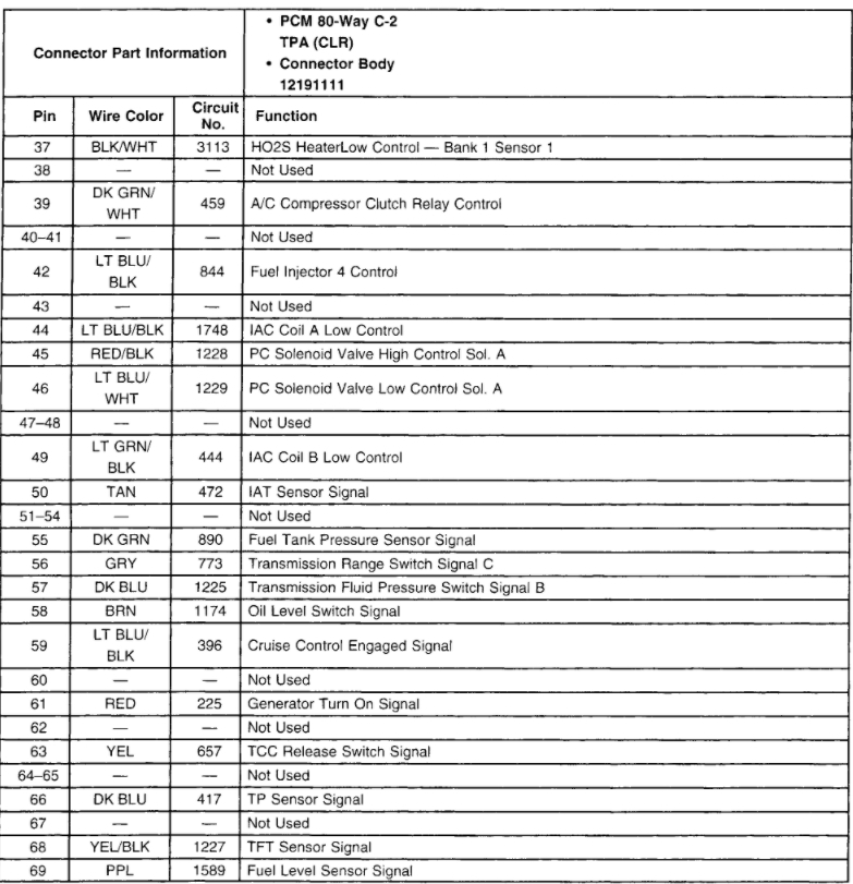

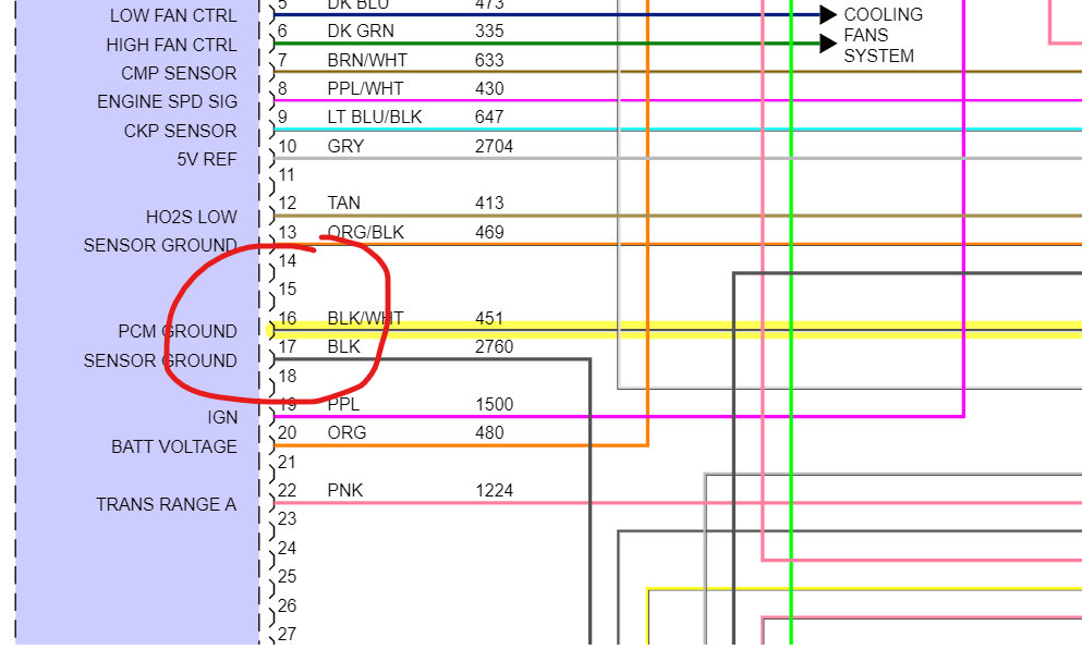

If this is where we are at, and you're still reading 0volts on the Signal wire at the ECM (Pin 66) dark blue wire? The 5 volt ref is good,? And the ground is reading 0 volts going to battery negative?
Note: If that's our case here then its obvious there's an issue with the Signal wire somewhere between the TPS and ECM.
That's what you're chasing if all the above is correct..

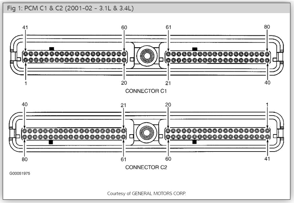

There is a connection (p100) which is the Harness plug going through the firewall.
If you have followed that wire all the way to the firewall and found nothing wrong, then you need to start checking inside the car for a broken wire somewhere.

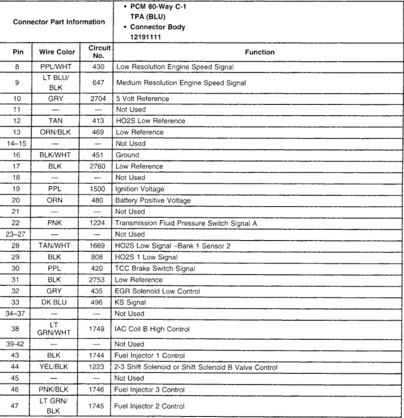

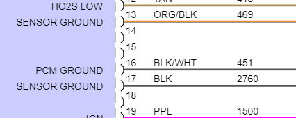

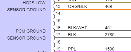

I'm really hoping you had a good ground connection with your meter when you were checking the ECM pins.
Another method is to use the ECM ground while checking Pin 66.
So put your black meter lead on Pin 16 Connector 1 (ECM ground black/white wire)
Red meter lead to Pin 66 Connector 2 (TPS Signal dark blue wire)
Since you didn't get any good readings with just the key on, do this engine running.
Just be extra careful with the engine running doing this. Have everything ready before you start the car so you don't accidently short anything out.
If you get the same TPS reading of 0.63v at the ECM now. Then you have a vacuum leak somewhere.

I would really like to know if you are getting no reading on Pin 66 of the ECM, while you are getting a reading at the TPS dark blue wire. If the car needs to be running to get a reading, then run it. But the code p0122 is there for a reason, There are other TPS codes it could have set, but its a low input code and you're reading a low input. I would retest again.
This would explain the code and the symptoms. I know you have done a lot of testing and are probably exhausted because of this. But if these 2 readings differ. Then we can try somethings to verify a broken wire.
We can even run a new wire to see if the idle comes down.
And as for grounding your meter correctly, you can always use a long piece of wire and run it to the battery negative while checking circuits inside the car.
I do this a lot. Then I know i have a good ground on my meter.

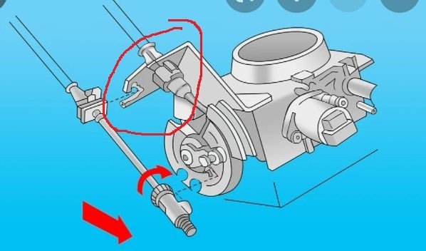

I connected the throttle cable and it had the high fluctuating RPMs again. I disconnected it and it idles normal.
Sep 22, 2021 at 8:24 AM
how do I adjust it at the throttle body?

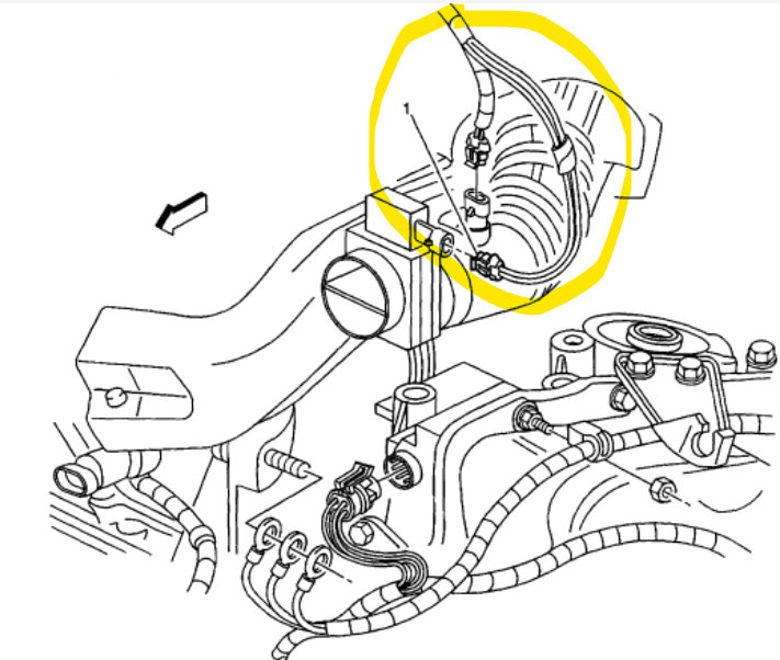

Sep 22, 2021 at 8:25 AM

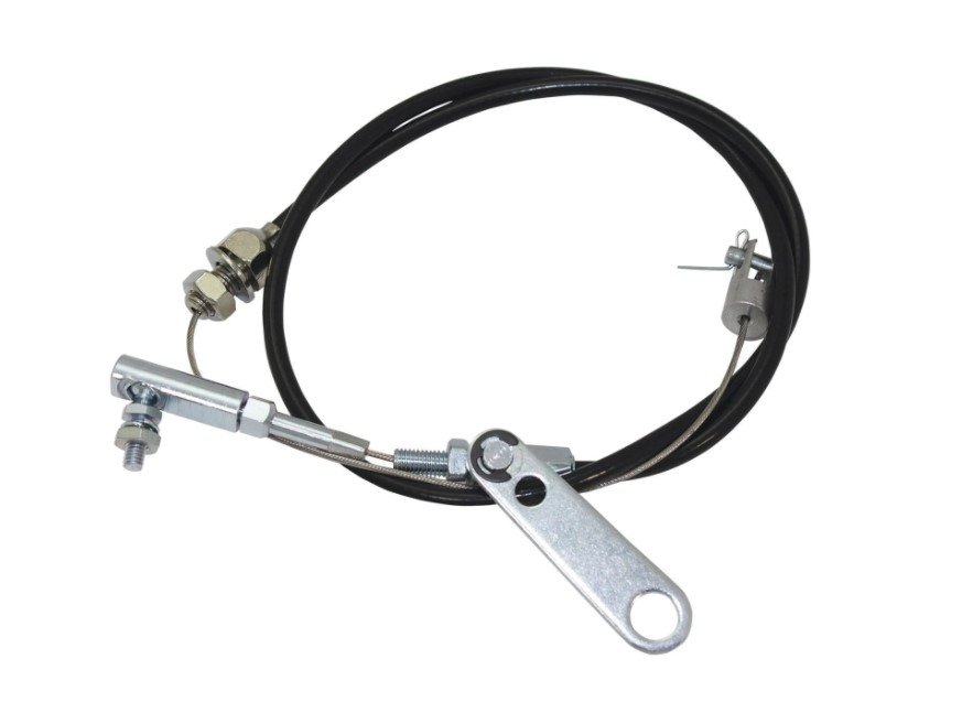

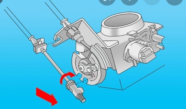

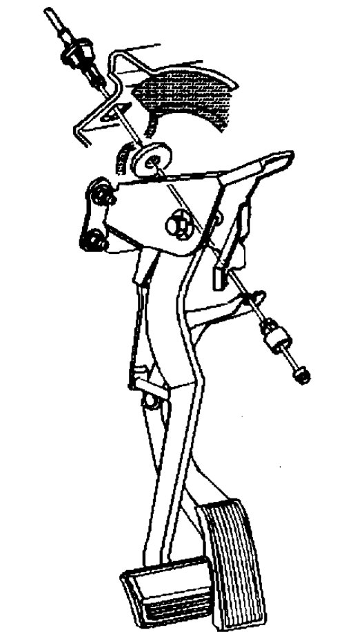

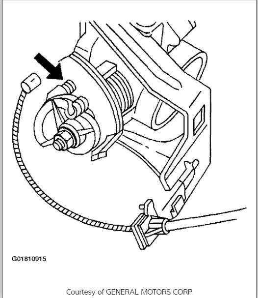

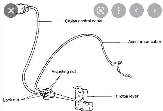

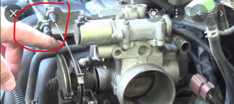

there should be a nut you can loosen up to give the cable some extra play. Can you send me a picture of your throttle body close up so I can which kind you have. The picture i'm leaving is a basic setup. I wondering if you need to replace the throttle cable. It may be binding up somewhere. Or there is a problem with your gas pedal.
Amazing huh, the problem may have been the throttle cable this whole time. But I would give the gas pedal a real good inspection too, see if you can pull it up or if is staying up by itself.

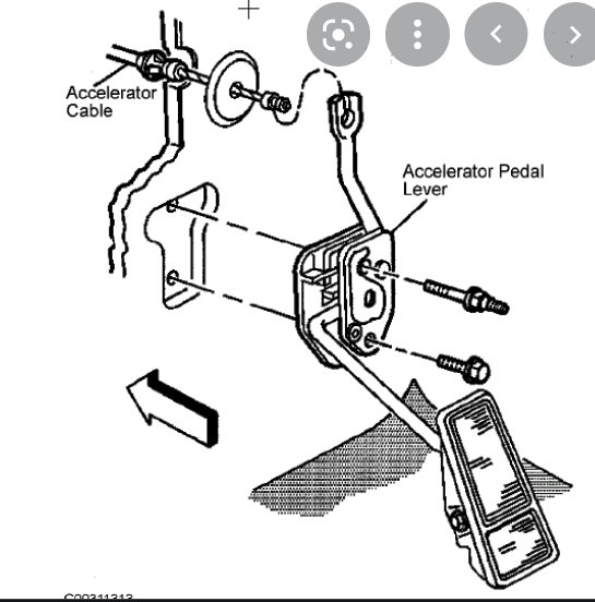

If there is no adjustment at the throttle body or on the pedal, then the cable needs to be replaced. If it is binding up that bad, its going to be a safety concern driving. You don't want your cable to get stuck and lose control of the car..
The 2nd picture is what I found for GM throttle cable. is this what your setup looks like?

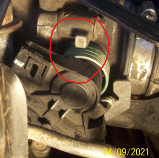

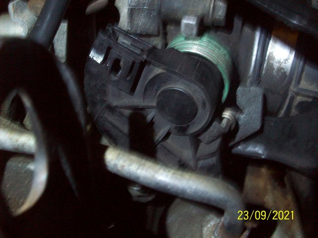

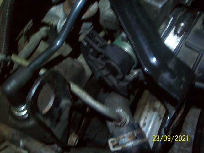

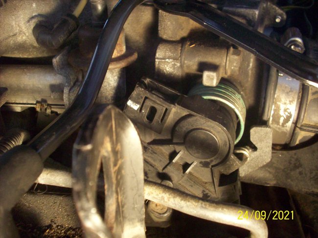

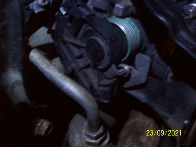

Sep 23, 2021 at 5:01 AM
Yeah, I looked and couldn't see anything but this is what I have. Sorry about the poor quality I was trying to hold a flashlight in my left hand and snap with my right and I'm left handed. I tried pulling the cable from both ends to free it up and there was nothing. I've looked for the cable, all they have are the "universal" ones. Called a dealership and was told GM doesn't even make it any more.

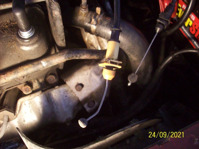

Sep 23, 2021 at 8:14 AM
When you say you tried pulling the cable from both ends? Do you mean the cable feels like it's binding up or is it the gas pedal that's not returning to its normal position? Also is there a stop screw on the side of the throttle body that can adjust the plates position? It's odd because usually a cable will stretch and be too long, therefore having slack in it, in this case your throttle cable is too tight. Is there an additional cable for the Cruise Control that's pulling on the throttle plates? Because honestly I can't see anything out of those pictures. Maybe if you can take 4 or 5 pictures during the day from different angles around the throttle body.
I mean now we have to figure out why the cable is so tight. Did this original problem happen suddenly or over time?
This is a cable I found from AutoZone, does this look like your cable (Pic 1)? You'll notice there is an adjustment screw towards the bottom of the cable.
Does it make a difference with the cruise cable off?
Sep 23, 2021 at 2:16 PM
pic 1 shows yellow throttle and black cruise cables, 2 and 3 show the position of the throttle (closed) with both cables disconnected, 4 shows position of throttle (open) with throttle cable connected, I took a few pics with cruise connected but they didn't turn out good enough to see but there is a good 1/4 inch of slack at the end. Your pic 1 is pretty close to what I have. Nothing stuck under the pedal I pulled the floor mat out and stuck a mirror behind it.
Sep 24, 2021 at 9:46 AM
So there's no threaded adjustment on the throttle cable anywhere, with a nut on it? not even down at the pedal? Something is holding that cable up, if you pull on the cable does it feel like it moves freely?
Have you followed the cable all the way down to the firewall, does it meet up with any other cables at any point or can you follow it all the way to the pedal and find no places where its kinked in a strange position or something?
I mean you've found the issue. All of those throttle body pics look the same to me, There has to be an adjustment on it somewhere. Cables don't just tighten up like that for no reason. I have been looking all over for diagrams and can't find much. Im doing some investigating and see if i can get a better diagram of where that cable runs too. Hopefully ill have more info tonight.
i do see that a lot of places sell a universal cable like you said. Not sure that will work for you though.
Can you disconnect the cable from the gas pedal?
One more thing, how does the throttle plates move with the cable disconnected, can you turn the plates freely, no binding or anything? Just pull the throttle linkage like the cable would be doing. Make sure that bearing in there isn't binding up.
So it seems other Malibu's have this same issue. They think it's an adjustment issue.
Sep 24, 2021 at 10:26 AM
I can't see anything on the throttle nut or a screw. If it's on there they have it buried so I'll take the air box off again and move any wires or anything else that could be in the way and take another look. Yes the cable moves freely and my wife says when I move the cable inside the casing the gas pedal moves up and down about an inch and I can hear the pedal hitting the floor. I had her move it and verified it does just that. I'll take a look at the pedal for a nut or something there, I wasn't looking for one before but I don't recall seeing anything that looked odd to me. Yes I followed the cable to the firewall and it's normal at the air breather tube there is a clip it lies on to keep it in place. It goes into a rubber sheathing and runs back beside the brake booster and I looked at that point and I can see where it goes thru the firewall. I followed the cruise to the box of the passenger side and it's secured in place. Figure 2 looks more like what I have so again, I'll get back under there for another look. The throttle opens and closes freely with the cable disconnected. I don't feel any catching or sticking, the tension on that spring I think feels ok but I've found myself looking at it off and on like maybe subconsciously something there is catching my eye, for some reason I just keep looking at it if that makes any sense. No I didn't disconnect at the pedal but since you asked if I did I suppose I should.
Sep 25, 2021 at 1:44 AM
okai, so after some more investigation from another source, this car supposedly does not have any adjustments for the cable. It's only the throttle cable and the cruise control cable. But we must be missing something here.

Is this bracket bent at all? You might want to take the whole throttle body right off the car and inspect every part.
Also, the springs that are supposed to pull the throttle closed are supposed to be wound around twice, I think there are 2 of them, if they're weak or not in the correct position, they might not be able to fully pull the throttle closed. With the cable connected can you pull the throttle closed by hand?
That bottom pic is yours, I don't think I see the spring hooked on there.
I just also read about the vacuum behind the throttle plates pulling them slightly open due to worn return springs, does this only happen when its running?
If you have the cable hooked up, without the cruise cable, it's still hanging the throttle plates open correct?
If so, is it possible to pull up on the gas pedal to allow for the little slack it needs? I mean we're talking about probably a 1/4" inch. Or is it possible that the spring on the throttle body is connected incorrectly? You said you cleaned the throttle bore , so it can't be carbon hanging the cable up.
The only thing I can think of at this point is the cable is maybe binding up inside its case,
I would say order a cable and replace it at this point just to see if that helps.
I'm running out of ideas here. Is the TPS holding it open? have you had that off with the cable on and see if the plates are still open? Try that. We're missing something really simple here. Cables don't shrink,
Also try unhooking the cable from the gas pedal, and keeping it just hooked up to the throttle. See what that looks like.
I have never seen a TPS bind up and hang a cable up, but I suppose its possible. I'm not sure.
You're going to figure it one of these days and be kicking yourself, it has happened to me. But please let me know if you do find out what's going on. I really have to know at this point why those throttle plates are hanging open.
