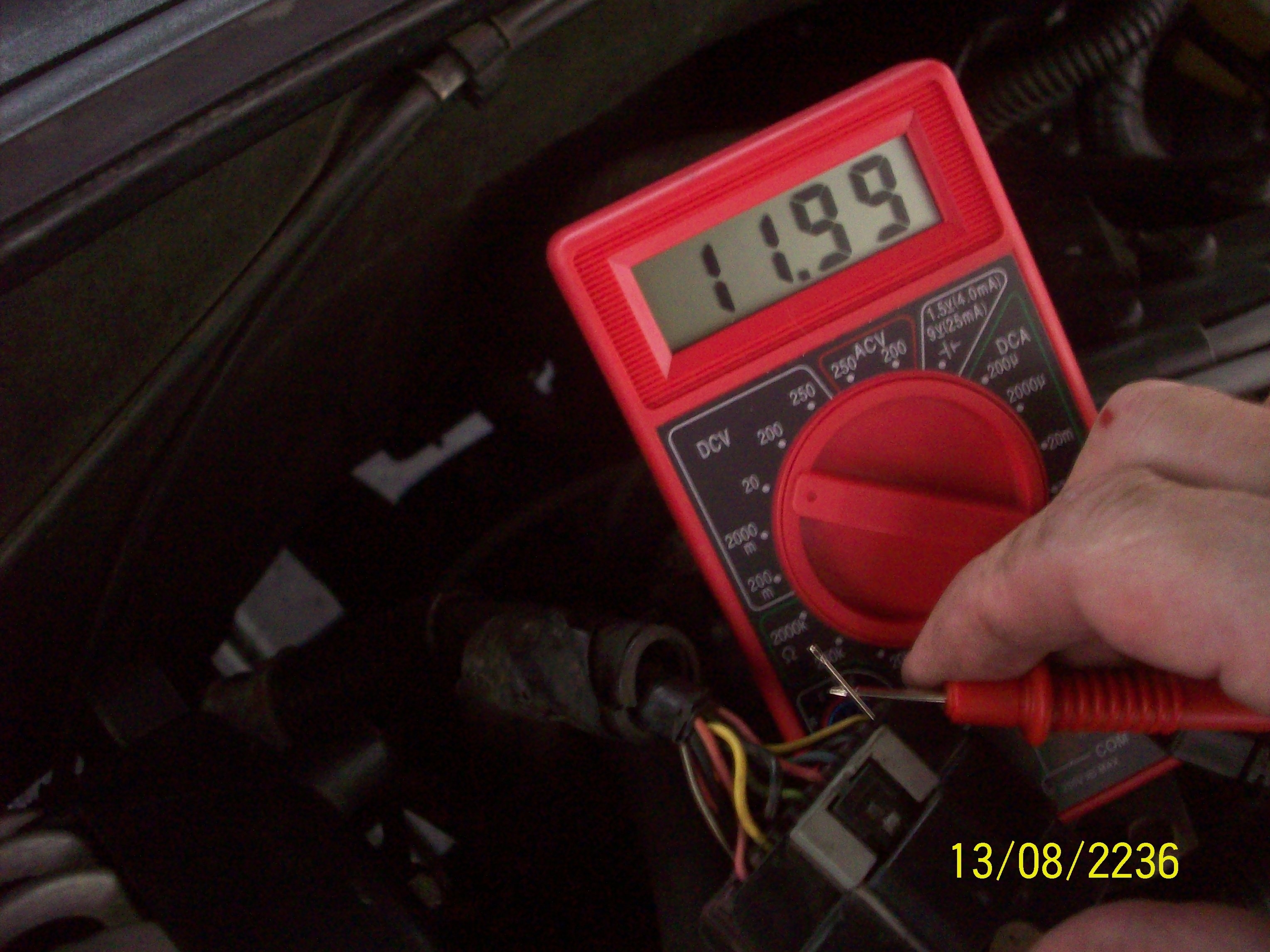

traced from plug back to connection right behind alternator touched pin in grey wire read 11.99 on both ends of the connection.

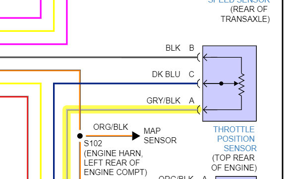

The grey/black wire reads 11.99volts with the other lead on battery negative? This is the same wire that reads 5 volts at the TPS sensor?

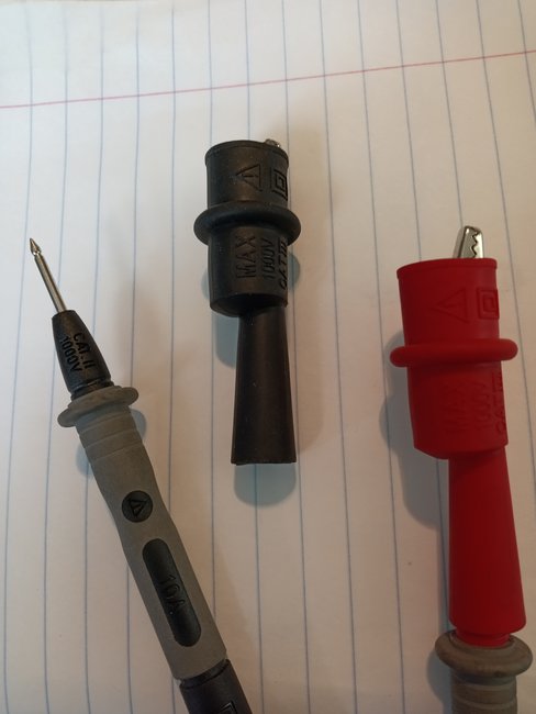

A side note, when checking a ground wire, (the black wire), you want to leave the meter set on voltage, with the key still in "on" position, you'll then want to back probe the black wire and other meter lead going to battery negative. This is called a voltage drop test. So you will be testing how much voltage is lost from the sensor to the battery negative. it should read almost nothing, 0.050 volts or less. Doing a resistance test will not show a problem on a wire, that might only occur when the circuit is "on" and loaded.
Sep 9, 2021 at 10:21 AM
AL514
  • 5,639 POSTS

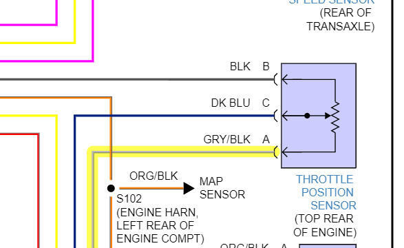

I'm not sure if you're on the right wire. Because if you're reading 5 volts on grey/black wire at the sensor to battery negative, You would be reading the same 11.99 volts at the sensor as well. If you get what i'm saying. Unless you're taking a reading across the connector, one lead on one side and the other lead on the opposite side. Then I would pull that connector apart and see if its corroded inside.

I think you're right. In a different light the wire looks more yellowish than grey but it still has a dark stripe.

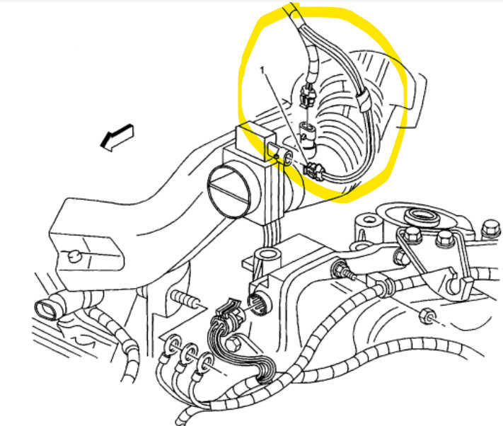

The hole for the Idle Air Control Valve (IAC) is right in front of the throttle plates, so it will be the neck of the throttle body.
So technically when you unplug the Mass Air Flow sensor, the ECM should go into a default fuel strategy and the engine should run okay, (This is on most cars, but i'm not 100% on Chevys) But i wanted to see if the idle would come down when you put your finger over the IAC hole. This hole just bypasses the throttle plates and allows the ECM to control the idle by moving a Stepper motor back and forth inside the IAC. If its stuck open, the idle should come down by doing this. If the car just stalls out, we're probably going to check for a vacuum leak. Do me a favor and take a picture of the engine layout and post it here, so i can direct you a little easier.
I am concerned with that voltage drop off though, reason being, is this Code p0122 is for a Low Input signal from the TPS to the ECM . I'm wondering about a possible bad ECM ground here as well.
I know it's a lot to take in at once, But I think while your messing around with the car, you may want to keep your multimeter set up on that Signal wire (dark blue wire). If you can with an alligator clip to hold your lead on the pin. These are one of my pair i use. Since you're going to be a pro at testing wires when we're done here.
So does the car surge when your driving? For instance when you have the throttle plates open with your foot on the gas? or does it go away? Reason i'm asking is a vacuum leak will go away when you open up the throttle plates and more air is moving in. Vacuum leaks will be more noticeable at idle.

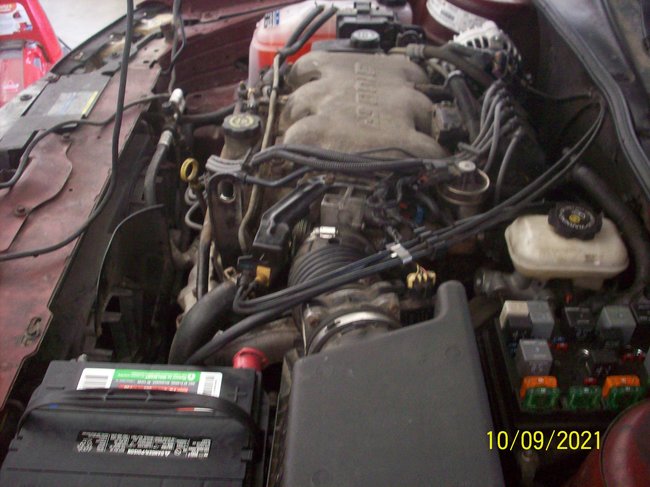

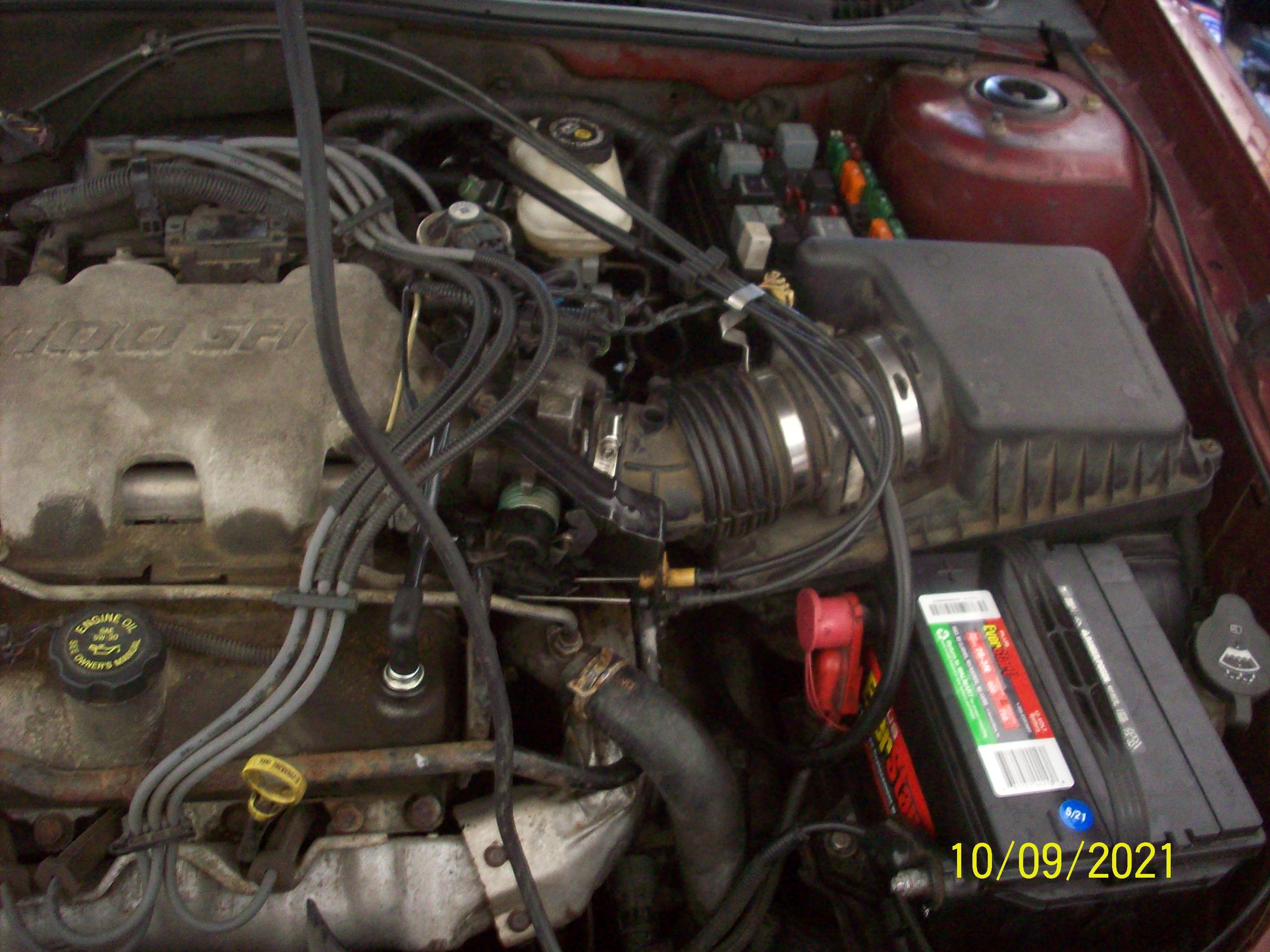

So try your finger over that IAC hole, take me a picture of the engine, and monitor that Signal wire and see if the voltage drops off like that again. If it does we're going to have to start checking the ECM power and ground wires.

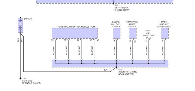

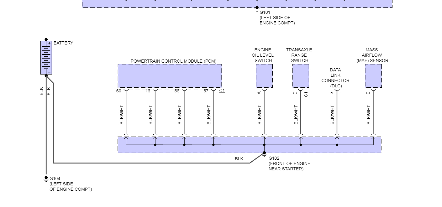

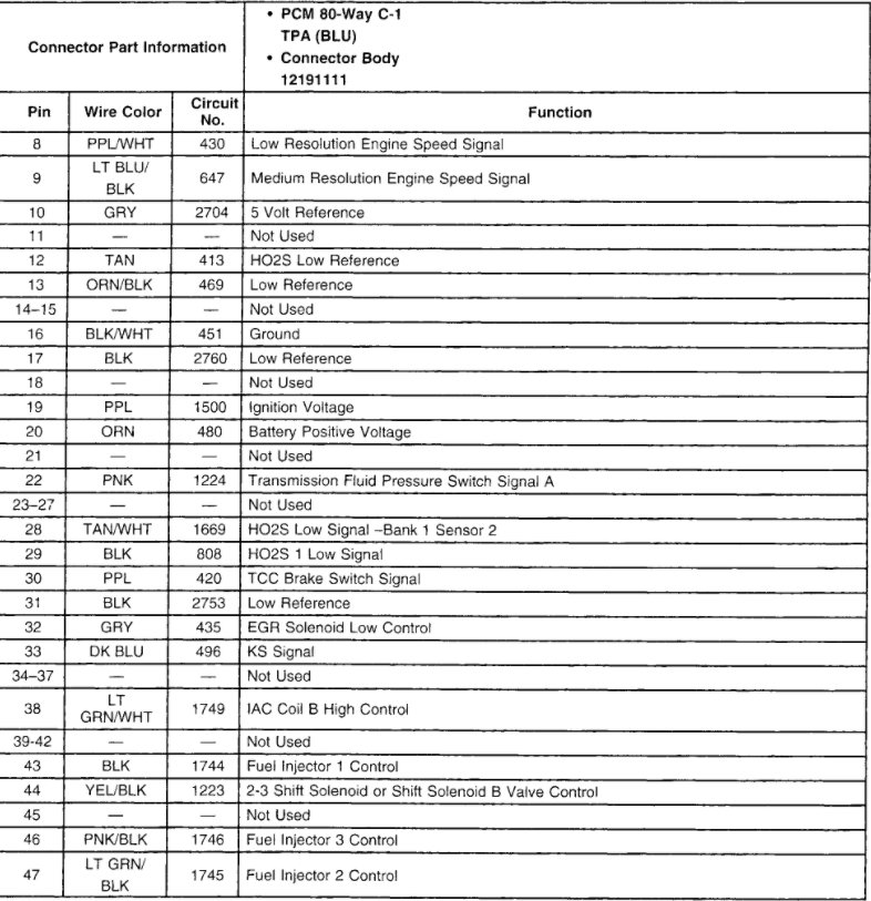

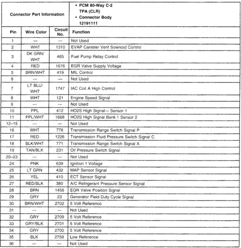

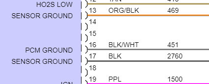

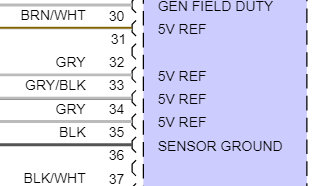

I'm going to throw this out there right now, Here are the Grounds for PCM/ECM. They're right near the starter motor in front of the engine, so the front of the engine means where the main drive belts are. But check these Grounds, I saw this picture and they're all bulked together, probably on one stud with a nut on it. If there's any rust or corrosion, take the nut or bolt off and clean the heck out of this Ground location. I remember a car like this having an issue with the ECM and it was these grounds that were the problem.
They put all the PCM grounds together like this, and if one is bad it effects the whole lot of them. Black/white wires.

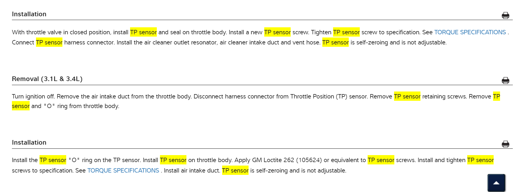

Sorry for all the edits here, Just to see if this works, if you do have a new TPS sensor on there, try unhooking the battery negative for a few minutes, the hook it back up, This will erase the ECM memory, lets see if that works. This is along the lines of erasing a code after a part is replaced,

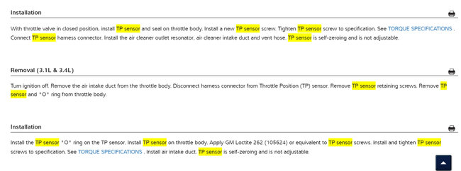

I'm adding an installation tip I just found, I know it's for the 3.8L, but the 3.1L is very similar.

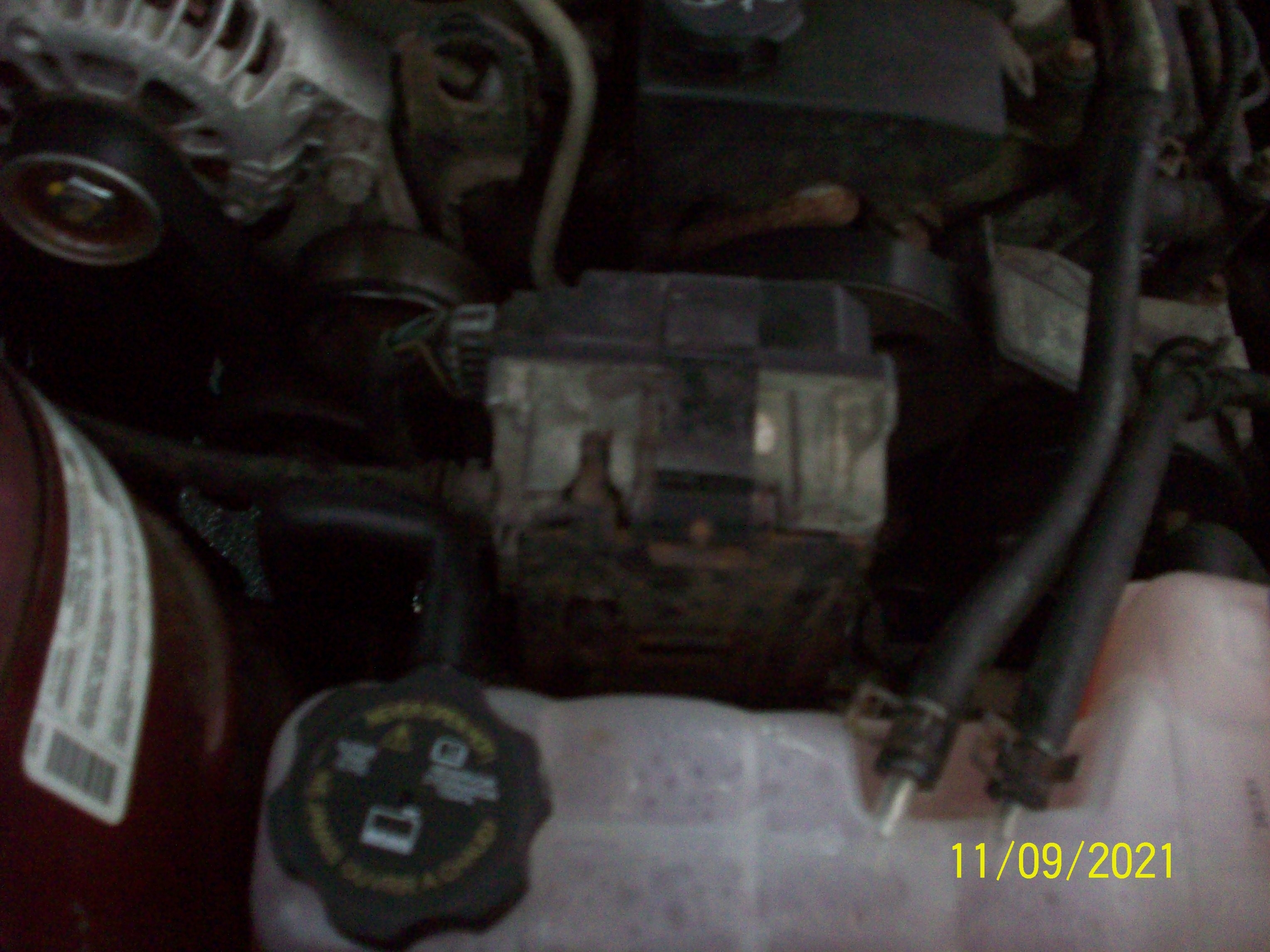

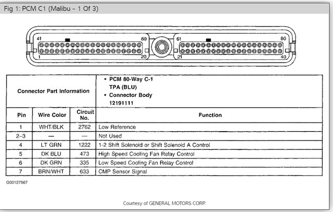

I traced the blue wire to the ECM and back probed it. It took a reading 1.59 - 1.62 that was with the key on. Opening the accelerator had no effect.
Sep 11, 2021 at 8:22 AM
10POINTBOB
  • 56 POSTS
This is the ECM correct? If not what is it?
Sep 11, 2021 at 9:25 AM
10POINTBOB
  • 56 POSTS
Never mind I know it isn't.

Okay, thanks for the pictures. Well we've found the real issue at least. Its strange that you're even getting any reading on the signal wire at all. I think you're going to have to check that 5 volt reference wire while this problem is occurring. My head is telling me you may have another sensor that is shorted out and pulling the 5 volts low or a corroded connection somewhere. the ECM needs a full 12volts to operate. I'm not sure its a bad ground.
The reason for this is, if you had a bad ground wire, the signal would be high because its not being pulled to ground, but since its a low signal, either that 5 volts is low, or power to the ECM/PCM is low. This is definitely not an average problem. I'm glad you've been able to do these tests so far. This is getting to be some tough diagnostics.
So the next step here is going to be checking the 5 volt wire at the sensor when you're not getting a reaction out of the TPS. I don't know if this is a problem that is always happening or if it is intermittent. Since you did have a reading at one point during all this,.

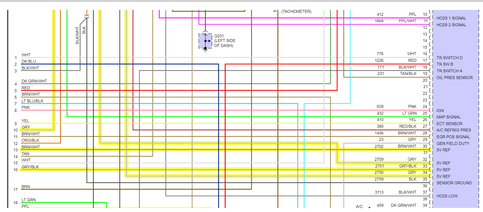

So next steps, charge up the battery, check that 5volts while the problem is happening, And is this the Base Malibu model or the LS model?

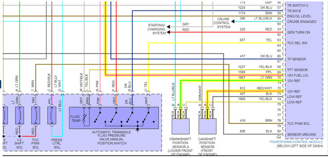

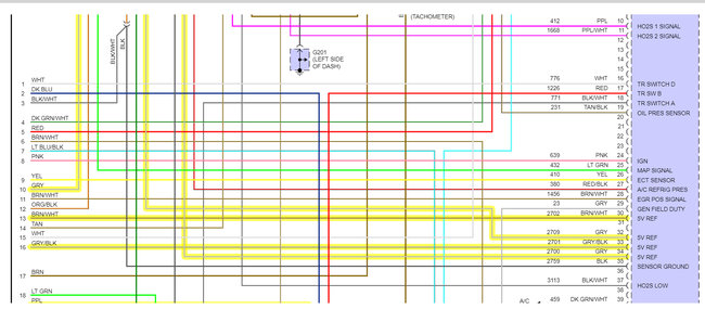

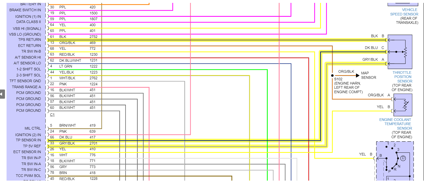

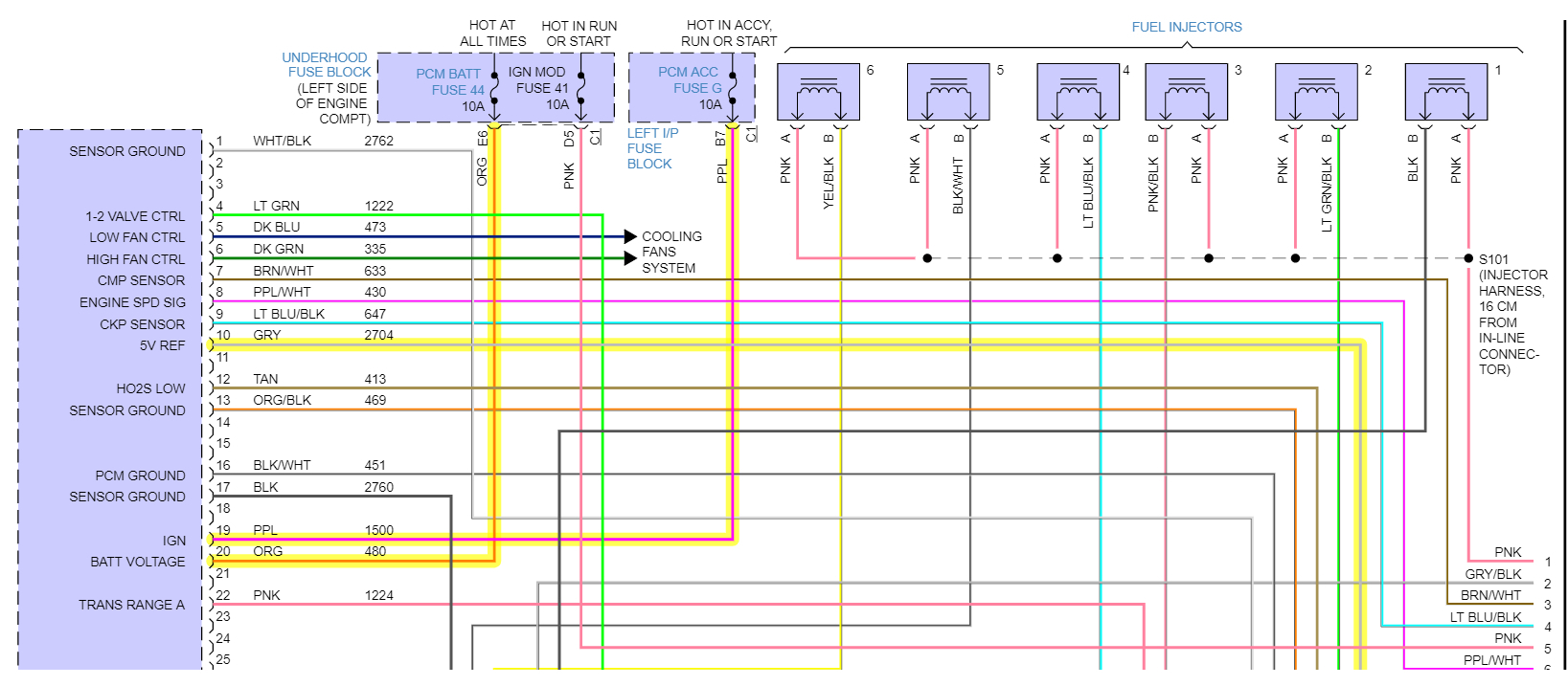

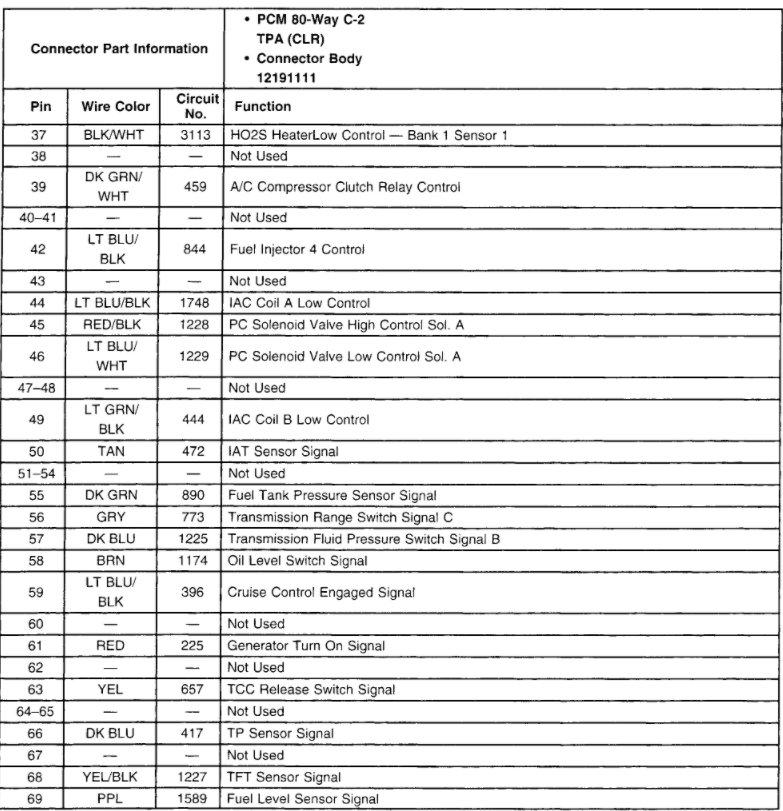

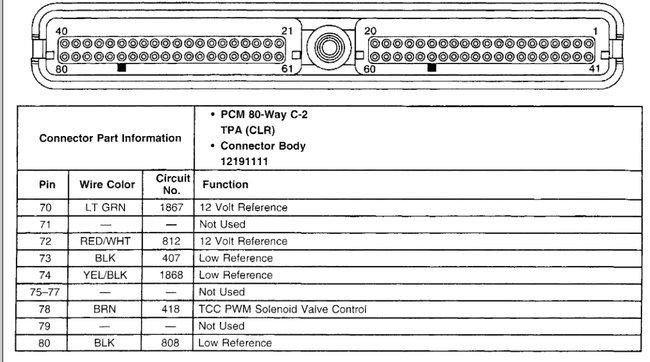

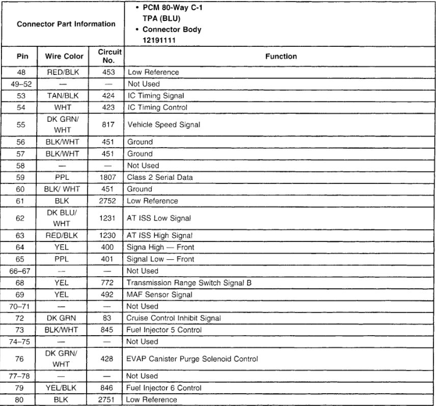

I'm giving you the power diagrams to check the ECM. So what you'll have to do on these, since there might be more some wires that are the same color, is just make sure the wire you checking has the same color wires next to it as on the diagram.
So the 1st Diagram is the battery voltage wire is an "Orange" wire next to it a Pink wire, and a Purple wire on the other side. The Orange wire should be battery voltage all the time (12v), And the Purple wire is Battery Voltage while the key is in the On Position (12v).
These are all highlighted in yellow.
The grey wire above those, you'll see, is a 5 Volt reference wire. Check all these after the battery is good and charged up.

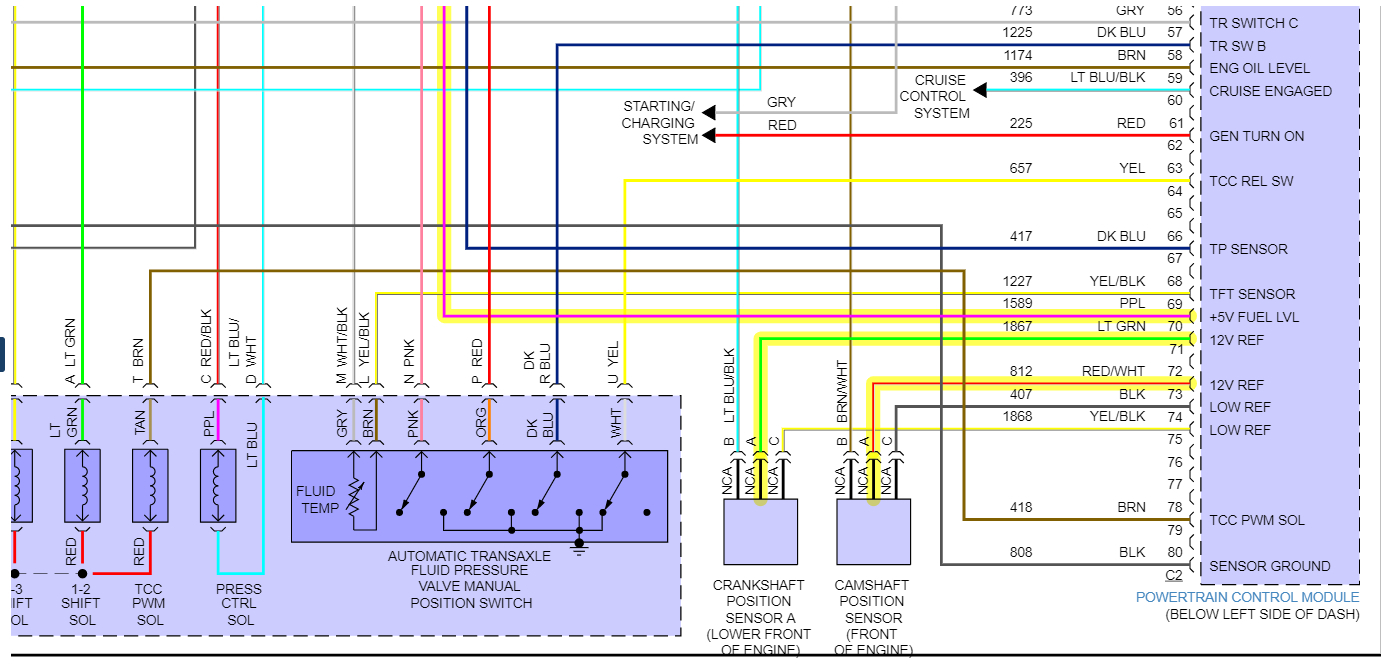

The 2nd diagram is all 5 volt tests, Key On is fine for these.
The 3rd diagram is one 5volt ref, and two 12v ref.

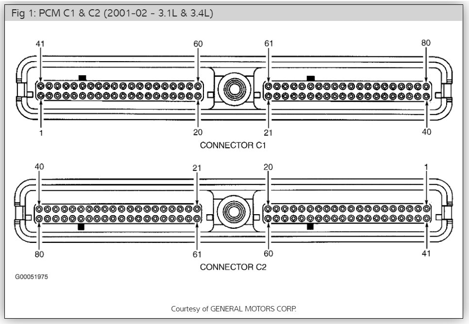

I'm assuming you know where the ECM/PCM is because you said you traced a wire back to it, which is great by the way.
Just really make sure that battery is good, its really important that its fully charged for anymore testing. Let me know what you find.
And one thing, these tests we're doing are not loaded circuit tests. Meaning we're not stressing the circuits right now, which is what I would be doing in a shop. But for right now, just do these basic checks and we'll keep going from there. Doing these tests while the car is running would be even better, but if you're worried about the idle being all over the place i understand.
If everything checks out, check the wires while doing some wiggle tests on the harness, sometimes while moving the harness around a little, a problem will reveal itself.
In your pictures, the 3rd one you asked about, looks like an ignition module for the coils. You have spark, so go right to the ECM now. Its labeled as just below the left side of the dashboard, so driver side. Its going to have a ton or wires running to it like in the diagrams. I know there is 3 of them, but there just broken up that way. All the pictures run to the same ECM.
I really hope you didn't just get a bad part from the auto store. Its been happening a lot more lately. Just junk brand new parts.
Just wanted to throw more to think about, sorry for this, but while tracing wires back from the TPS to the ECM, check as much of the wiring as you possibly can. I know you've got an odd situation here. But any contact points where the harness touches any part of the engine or frame, where it can rub threw after years of vibration and movement.

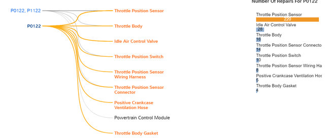

I would try another TPS, give the throttle plates a real good cleaning. And i'm not sure if you tried putting your finger over that IAC hole in front of the throttle plates and if that brings the idle down.

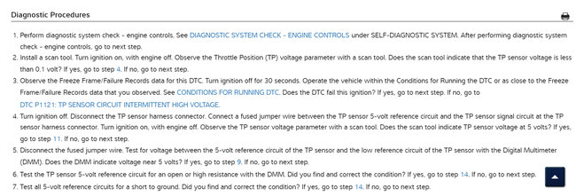

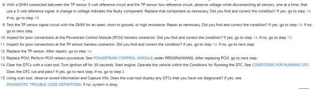

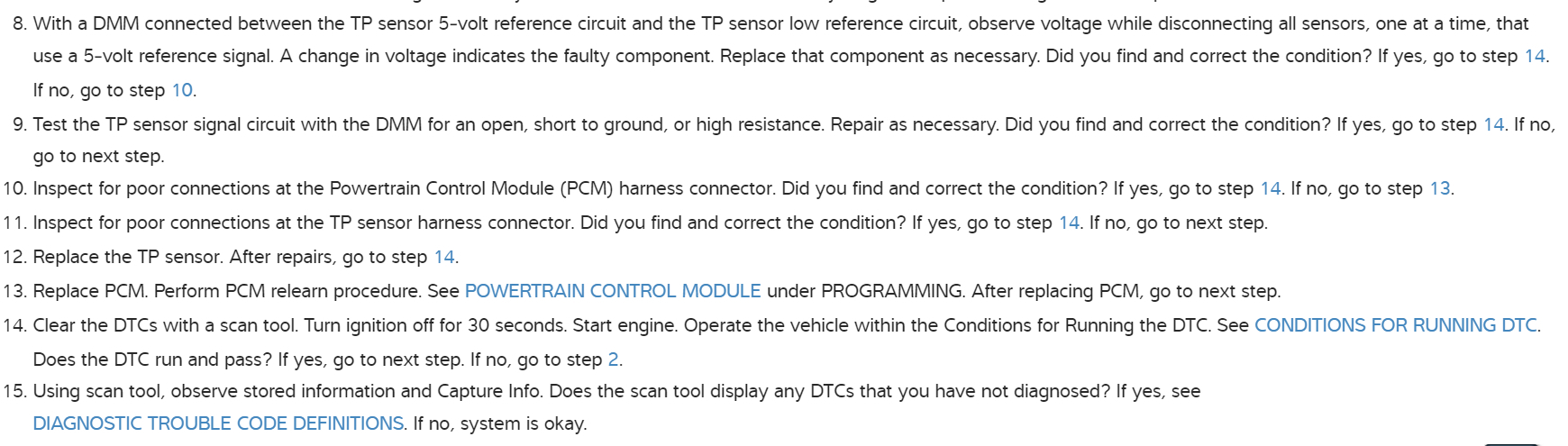

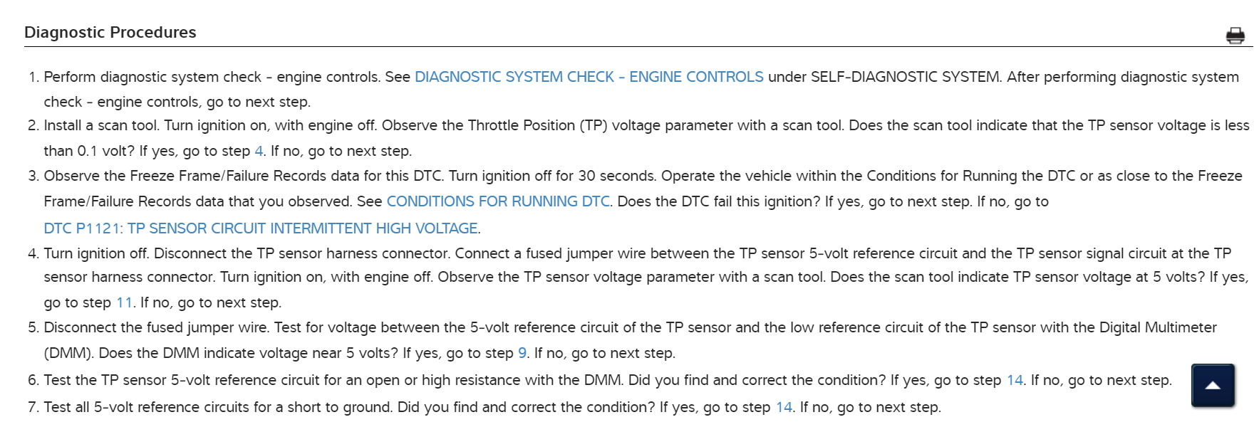

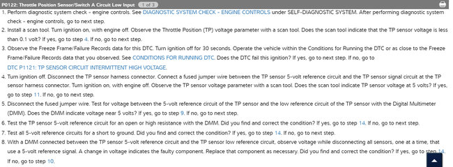

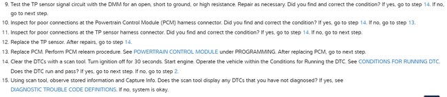

I'm putting up the Diagnostic Procedure from our information source, but it calls for a having a scan tool to watch the data and check the freeze frame info as well,
You can try this method, i'm just not sure how far you will get with it, it talks about jumping the 5 volts to the signal wire, and if you do that wrong, you can fry ECM parts. So i don't recommend it.

okay. well, I'm glad you got all that done though, that helps rule out a lot here. How much is the throttle plate open? and if you were to loosen up the cable do you think you can get it closed all the way?

The throttle response is your issue, if your pushing on the gas and nothing is happening with it running, its either gone into Limp Mode, or you may have a bad ECM.
Under the dash on the driver side, look for the ECM. Its going to be a big flat silver box.
Use the wire colors in their order and match them up match. There are 2 big connectors on this ECM. I'm putting up all the diagrams for both connectors. You'll have to get a real good flashlight so you can see the correct wire colors.
The 1st picture is the 2 connectors,
the next 3 are connector 1. its a blue color
and the last 3 are connector 2 is clear looking.
You're going to have to find it and check the power inputs and grounds to it.
Connector 1 (blue) has the main power feed for the ECM. The Orange wire (Pin 20)
The ignition switch power is Pin 19 Purple wire. Both these should have battery voltage.
The ECM ground is on Connector 1 Pin 16 Black/White wire.
All the 5 volt refs are on Connector 2.

Limp mode sounds like it should be self explanatory. What numbers should I be reading on my multimeter, should I be seeing 12v on the blue power wire to the emc v?
Sep 15, 2021 at 4:52 AM
10POINTBOB
  • 56 POSTS
It took a while but here's what I got on the connections from the connection side. I couldn't go in from the wire side because it's all encased in plastic and I couldn't get in there, I didn't want to break it trying to separate the halves. C-1 pin 20 battery positive voltage 12.34, pin 19 ignition voltage 12.03, pin 16 ground -0.02. C-2 pin 66 T P Sensor signal 0.01 and the battery is down to 12.19 now. C - 2 was harder because the wires didn't have much give to turn and being clear reflected more light back. What I saw that I think would be off is maybe c-1 pin 16 my .signal wire -0.02 and on c-2 pin 66 my TPS signal 0.02. What that all means though I'm not sure. One thing I didn't think of doing when I was on 16 was press on the gas pedal and take that reading. I was trying to keep a good ground.

okay. For trying to keep a good ground, using an Alligator clip helps a ton. You really need to keep the ground (the black meter lead) as solid as possible. Because with the meter set on a voltage scale, and not having a good ground, the meter is just going to read 0 or 0.01. So have a good ground is essential. Plus it makes it easier to test when you don't have to hold on ground lead all the time.
If you plan on doing repairs yourself in the future (which i recommend you do, because you will save yourself a lot of money). You should invest in a pair on meter leads that have clips on them that can be removed if needed. I recommend (https://www.aeswave.com/)
This is where I get all my leads for my meters and lab scopes. They High quality leads that they build for you. The prices are good too for the quality you get.
This is what you want- (https://www.aeswave.com/Automotive-Test-Lead-Kit-p9121.html)
Now onto the car. The ECM connectors have covers on them that can be removed for testing. Pins 19 and 20 look okay. Pin 66 is not good. With the key on you should have at least 0.4-0.5volts at closed throttle. "There's your problem" if you have the black lead correctly grounded. The code sets because of a voltage signal lower than 0.1v.
Pin 16 Connector 1 is the ECM Ground pin. Again if you have the meter leads grounded correctly, that reading is ok, its reading -0.02 because the meter leads are reversed. The other way it would be reading 0.02, so that's okay. Pin 66 is our issue here,
Are you getting that same reading at the TPS itself on the dark blue wire?
If not there's a broken wire somewhere.
If you go to the TPS and get a reading around 0.4-0.6, somewhere around there. You'll need to follow that wire, start taking it out of the harness and follow it to each connector. Take each connector you find along the way apart and check it for corrosion or breaks.
You need to carefully examine that wire as far as you can.
Eventually you will trace it back to the firewall. Use a really good flashlight and inspect that thing up and down.
Check for the same reading your getting at the TPS, at each connector that wire goes through,
You're getting close now. From what you're telling me, the ECM is not receiving the TPS signal.
And to your questions, no you should not being seeing 12v on that Dark Blue signal wire at the ECM (Pin 66 Connector 2).
I don't think you're going to erase anything by disconnecting the ECM bulk connector. You just have to have the key off before you do it. I have never lost any ECM programming, ie- Fuel Mapping, Shift Points. from disconnecting an ECM connector.
But you wont have any power to ECM for testing if you do disconnect it, usually I only disconnect the ECM plug to remove that cover and plug it back in so I can back probe the connector for testing.
In Honda's service manuals, they have you disconnect the ECM connector to test circuits. So i would say no to that question.
(Updated)
Try this too please, Key Off
Unplug the TPS and back probe the dark blue wire,
Set your meter on Ohms (Resistance testing)
And touch the back probed dark blue wire with the red lead and black lead to battery negative and tell me what you get for an Ohms reading.
This is a short to Ground test.
Here's some extra guides just to help further your knowledge:

Did you find anything yet? Did you try the resistance test to ground? I checked around for information on this.
Apparently the harness can rub threw on the A/C accumulator (which is the round looking can in series on one of the AC lines), and also around the area where the ECM is due to vibrations. So also check inside near the ECM as well. Anywhere the harness has a contact point with the frame or engine block.
You're absolutely certain you had no reading at all at the ECM on pin 66 with the key On? While having a reading at the sensor itself?
Just so we're clear that the Signal is not making it to the ECM from the TPS.
With you opening up the throttle and just getting the air rushing in noise, (which i have had before as well). Seems that the ECM doesn't know you're opening the throttle, therefore not adding any fuel.
The truck I had that was doing this had a bad ECM, the throttle plates would open with the cable from the pedal, air would rush in, but the ECM would not increase the injector pulse width, so no added fuel.
I'm still digging for more information as well.

Hey, I went back to the fire wall and couldn't see or feel anything, under the dash the ECM connector has a screw in the middle that is held in place by a washer. That keeps the parts from separating and I couldn't push it out. At any rate, I decided to redo some test starting from the beginning with back probing the TPS sensor connection on the wire side. grey/black read good 5.00 black read 0.01 blue read 0.01 and when I pressed on the throttle nothing happened at all. I tried different placement of pins, different pins and different grounds and the readings remained consistent. there wasn't movement.
Sep 19, 2021 at 6:43 AM
10POINTBOB
  • 56 POSTS
back probing blu wire car running multimeter reading 1.60 - 1.62. If I press on throttle it topped out at 4.53 but was bouncing around a lot. 4.53 to maybe a 4.49 it was hard to get a good read and that was with my black wire on the battery negative.
