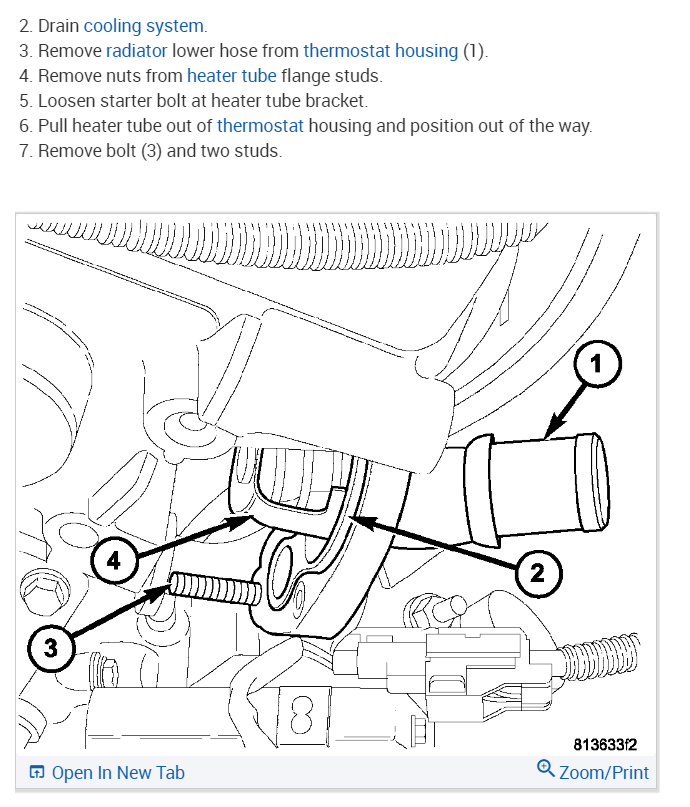

Yes, I was wondering if you could tell me how to change the water outlet housing.
Aug 14, 2023 at 6:50 AM
  • 55,423 POSTS

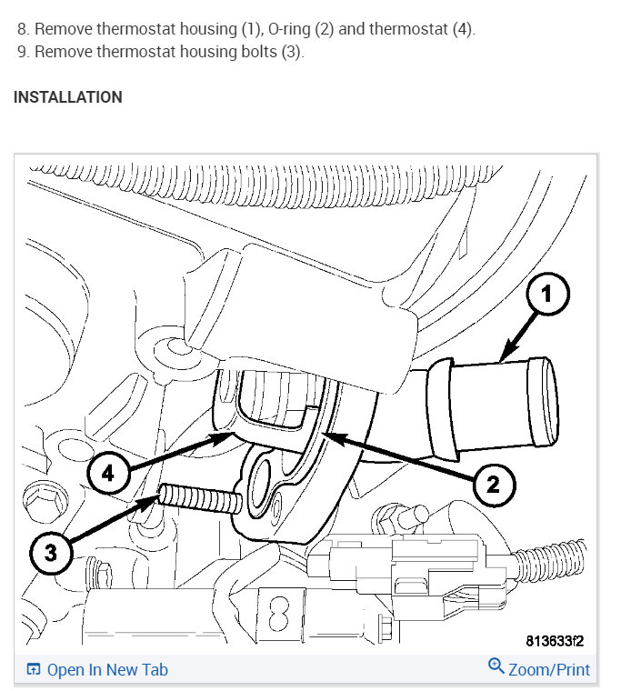

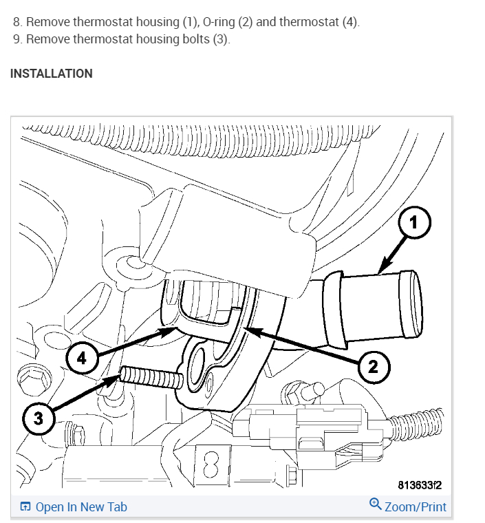

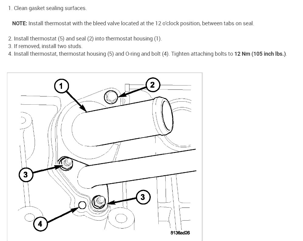

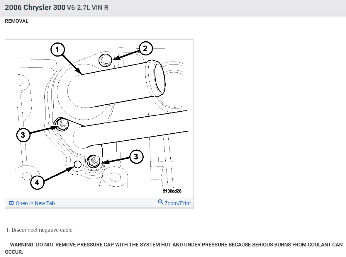

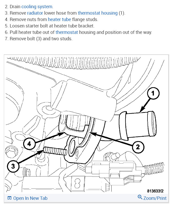

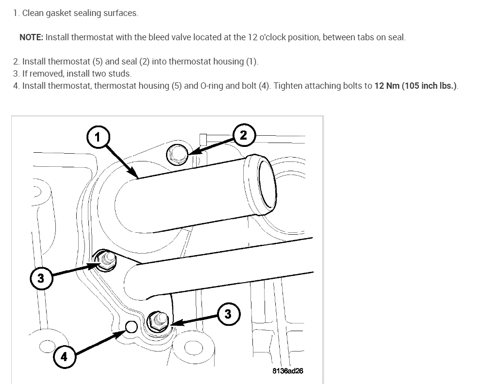

Sure, here are the instructions for changing out the thermostat and outlet hose. Here is a generic guide to help you step by step with instructions in the diagrams below to show you how on your car:
Check out the images (below). Please let us know if you need anything else to get the problem fixed.
