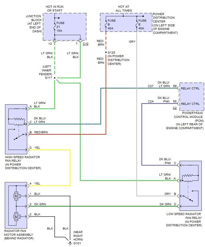

Installed new head gaskets, new thermastat, new rad. Could pcm be the problem. No codes come up, runs good.

Check the cooling fans and the temperature sending switch that controls the fan relays as well as the relays themselves. If you unplug the temp sender the fans should kick on. Check the fuses shown and for power at the relays.
If the fans are operating then check for actual coolant flow from the pump.
Thursday, March 23rd, 2017 AT 1:33 PM
TOM FLATAU
  • 10 POSTS
Both fans were runing when guage went over half between L and H. INSTALLED a new water pump when I had heads off. Will check things on diagram.

OK, what are you calling "overheating" just the gauge? Did it actually overheat and boil? Gauges can be very inaccurate. I would test it with a thermometer and see what temperature it is actually running.

The top hose burns you fingers, I took off new rad having end taken off to see if that could be a flow problem, bottom hose not that hot, new thermostat open at 180 on the stove.

The top hose should be hotter than the bottom, that is how the radiator works, Hot water in the top, cooler water out the bottom. Put an actual thermometer on it and check the real temperature of the coolant. That system normally runs around 200 degrees. Put a scan tool on and see what the computer sees as the operating temperature.

My scan tool only shows codes, My new Rad had lots of blockage. The ran wire down each row, will put it back on monday and test run, no codes up.I think this might solve it.
