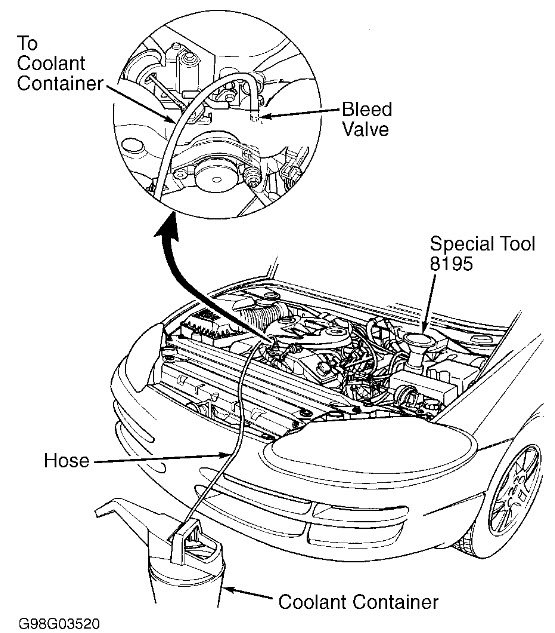

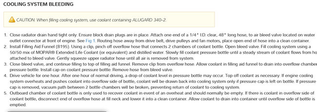

Try bleeding cooling system see pics for instructions on how to do it. May have an air lock in it causing problem.

Do I need special tool 8195 or will this work with out it. What purpose does the hose that goes toward the upper air plenum serve.

The special tool is a funnel
