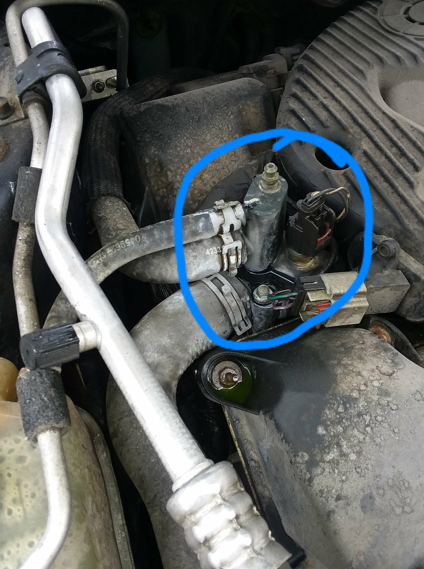

My car started to overheat so I checked coolant added some and ran to the store. I noticed smoke coming from under the hood and looked under the hood and heard the coolant boiling and coolant coming out from the area in the picture. Could someone tell me what this is and why is the coolant squirting out from this area?
Saturday, September 26th, 2020 AT 10:09 AM (Merged)
  • 52,797 POSTS
Good afternoon.
That is an adapter of the upper hose to the upper intake unit. Common area of leaking. I would take this to the dealer, the picture, that is, to the parts department to get the part. It warps over time from heating and cooling and then starts to leak.
What engine? Is this a convertible?

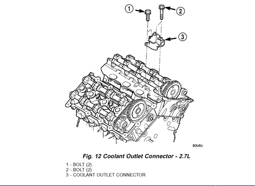

Procedure for this:
2.7L ENGINE
1. Drain cooling system.
2. Remove upper intake manifold.
3. Disconnect Engine Coolant Temperature (ECT) sensor connector.
ImageZoom/Print
4. Disconnect hoses at coolant outlet connector. Use Special Tool 8495 Pliers to remove clamps (Fig. 11).
ImageZoom/Print
5. Remove bolts attaching coolant outlet connector (Fig. 12).
6. Remove coolant outlet connector.
Parts Information OEM Part Price
Water Outlet
Water Outlet 4792630AA 71.70

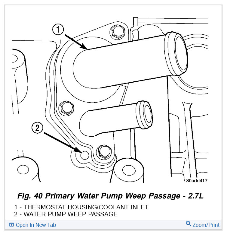

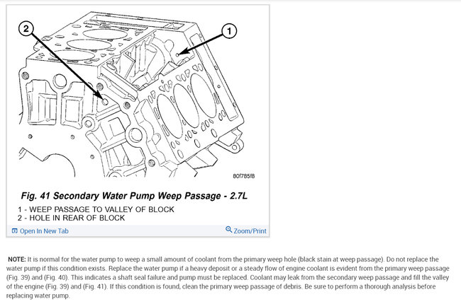

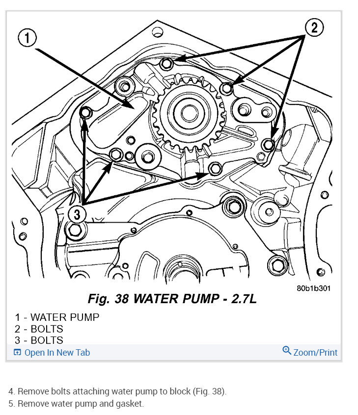

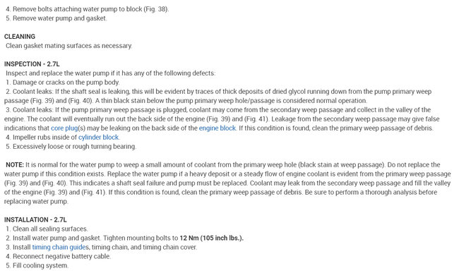

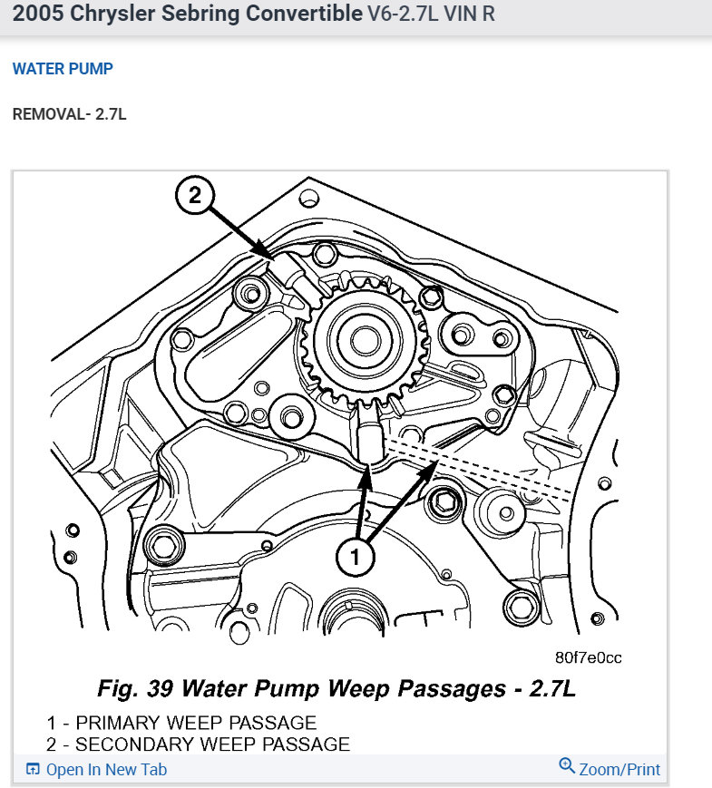

2005 Chrysler Sebring 61K miles 3.7 - Has an overheating problem, boiling water out of the coolant recovery tank but lower radiator house is cold to the touch. Tried replacing the thermostat, but still have the problem. Does not appear to be a head gasket, engine runs fine and fans seem to be working OK. Could it be water pump? No signs of water in the oil or leakage from the weeping hole. At a loss on this one. Any suggestions?
  • 75,992 POSTS

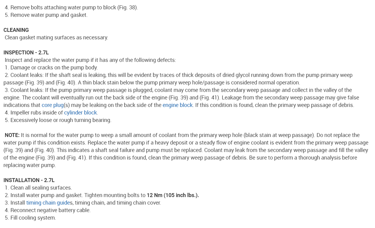

I have seen the water pump impeller go bad and not circulating the coolant correctly here here the instruction in the diagrams below to help you fix the problem.
This guide will walk you through the steps with diagrams below to show you your car.
https://www.2carpros.com/articles/water-pump-replacement
Check out the diagrams (Below). Please let us know what you find.
