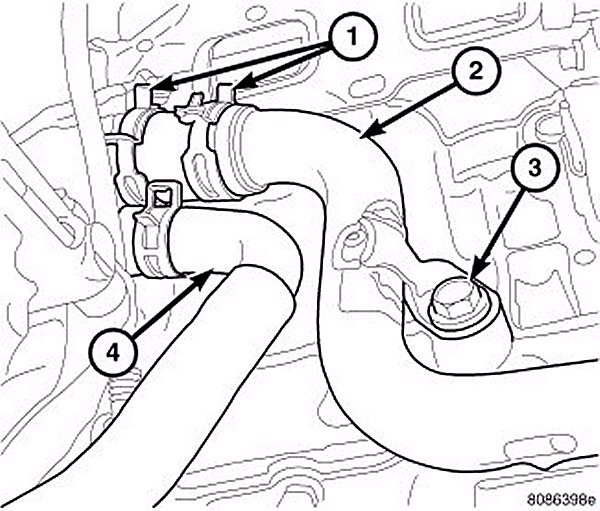

12. Remove radiator hose tube mounting bolt (3).
13. Disconnect hose clamps (1) at thermostat housing.
14. Remove thermostat housing bolts.
15. Remove thermostat and housing.

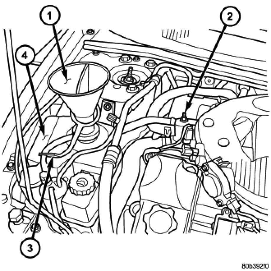

Cooling System Filling - 2.7L
Note: Drain-cock should be hand tightened only.
Note: It is imperative that the cooling system air bleed valve be opened before any coolant is added to the cooling system. Failure to open the bleed valve first will result in an incomplete fill of the system.
1. Close radiator draincock by turning clockwise.
2. Open cooling system bleed valve.
3. Attach a 6.35 mm (0.250 in.) inside diameter clear hose that is 120.0 cm (48 in.) long to the bleed valve. Route the hose away from accessory drive belts and radiator fan. Position the other end of hose into a clean collecting container. The hose will prevent coolant from contacting accessory drive belts and other components.
4. Remove cooling system pressure cap. Attach Filling Aid Funnel 8195, to coolant pressure container filler neck.
5. Use the supplied clip to pinch overflow hose that connects between the two chambers of the pressure container.
6. Pour coolant into the larger section of Filling Aid Funnel (the smaller section of funnel is to allow air to escape).
7. Slowly continue filling until a steady stream of coolant flows from attached hose on bleed valve.
8. Close bleed valve and continue filling system to top of Filling Aid Funnel. DO NOT overtighten. Tighten to 12.4 Nm (110 lbs. in.).
9. Remove clip from overflow hose.
10. Allow coolant in Filling Aid Funnel to drain into overflow chamber of pressure container.
11. Remove Filling Aid Funnel 8195 and install pressure cap on pressure container.
12. Remove hose from bleed valve.
13. Start engine and allow to run until thermostat opens and radiator fans cycle.
Note: If the engine cooling system overheats and pushes coolant into the overflow chamber of the pressure container, this coolant will be drawn back into the cooling system Only if the pressure cap is left on the pressure container. Removing the pressure cap breaks the vacuum path between the two chambers of the pressure container and the coolant will not return to the cooling system. The engine cooling system will push any remaining air into the pressure container within about one half hour of normal driving. As a result, a drop in coolant level in the pressure container may occur.
14. Shut off engine and allow it to cool down. This permits coolant to be drawn into the pressure chamber.
15. With engine cold observe coolant level in pressure chamber. Coolant level should be within MIN and MAX marks. Adjust coolant level as necessary

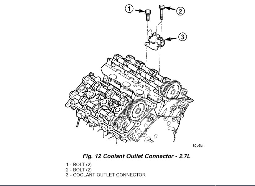

KFINCHY

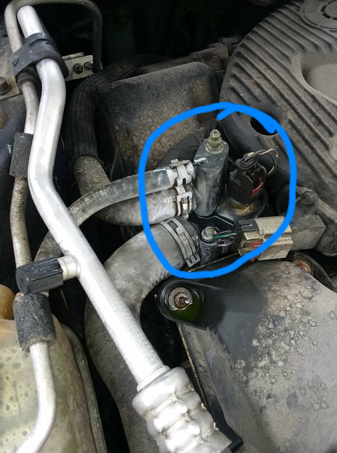

My car started to overheat so I checked coolant added some and ran to the store. I noticed smoke coming from under the hood and looked under the hood and heard the coolant boiling and coolant coming out from the area in the picture. Could someone tell me what this is and why is the coolant squirting out from this area?
Sep 26, 2020 at 3:09 AM (Merged)
Good afternoon.
That is an adapter of the upper hose to the upper intake unit. Common area of leaking. I would take this to the dealer, the picture, that is, to the parts department to get the part. It warps over time from heating and cooling and then starts to leak.
what engine? Is this a convertible?
Procedure for this:
2.7L ENGINE
1. Drain cooling system.
2. Remove upper intake manifold.
3. Disconnect Engine Coolant Temperature (ECT) sensor connector.
imageZoom/Print
4. Disconnect hoses at coolant outlet connector. Use Special Tool 8495 Pliers to remove clamps (Fig. 11).
imageZoom/Print
5. Remove bolts attaching coolant outlet connector (Fig. 12).
6. Remove coolant outlet connector.
Parts Information OEM Part Price
Water Outlet
Water Outlet 4792630AA 71.70
Labor Information Skill Level Mfg. Warranty Standard
Replace
Water Outlet B 0.0 1.8

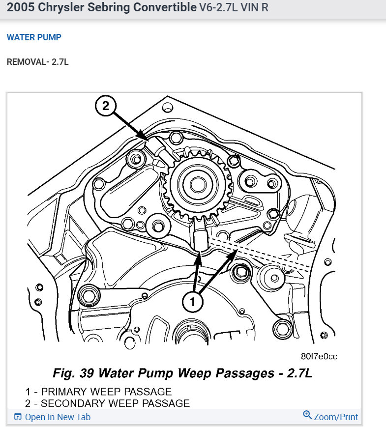

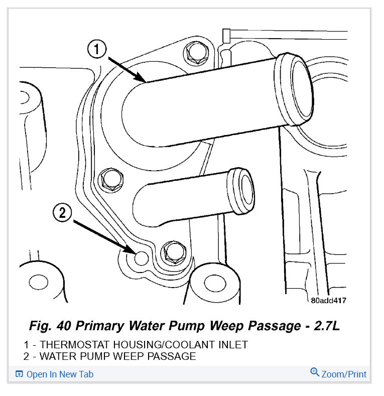

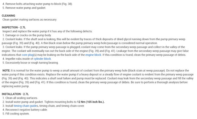

PHOWARTH

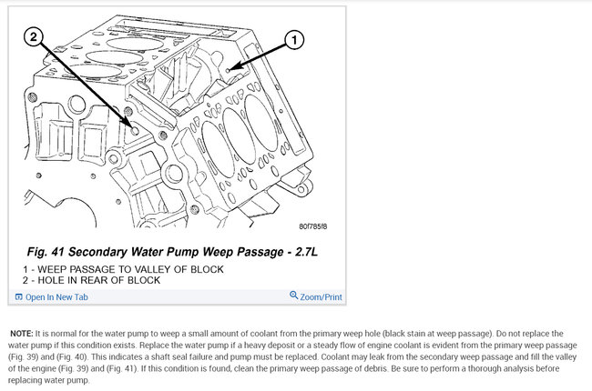

2005 Chrysler Sebring 61K miles 3.7 - Has an overheating problem, boiling water out of the coolant recovery tank but lower radiator house is cold to the touch. Tried replacing the thermostat, but still have the problem. Does not appear to be a head gasket, engine runs fine and fans seem to be working OK. Could it be water pump? no signs of water in the oil or leakage from the weeping hole. At a loss on this one. Any suggestions?
  • 75,992 POSTS

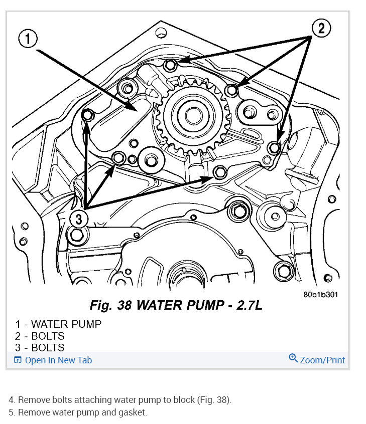

I have seen the water pump impeller go bad and not circulating the coolant correctly here here the instruction in the diagrams below to help you fix the problem.
This guide will walk you through the steps with diagrams below to show you your car.
https://www.2carpros.com/articles/water-pump-replacement
Check out the diagrams (Below). Please let us know what you find.
