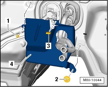

The heat shield is installed in front of the expansion valve, depending on engine.
Loosen, but do not remove, the heat shield and pull it off slightly. The coolant system does not need to be opened.
If Equipped, Loosen the Heat Shield
- Remove nut - 1 - (10 Nm).
- Remove the lock washer - 2 - and the clip - 3 -.
- Loosen the heat shield for the expansion valve - 4 - from the bulkhead.

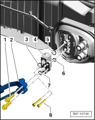

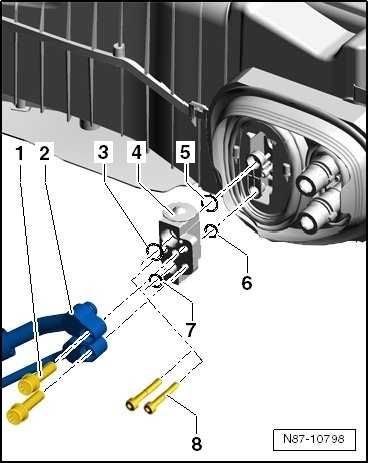

- Remove the bolts - 1 - from the refrigerant line - 2 - (10 Nm).
- Carefully remove the refrigerant lines - 2 - from the expansion valve - 4 -.
- Remove the bolts - 8 - from the expansion valve - 4 - to (5 Nm).
- Carefully remove the expansion valve - 4 - from the heater and A/C unit.
pic 2
Installing
Install the expansion valve in reverse order. Note the following when doing this:
Always replace the O-ring for the high pressure refrigerant line - 3 and 5 -.
Always replace the O-ring for the low pressure refrigerant line - 6 and 7 -.
Lubricate O-ring seal lightly with refrigerant oil before installing.

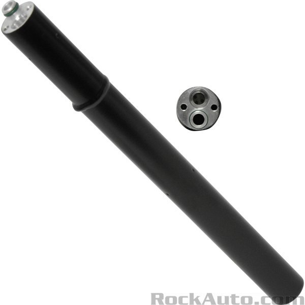

The easiest way would be to find a shop that can evacuate the system, then you do the mechanical work and then return to have it recharged. It can be hard to find a shop that will do that but they are out there. Your car has an accumulator drier that's unique. The image is what it looks like. It is attached to the condenser core behind the bumper.

The drier is not a fun thing, basically you need to remove the entire nose of the car. However you shouldn't need to replace it, you use a vacuum pump and use it to pull a good vacuum and that will remove the moisture from the system. But you really need to use a good gauge set to check the high and low pressures first.

Drier has nothing to do with condensate dripping on the ground. It is installed in the system to catch any moisture that could get into the system if there is a leak or someone tries to top off the refrigerant charge without the proper equipment. It is nothing but a tube with desiccant in it. If you recover the charge and then apply a vacuum it will actually boil any moisture out of the system and the drier as well. So far you have decided to replace parts but haven't actually tested the system to see what the issue is. It could simply be low on charge or contaminated if someone tried sealer or similar on it. You really need to use an actual gauge set first.
