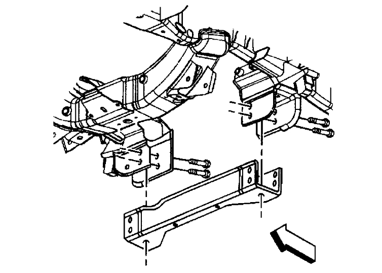

Good morning,
Did you remove the cross bar from the frame?
Jacking up the motor and removing the cross frame is what I do. I had one where I had to unbolt the pick up tube and remove it to get the pan out as well.
Can you upload some pictures of what you see?

Do I have to jack motor up to get oil pan off of 02 chevy 2500 4x4.
I need to replace oring on oil suction tube

Removal Procedure

Fig. 180: View Of Crossbar Bolts & Bar (2WD)
9. Remove the crossbar bolts.
10. Remove the crossbar.

Fig. 202: View Of Crossbar Bolts & Bar (2WD)
15. Install the crossbar.
16. Install the crossbar bolts.
Tighten: Tighten the crossbar bolts to 100 N.M (74 lb ft).
