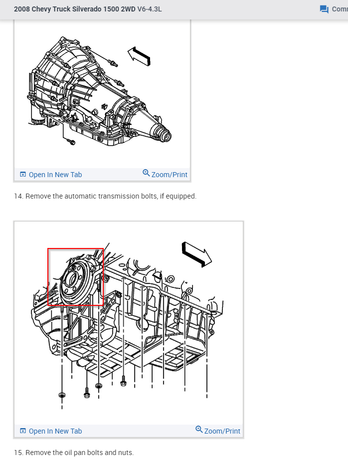

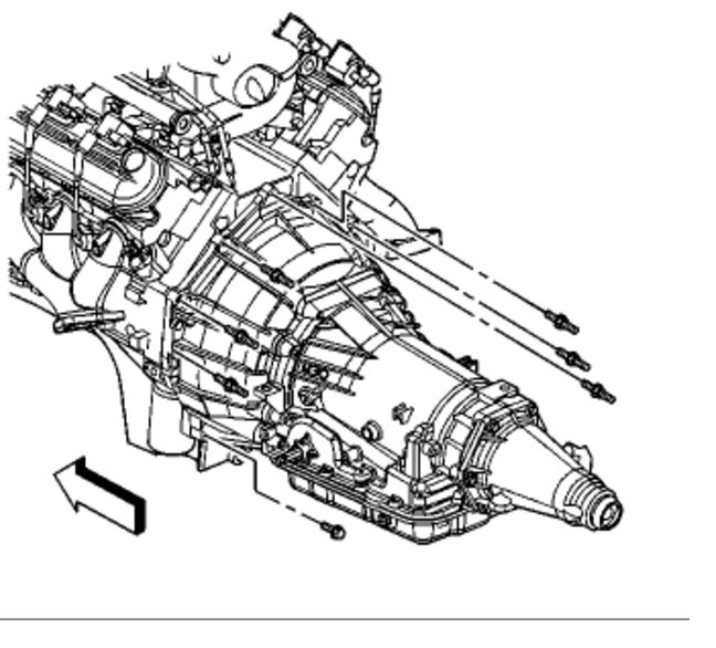

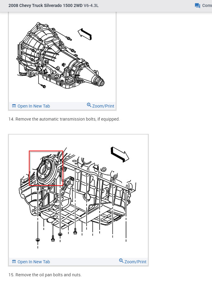

Replacing oil pan gasket,instruction say remove transmission bolts,all not just the ones going through the oil pan. is it necessary to do this?
Jan 27, 2020 at 9:44 AM
From what I remember you do not. There next picture shows the flex plate off so I imagine this was an added step that was not needed. Clearly it never had you take the drive shaft out so you can't move the transmission back. Nor does it tell you to unhook the torque converter so I suspect it is a oversight in the manual. Unfortunately this happened frequently in these types of manuals. They copy and paste from prior years and other services to cut down on editing and I think this one got past them.
I would just go through the process and if some reason you need to, you can always come back and do it.
Jan 27, 2020 at 5:23 PM

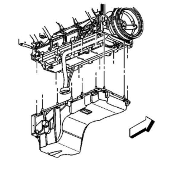

OIL PAN REPLACEMENT
Oil Pan Replacement
Removal Procedure
pic 1

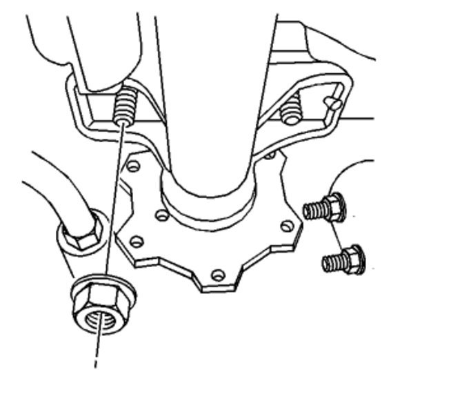

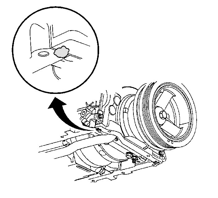

1. If equipped with Four Wheel Drive (4WD), remove the inner axle housing nuts and washers from the bracket.
2. Support the front drive axle with a suitable jack.

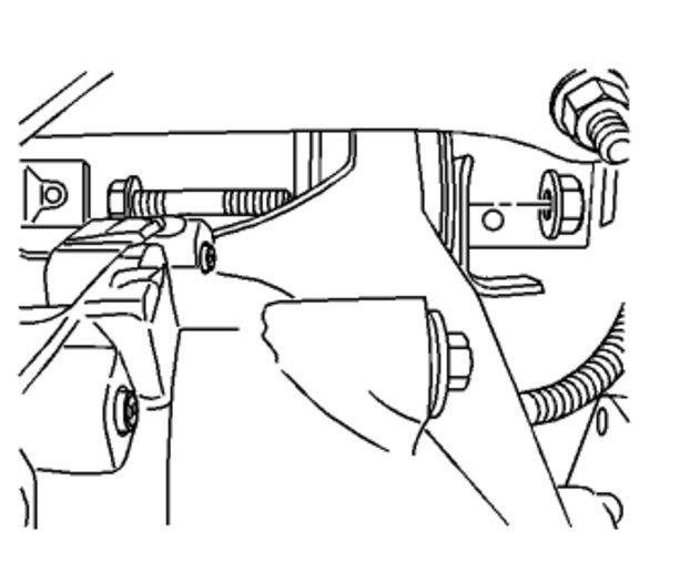

pic 2

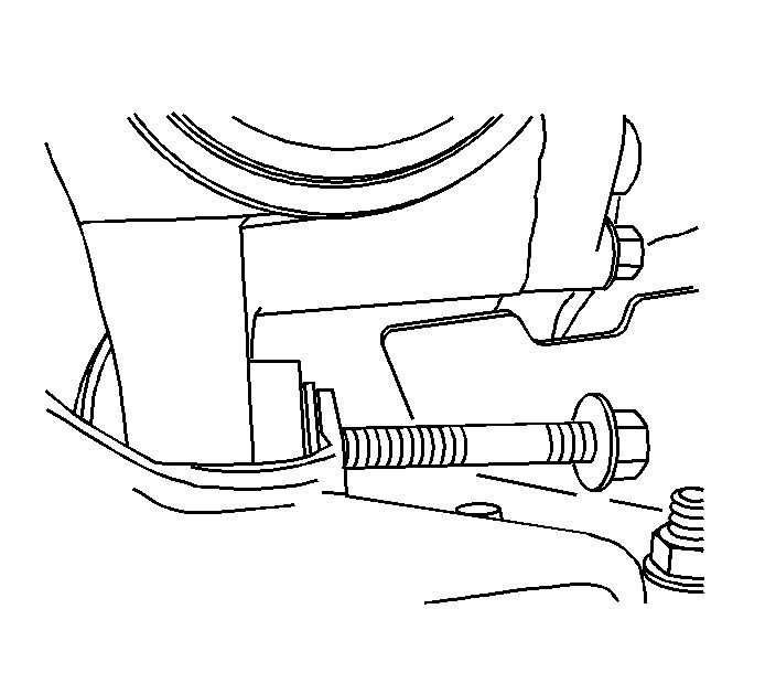

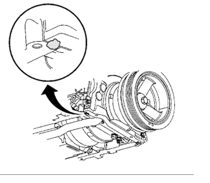

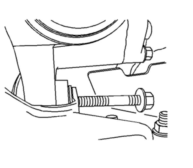

3. If equipped with 4WD, remove the differential carrier lower mounting bolt and nut.
pic 3
4. If equipped with 4WD, remove the differential carrier upper mounting bolt and nut.
5. Lower the front drive axle.

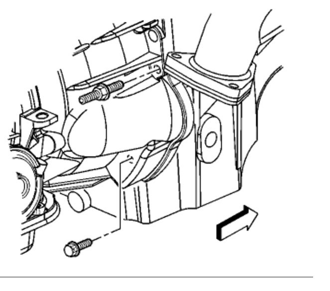

pic 4

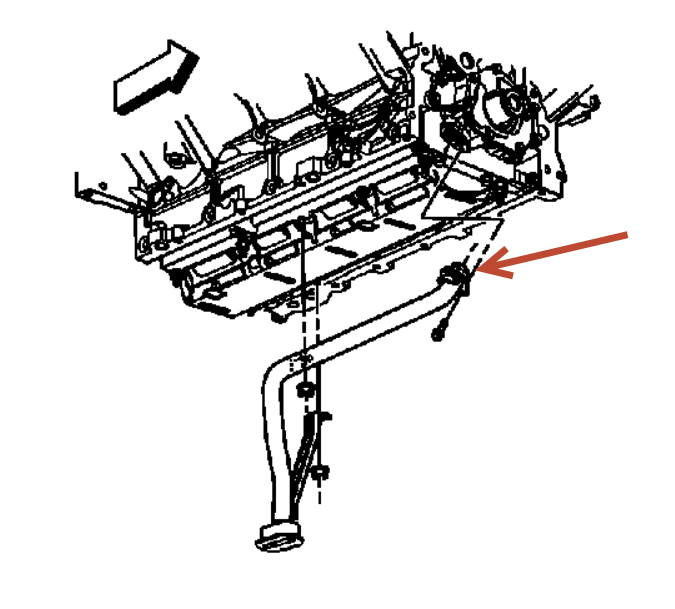

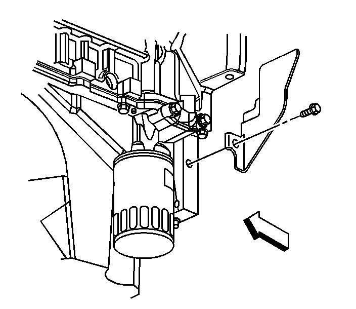

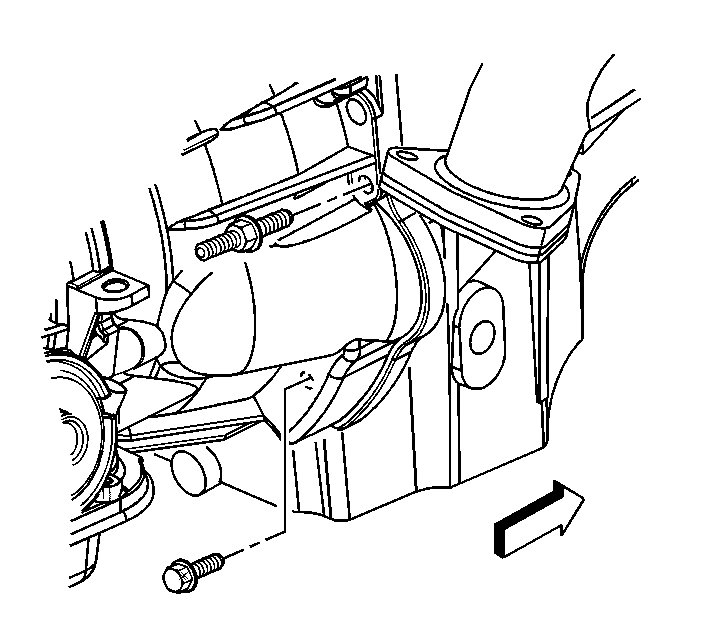

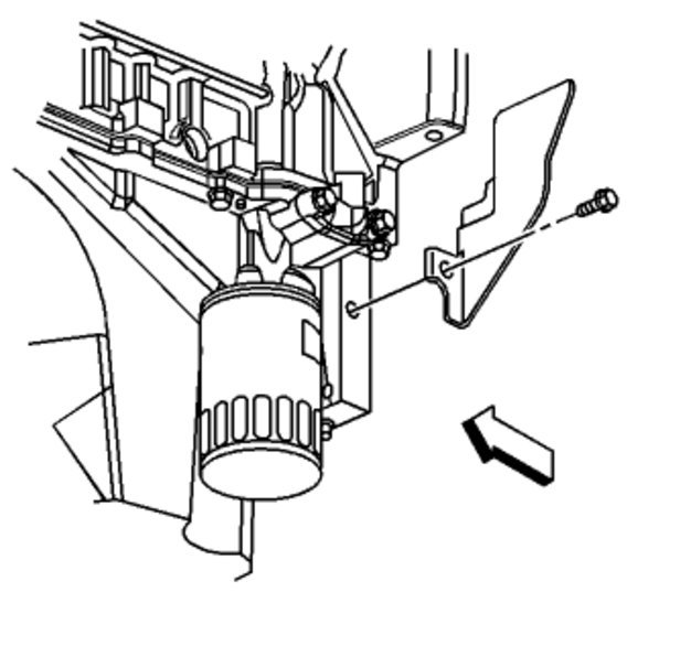

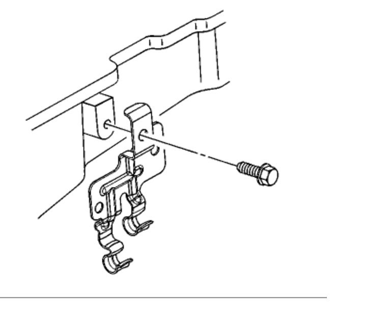

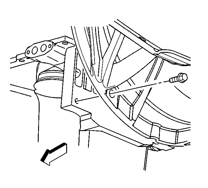

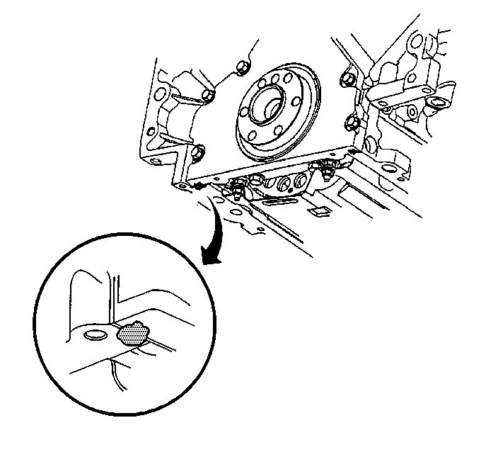

6. Remove the transmission cover bolt.
pic 5

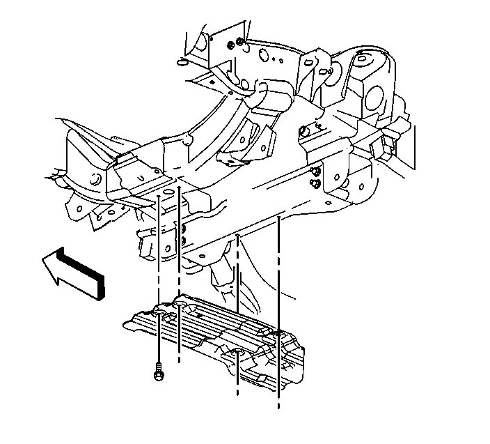

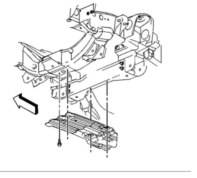

7. If equipped, remove the oil pan skid plate bolts.
8. Remove the oil pan skid plate.

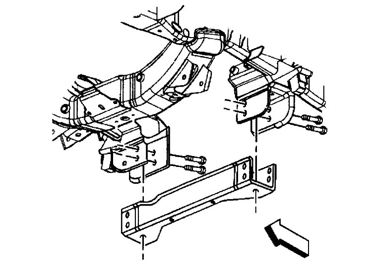

pic 6

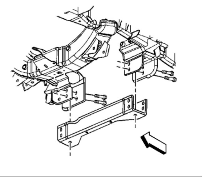

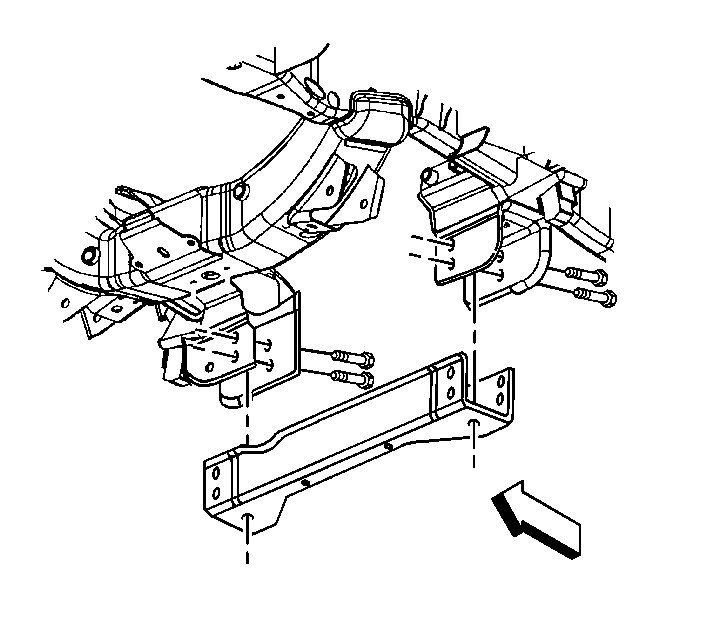

9. Remove the crossbar bolts.
10. Remove the crossbar.
pic 7

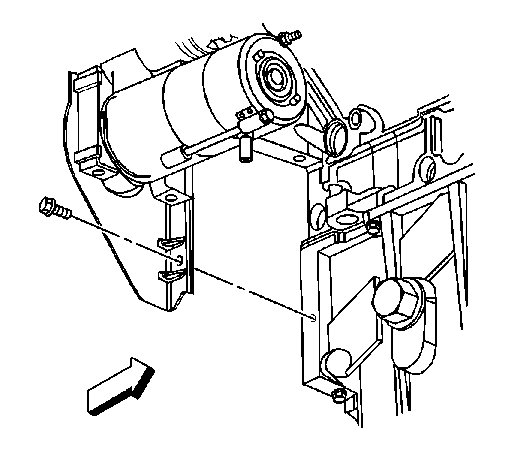

11. Remove the transmission cover bolt and cover.
12. Drain the engine oil and remove the engine oil filter.
13. Re-install the drain plug and oil filter until snug.

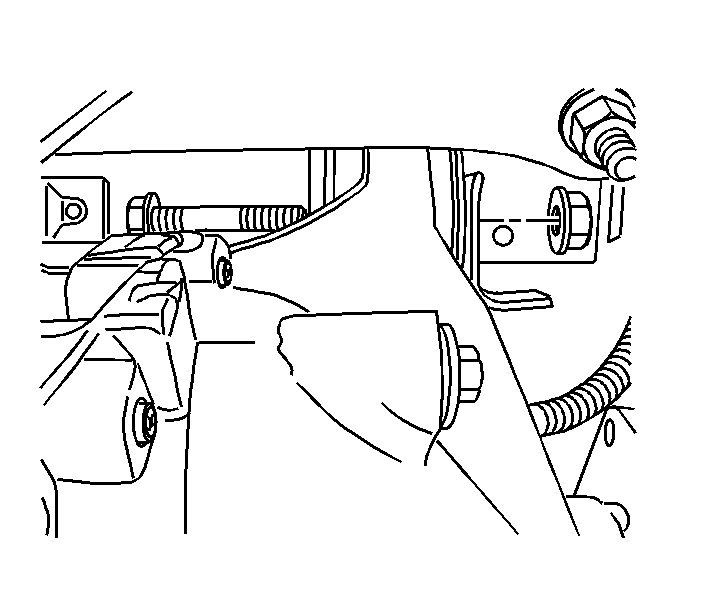

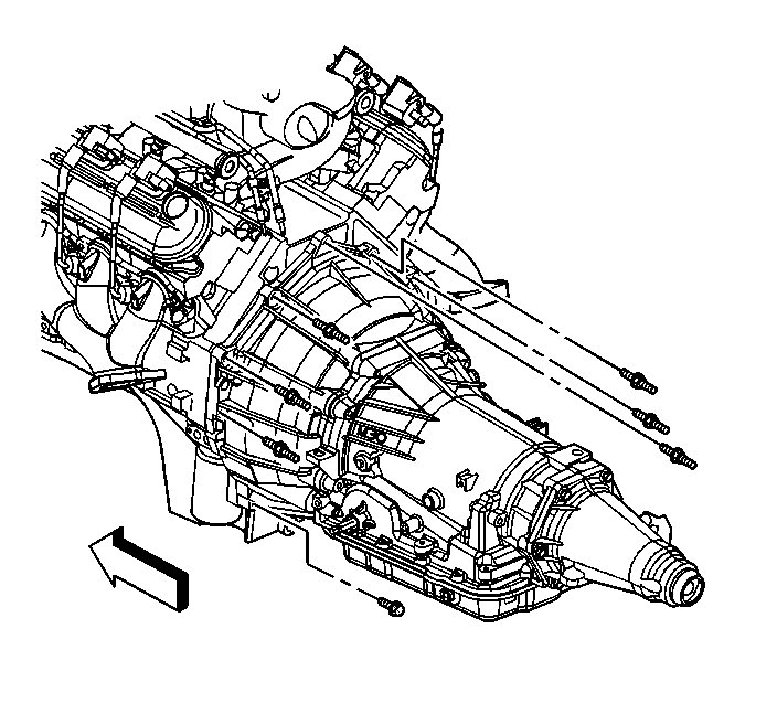

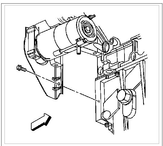

14. If equipped with the 4L60-E automatic transmission, remove the transmission bolt and stud on the right side.
pic 9

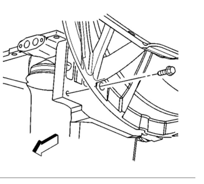

15. Remove the bottom bolt on the left side.
pic 10

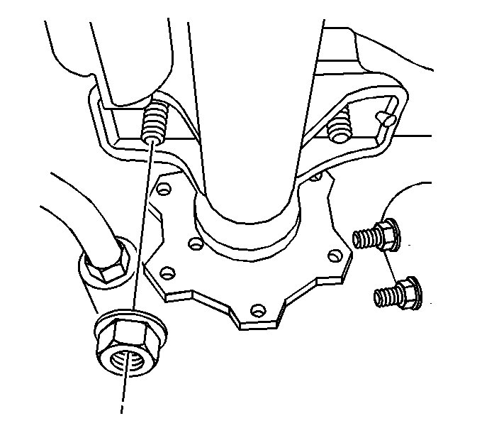

16. If equipped with the 4L80-E automatic transmission, remove the transmission converter cover bolts.

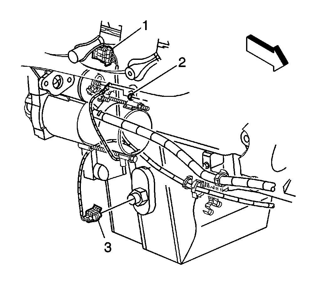

pic 11

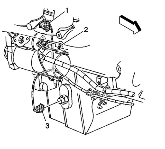

17. Disconnect the oil level sensor electrical connector (3).
pic 12

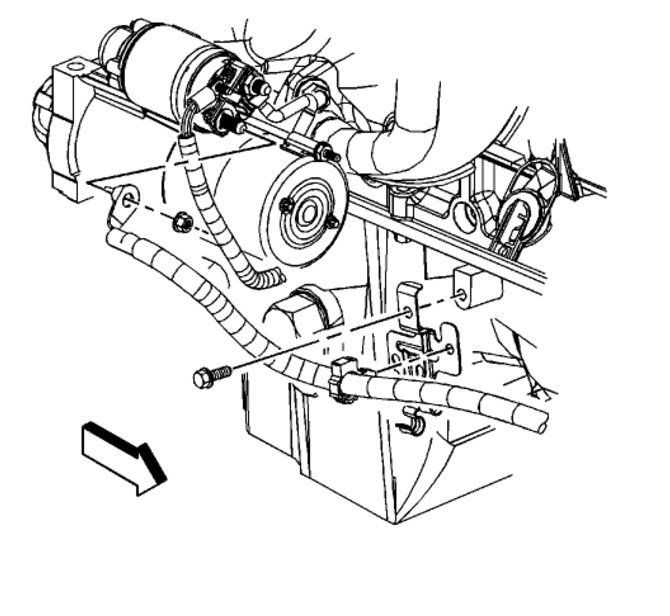

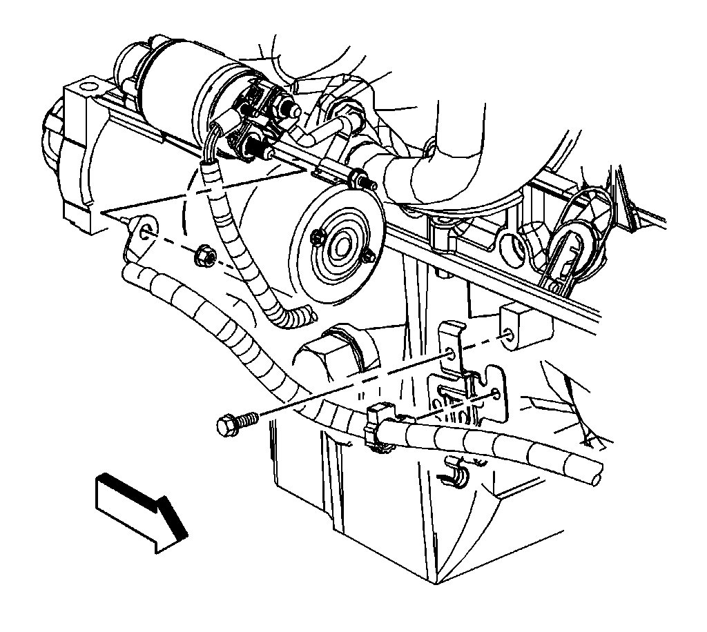

18. Remove the battery cable channel bolt.
19. Slide the channel pin out of the oil pan tab.
pic 13

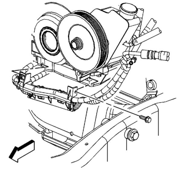

20. Remove the following from the positive battery cable clip:
^ Engine wiring harness clip
^ Positive battery cable clip
pic 14

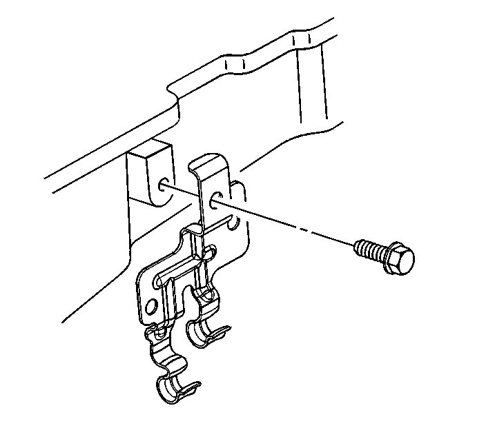

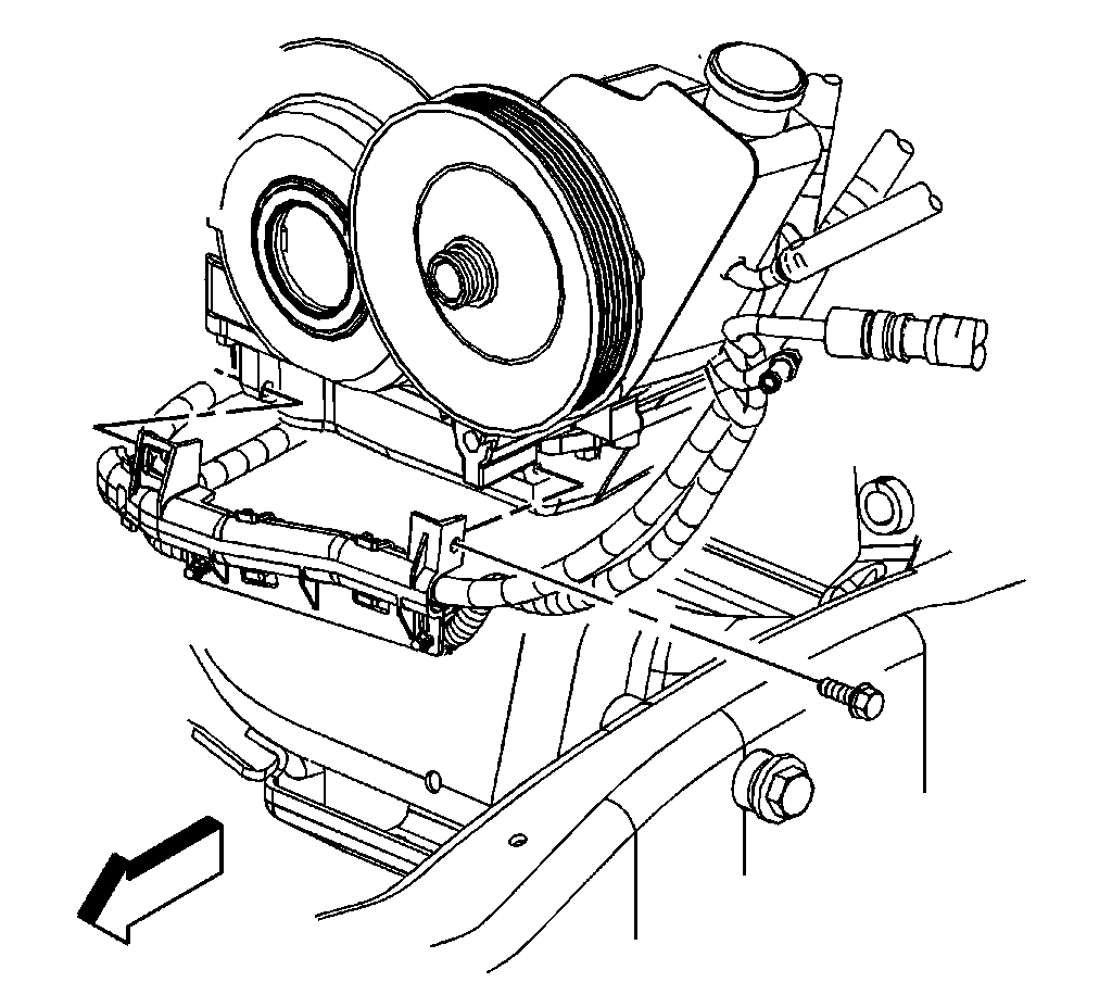

21. Remove the engine oil cooler lines from the positive battery cable clip.
22. Remove the positive battery cable clip bolt and clip.
pic 15

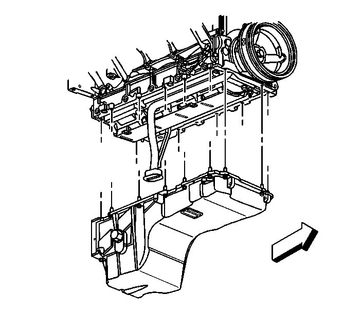

23. Remove the oil pan bolts.
24. Remove the oil pan.
pic 16

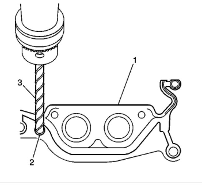

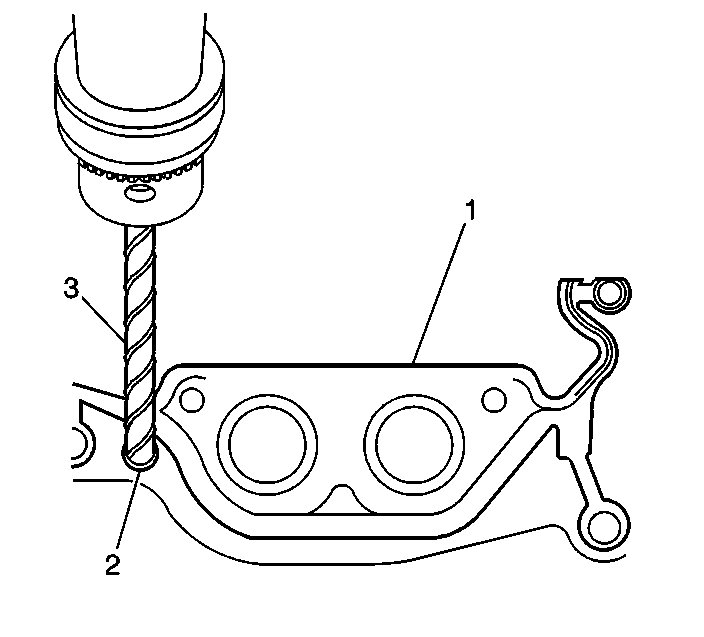

25. Important: DO NOT allow foreign material to enter the oil passages of the oil pan, cap or cover the openings as required.
Drill (3) out the oil pan gasket retaining rivets (2), if required.
26. Remove the gasket (1) from the pan.
27. Discard the gasket and rivets.

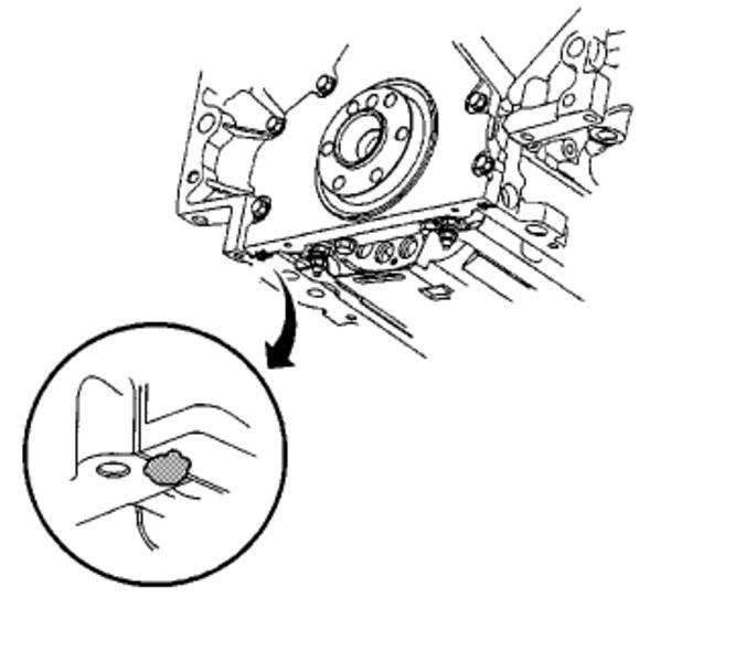

pic 17
1. Apply a 5 mm (0.20 inch) bead of sealant GM P/N 12378190, or equivalent 20 mm (0.80 inch) long to the engine block. Apply the sealant directly onto the tabs of the front cover gasket that protrudes into the oil pan surface.
pic 18
2. Apply a 5 mm (0.20 inch) bead of sealant GM P/N 12378190, or equivalent 20 mm (0.8 inch) long to the engine block. Apply the sealant directly onto the tabs of the rear cover gasket that protrudes into the oil pan surface.

pic 20
6. Install the transmission converter cover bolts until snug, if equipped with the 4L80-E automatic transmission.
pic 21
7. Install the transmission bolt and stud on the right side until snug, If equipped with the 4L60-E automatic transmission.
pic 22
8. Notice: Refer to Fastener Notice in Service Precautions.
Install the bottom bolt on the left side until snug.
1. Tighten the oil pan and oil pan-to-oil pan front cover bolts to 25 Nm (18 lb ft).
2. Tighten the oil pan-to-rear cover bolts to 12 Nm (106 lb in).
3. Tighten the bellhousing, converter cover, and transmission bolts/stud to 50 Nm (37 lb ft).

9. Install the positive battery cable clip and bolt to the oil pan.
Tighten the bolt to 9 Nm (80 lb in).
10. Install the engine oil cooler lines to the positive battery cable clip.

pic 26
14. Connect the oil level sensor electrical connector (3).
pic 27

22. If equipped with 4WD, install the differential carrier upper mounting bolt and nut until snug. Do not tighten at this time.
pic 32
23. If equipped with 4WD, instal the differential carrier lower mounting bolt and nut.
Tighten the bolts to 100 Nm (75 lb ft).
pic 33
24. If equipped with 4WD, install the inner axle housing washers and nuts to the bracket.
Tighten the nuts to 100 Nm (75 lb ft).

Removal Procedure
Fig. 175: View Of Inner Axle Housing Nuts
1. If equipped with four wheel drive (4WD), remove the inner axle housing nuts and washers
from the bracket.
Fig. 176: View Of Differential Carrier Lower Mounting Bolt
Fig. 177: View Of Differential Carrier Upper Mounting Bolt
Fig. 178: View Of Transmission Cover Bolt
6. Remove the transmission cover bolts.

Fig. 180: View Of Crossbar Bolts & Bar (2WD)

Fig. 182: Identifying Stud & Bolt Securing Transmission To Engine (Right Side)
the right side.
Fig. 183: Identifying Six Studs & One Bolt Securing Transmission To Engine
Fig. 184: View Of Transmission Converter Cover Bolt (4L80-E)
bolts.

Fig. 186: Identifying Electrical Connector (Right Side Of Engine)
18. Disconnect the oil level sensor electrical connector (6).
Fig. 187: View Of Positive Battery Cable, Channel & Bolt
19. Remove the battery cable channel bolt.
20. Slide the channel pin out of the oil pan tab.
Fig. 188: View Of Positive Battery Cable Clip & Bolt
21. Remove the positive battery cable clip bolt and clip.
Fig. 189: Oil Pan & Bolts
22. Remove the oil pan bolts.
23. Remove the oil pan.
Fig. 190: Oil Pan Gasket Retaining Rivets
24. Drill (3) out the oil pan gasket retaining rivets (2), if required.
25. Remove the gasket (1) from the pan.
IMPORTANT: DO NOT allow foreign material to enter the oil passages of the oil
26. Discard the gasket and rivets.

Fig. 191: View Of Sealant Applied To Front Oil Pan-To-Engine Block Junction
1. Apply a 5 mm (0.20 in) bead of sealant GM P/N United States 12378190, or equivalent 20 mm
(0.80 in) long to the engine block. Apply the sealant directly onto the tabs of the front cover
Fig. 192: View Of Sealant Applied To Rear Oil Pan-To-Engine Block Junction
2. Apply a 5 mm (0.20 in) bead of sealant GM P/N United States 12378190, or equivalent 20 mm
(0.8 in) long to the engine block. Apply the sealant directly onto the tabs of the rear cover
Fig. 193: Oil Pan & Bolts
3. Pre-assemble the oil pan gasket to the pan.
? Install the gasket onto the pan.
? Install the oil pan bolts to the pan and through the gasket.
4. Install the oil pan, gasket and bolts to the engine block.
5. Tighten the oil pan bolts until snug. Do not overtighten.

Fig. 196: Identifying Stud & Bolt Securing Transmission To Engine (Right Side)
8. Install the transmission bolt and stud on the right side until snug, If equipped with the 4L60-E
Fig. 197: Identifying Six Studs & One Bolt Securing Transmission To Engine
9. Install the bottom bolt on the left side until snug.

Fig. 198: View Of Positive Battery Cable Clip & Bolt
10. Install the positive battery cable clip and bolt to the oil pan.
Tighten: Tighten the positive battery cable clip bolt to 9 N.m (80 lb in).
Fig. 199: View Of Positive Battery Cable, Channel & Bolt
11. Slide the channel pin in to the oil pan tab.
12. Install the battery cable channel bolt.
Tighten: Tighten the battery cable channel bolt to 12 N.m (106 lb in).
Fig. 200: Identifying Electrical Connector (Right Side Of Engine)
13. Connect the oil level sensor electrical connector (6).
Fig. 201: View Of Left Closeout Cover & Bolt
14. Install the transmission cover and bolt.
NOTE:
Refer to Fastener Notice in Cautions and Notices.
Tighten: Tighten the transmission cover bolt to 12 N.m (106 lb in).
Fig. 202: View Of Crossbar Bolts & Bar (2WD)
15. Install the crossbar.
16. Install the crossbar bolts.
Tighten: Tighten the crossbar bolts to 100 N.m (74 lb ft).
Fig. 203: Identifying Oil Pan Skid Plate
17. If equipped, install the oil pan skid plate.
18. Install the oil pan skid plate bolts.
Tighten: Tighten the oil pan skid plate bolts to 20 N.m (15 lb ft).

Fig. 205: View Of Differential Carrier Upper Mounting Bolt
20. Raise the front drive axle into position.
21. If equipped with 4WD, install the differential carrier upper mounting bolt and nut until snug.
Fig. 206: View Of Differential Carrier Lower Mounting Bolt
22. If equipped with 4WD, install the differential carrier lower mounting bolt and nut.
Tighten: Tighten the bolts to 100 N.m (75 lb ft).
