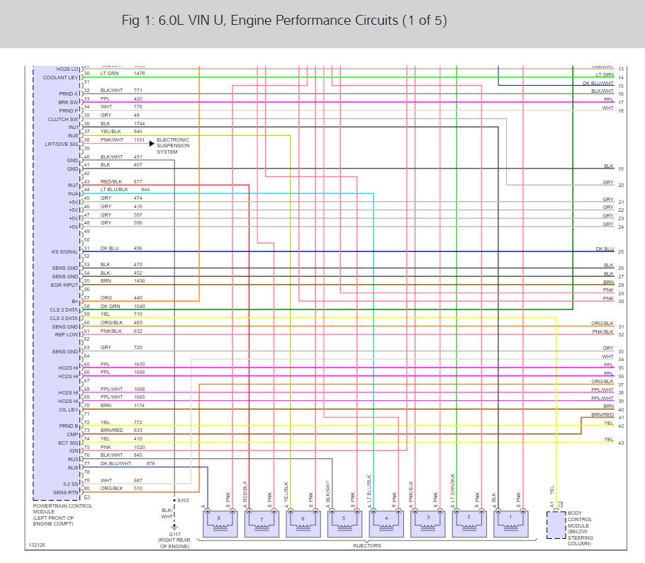

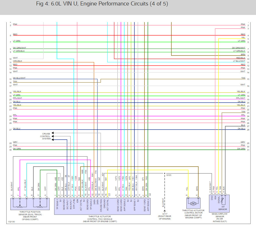

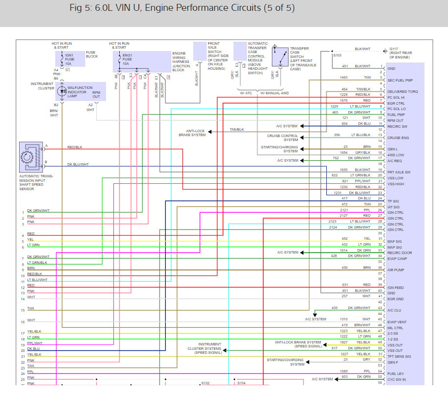

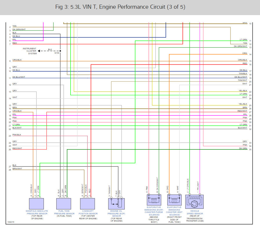

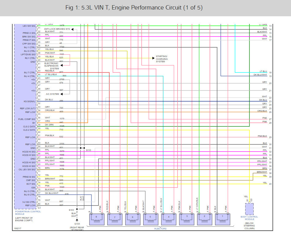

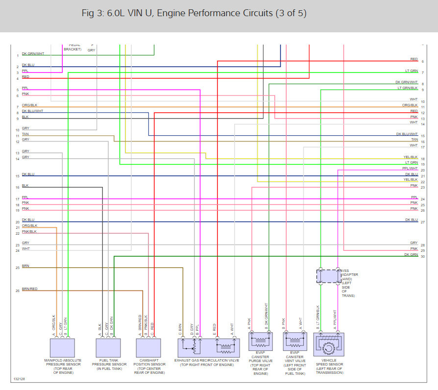

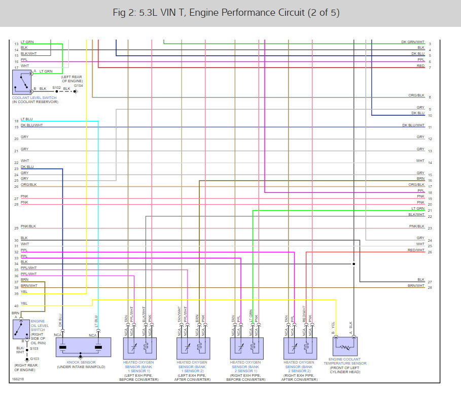

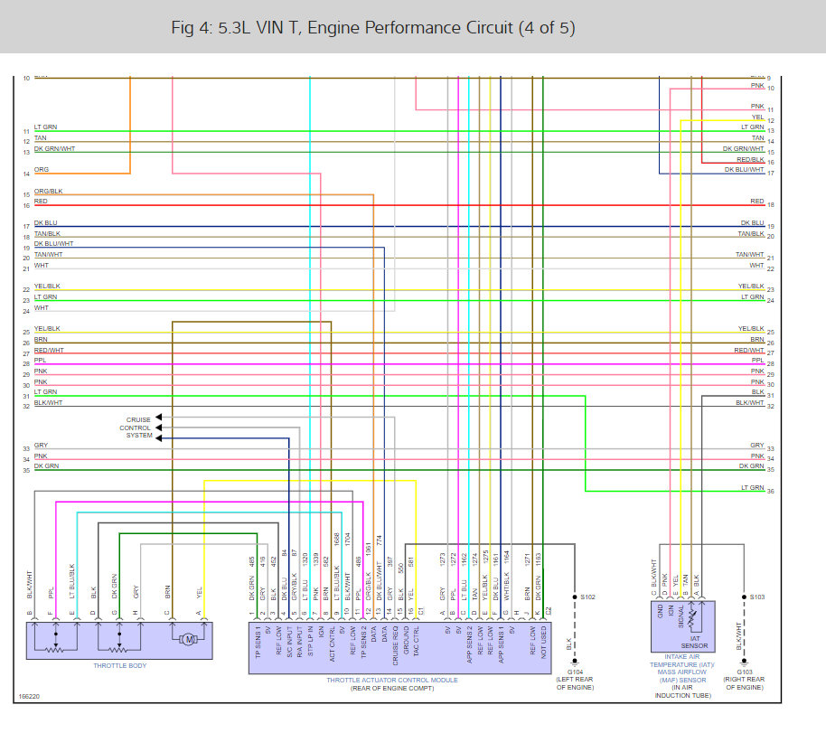

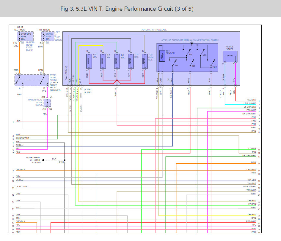

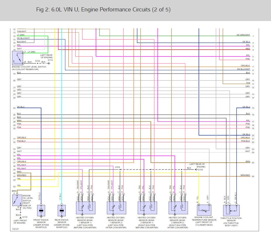

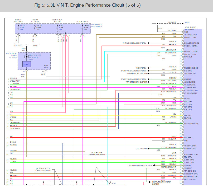

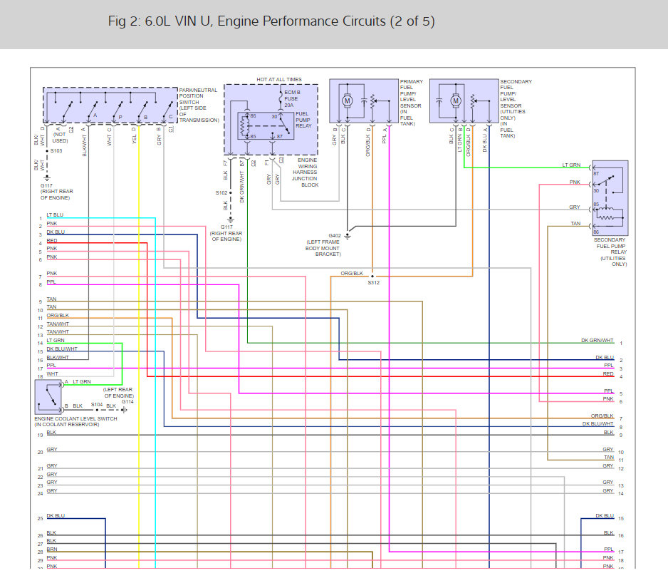

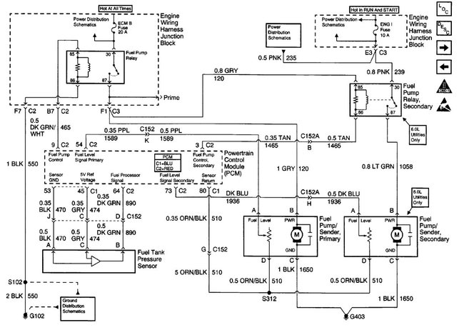

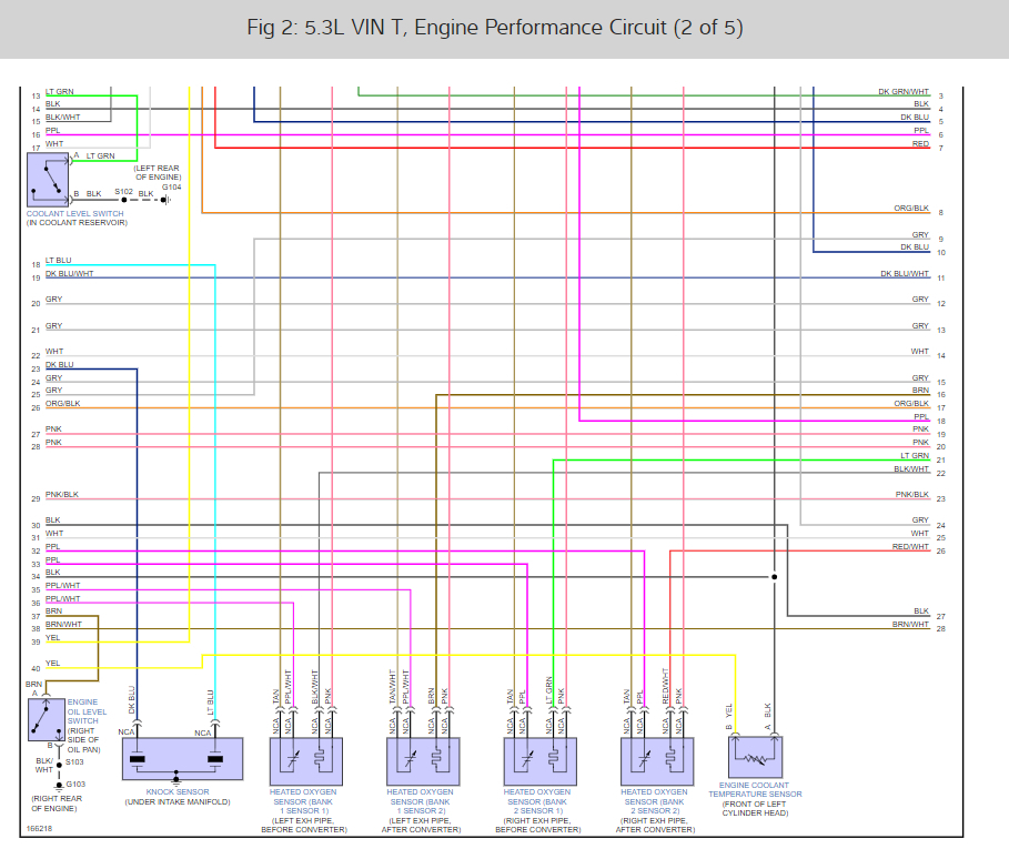

If you disconnect the fuel pump while battery is hooked up will you have to retrieve the check engine code and clear it to restart engine? I need the fuel pump wiring
Aug 29, 2016 at 8:22 AM
HMAC300
  • 48,601 POSTS
if engine is running yes if check engine light goes on. you'll need a scanner to remove the code if there is one. However, you will not have to clear the codes in order to start the engine. The vehicle should run if you shut the key off, plug everything back in and then start the engine. Basically the PCM will see the circuit is intact again and the codes will go stored and allow the engine to start.

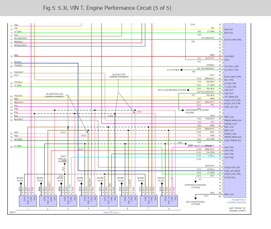

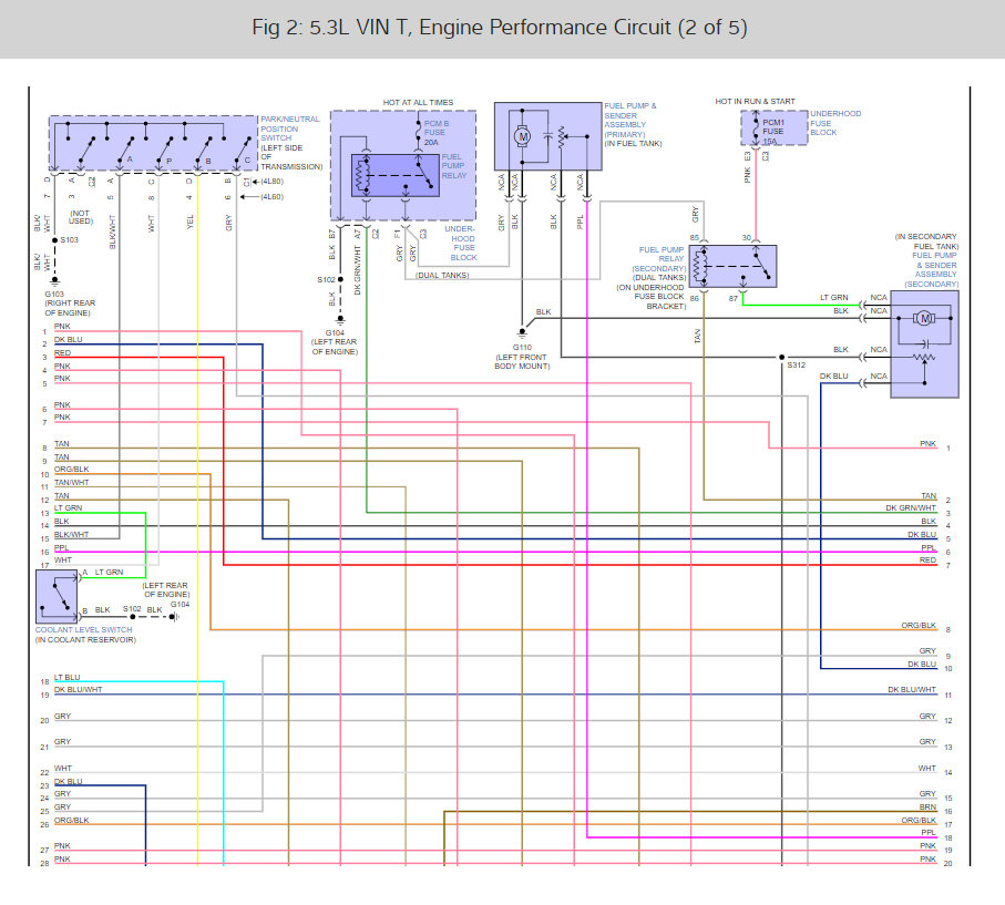

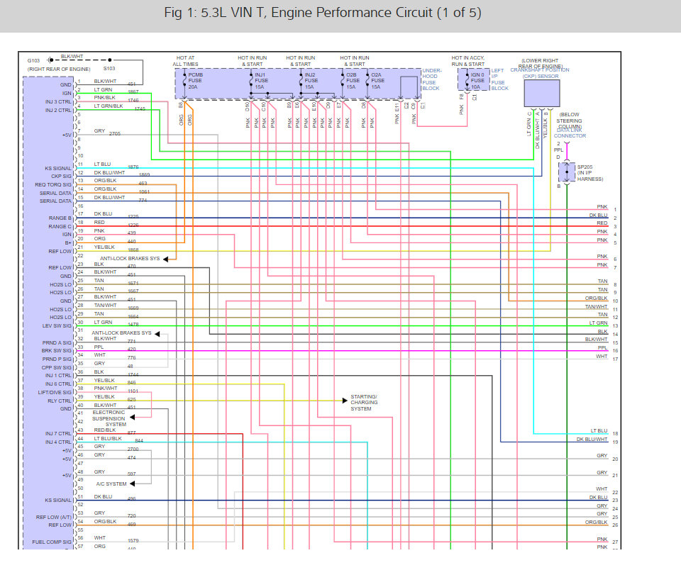

Here are the wiring diagrams requested they are for the fuel pump and engine wiring with a guide to show how you do the testing
Check out the diagrams (Below). Please let us know what you find. We are interested to see what it is.

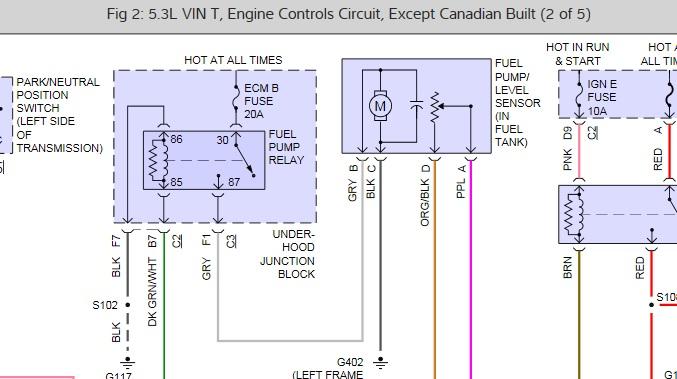

I can't find a (COMPLETE )Fuel pump diagram for this vehicle any where. Hope you can help.
Jun 23, 2020 at 10:35 AM (Merged)
JDL
  • 16,098 POSTS
This may be the same wiring diagram that you have? For the pump itself, gray wire is voltage, black wire is ground. The other two wires are for dash gage. The coil side of relay, dark green wire with white tracer is voltage from computer. Black wire is constant ground. Here are the complete engine and fuel pump wiring diagrams. Check out the diagrams (Below). Please let us know if you need anything else to get the problem fixed.

Getting no electricity to gray wire at fuel pump. Where does the wire go?
Nov 25, 2020 at 11:51 PM (Merged)
WRENCHTECH
  • 20,758 POSTS
How are you testing this? It only powers for two seconds when the key is first turned on and resumes when the computer see and RPM signal from cranking.
OUTLAWMOM
  • 6 POSTS
OK, if we run a hot wire to fuel pump it turns on. Someone suggested it could be the oil pressure sensor switch. What are your thoughts on that? Everything else has been replaced and a test light on all plugs and fuses shows juice.
WRENCHTECH
  • 20,758 POSTS
The oil pressure switch is just a redundant power supply to the pump and it can only effect the circuit if it is shorted out. Unplugging it would quickly answer that question. You didn't answer my question about how you are testing this. It only powers for 2 seconds when the key is turned on. https://www.2carpros.com/images/external/58832972.gif
