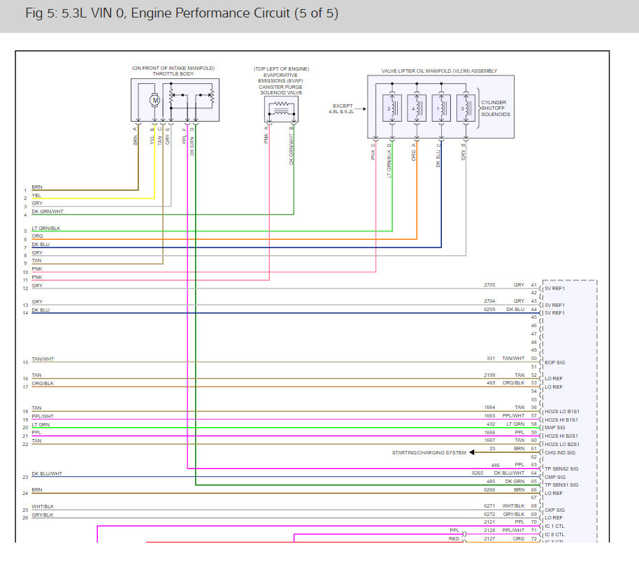

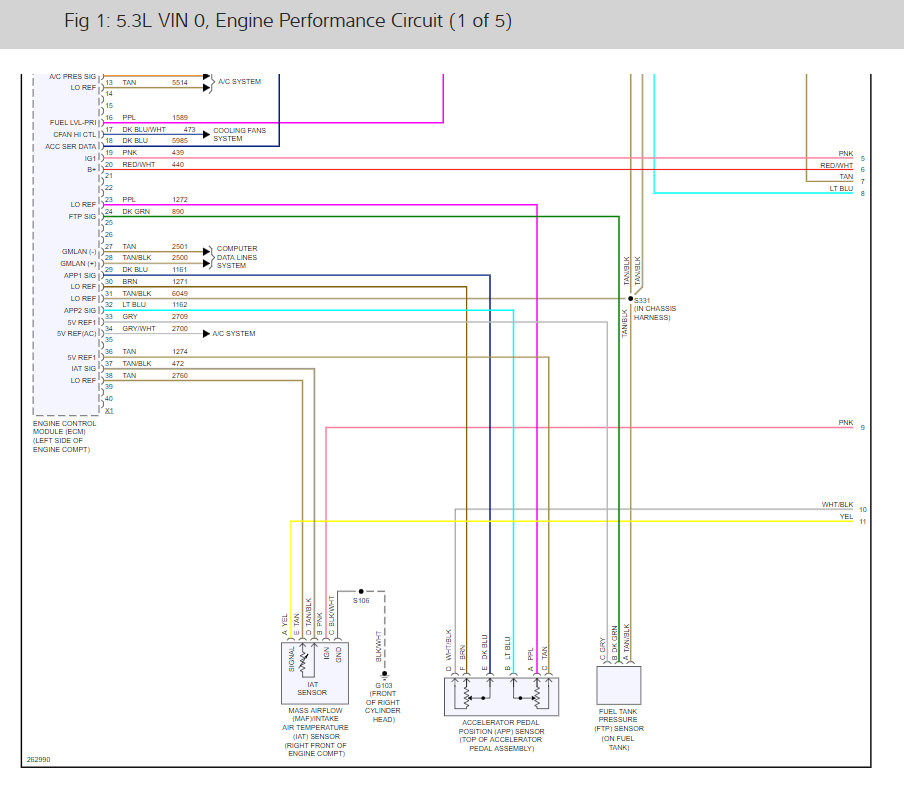

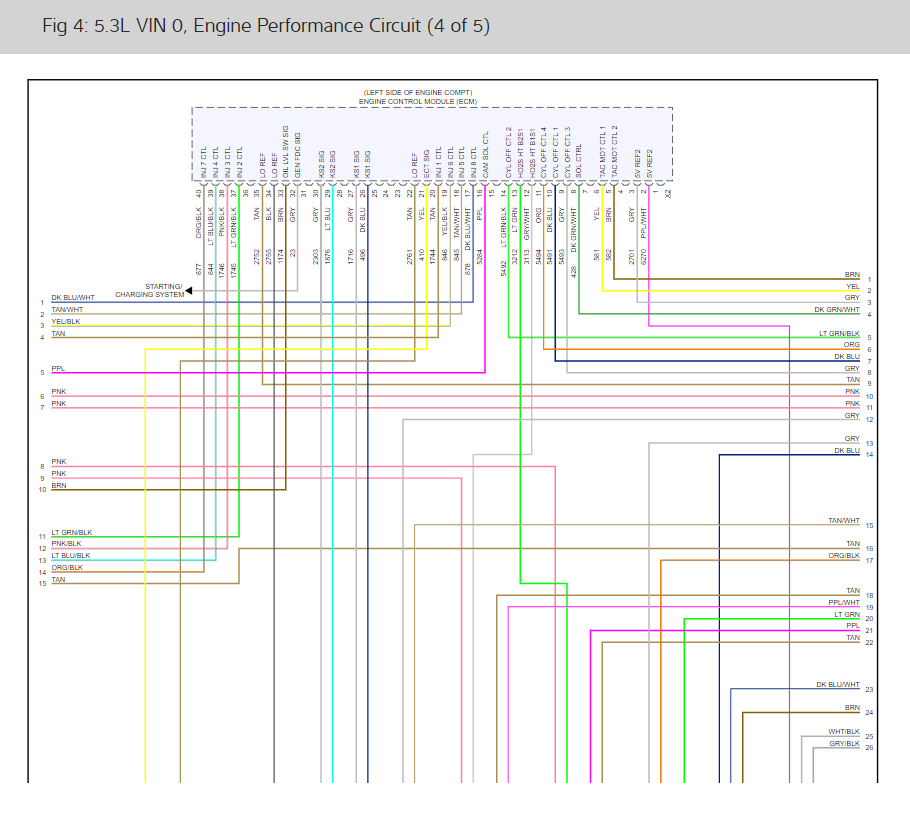

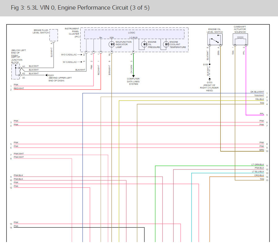

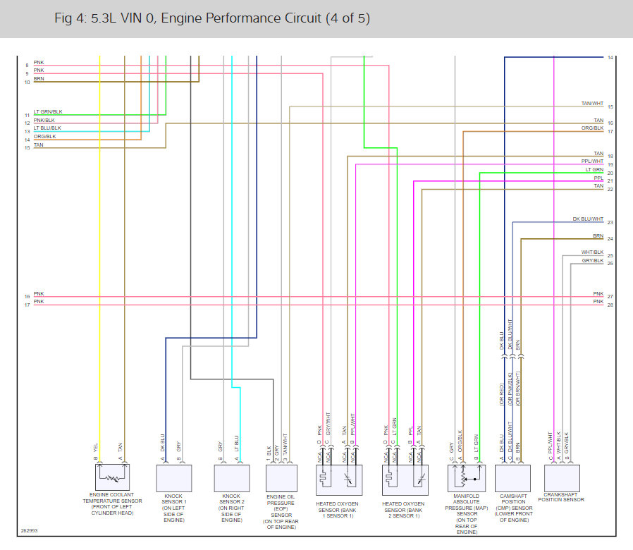

I have pulled the dummy fuse in the main fuse block under the hood but cant find the wire under the hood that I am to connect to the #1 post to make the plug connection hot for my trailer battery. Where is it and or what does it look like ? Thank you, MM9
Jul 5, 2010 at 7:51 AM
JIM SHIRRON
  • CERTIFIED EXPERT
  • 77 POSTS
Here is the engine wiring diagrams I found for you with a guide on how to check the wiring.
Check out the diagrams (Below). Please let us know what you find.

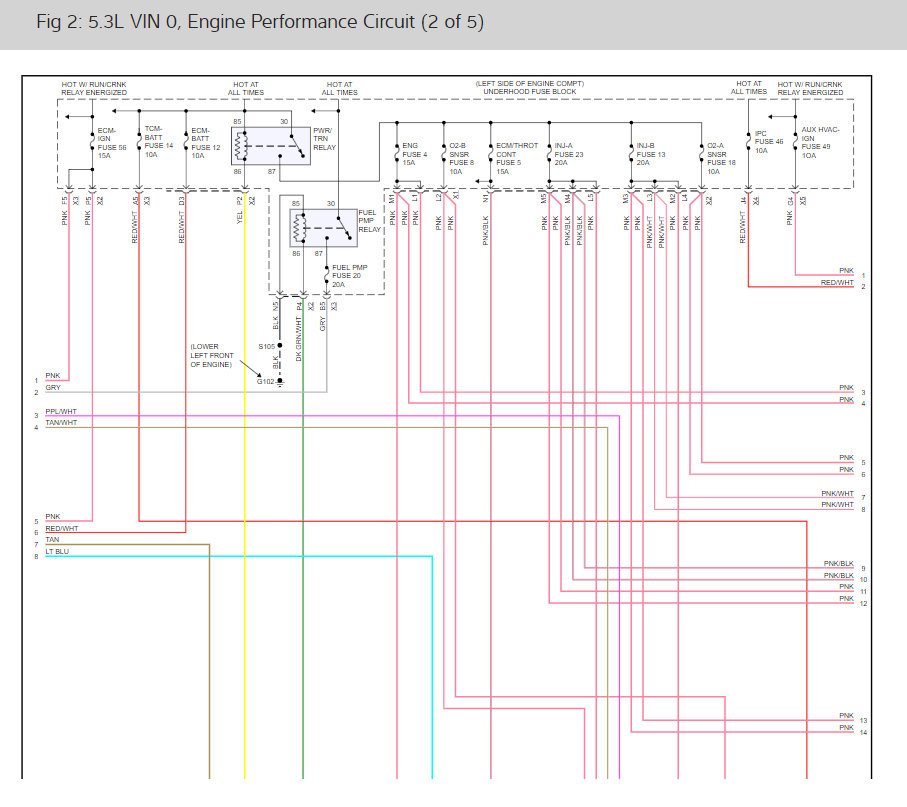

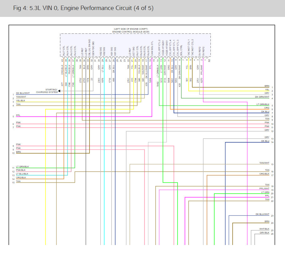

Electrical problem
2003 Chevy Silverado V8 Two Wheel Drive Automatic
I need to locate the fuel pump wire under hood.
May 7, 2020 at 1:17 PM (Merged)
  • CERTIFIED EXPERT
  • 75,992 POSTS
The fuel pump wire you are looking for is in the fuel pump relay socket that powers the fuel pump when the fuel pump relay energizes. Its the gray wire
CSMITH1973

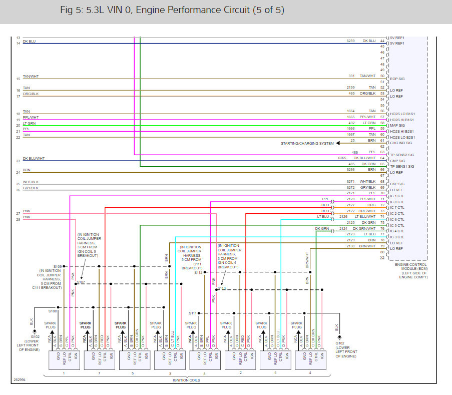

I lost all of the power do you have the engine wiring ?
SCOTTY DEE
  • CERTIFIED EXPERT
  • 592 POSTS
Check out the diagrams in the post above.
