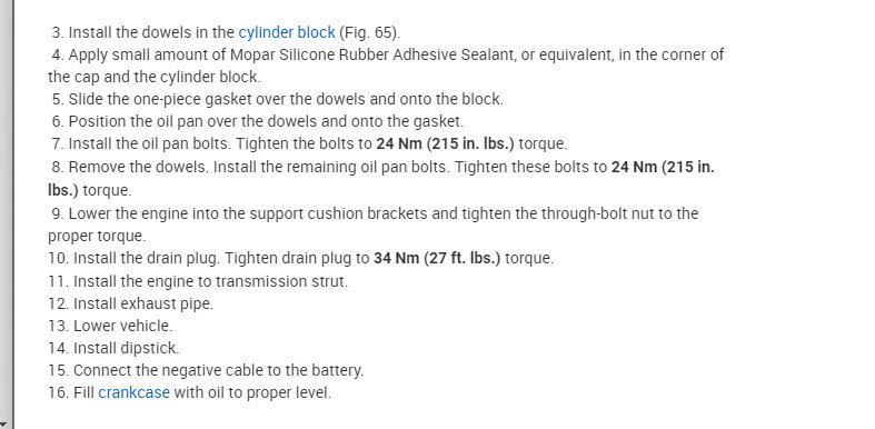

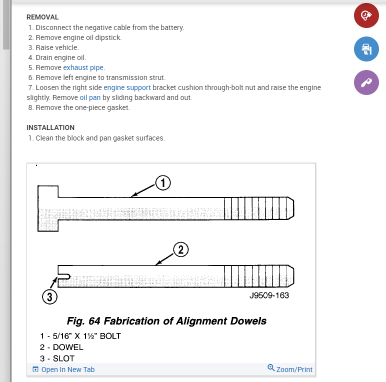

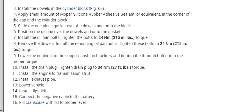

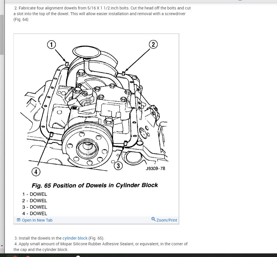

Yes. You do need to use silicone in each corner, but I attached the instructions for your review.
As for the black silicone, that will be fine. Just make sure you read the instructions on it. I believe it requires about an hour to set up and then you torque the pan and then you let it sit for 24 hours.
Take a look at this info and let me know if you need more info.
Thanks
