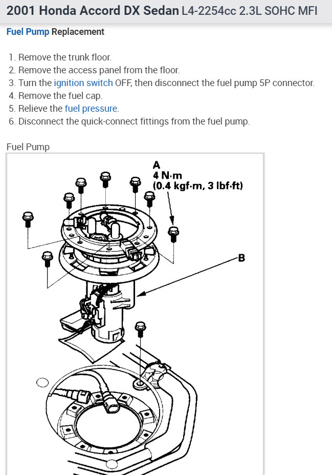

Over the past two weeks or so, my car is having trouble starting, but probably only about 1 out of 20 tries, so only occasionally. The crank is very strong, but when this issue occurs, it won't start until trying multiple times. Today it took about 10 tries before it started, which is the worst I've experienced so far.
I suspect a fuel related issue, but then I would expect to have an issue while driving as well, but so far it has not stalled once. Once starting the car runs great and continues to start normally and quickly for the next many tries.
Part of the reason that I suspect a fuel issue is that when the car would crank but not start, I tried just turning the key to the "on" position without starting it, and I could not hear the fuel pump cycling on. Then once it finally started and drove to where I was going and parked, I shut the car off, and turned the key to "on" and I did hear the fuel pump cycle on that time.
I don't necessarily want to point to the fuel system or fuel pump as the issue, but just wanted to give as much information as possible.
How can I determine if the fuel pump (or maybe a relay or some other fuel system component) is the issue?What are some other possible causes for this type of intermittent starting issue?

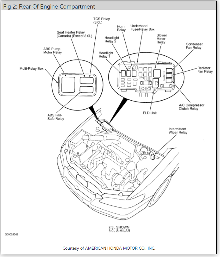

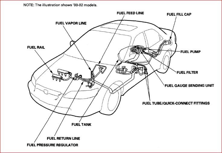

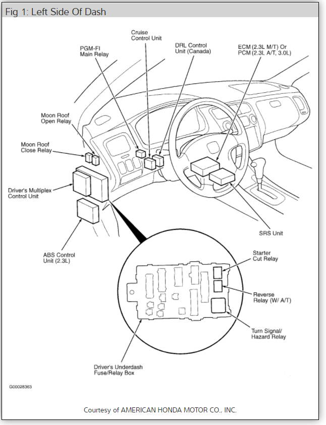

Hi Benlee,
I agree that this sounds like a fuel issue. Next time this does it, crank it one time so that you know it is doing it and then spray some starter fluid in the intake and see if it starts up on the next try. This will confirm a fuel issue. When you turn the key to the on position without cranking the engine over can you hear the fuel pump run in the tank for 5 seconds?
What I suspect is happening is the fuel pressure is bleeding down and it takes the engine cranking a few times to build the pressure back up. This is caused by a week fuel pump. It is normal for the fuel pressure to bleed off over time but a strong pump can build the pressure back as soon as you turn the key.
When you hear the pump kick on when you turn the key is normal. The only times you will hear it is when the fuel rail pressure is low and the pump comes on.
Another thing you can do, is cycle the key a few times without cranking the engine. So when you crank it the first time and it does not start, try cycling the key about 3-4 times. This will cause the pump to build the pressure. So turn it to the on position until you don't hear the pump and then cycle it again. This will build the pressure and it should start the next time you crank it. If it does then I would start sourcing a fuel pump.
The last thing is to hook a fuel pressure gauge to the engine and monitor the fuel pressure when this is acting up. You simply locate the schrader valve on the fuel rail and hook up a fuel pressure gauge.
So you have a couple ways to test this. If you do each of them and it still cranks but does not start then we need to start looking at sensors. Most likely it would be a crank sensor issue but we can dig into that once we eliminate a fuel issue.
https://youtu.be/NHWTTht6fkU

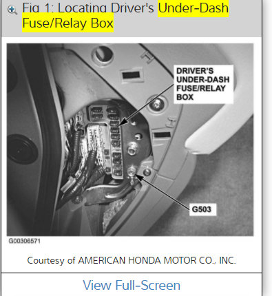

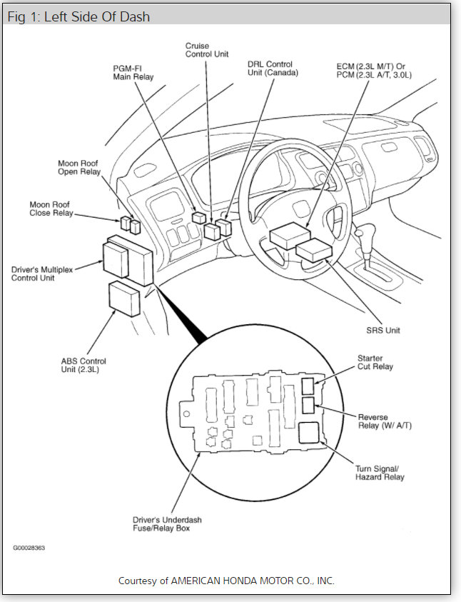

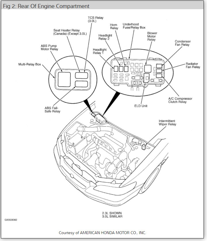

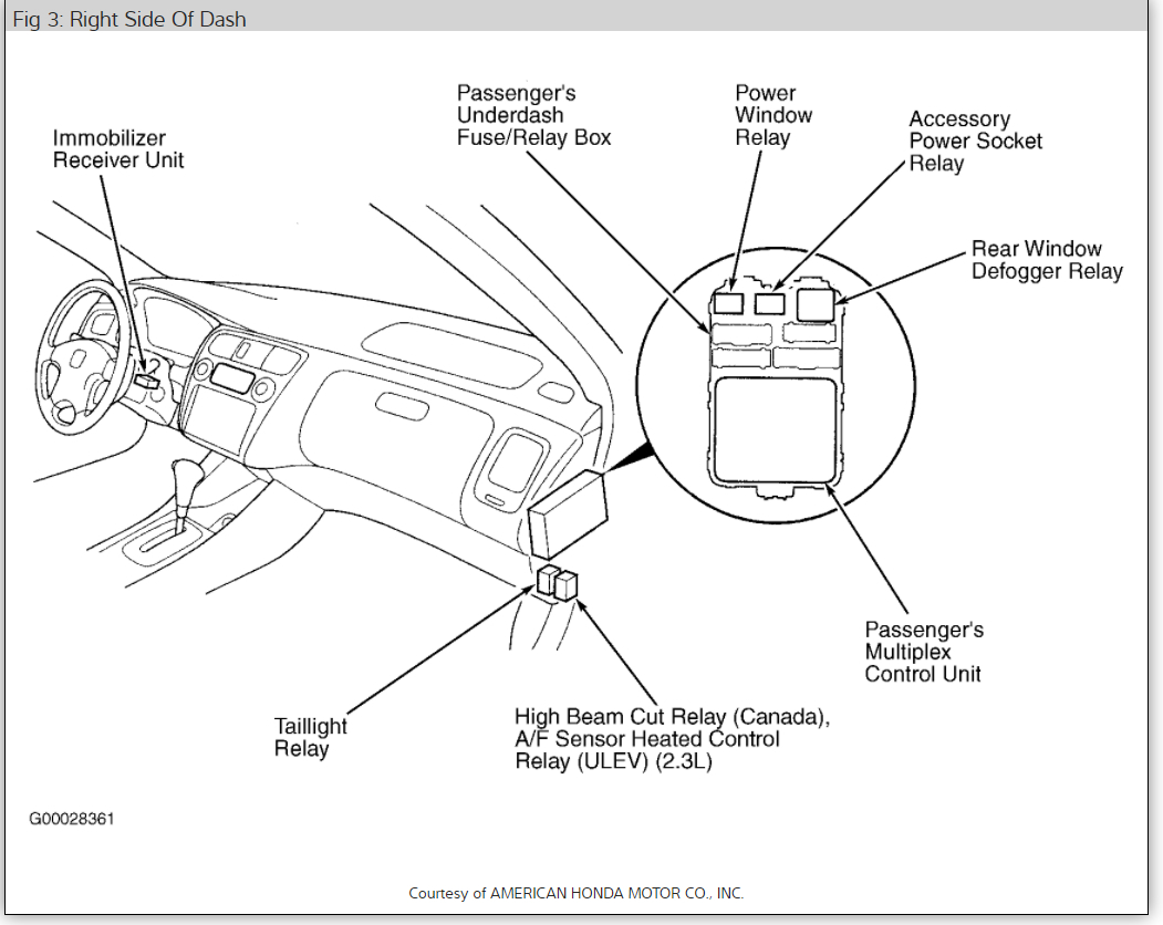

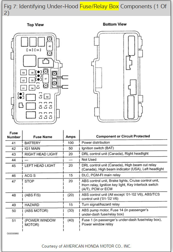

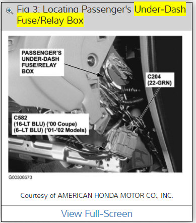

Check out the diagrams (Below). Please let us know what you find. We are interested to see what it is.

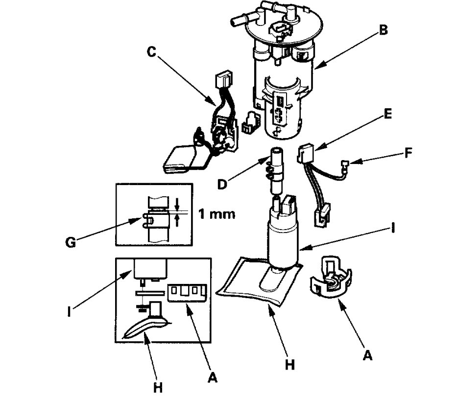

If you don't hear the pump you are on the right trail. I would do the fuel pump and relay. here is a guide to walk you through the steps and diagrams below to help you do the job:
https://www.2carpros.com/articles/how-to-replace-an-electric-fuel-pump

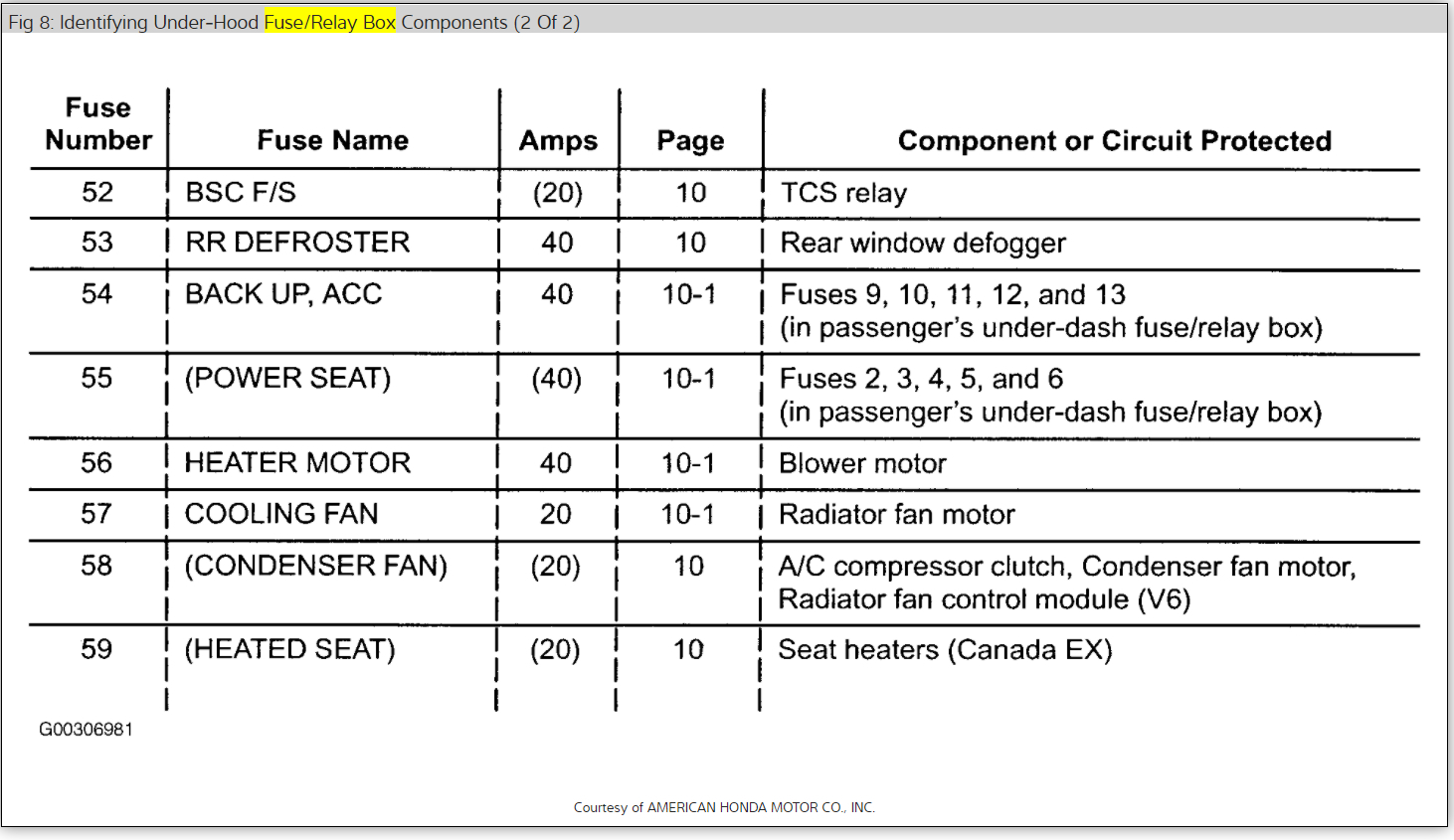

LANAKI
hey bruce,
many thanks for your advice. a friend came over with a continuity tester and we discovered a 50 amp fuse under the hood blown. replaced it and all is well! whew! "how do you spell relief?"

As to the buzzing noise, it most probably is a relay buzzing and it could be from the relays in the underhoos fuse box. You would have to locate the source to find out what is causing it.
