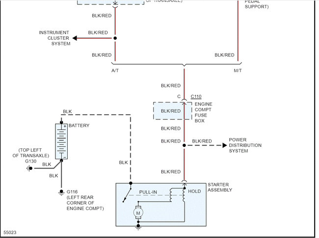

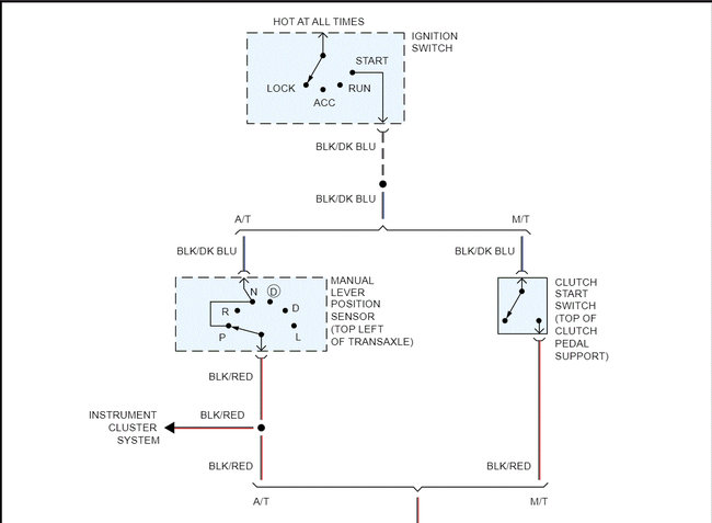

I'm having the exact issue that lowrider was having. My car won't start and all that I get is a clicking from the passenger side fire wall in a relay there. I was wondering if lowrider was able to resolve the issue and could tell me what the problem was.
May 21, 2022 at 10:54 AM
  • 110,240 POSTS
I'm not familiar with that post. However, I will try my best to help.
If you are getting a click from the starter relay, there is a chance the starter itself has failed. Was there anything that led to this or did it happen all at once?

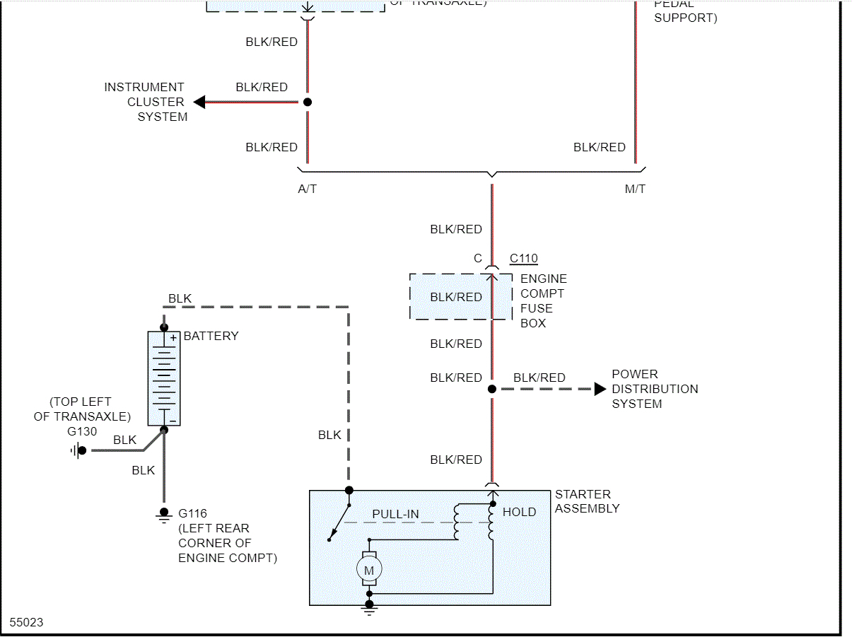

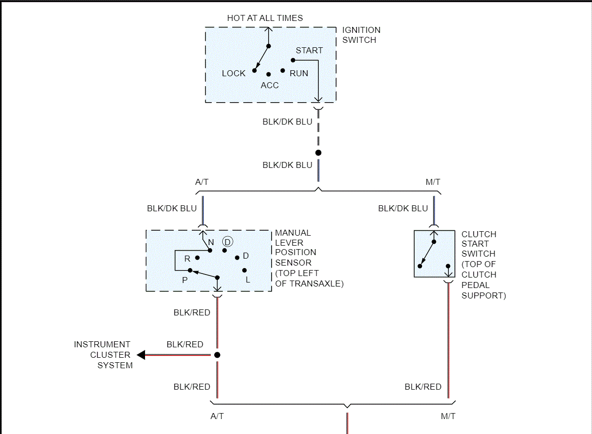

If you look at the pics below, I included the wiring schematic for the starter motor. If the battery is fully charged, I need you to try something.
At the starter motor, there will be a heavy gauge black wire. It should have 12v at all times directly from the battery. In addition, there will be a lighter gauge wire that is black with a red tracer. This wire only receives 12v when the ignition key is in the start position. Have a helper turn the key to start while you check the black/red wire for power.
If it has power and the solid black wire always has power, chances are the starter has failed. Here is a link that explains in detail how to check for a starter issue:
Try this and let me know what you find.
