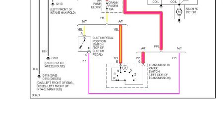

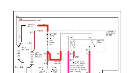

My truck wont start without being jumped. I have taken off the alternator and the battery and had them tested and they are both good. Im lost as to what to do next
Thursday, September 3rd, 2020 AT 5:11 PM (Merged)
  • 75,992 POSTS
Do you see all the lights that normally comes on when key at run position, also do you have an auto theft deterrent device?
CHEVY96SS
Yea I see all the same lights no new ones. No I dont have a security system
  • 75,992 POSTS
Okay-have helper hold key at start position and look for power at the starter solenoid purple wire terminal-do you have it-if so replace the starter. If not check the starter relay/transmission range switch, ignition switch and fuses also see below
https://www.2carpros.com/forum/automotive_pictures/12900_st1_11.jpg
https://www.2carpros.com/forum/automotive_pictures/12900_st2_10.jpg
https://www.2carpros.com/forum/automotive_pictures/12900_st3_1.jpg

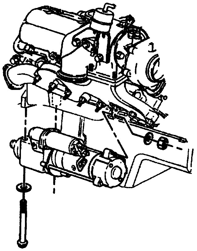

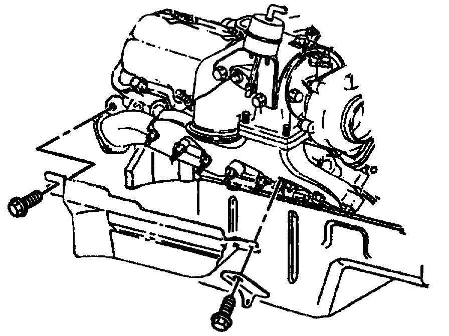

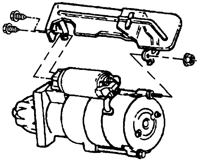

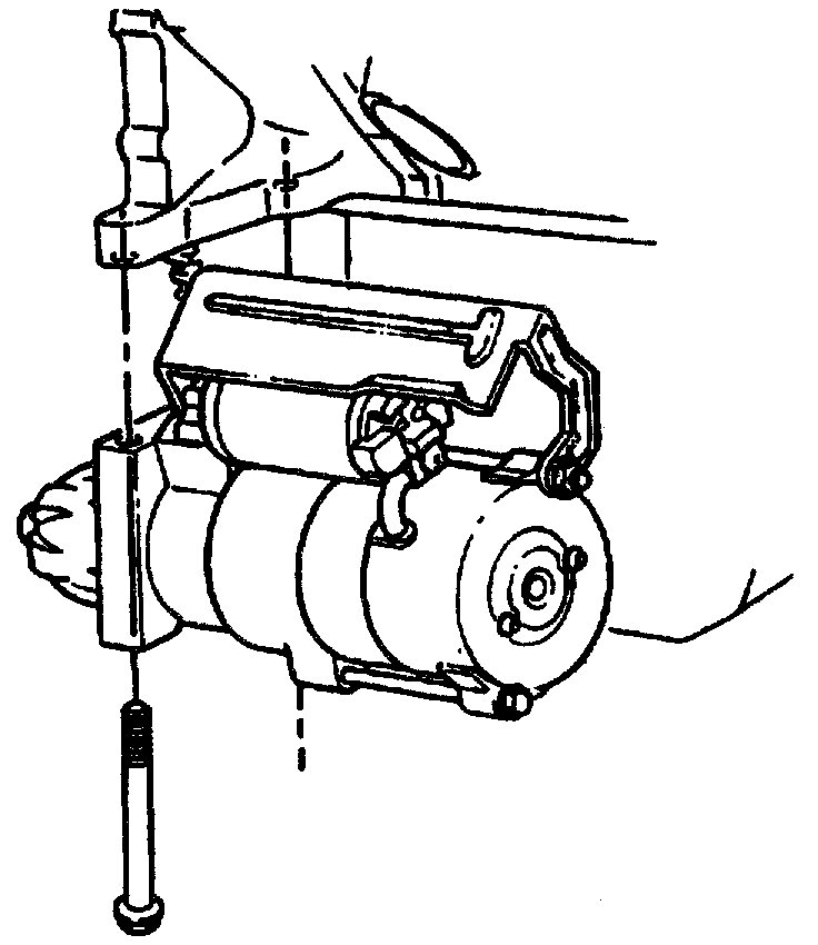

1997 Chevy Truck K 1500 Truck 4WD V8-5.7L VIN R
Starter Motor Replacement
Vehicle Starting and Charging Starting System Starter Motor Service and Repair Procedures On-Vehicle Service Cranking System Starter Motor Replacement
STARTER MOTOR REPLACEMENT
Gas Engine Starter Motor And Heat Shield
pic 1
pic 2
Diesel Engine Starter Motor Shield
pic 3
pic 4
Remove or Disconnect
1. Negative battery cable. Refer to CAUTION. See: Starter Motor > Service Precautions
2. Starter brackets and/or shields, if equipped.
3. Wires from the starter solenoid.
- Raise the vehicle and support with safety stands.
4. Two bolts and washers (where present) holding the starter to the engine.
5. Starter from the engine.

Let me know if that takes care of the problem. Also, make sure the heat shield is in place on the starter. Without it, the starter will get extremely hot from the exhaust system and can cause what you experience.
