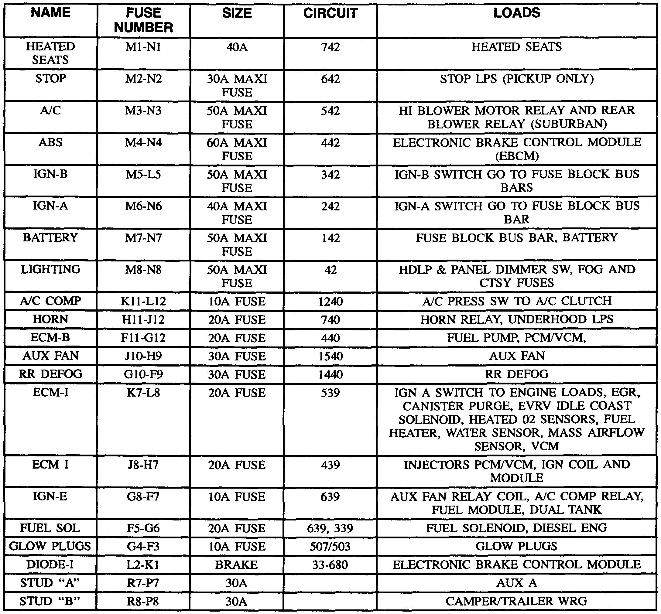

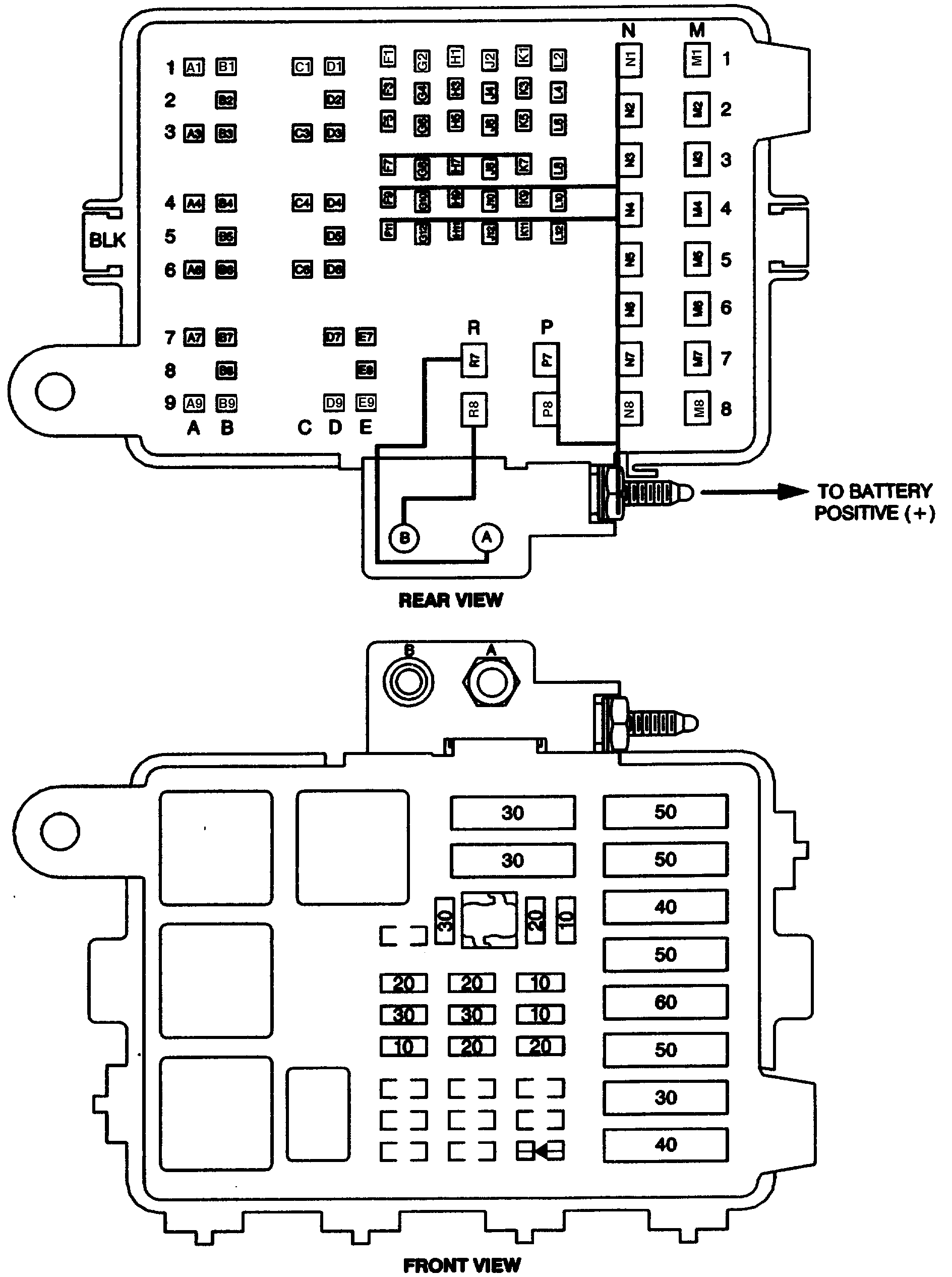

If you haven't already, inspect the fuses under the hood in the power distribution center. I have attached two pictures. One is the fuse box under hood, the second is the legend. Specifically, check the following:
Battery
Ignition A
Ignition B
ECM 1

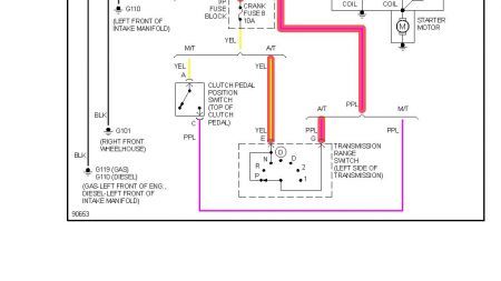

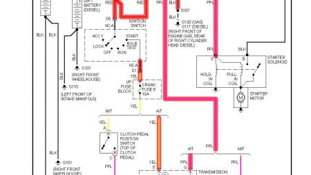

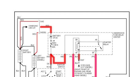

Okay-have helper hold key at start position and look for power at the starter solenoid purple wire terminal-do you have it-if so replace the starter. If not check the starter relay/transmission range switch, ignition switch and fuses also see below

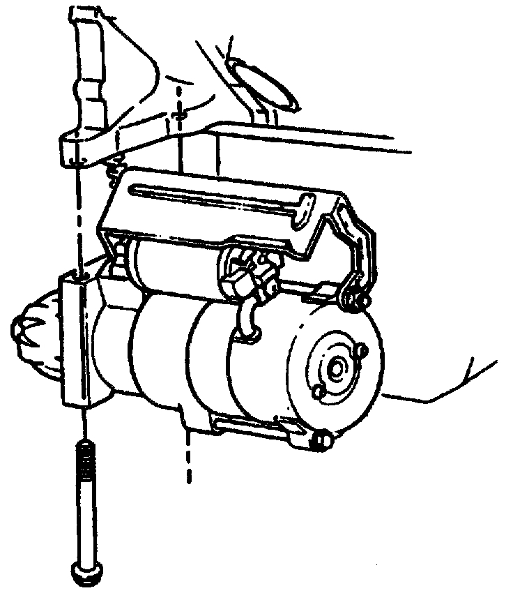

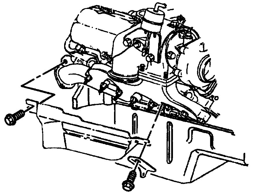

1997 Chevy Truck K 1500 Truck 4WD V8-5.7L VIN R
Starter Motor Replacement
Vehicle Starting and Charging Starting System Starter Motor Service and Repair Procedures On-Vehicle Service Cranking System Starter Motor Replacement
STARTER MOTOR REPLACEMENT
Gas Engine Starter Motor And Heat Shield
pic 1

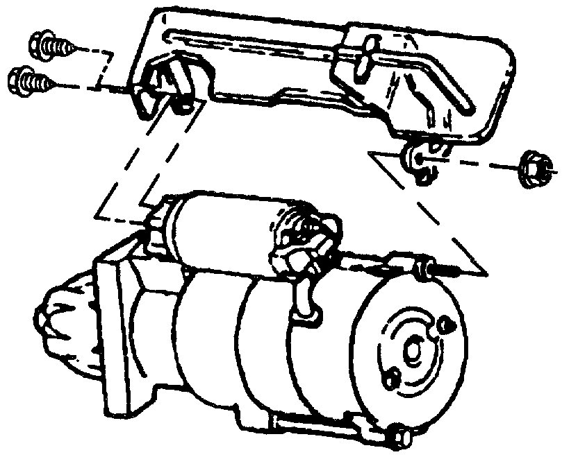

pic 2

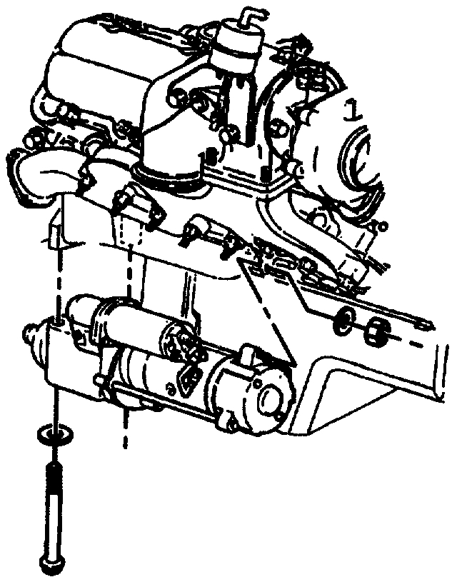

Diesel Engine Starter Motor Shield
pic 3
pic 4
Remove or Disconnect
1. Negative battery cable. Refer to CAUTION. See: Starter Motor > Service Precautions
2. Starter brackets and/or shields, if equipped.
3. Wires from the starter solenoid.
- Raise the vehicle and support with safety stands.
4. Two bolts and washers (where present) holding the starter to the engine.
5. Starter from the engine.
INSTALL OR CONNECT
NOTICE: Refer to "Notice". See: Starter Motor > Vehicle Damage Warnings
1. Two bolts and washers (where used) through the starter to the engine.
Tighten
- Mounting bolts (diesel) to 40 N.m (30 lb ft).
- Mounting bolts (gas) to 45 N.m (33 lb ft).
- Bracket Nut (diesel) to 8 N.m (75 lb in).
- Nut (diesel) to 8 N.m (75 lb in).^ Lower the vehicle.
2. Wires to the solenoid terminals.
3. Brackets and/or shields, if equipped.
Tighten
- Heat Shield bolts (diesel) to 17 N.m (13 lb ft).
- Heat Shield bolts (gas) to 12 N.m (9 lb ft).
4. Negative battery cable.
_________________________
Let me know if that takes care of the problem. Also, make sure the heat shield is in place on the starter. Without it, the starter will get extremely hot from the exhaust system and can cause what you experience.
