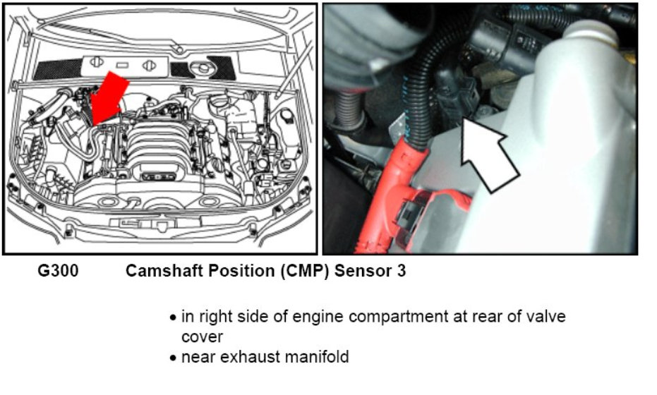

Hmm. That seems strange can you make a video of the engine cranking over so I can see what it is doing? I think you may have a fuel pressure sensor that is not working.
Here is the location.

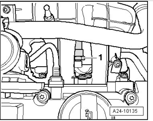

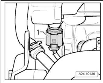

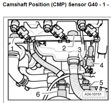

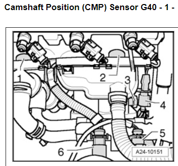

Nice! here is a guide to help you see what you are in for when doing the job.
https://www.2carpros.com/articles/camshaft-angle-sensor-replacement
Here is where is it located on your car.
