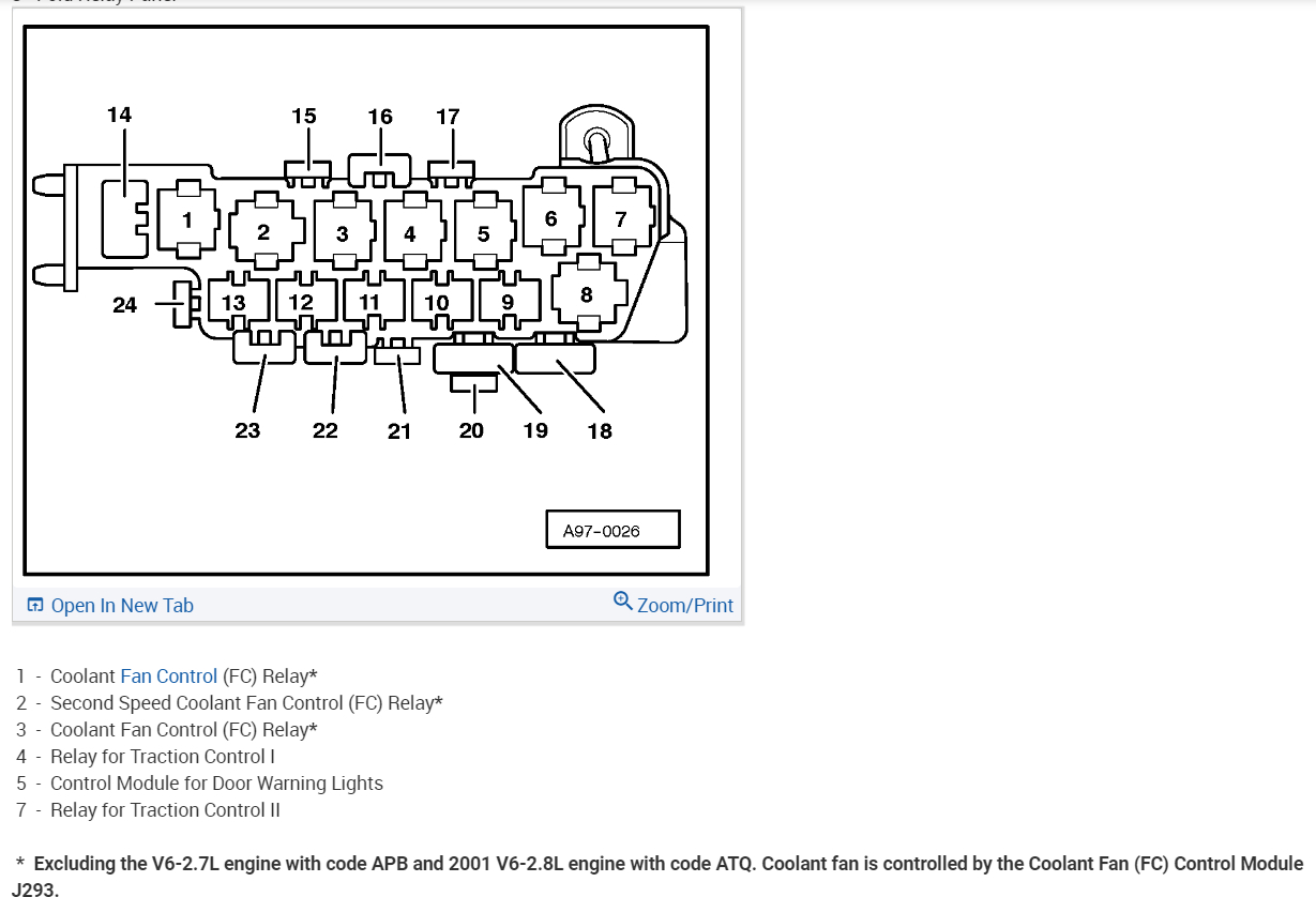

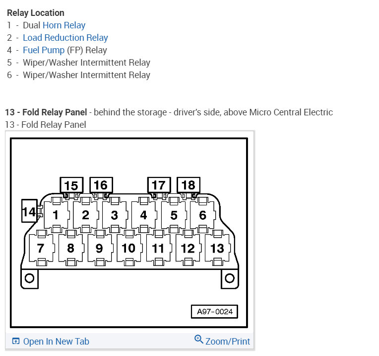

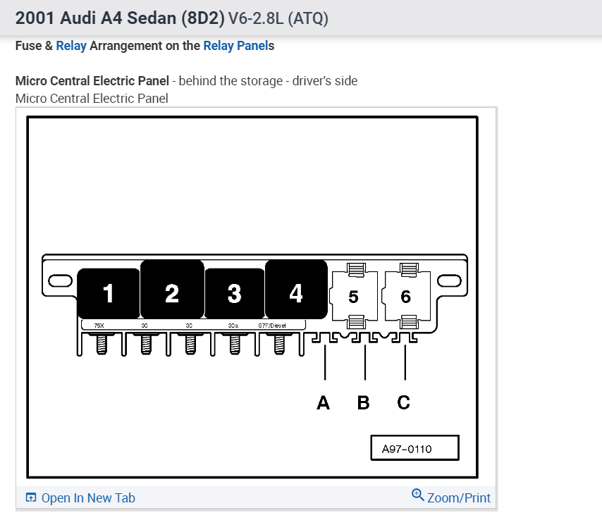

With the key on do you have 12 volts at one of the wires for the coil or fuel injector? Also, we should run the codes and check the fuses.
These guides can help:
and
If no voltage is present, I would swap out the fuel pump relay which gives power to the PCM here is the location so you can check it out.
