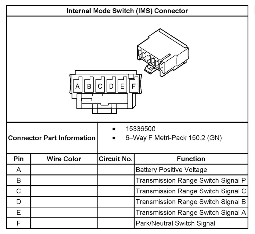

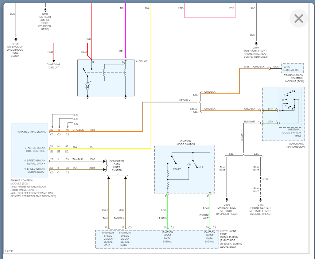

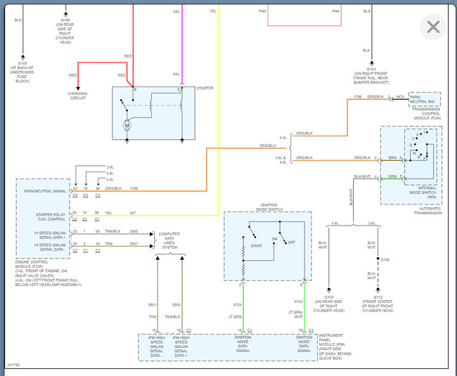

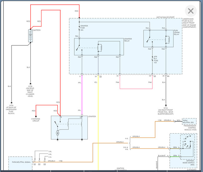

More than likely this is an issue with the park neutral switch that is part of the transmission.
The way we confirm this is to check the voltage at the switch and make sure there is battery voltage on pin A and then what is coming out of F when in park and neutral.
Here is a guide that will help with this:
The fact that it appears to go through the cluster sweep when in neutral but not park normally means the switch is the issue but I would expect it to start in neutral but there is not only one way that these can fail so we need to test it and see what we are getting.
I am attaching the info below on this and the starter circuit. So, let's start with this and then go from there.
