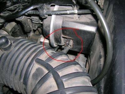

The MAP sensor has been replaced. While doing this, I noticed that there seemed to be a node for a vacuum line with no line attatched. I'm attatching pictures, what do you think?

Thats crusie controlie lol, you either got plug wires crossed or something wrong, when was the map sensor replaced?

About a week before I made the post that I had done it. Is that node there something I should worry about? Or not really?
