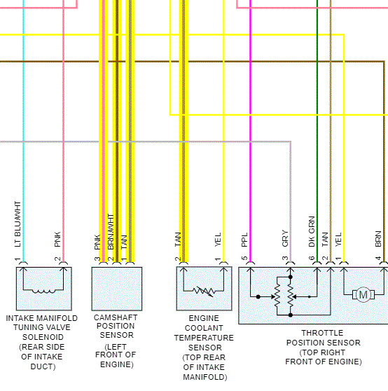

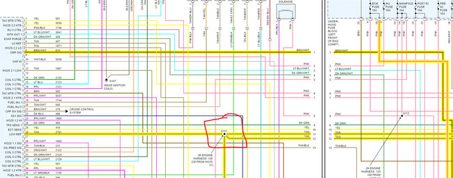

I'm no closer to understanding what exactly happened. I've rewired all my sensors from the ECM to the sensors, MAF, coolant, cam, vapor canister, intake. I'm still getting 10v on my low ref lines when MAF sensor is plugged in, 0v when unplugged and my coolant sensor reading is still at -40 either way. When I first rewired the low reference lines, everything read fine until the next morning when I went out to cleanup the new wires, I double checked my readings and that's what I was getting. At this point I don't know what else to do or check! New sensors, new harnesses, new wires, no change. No more pending codes or stored codes, still no start condition. Help!
Saturday, April 25th, 2020 AT 11:02 AM
RGRUBER69
  • 22 POSTS
Okay, not sure if this will help or make any sense, but I've ran new 12v wire from fuse panel to my cam sensor. When I disconnect that wire at the fuse panel, I get normal 5v on the low ref. And by coolant temperature reads -14. Weird, and as stated, I'm getting way more confused with everything I do!
Saturday, April 25th, 2020 AT 4:56 PM
  • 109,936 POSTS
I am getting more confused as well. LOL The sensor should have 12v from the ECM. If I understand, you ran a jumper wire to 12v from a fuse to the cam sensor. Is that when you had closer to the correct voltage from the low reference and the -14° F from the coolant temperature sensor? What is the actual temperature?
Sunday, April 26th, 2020 AT 7:33 PM
RGRUBER69
  • 22 POSTS
I cut the 12v wire to cam sensor at the fuse panel, ran a new 12v line. But checked all my readings before hooking up the new wire. That's when I had the -14 and correct voltage at low ref. With No 12v hooked up at cam sensor. Actual temperature was about 65°.
Monday, April 27th, 2020 AT 2:01 AM
  • 109,936 POSTS
If you look at picture 1, it shows where the power supply to the cmp comes from. You replaced that. Next, note that one wire splices (I circled it) to the low ref. That low reference is used by the coolant temp sensor and the MAF sensor. Since you get the same thing when you run power direct but chances when you remove the power to the CMP, something is likely back feeding power to MAF. Disconnect the MAF sensor and see if it changes the reading when you power the CMP.
Monday, April 27th, 2020 AT 11:28 AM
RGRUBER69
  • 22 POSTS
I've completely removed the splice pack circled and replaced all low ref wires from the ECM to each sensor, creating a new splice at the ECM side. The 12v power to the CMP and MAF have been replaced from the fuse panel harness to the sensors, along with all the other wires in each harness, at the ECM.
Monday, April 27th, 2020 AT 12:34 PM
  • 109,936 POSTS
I am going to ask for another tech's opinion, but in all honesty, I suspect something to be wrong with the ECM.

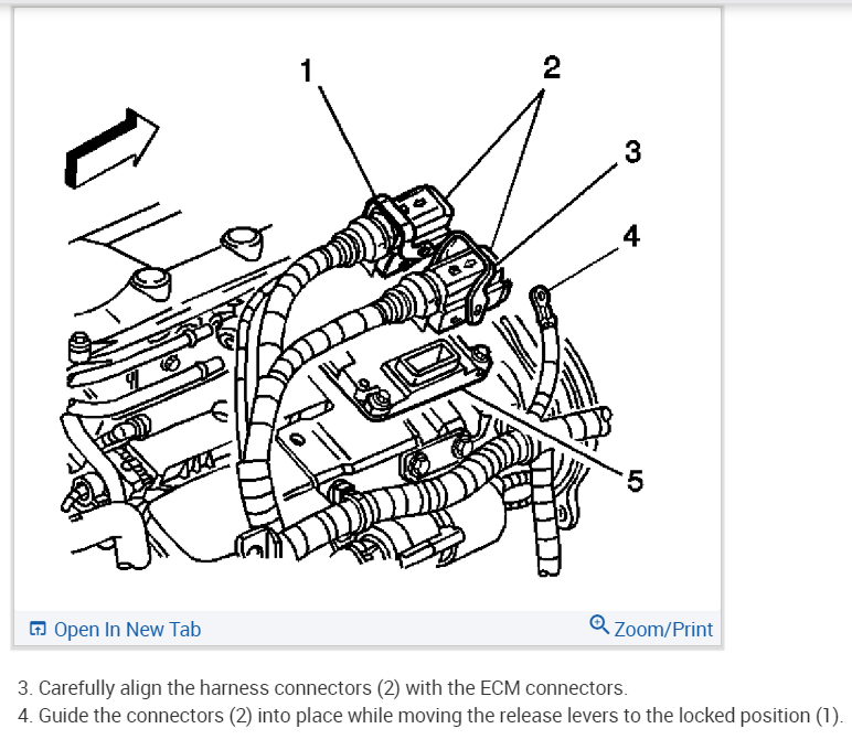

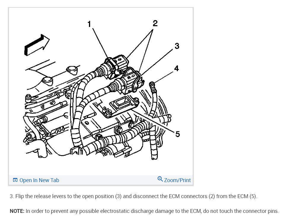

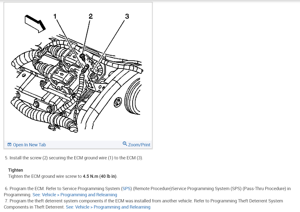

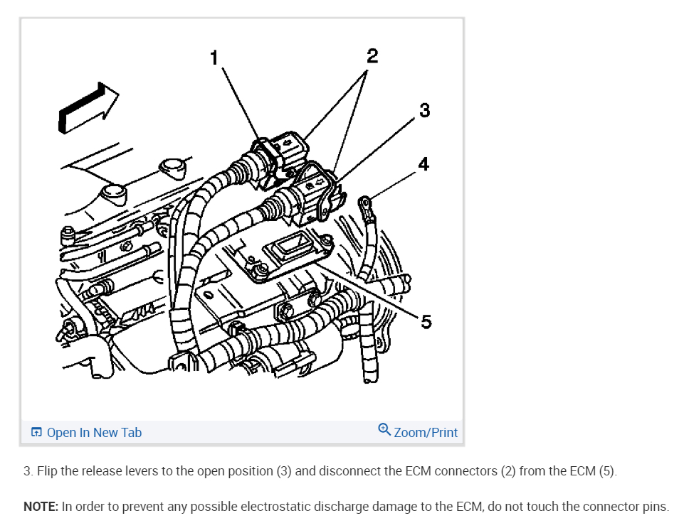

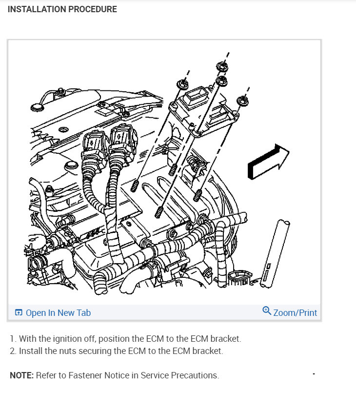

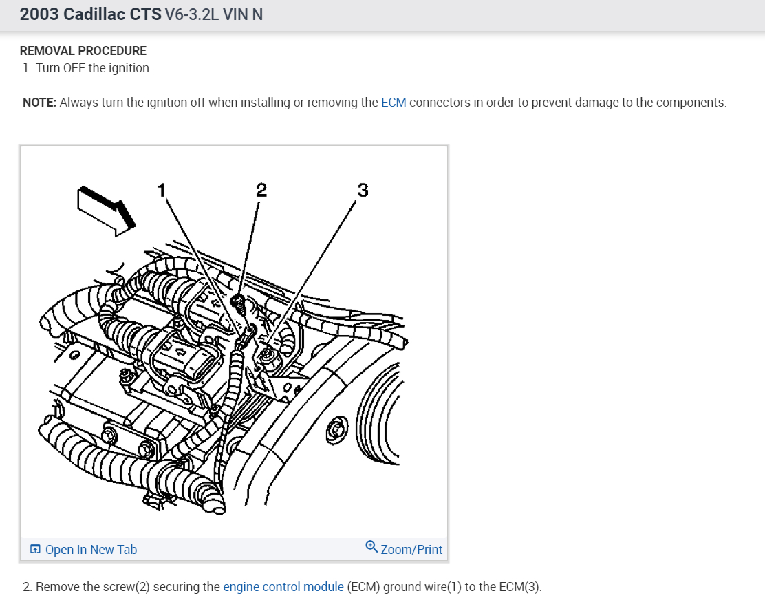

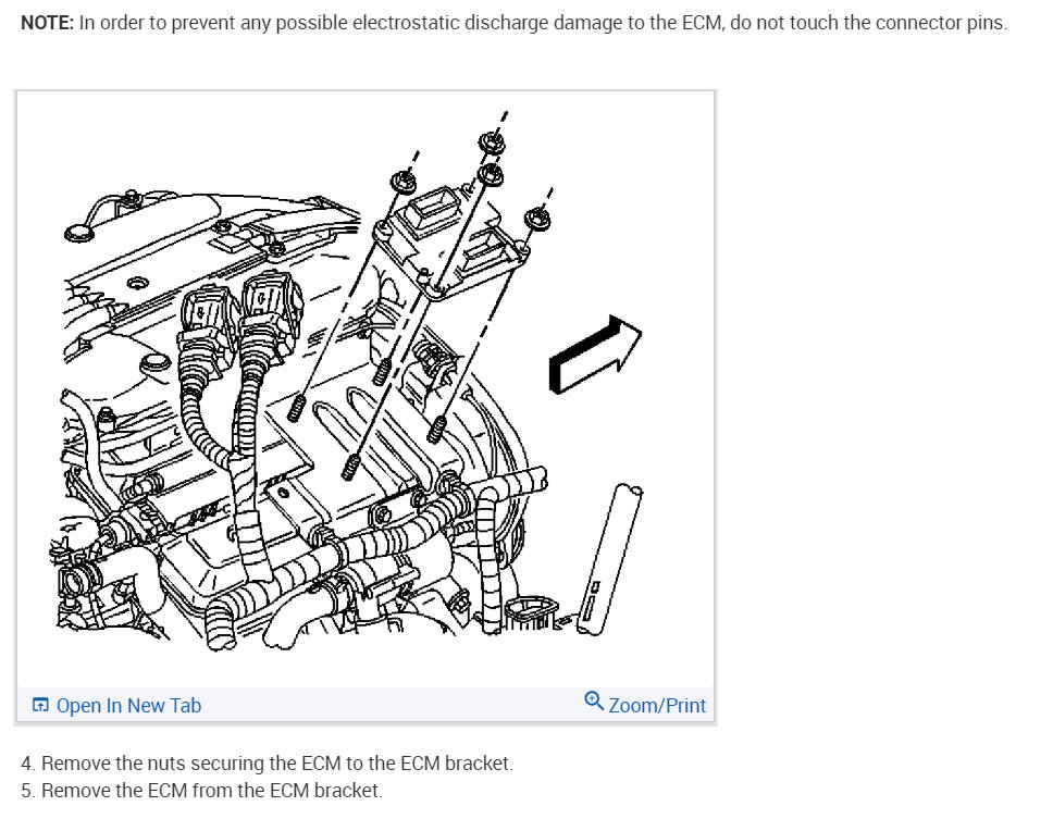

Yes, it sounds like the drivers inside the PCM have gone bad, probably due to the shorted wiring. I would try a rebuild unit please give your VIN number when ordering. Here are the instructions on how to replace the unit in the diagrams below. Yours should have this done before you get it.
