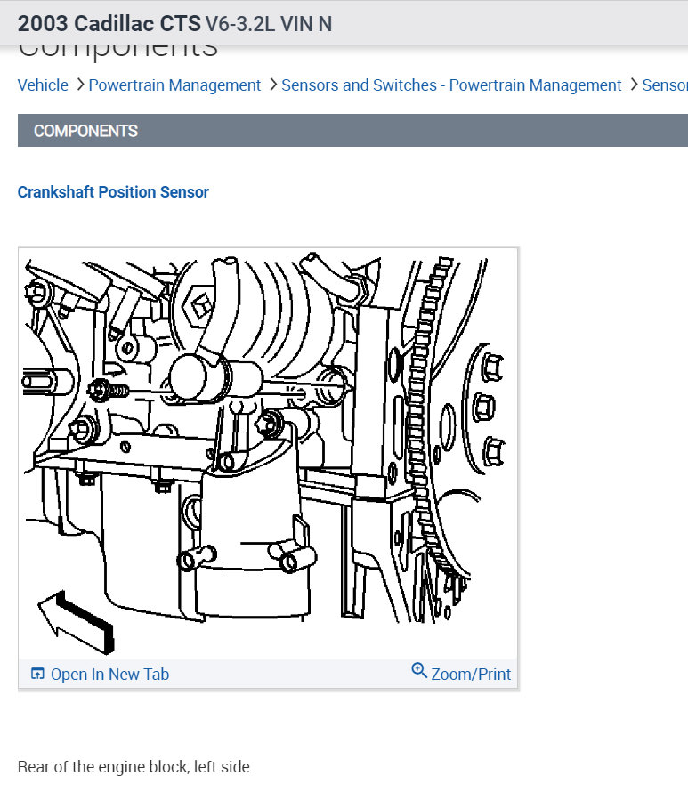

A few weeks ago my car began to have problems. The car had a bad battery which I replaced and then I was driving down the road and my car completly stalled out but started up immediatly. A day later, I started it up w/out a problem and drove down the street where I parked it for 2 min and then it wouldnt start. It clicks over but wont start. If I give the car 10 minutes to rest and I try starting it again it starts. Whats the problem?

We've had a few of those in my shop lately and the most common issue is the crankshaft sensor. Here is the location of the sensor to help you fix the problem. Check out the images (below). Let us know if you need anything else.
