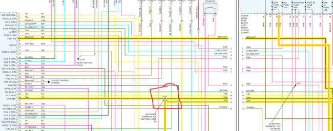

No start condition, p0118 and p0343 codes

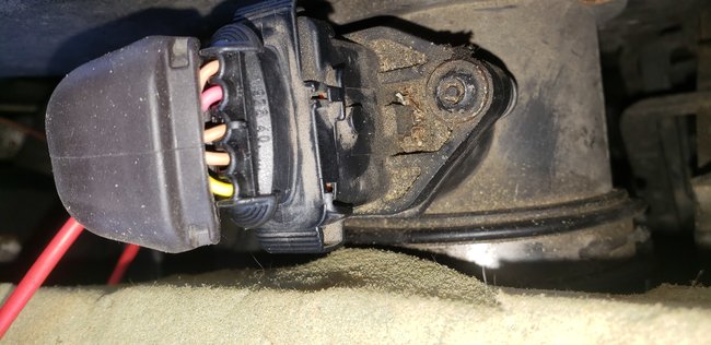

Have you repaired the wires that were taped? The -40 is an indication that you have an open circuit. That is a default when either the sensor is open or the wiring to the control module. I attached the testing for the ECT code. Pay close attention on step 6 assuming you don't repair it in a prior step. However, I suspect you have a 5 volt reference issue.

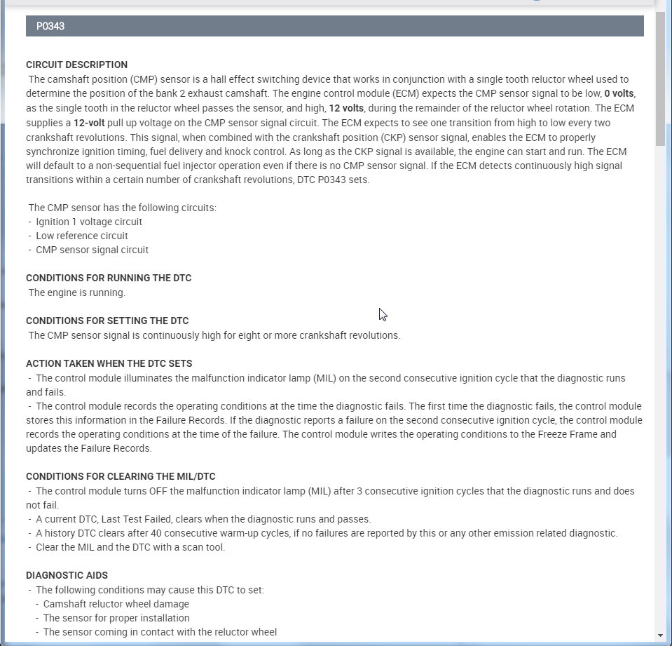

I also included the Cam code but I would start with the ECT temperature code and see what you find. I included the wiring diagram as well. As you will see the cam sensor and ECT share a low reference wire which is spliced together. That is the 5 volt reference wire which I suspect is your issue.
Let me know and we can go from there. Thanks

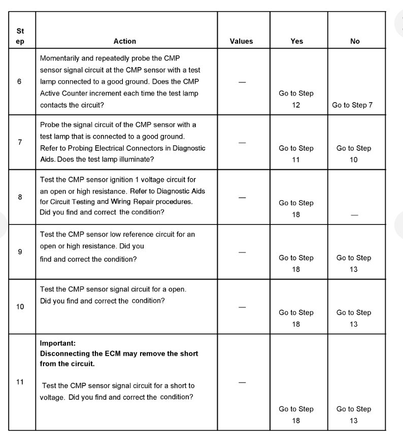

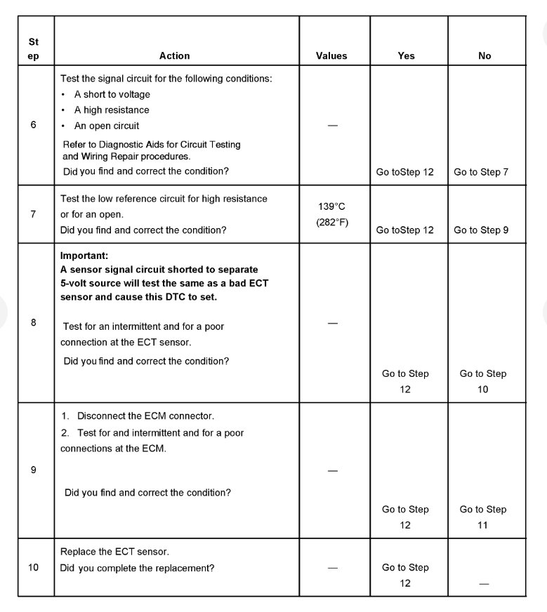

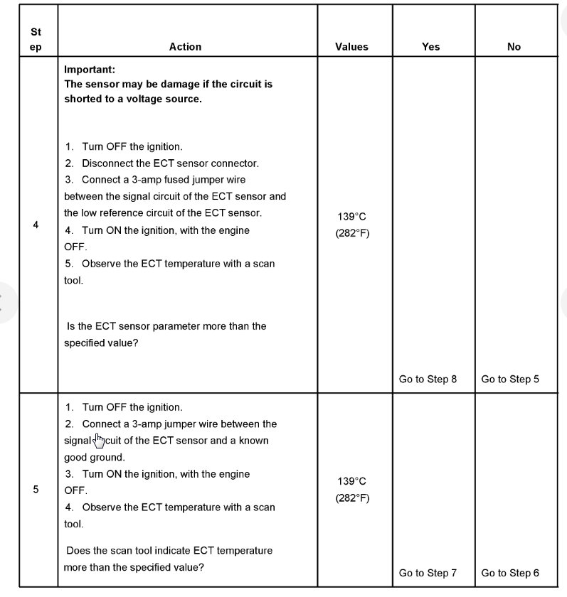

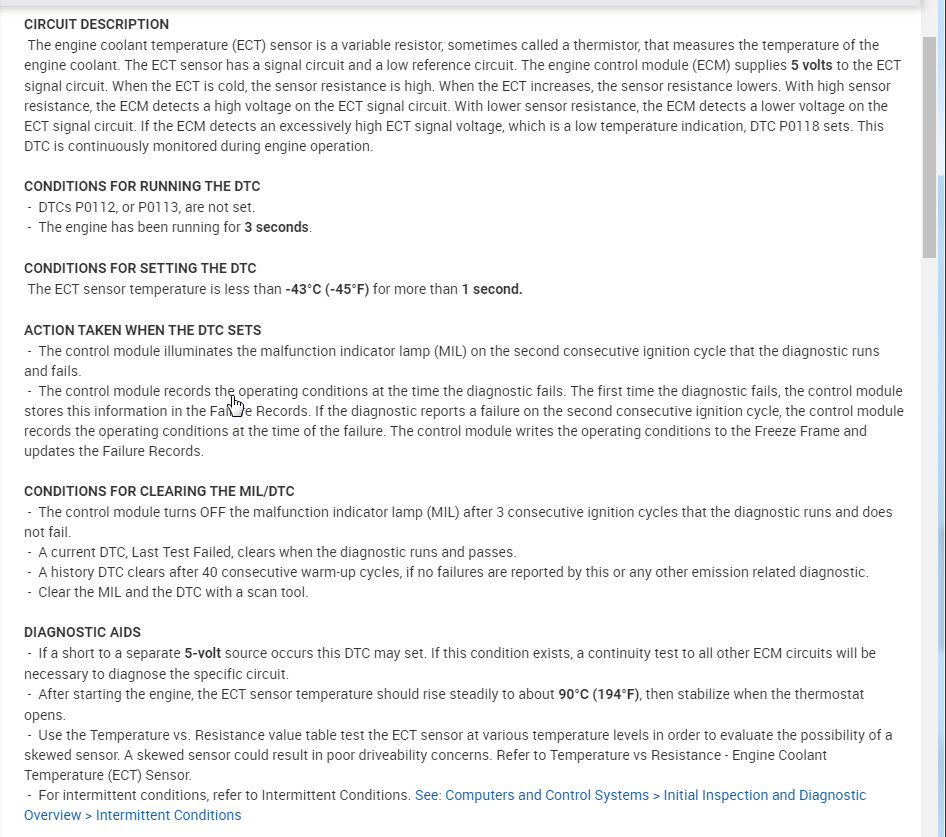

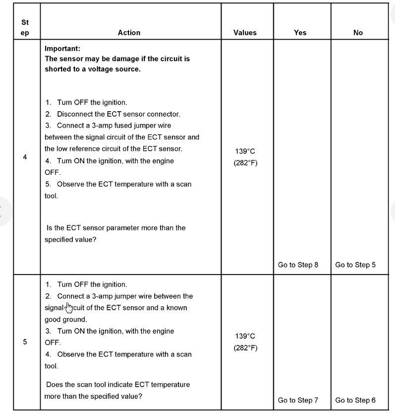

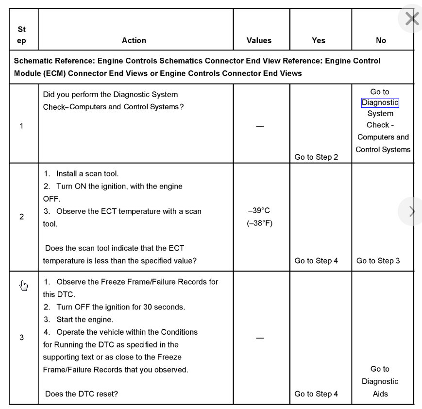

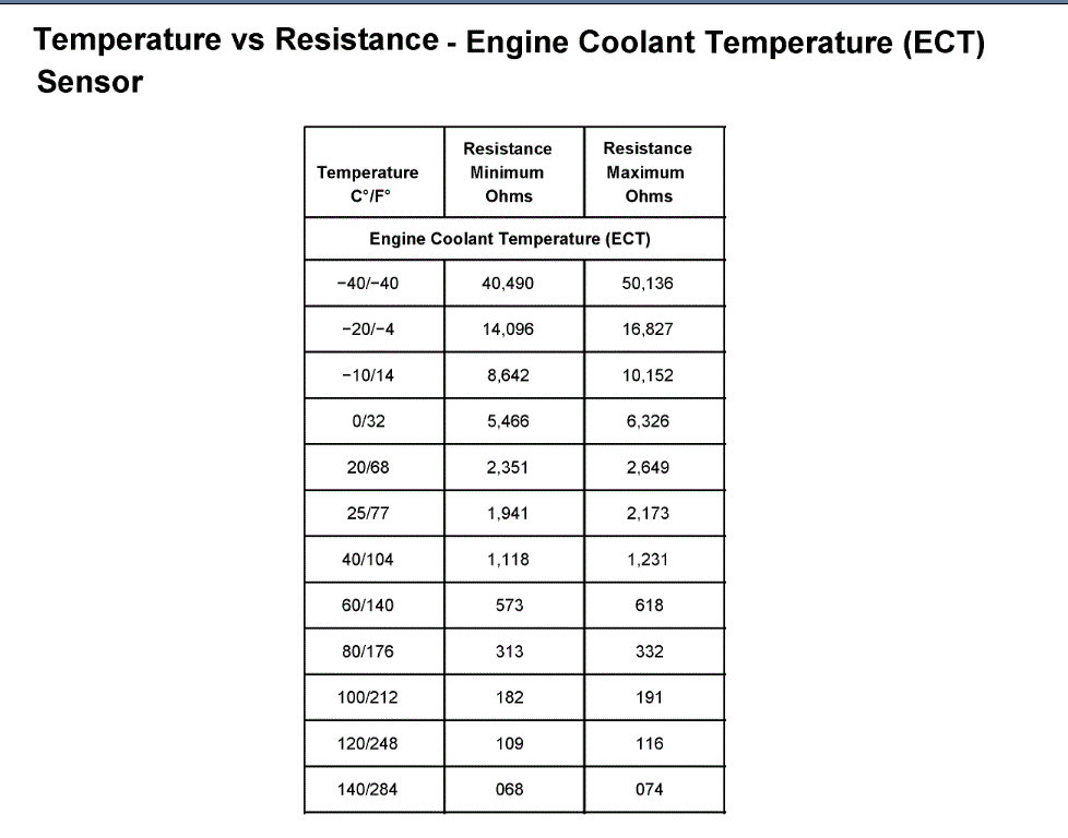

The coolant temperature sensor is the likely cause of the no start. If it is indicating -40° F, it's dumping fuel to the engine to run in extreme cold temperatures.
Now, anytime I have had this happen, the sensor was bad. However, you indicated the sensor was replaced. So, we need to check it to determine if the sensor is bad or there is excessive resistance in the wiring to it, or the plug itself.

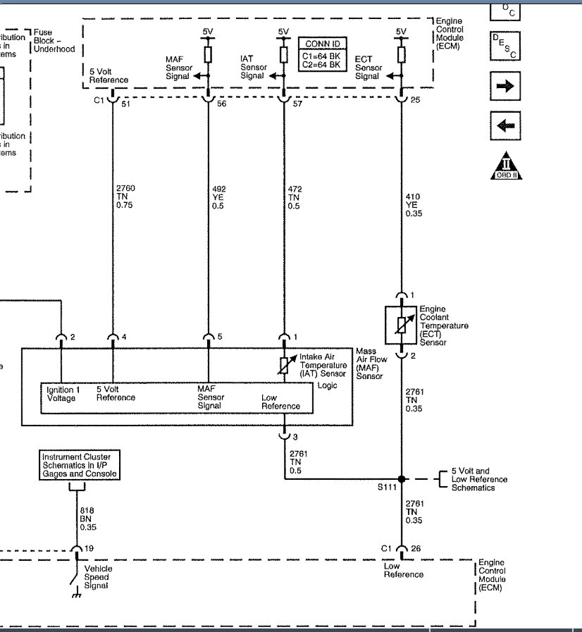

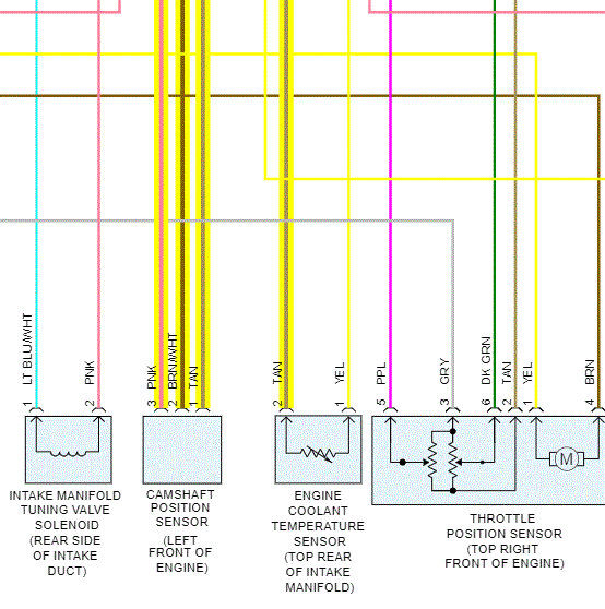

If you look at the attached pic, it shows what the resistance should be based on temp. Before going crazy and testing it, reconfirm there is no wiring damage and the connector is tight, clean, and there is no damage to the connector.

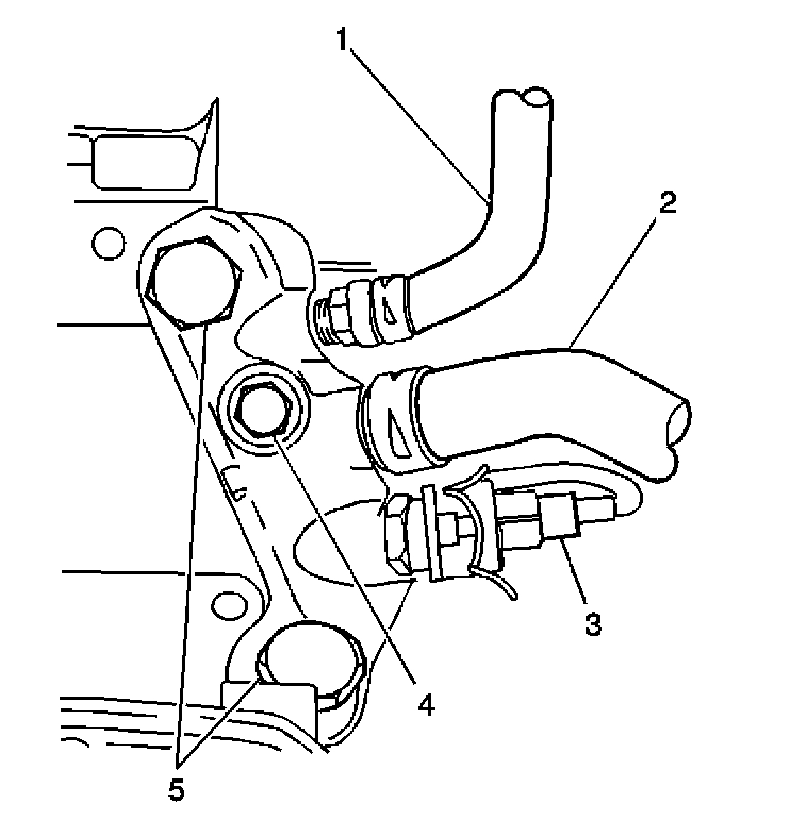

Also, just to confirm we are referring to the same part, it is located in the crossover pipe. See pic 2
Because of the sensor's location, I hate to say it, but it will be easier to remove it for checking unless you can access it to check resistance.

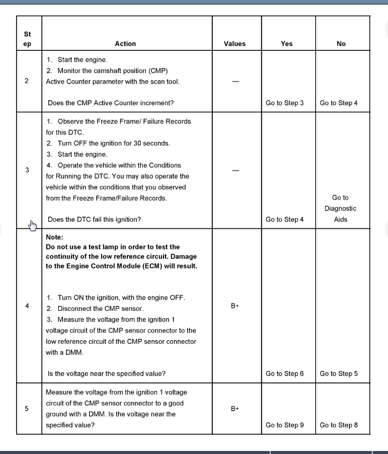

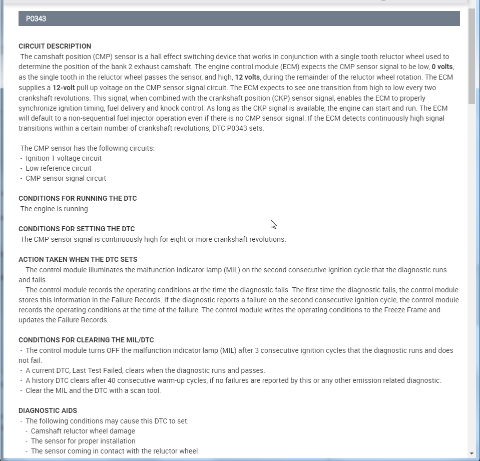

The only other thing I'm concerned about is the connection at the cam sensor. You indicated it was taped. Make sure that everything is properly put back together and shielded.
To shed some light on my rational for the not running condition is simple. You have two codes. From experience, I know if the ECT is indicating -40, either the engine will not start or be running extremely rich if the ambient temp isn't as indicated. If you pull a plug after trying to start it, chances are it will be wet with fuel. Now as far as the cam sensor code, the reason I don't feel that is causing a no start condition is because the system is designed to still run in a default mode even if the crank sensor fails. The only thing that will cause a no start related to the cam sensor would be if there was no crankshaft position sensor signal. Then it wouldn't run. An easy way to check for a crank signal is simple. Using your live data scanner, see if there is an RPM signal when cranking the engine. If there isn't one, chances are the crankshaft position sensor has failed. If you can't read an RPM signal, check to see if there is spark to the plugs.

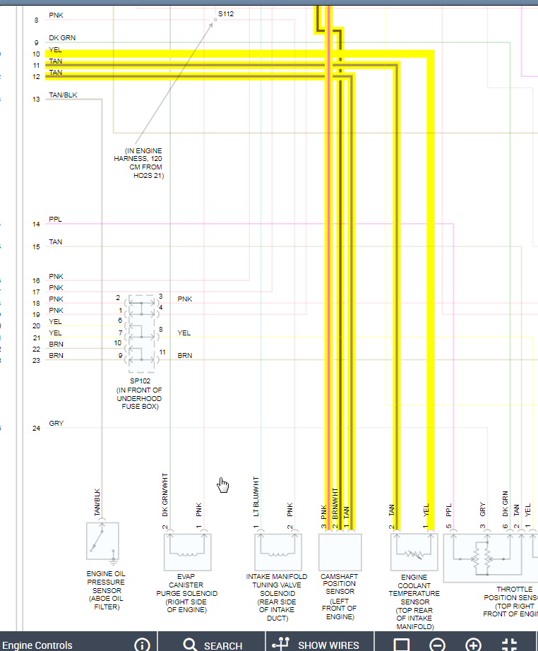

Kasekenny, with both sensors sharing a common ref wire, can I assume that there should be continuity between the two? And are those the only two sensors to share that common wire? And on the sensor wires, should I check for 5v on the tan wire? Before treating into the entire wire harness, I'd like to isolate smaller sections to check!
Jacobandnickolas, I did replace the cam sensor that had the taped wires, but an currently trying to chase the remaining wires for damage. I'm hoping it didn't short the ECM! As far as my little scanner, it shows approx 750 rpm's at cranking, so I'm assuming crankshaft sensor is okay!
Apr 14, 2020 at 9:54 PM
Yes. They will have continuity but you want to check end to end. Meaning from the module to the component. Clearly when there is a splice you will have continuity from the module to multiple sensors.
If you have 5 volts coming out of the module, you can just run a new wire to each sensor. In essence you splice in a new wire and run it directly to the sensor and replace the wire that is at the sensor. Due to this being a splice for multiple sensors you don't want to eliminate the current wiring or you will lose the 5 volt reference to the other sensors. You just want to replace the wires that have the issue. This way you don't need to do an entire harness. Does that make sense?

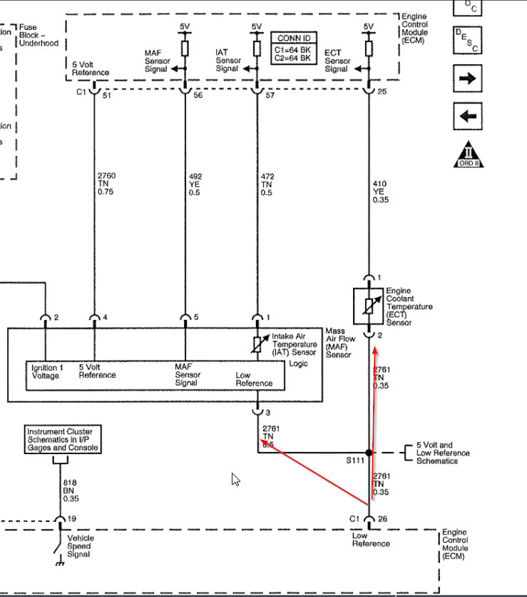

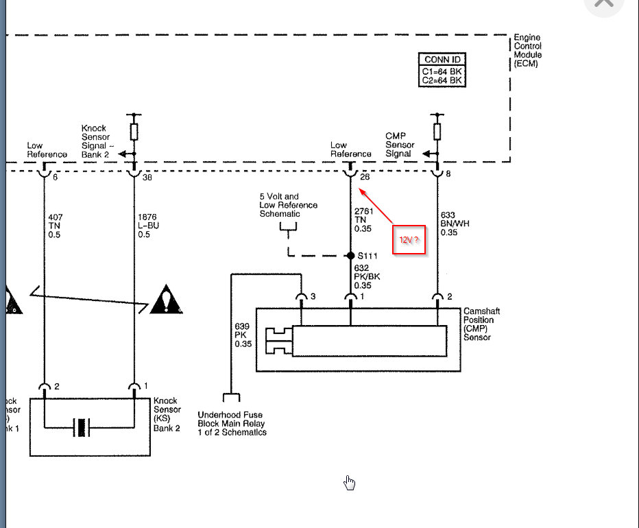

I need to stop using the aftermarket diagrams because they are a little misleading on these types of issues. You understand me correctly but I am wondering exactly where you found 12 volts on the tan cam wire. That doesn't sound right.
These diagrams explain what is happening a lot better. The Low Ref wiring is the 5 volt ground back to the ECM. The ECM supplies 5 volts and then supplies the ground for each sensor. Look like the MAF, Cam, and ECT are the only ones on that splice. Since that is the case, I would just create your own splice to each sensor from the ECM pin 26.

At the cam harness, I have brown/black wire(pink), brown/white wire and tan wire. 12v at tan, 5v at brown/black(says pink on diagram!). On the coolant sensor, 5v at yellow, nothing on tan... Possibly the 12v is because that wire is shorted?! I've yet to find where, but nothing looks pinched/burnt/damaged, just no room to get my hands on to remove the wire loom!
Those schematics make sense. 5v in, tan wire is like a return. I found the tan wire at ECM, I removed harness at ECM and back probed it checking continuity to all 3 sensors, only got it at MAF sensor. That was my main thing was how many sensors are connected, so tomorrow I will definitely tap into the ECM wire and run new to coolant and cam. I'm trying to learn and this is *just* at the scope of my knowledge on vehicle electrical! And Cadillac's are probably not the wisest thing to learn on, lol.
Apr 15, 2020 at 11:10 AM

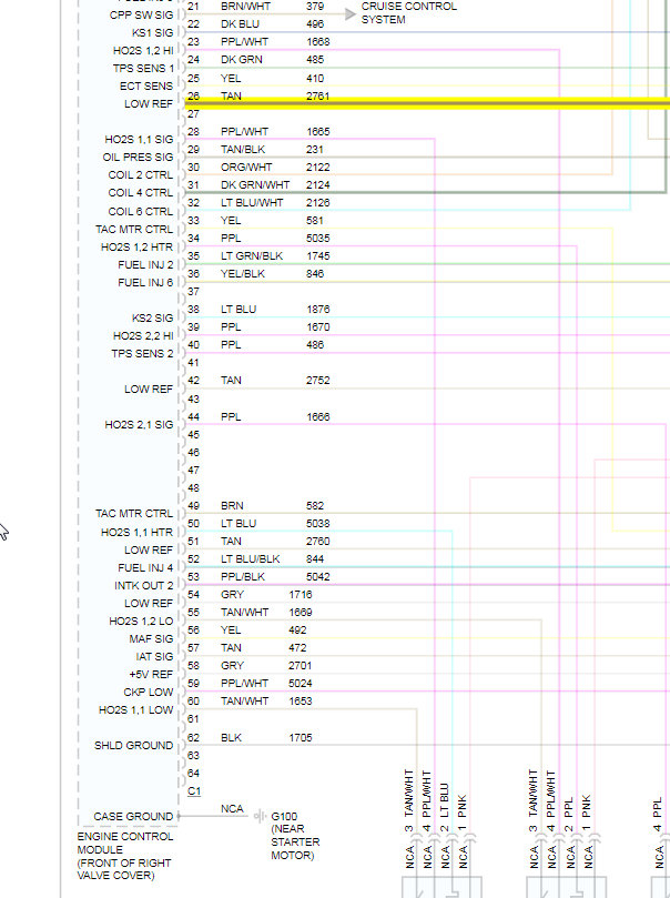

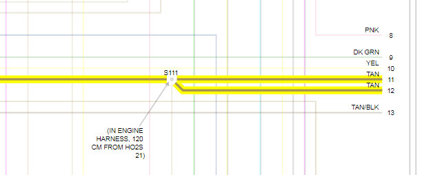

I think that maybe my 'tan' wire at the cam sensor may have been pink and it's just faded. If I'm reading the diagram correct, pk (pink?) from fuse panel would have 12v. Power steering fluid was found in the harness there and I think faded the color of wires.
Anyway, pin 26, new splice from there to coolant, cam, MAF sensor, and looks like maybe knock sensor as well? If I'm reading the schematic right...

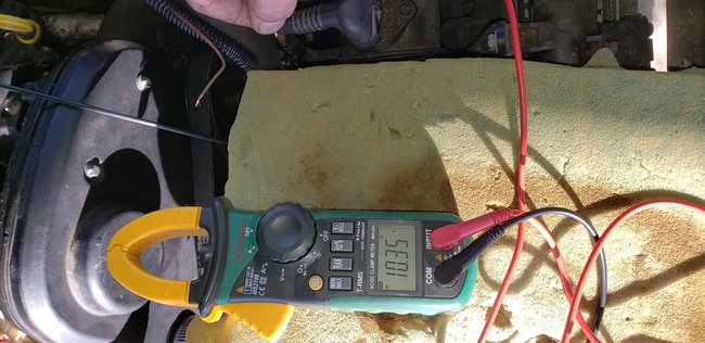

Left to right, yellow wire had 9.3v when plugged in to maf sensor, 0v when unplugged. Next wire tan has 5v plugged in or not. Middle tan is low ref. Next is red 12v with ignition on. Last wire is tan and has 5v plugged in or not.
Apr 17, 2020 at 12:09 AM
RGRUBER69
  • 22 POSTS
I'm thinking I've still got a short somewhere. Ref line is still showing 10v with ECM harness connected or removed... I've looked at all my harness up to the rear of the engine, and without pulling the engine is gonna be impossible to check the rest! Is it possible to do the same for the signal lines to the sensors as I did the low ref lines? Run straight from ECM to sensor harness? Do the coolant, MAF and cam signal wires share and splice points?

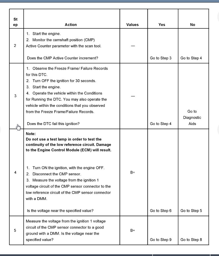

Okay, not sure if this will help or make any sense, but I've ran new 12v wire from fuse panel to my cam sensor. When I disconnect that wire at the fuse panel, I get normal 5v on the low ref. And by coolant temperature reads -14. Weird, and as stated, I'm getting way more confused with everything I do!
Apr 25, 2020 at 9:56 AM
  • 110,248 POSTS
I am getting more confused as well. LOL The sensor should have 12v from the ECM. If I understand, you ran a jumper wire to 12v from a fuse to the cam sensor. Is that when you had closer to the correct voltage from the low reference and the -14° F from the coolant temperature sensor? What is the actual temperature?

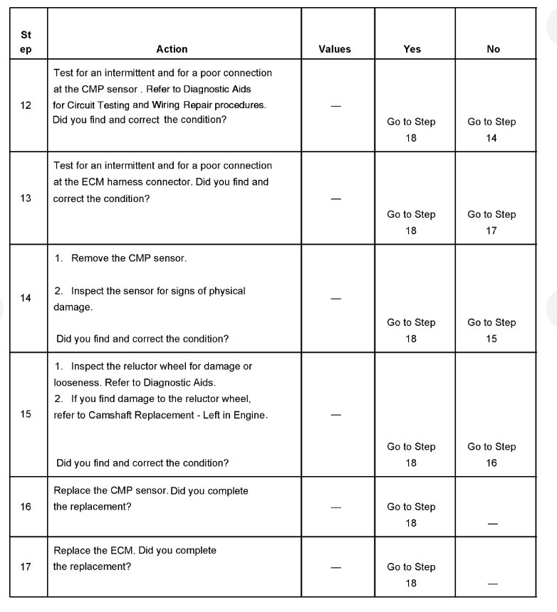

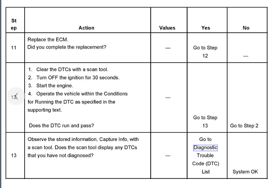

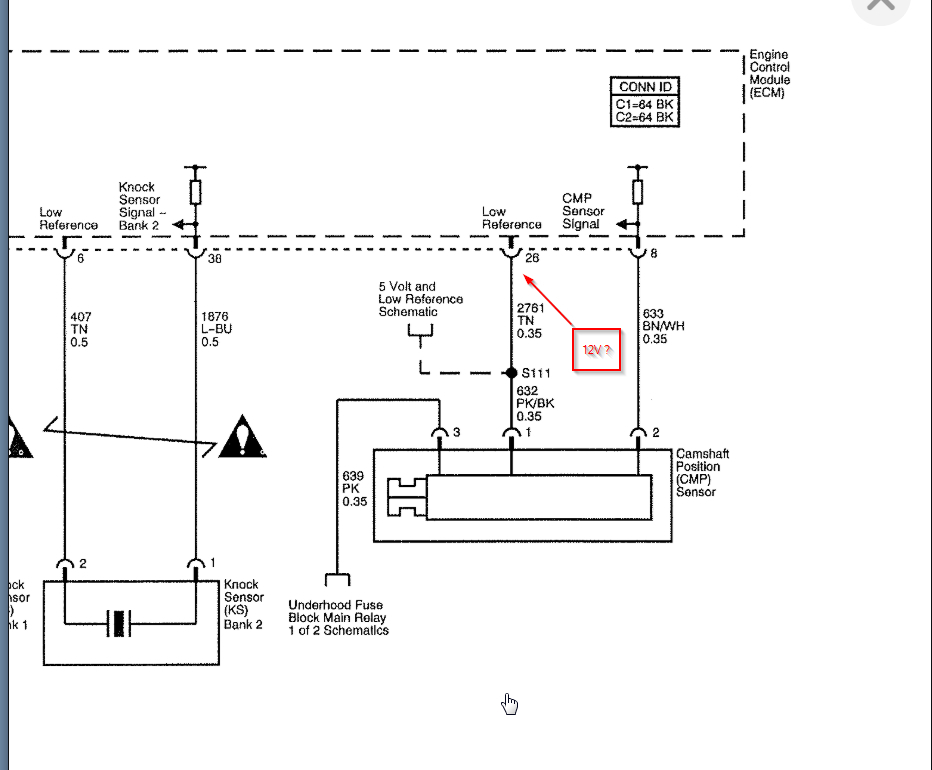

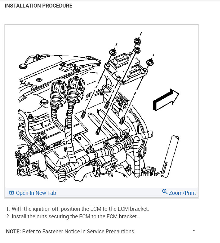

If you look at picture 1, it shows where the power supply to the cmp comes from. You replaced that. Next, note that one wire splices (I circled it) to the low ref. That low reference is used by the coolant temp sensor and the MAF sensor. Since you get the same thing when you run power direct but chances when you remove the power to the CMP, something is likely back feeding power to MAF. Disconnect the MAF sensor and see if it changes the reading when you power the CMP.
Apr 27, 2020 at 4:28 AM
RGRUBER69
  • 22 POSTS
I've completely removed the splice pack circled and replaced all low ref wires from the ECM to each sensor, creating a new splice at the ECM side. The 12v power to the CMP and MAF have been replaced from the fuse panel harness to the sensors, along with all the other wires in each harness, at the ECM.
Apr 27, 2020 at 5:34 AM

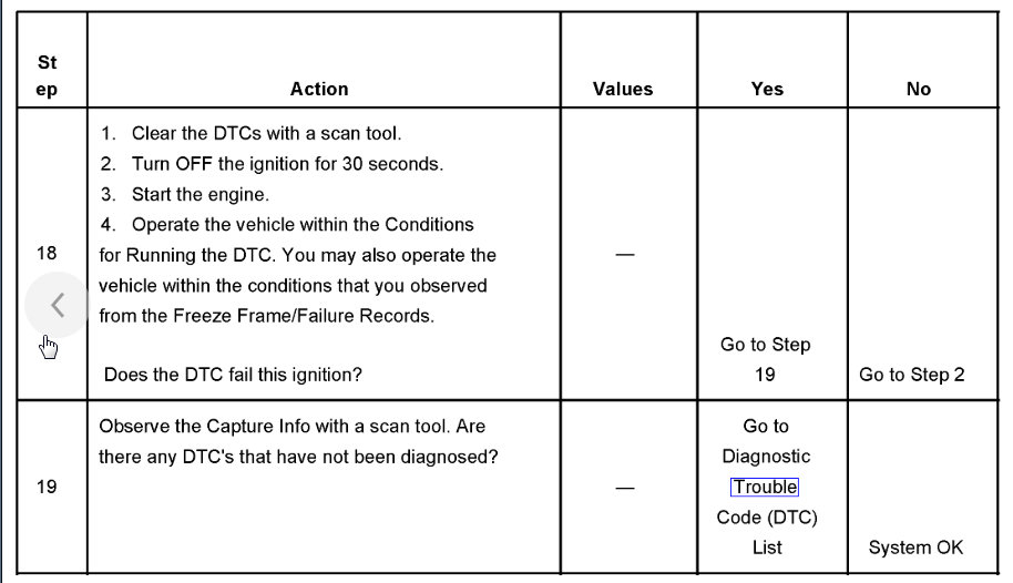

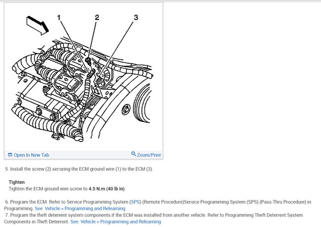

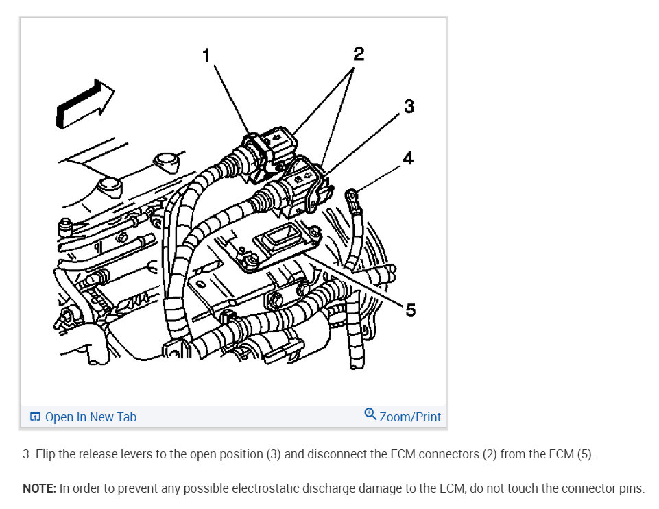

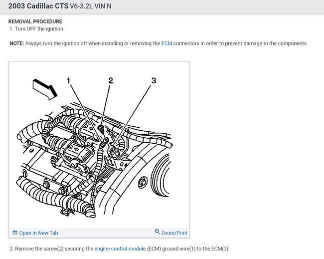

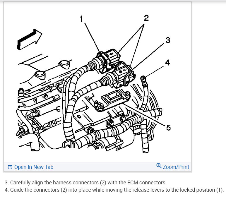

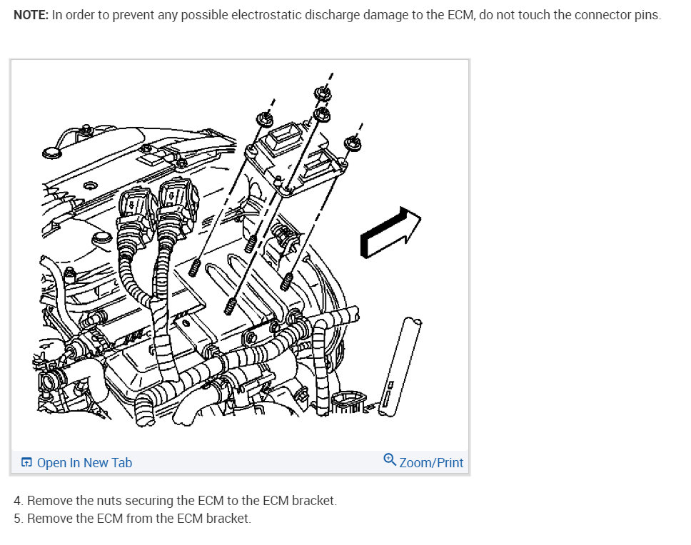

I am going to ask for another tech's opinion, but in all honesty, I suspect something to be wrong with the ECM.
Lets see what he says.
Apr 28, 2020 at 12:31 PM
  • 55,688 POSTS
Yes, it sounds like the drivers inside the PCM have gone bad, probably due to the shorted wiring. I would try a rebuild unit please give your VIN number when ordering. Here are the instructions on how to replace the unit in the diagrams below. Yours should have this done before you get it.
