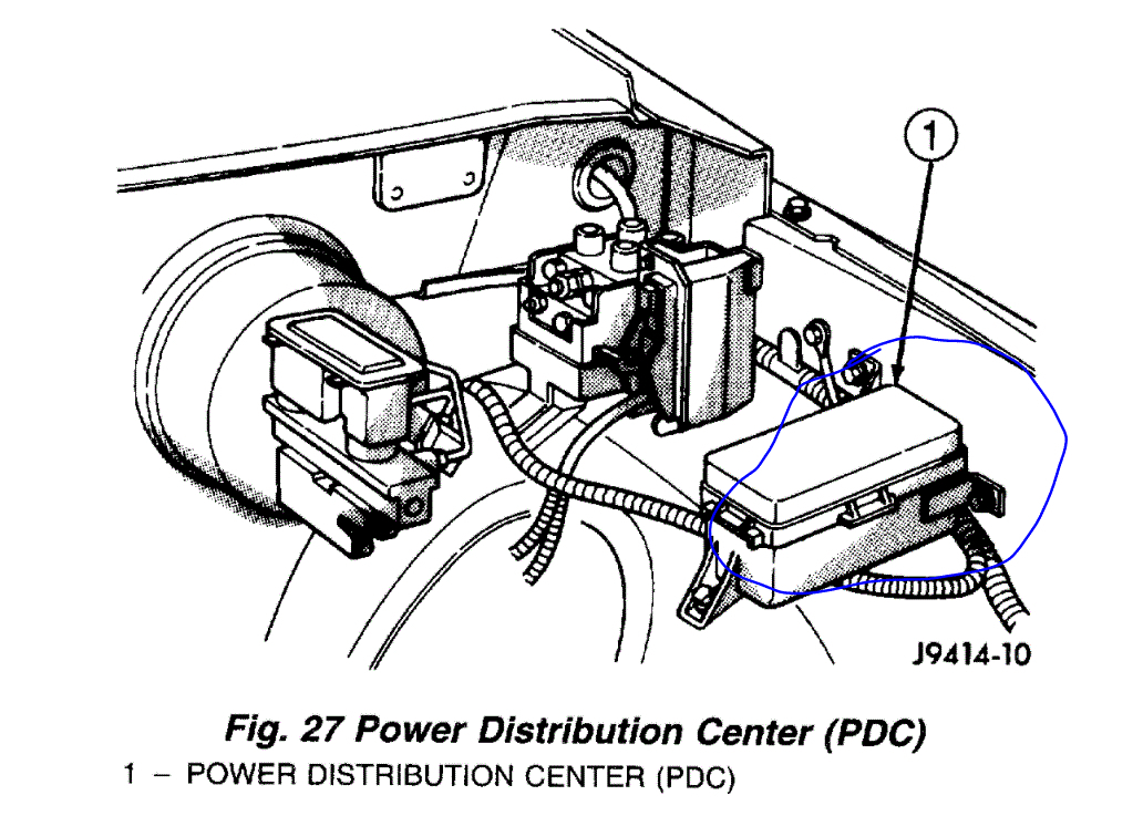

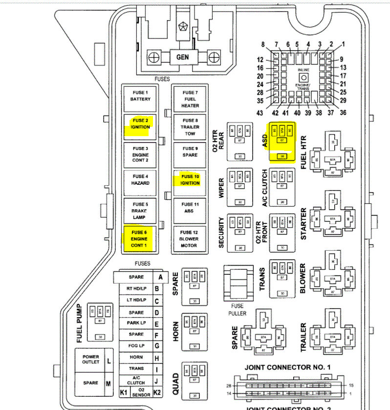

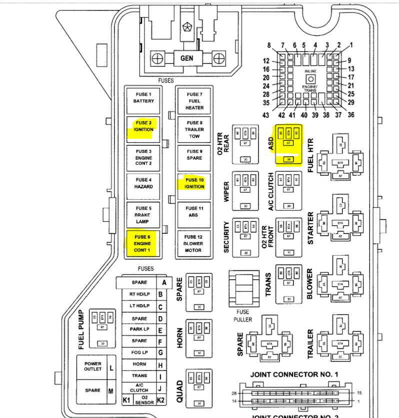

There are a couple of things I want you to check. First, there is an auto shut down relay (ASD) that will cancel spark if bad or tripped. Also, there are three fuses I need you to check.
Below I attached two pics showing the power distribution box under the hood. Pic 1 shows the location and pic 2 shows what to check. As far as the ASD relay, if there is another relay with the same part number, switch them. If not, here is a link you may fund helpful for testing:
Also, in addition to checking the fuses, confirm there is power in and out from them. Here is a link you may find helpful:

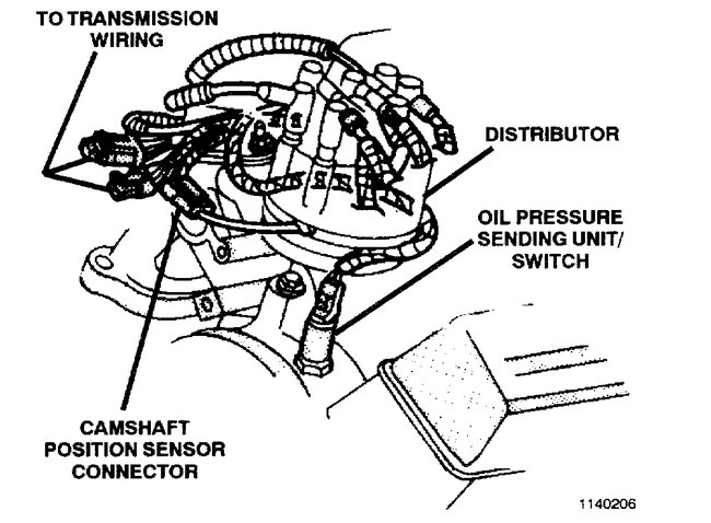

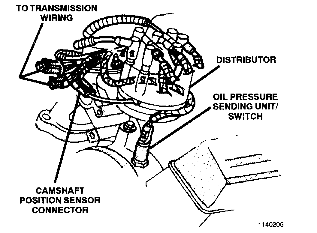

Let me know what you find. Also, if you hear the fuel pump running, we may have to test the cam sensor in the distributor. See pic 3.
