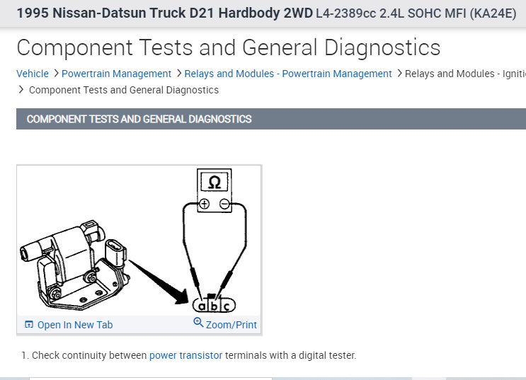

When starting when the engine is cold, it will fire once, and then it will just turn over without starting. Then there is a strong smell of gas. If I work at it long enough to get it started, it runs pretty normal, with a little hesitation for the first couple of miles. I have replaced the spark plugs, wires, distributor cap, rotor, and fuel filter. I checked the fuel and there is no water in it. It doesn't have OBDII, so I can't pull codes.

As far as checking for spark, here is a link that explains how it's done:
https://www.2carpros.com/articles/how-to-check-for-ignition-spark

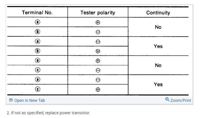

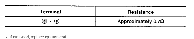

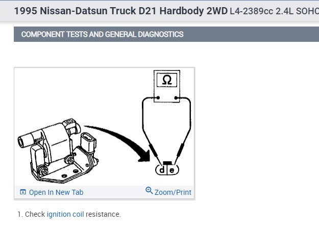

If there is no spark, it could be a few things. The coil itself may have failed, the power transistor (ignition control), and so on.
Have you checked for spark? If there is none, I attached the tests for both the coil and the power transistor. Let me know if you are comfortable performing them. Here is a link that you may find helpful.
Let me know. Also, let me know if you were able to retrieve any codes.
