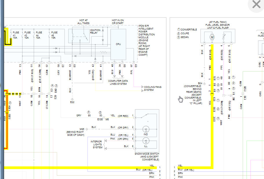

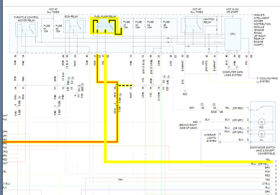

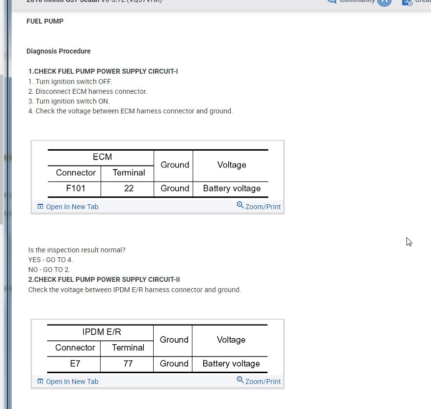

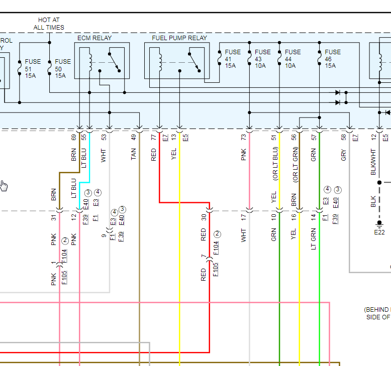

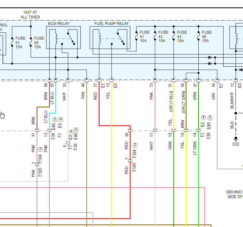

Have one that cranks but no start, i checked the fuel pump fuse and it's good, if there is a relay where is it? I pulled one plug and it is dry. this is a sedan.
Jan 19, 2021 at 4:28 AM

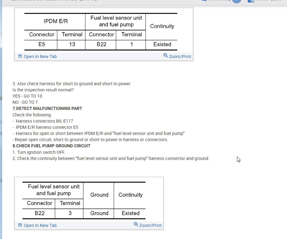

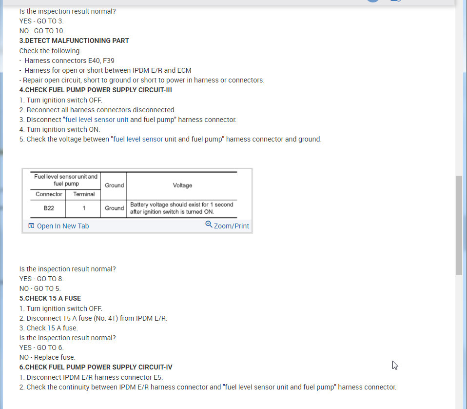

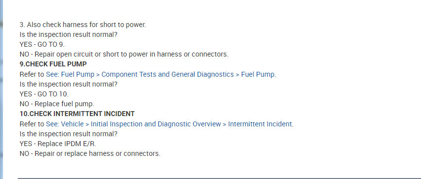

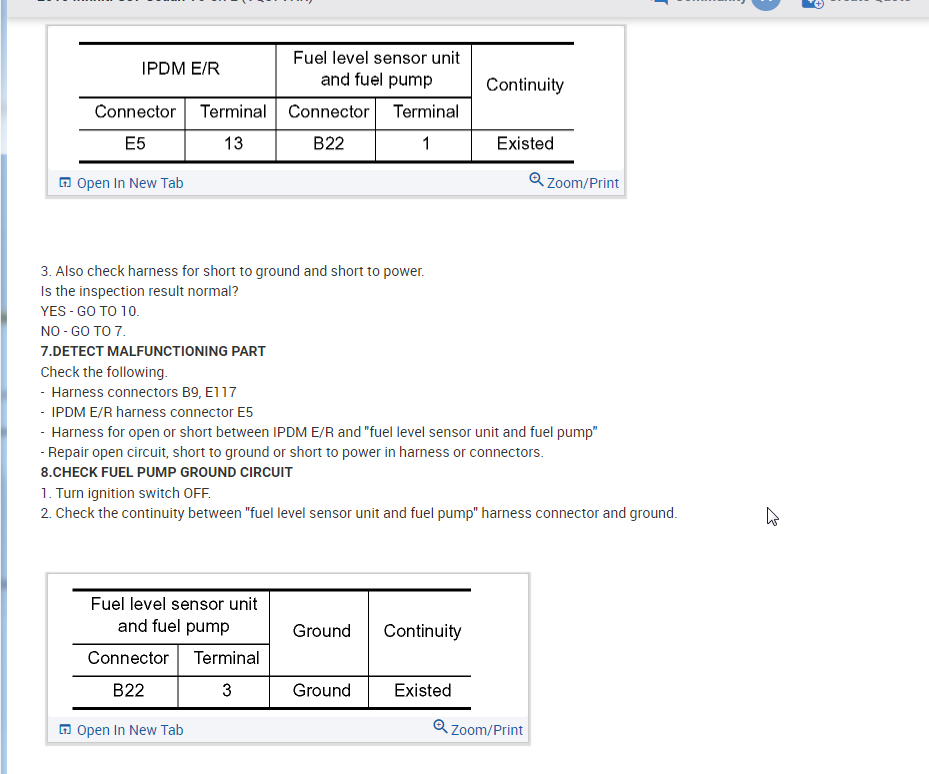

There is a relay for the fuel pump. It is in the IPDM but I don't think it is serviceable. I attached below the wiring diagram and the testing for the fuel pump for this vehicle.
Also, we can check fuel pressure to confirm this is the issue but it sounds like it is.
See below for this info and let us know what you find.

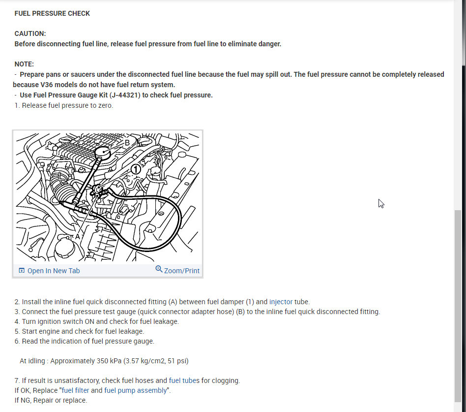

Can you tell me where the fuel pressure port is? Can't seem to find it.

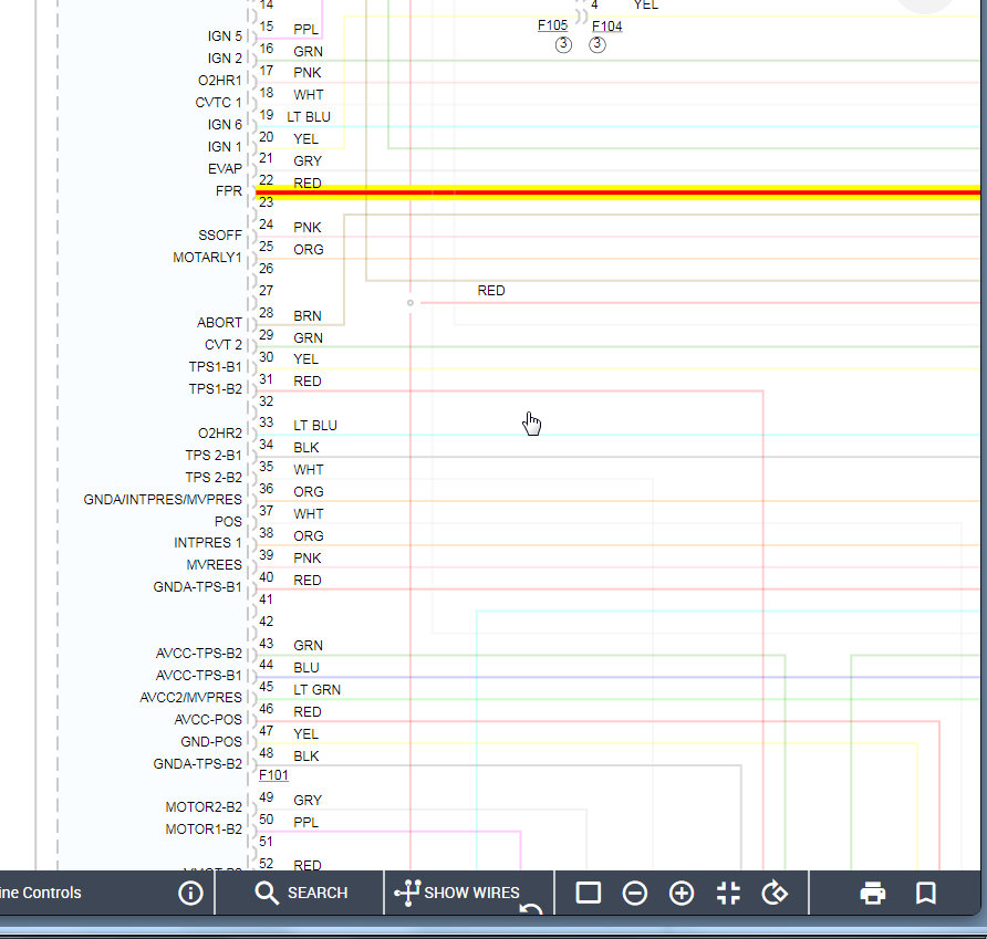

Can't tell from the diagram what color wire should have power once ignition is on, it's confusing.
Jan 20, 2021 at 10:59 AM
The control wire to the relay from the PCM is red. The power supply is yellow from the relay to the pump.
I attached the process on how to test the fuel pressure. Even more reason we need the pressure because if you can hear the pump then the wiring is fine but we need to know if the pump can produce the pressure.
Jan 20, 2021 at 11:09 AM
NASER NASER
  • 836 POSTS
I see, now it's more clear, ugh even japanese cars now need special kits or adapters. i will get it ASAP. it's a kit they use to test the pressure as these cars have no port.

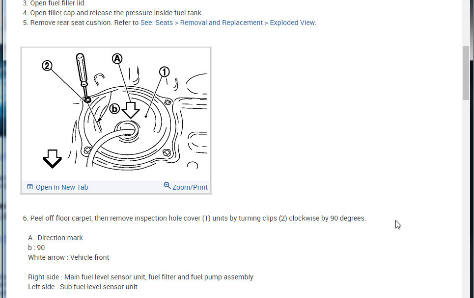

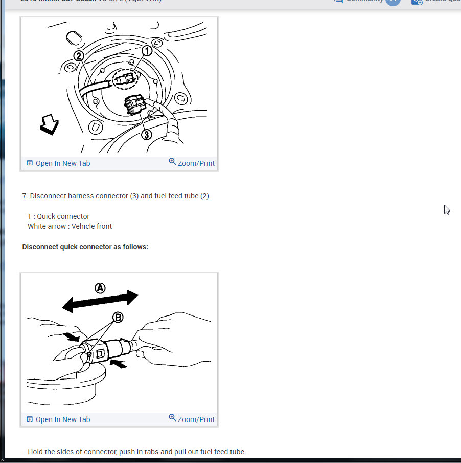

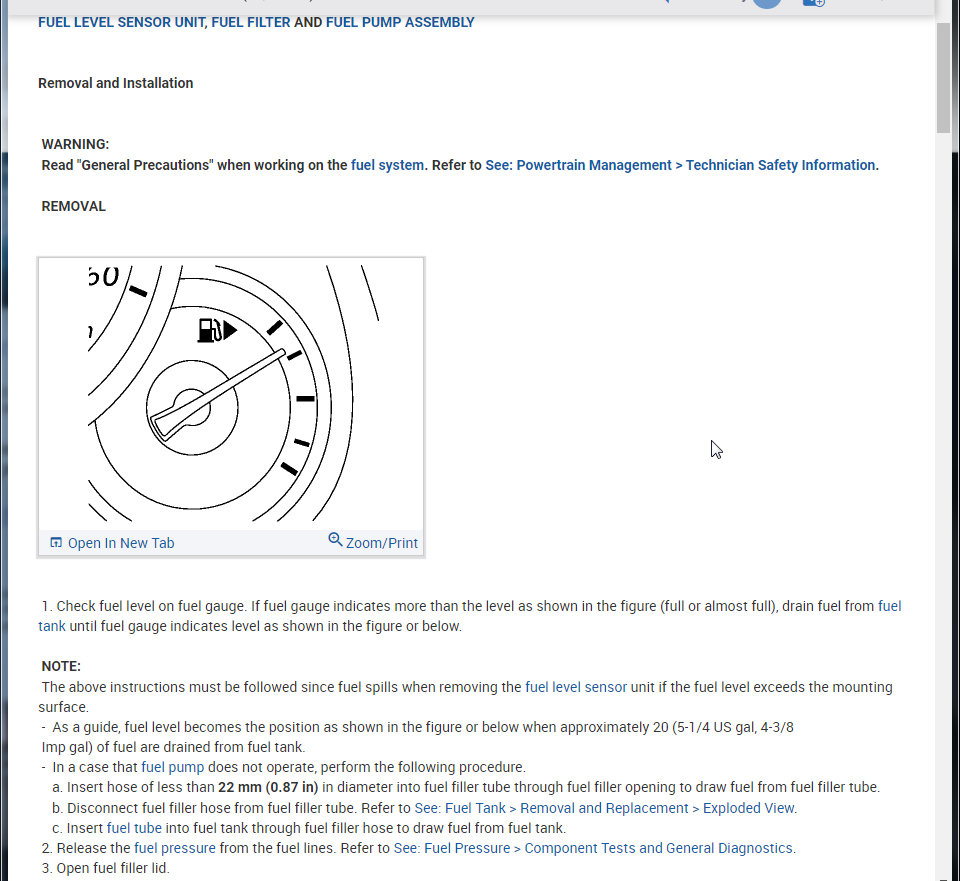

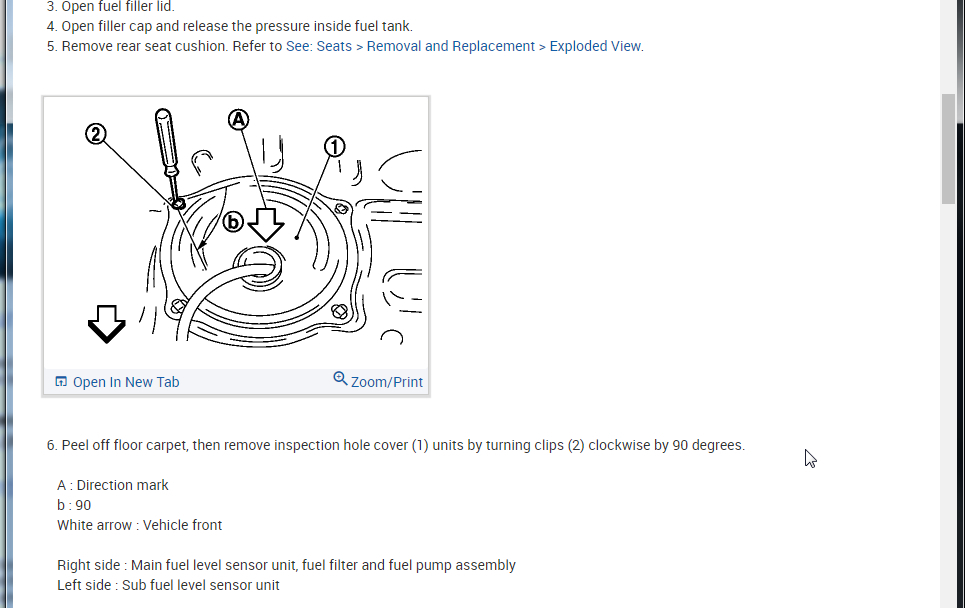

Still waiting on an adapter to test the fuel pressure, but I sprayed some fuel in the throttle and it started for a second so now we know it's a fuel issue. I am hoping it's the fuel pump, as this is an easy replacement, I read others had an issue with the relay and replaced the IPDM, but I am not sure if it is just the small box by the big fuse box or if it's the whole fuse box, crossing fingers.. If the pump is making noise, isn't that an indication that it's getting power from the relay? But test light not showing any light at all at any of the pump wires, unless the test light isn't connected right, I will check again.
Jan 22, 2021 at 7:32 AM
You nailed it. If the pump is making noise then it is a safe assumption that the electrical side is just fine. I would go with the pump as well if it starts on starter fluid.

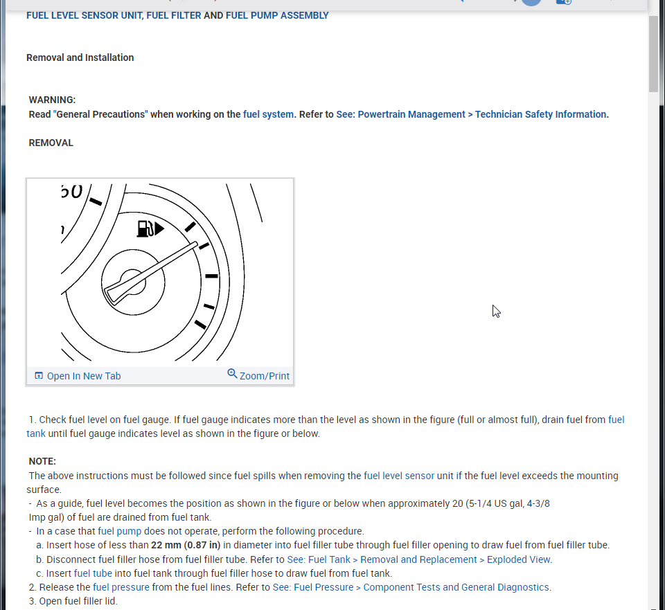

I attached that process from the manual below.
Jan 22, 2021 at 11:16 AM
NASER NASER
  • 836 POSTS

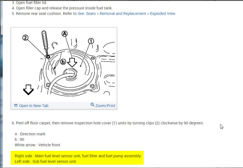

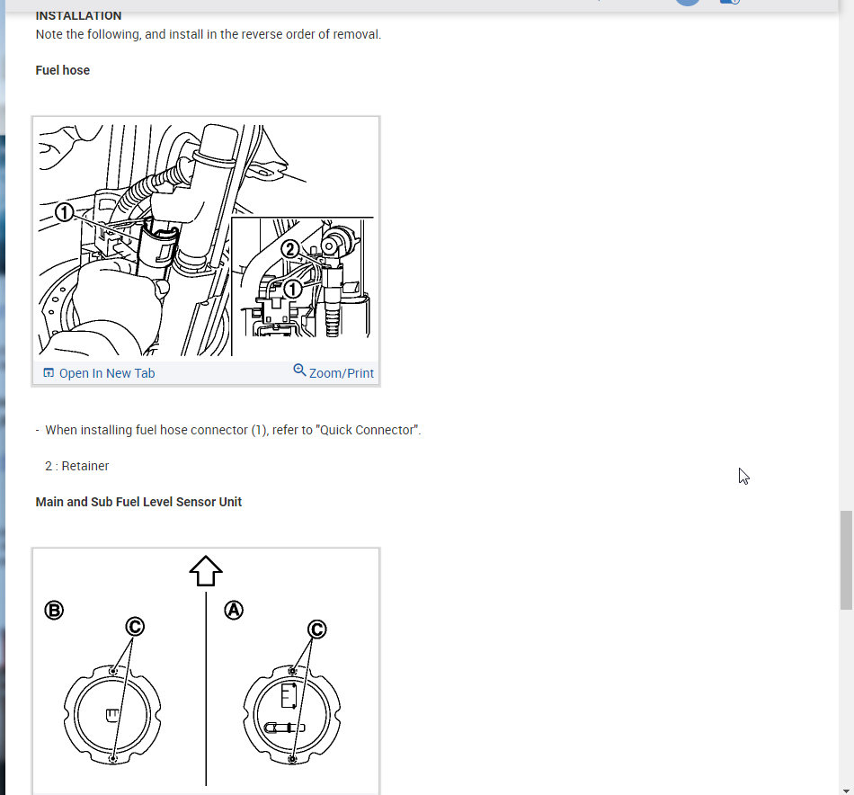

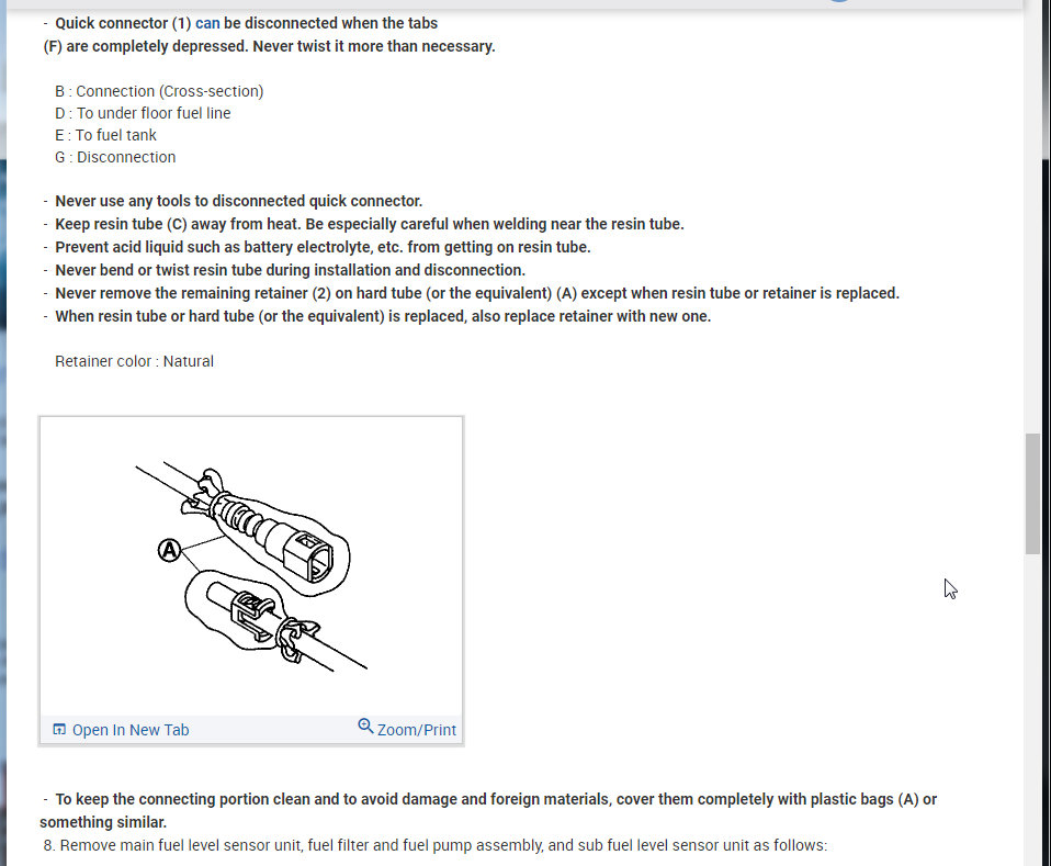

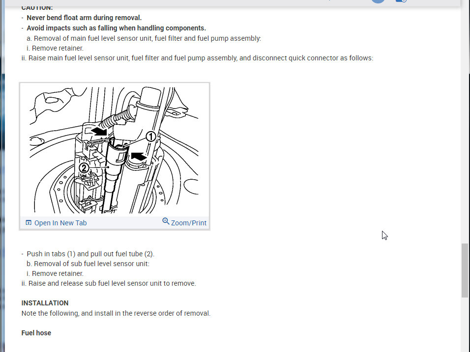

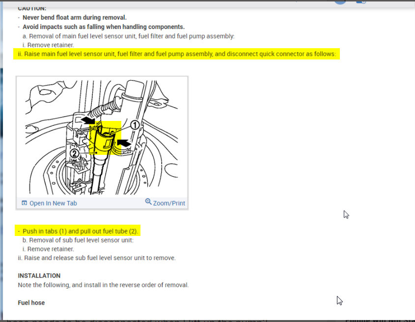

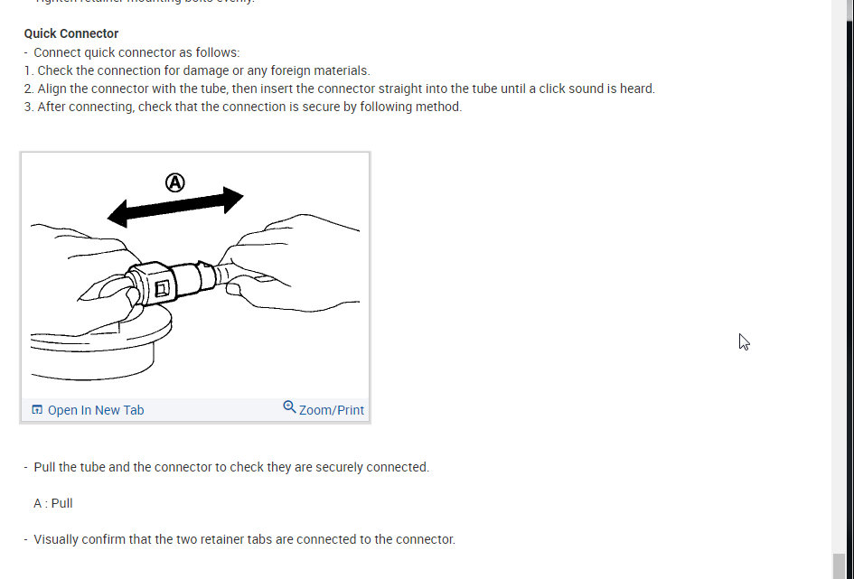

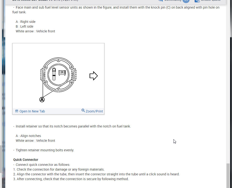

There are two u its on this car one behind passenger one behind driver, the one behind the passenger is the fuel pump and i assume the one behind the driver is the fuel sending unit? The directions talk about disconnecting the sending u it from pump, i can't tell from the picture but correct me if am wrong, there is a hose that runs from driver to passenger side pump and that hose needs to be disconnected when i lift up the pump?
Jan 22, 2021 at 11:44 AM
Yes. You are correct. Take a look at the highlighted sections from the attachments below.
When you pull up the main unit there is a fuel line that is highlighted and you release that with the tabs. Then the main unit should come out.
Hopefully this helps but I think you are on it.
Jan 23, 2021 at 9:14 AM

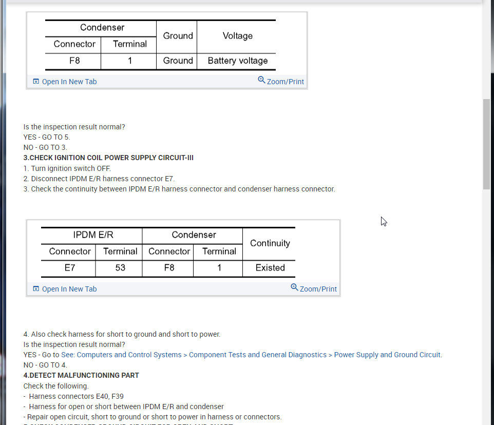

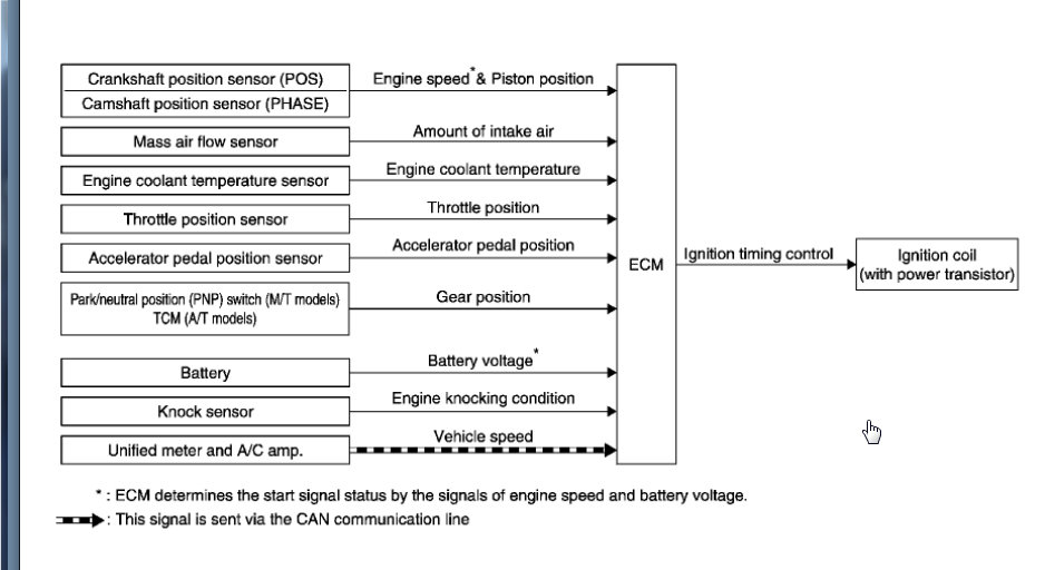

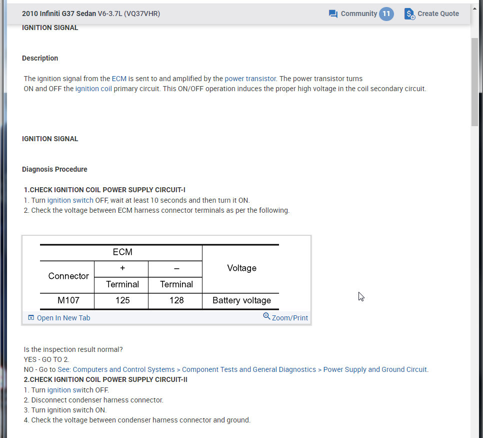

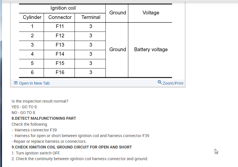

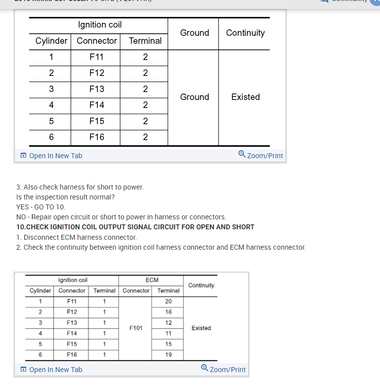

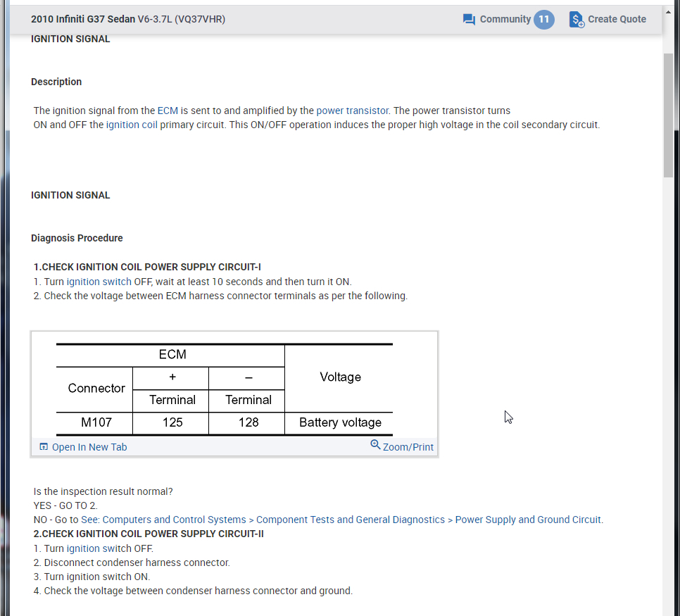

Checked on soaked plug again and it is a bit wet so there is fuel, placed a spark plug to ground and there is no spark. is it safe to say that the ECU is bad? If it was the crankshaft sensor it would not have had any fuel. No codes whatsoever.
Jan 30, 2021 at 7:27 AM

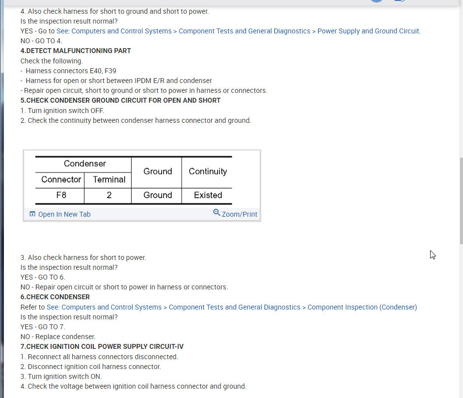

Okay. That is good. Yes. It could be the ECM but that just sends the signal to the coil on when to fire the plugs so it could still be sending the signal but the coil is faulty.
I attached the process on how to test the ignition system but the idea is to go back through the system from the plug and find where you do have power. If you get to the coil and do not have power coming in then we can assume the ECM is the issue.
Jan 30, 2021 at 9:21 AM

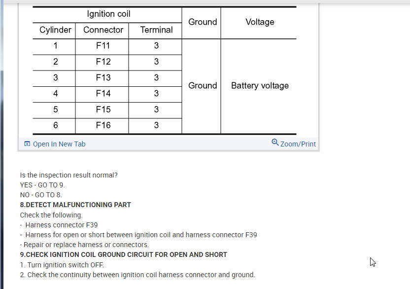

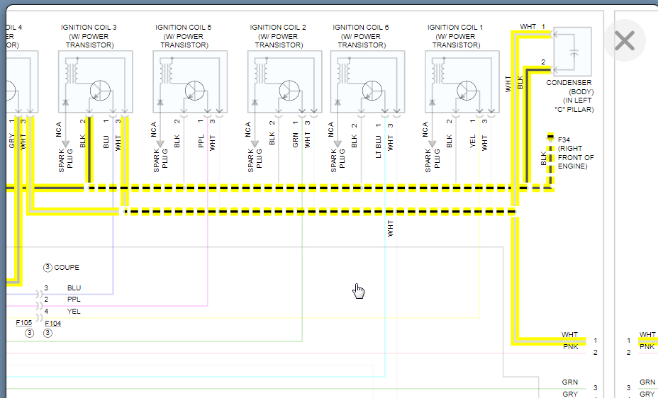

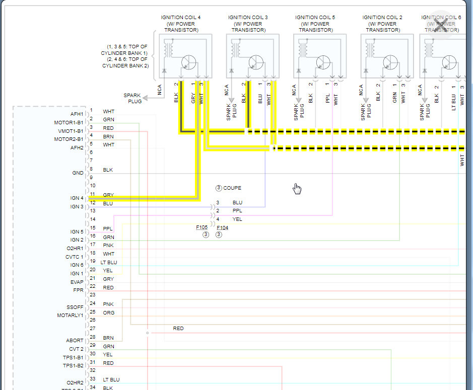

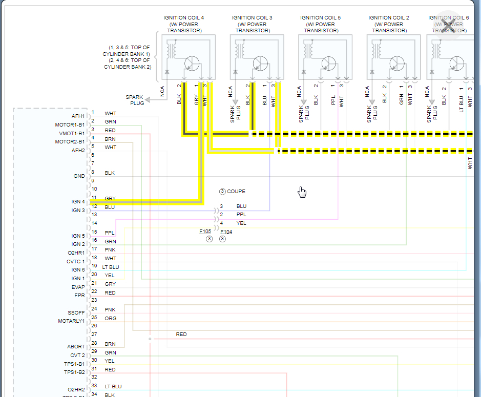

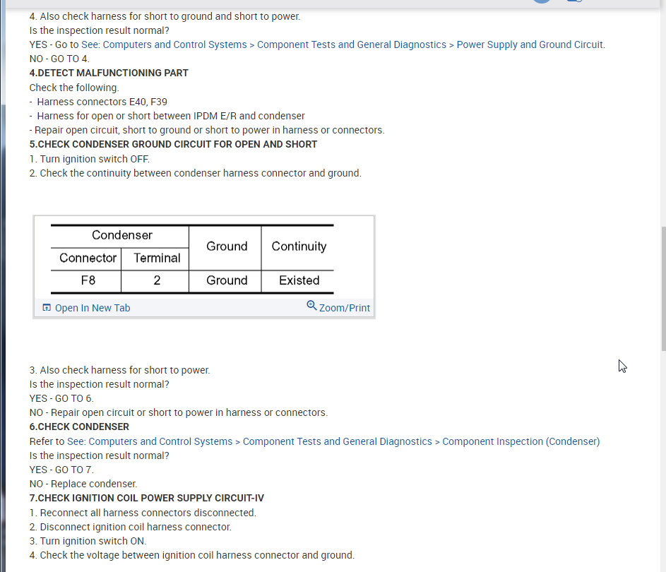

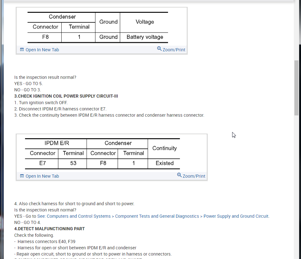

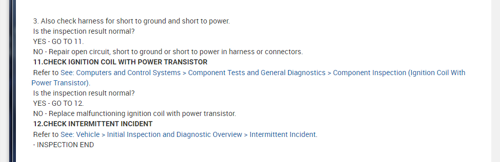

Thanks for the info. Hard to believe that all the coils are bad, i will check power at coils and see if i find anything. Which of the coil wires should have constant power when ignition is on and which lights up when starting
Jan 30, 2021 at 9:51 AM
NASER NASER
  • 836 POSTS

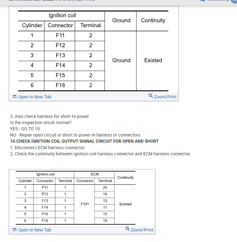

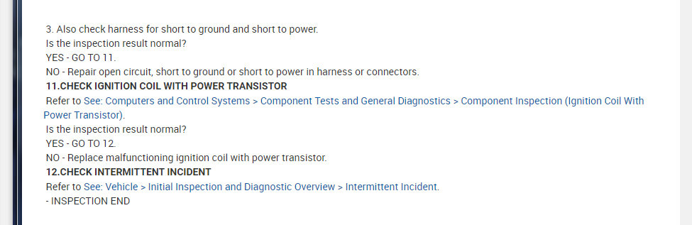

There is power on one of the wires when ignition is on, there is also ground, the 3rd one has no power when starting the car. so i assume no signal is coming from the ECU.
Jan 30, 2021 at 10:23 AM
Great job. I attached the diagram below. Assuming it is the wire in pin 1 from the ECM which should be fired when that coil is to be fired, then I would agree the ECM is faulty.
It is odd that all the coil drivers on the ECM have failed so just make sure the theft light or something silly like that is not on.
Jan 31, 2021 at 8:27 AM

Yes, first thing i checked for is the alarm light but i cannot see it flashing anywhere. also what is the job of the condenser? I read anoit it few times.
Jan 31, 2021 at 8:40 AM
The condenser is what supplies the low side voltage. So it supplies the 12 volts and then the ECM sends the signal for when the coil is to fire the plug so the coil interrupts the 12 volt feed to create the high voltage spike which gets delivered to the plug.

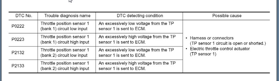

I know you guys are busy, so i kept looking and found it, it's a PITA but replaced it. Put a new battery, and tried, i got about 1/2 second of it starting so that's something different but then the battery started to get weaker. But it now sounds like it wants to start. I wish it would give me codes, only thing that is always there but not under current codes or pending but permanent are: p2133, p2119, which were there from before but i doubt these would stop the car from starting.
Feb 19, 2021 at 7:35 AM
NASER NASER
  • 836 POSTS
Also, the old crank shaft sensor was bone dry. isn't it supposed to have oil on it like camshaft sensors?

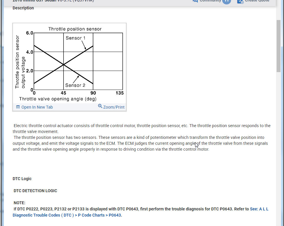

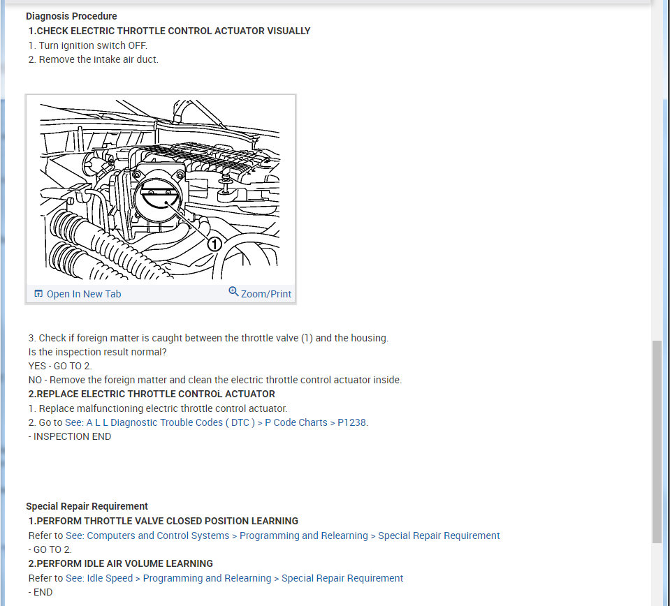

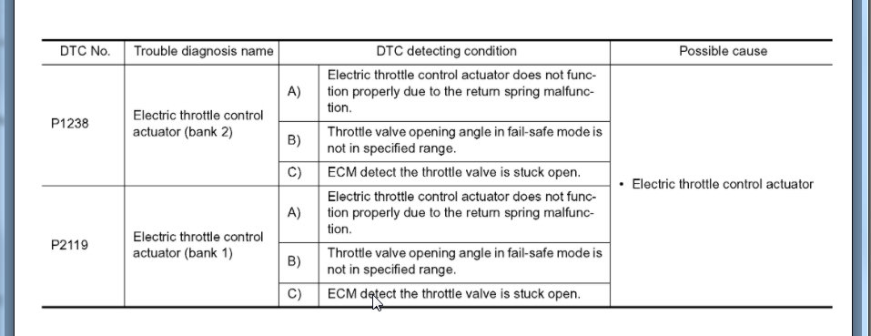

Feb 19, 2021 at 7:52 AM

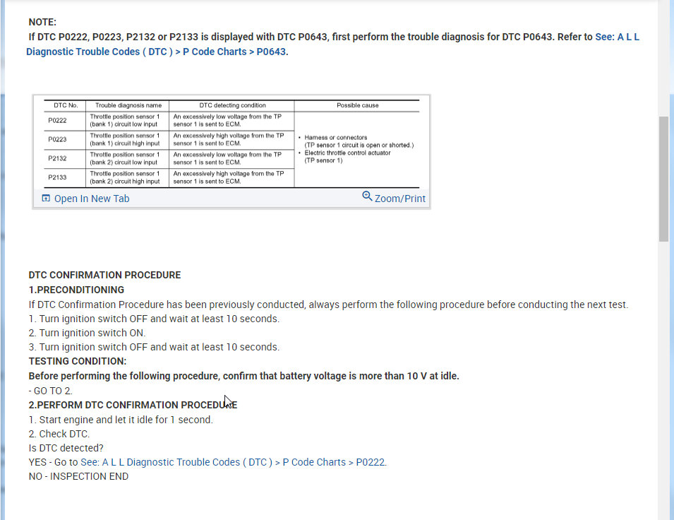

No. The crank sensor needs to be dry. It is only reading the rise and fall of the crank tone wheel so there is no oil.

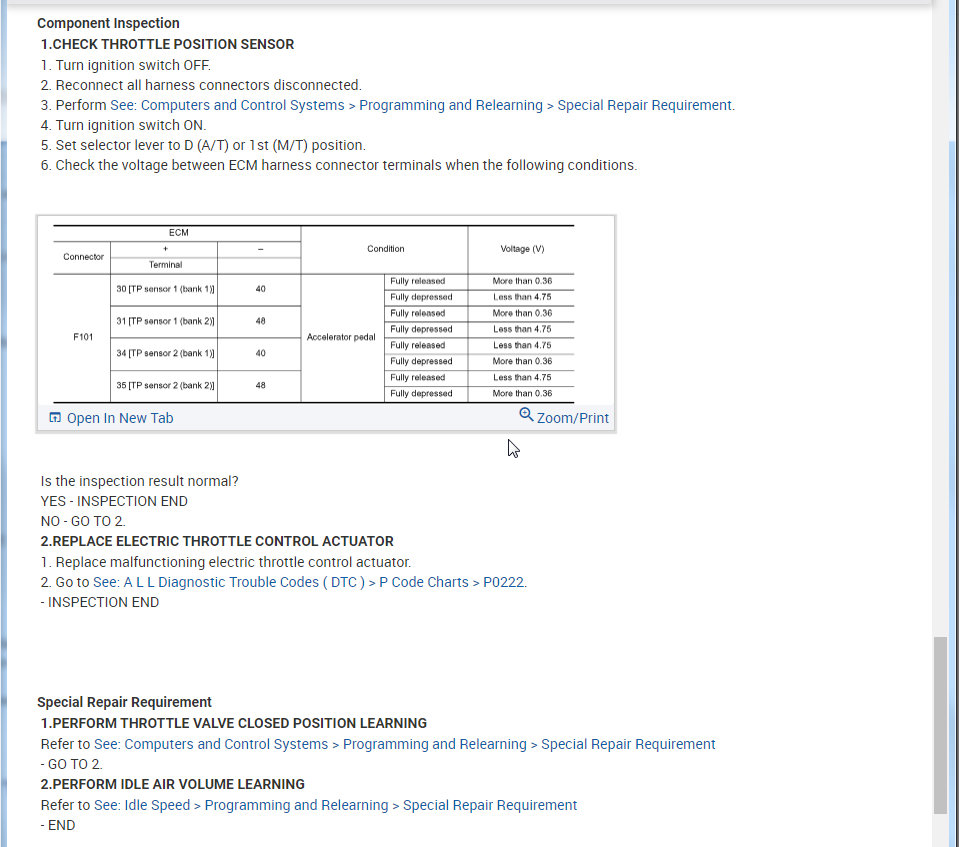

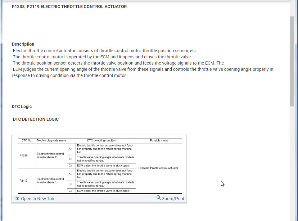

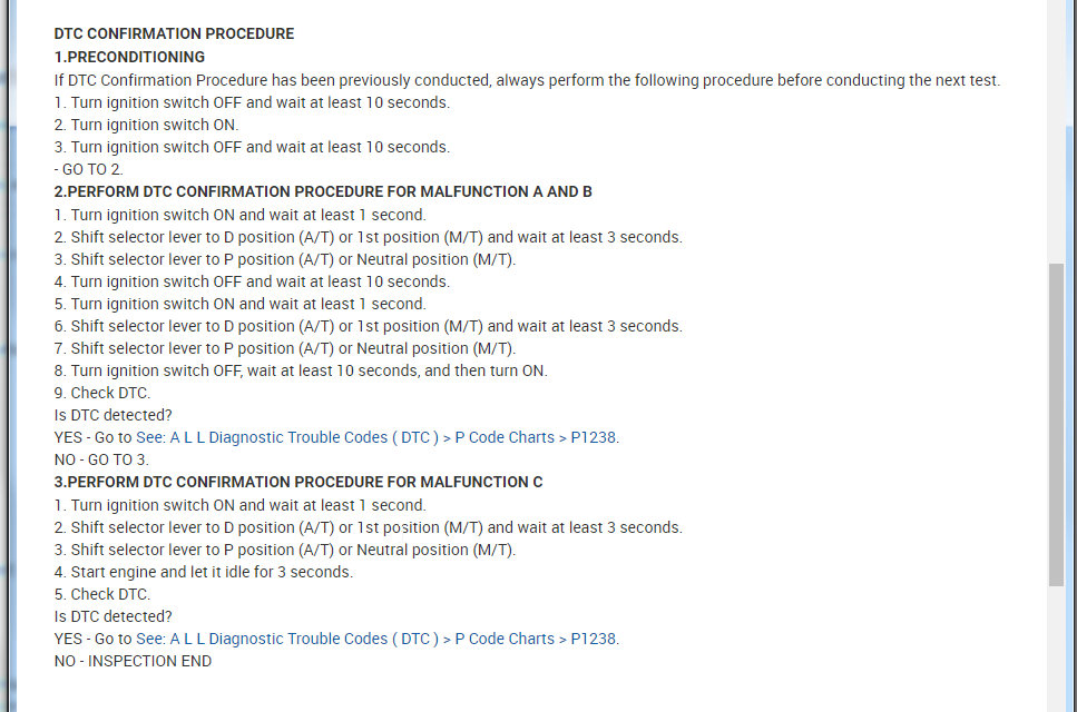

Looks like you have a throttle body issue. I attached the info for these two codes. However, I would pick one as I suspect you fix one it fixes the other.
Feb 20, 2021 at 9:26 AM
NASER NASER
  • 836 POSTS
Thanks for that. i will have it checked out. If i do, could that prevent it from starting? Also, when i spray starting fluid in one of them, sometimes the car would almost want to start, but the fuel pressure is good, and there was fuel coming out from where i measured the pressure, so is it possible that fuel is getting there bit injectors aren't firing?
Feb 20, 2021 at 9:42 AM
NASER NASER

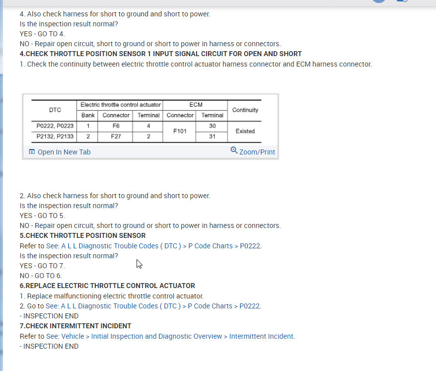

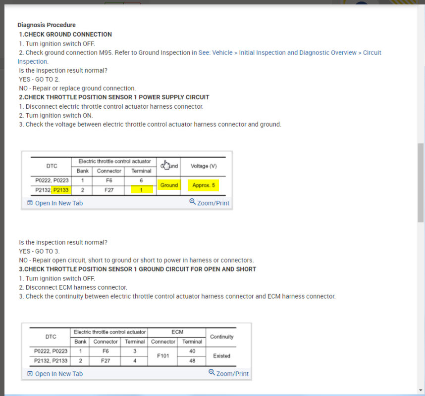

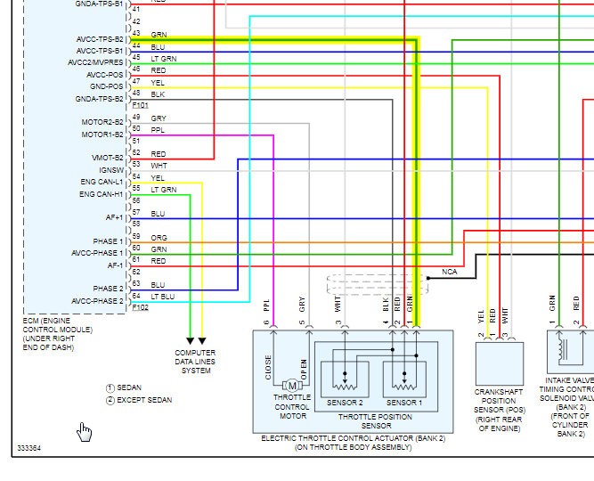

  • 836 POSTS

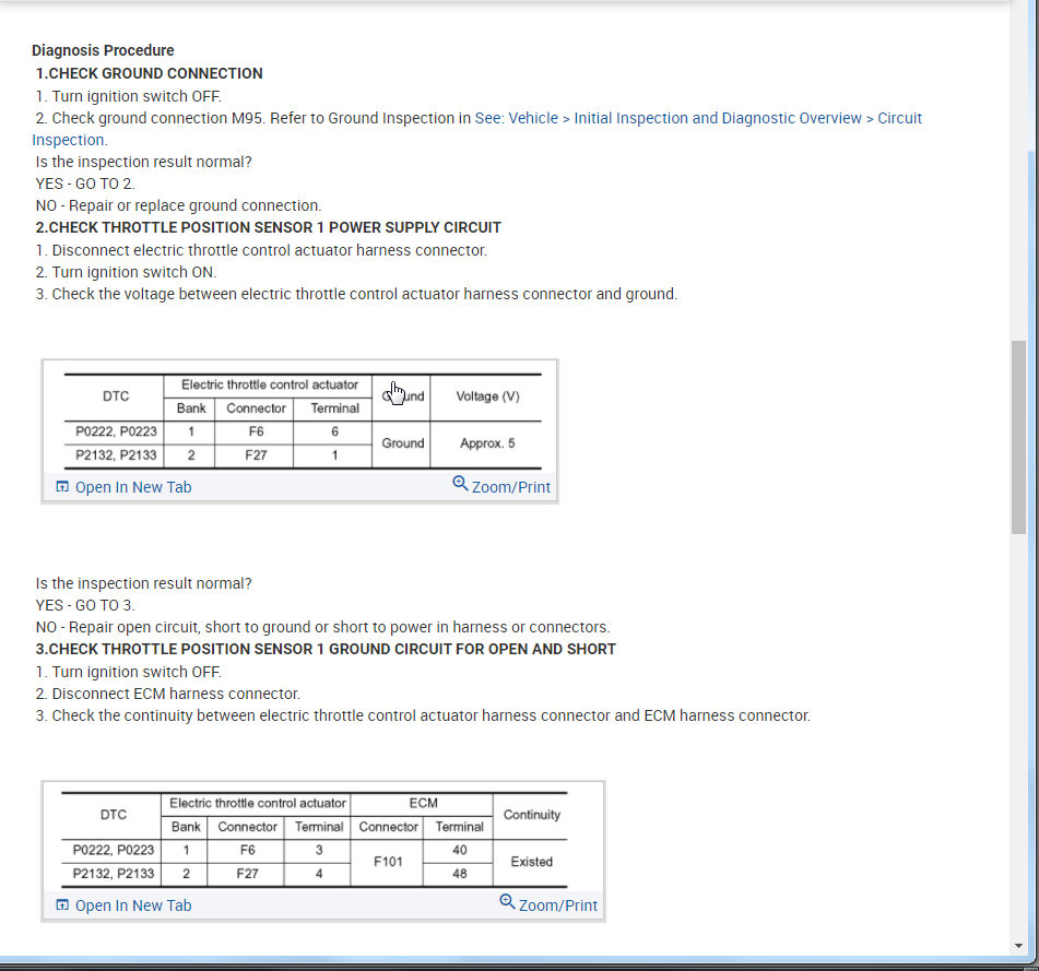

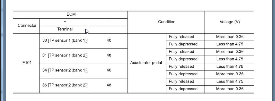

Only thing they giving me is to check volts between pin 6 and ground and it has 5 volts, and there is continuity between ECM and throttle harness.
Feb 20, 2021 at 11:53 AM
You mean pin 6 of the TP sensor? If so, you are testing for the wrong code. You had the P2133 which means we need to check pin 1 and ground.
Basically it is the same wire just on bank 2 actuator.
Take a look at the highlighted section below and wiring diagram.
Feb 21, 2021 at 11:14 AM

  • 836 POSTS
It does have 5 volts.

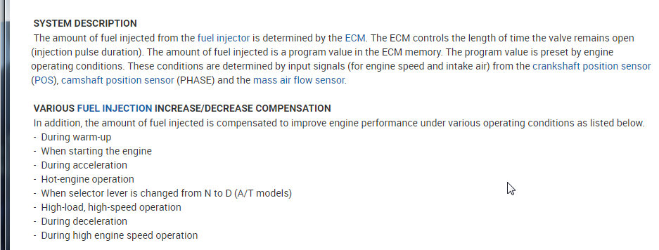

Sprayed starter fluid the other throttle and started for a second and shut off, that means there is spark but no fuel right? How do i know that injectors are firing even though there is fuel reaching the fuel pressure lines?
Feb 23, 2021 at 3:06 AM
That is correct. If just adding a fuel source and it starts then the plugs and all other components are operating. It is simply not getting fuel to the combustion chambers.
Here is a guide on how to test the injectors. You need to use a test light or noid light to see if they are firing.
https://www.2carpros.com/articles/how-to-test-a-fuel-injector
If they are firing and there is pressure then they should be delivering fuel.
Feb 24, 2021 at 11:11 AM
