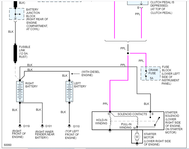

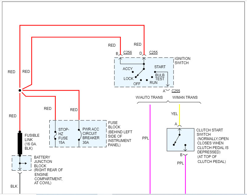

When I first read your post, I was thinking there was an issue with a relay sticking, but there isn't one.
I attached the wiring schematic below for the starter circuit, so you have a reference. Based on what I am seeing, either the ignition switch is faulty or there is a mechanical issue with the starter/flex plate. Did the original starter do the same thing?
See pic below.

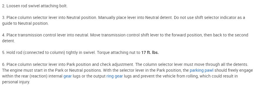

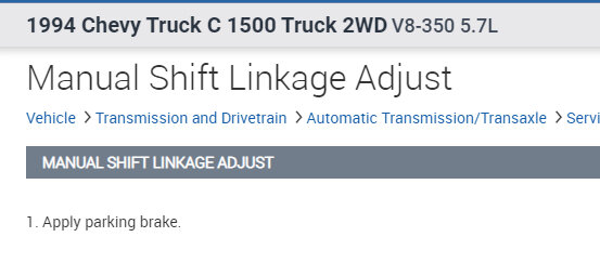

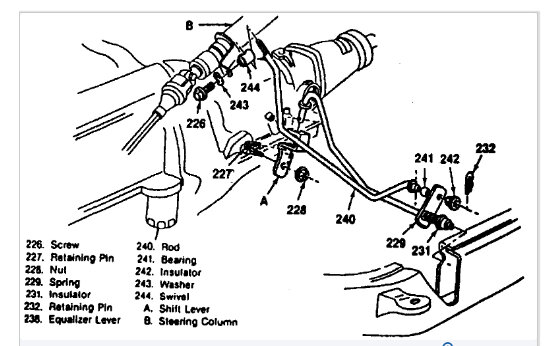

Do you mean the starter won't engage or it does, but the engine doesn't start?
As far as adjustment, I attached the directions below. Try this and let me know if it helps.

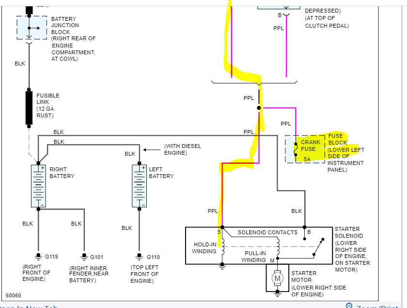

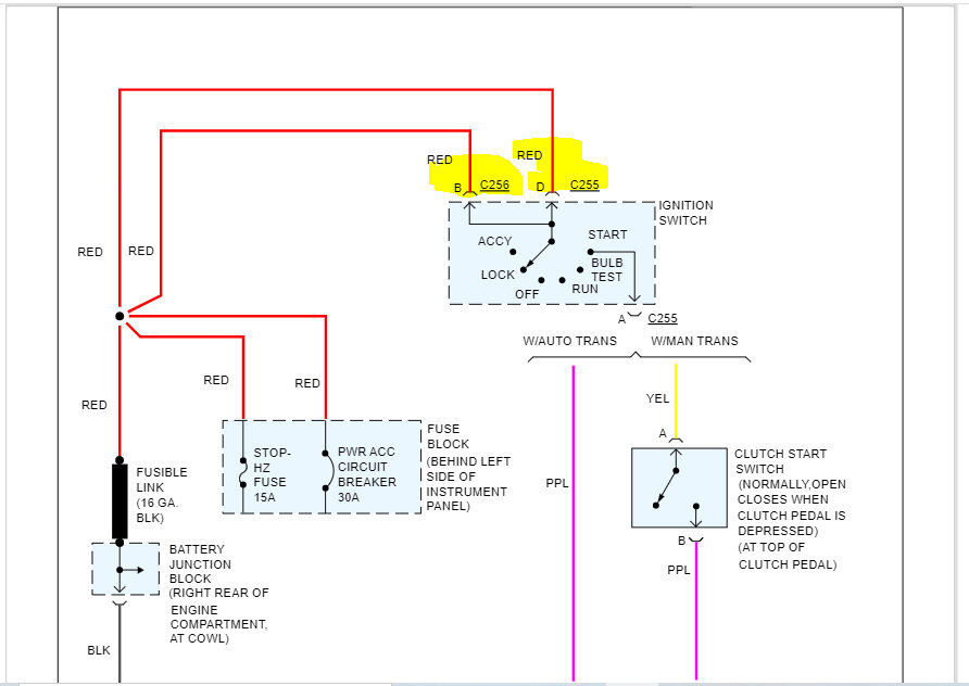

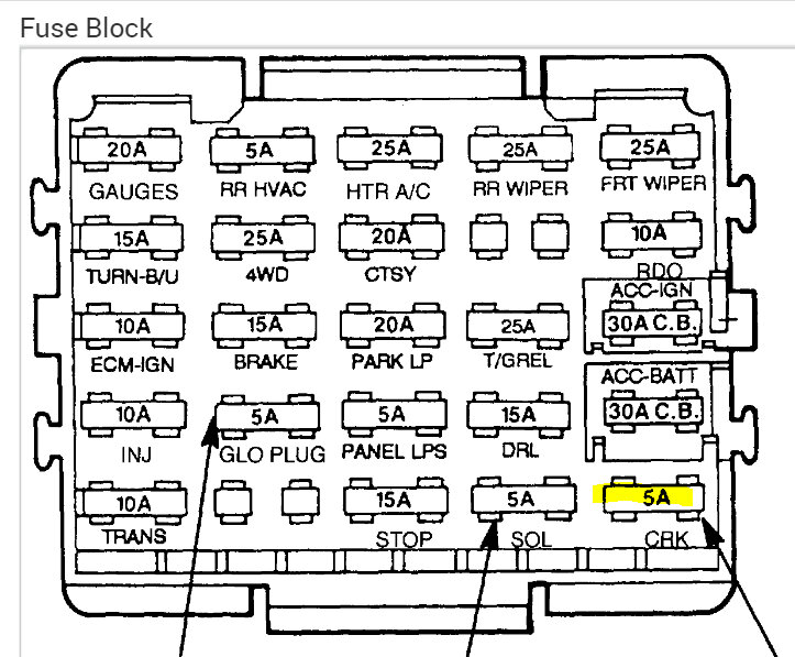

If you want to check the ignition switch, there will be two red wires to it directly from the battery that should have power at all times. Confirm that first.
If they are good, turn the key to the start position and check the purple wire at the switch for power. It should have power only when the key is in the start position.
Have you checked the 5-amp crank fuse under the dash?
Also, I attached the schematic again and highlighted things, so you have a reference.
Let me know what you find.

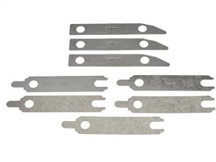

Okay, if it is the starter getting stuck, there is a chance the starter motor may need shimmed. I thought it wasn't working at all anymore. LOL So it is a mechanical issue and not an electrical one.
When you removed the old starter, did you notice if there were shims between the starter motor and where it mounts? I looked up online to get a pic of shims and attached it below.
See pic below.

No shimms when i remove starter .but it was working good .how many shimms should I put on?
Oct 16, 2022 at 2:07 PM
  • 110,248 POSTS
If nothing was removed, then you need to do one at a time to see if that takes care of the issue. Keep in mind, they come in different thicknesses.
You should be able to get them at any parts store. Also, they are not expensive.
Let me know if that takes care of the issue.
