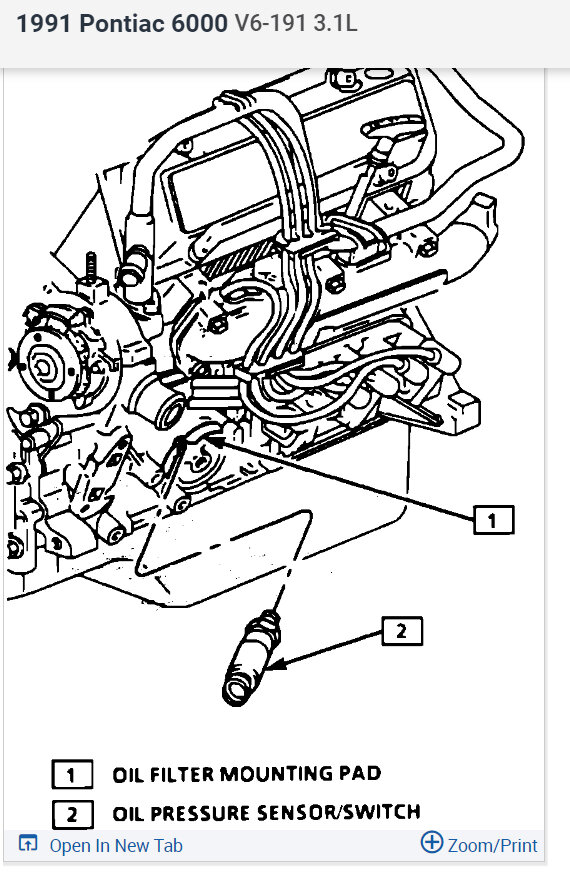

At first the car ran and drove not starting issue?
SNOWINDIESEL
  • 15 POSTS
Starting fluid keeps the car running.
Tuesday, October 1st, 2024 AT 12:33 PM
KEN L
  • MASTER CERTIFIED MECHANIC
  • 48,363 POSTS

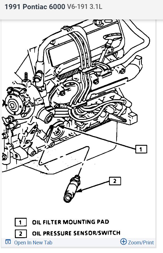

So, it is losing fuel pressure, you said you installed a new fuel pump and filter, correct? Also, I have seen the oil pressure sender switch cut out the fuel pump due to low oil pressure. Here is the location so you can bypass it to see if things change. Check out the images (below). Please let us know what happens. Connect the orange and grey wires.
Wednesday, October 2nd, 2024 AT 9:04 AM
SNOWINDIESEL
  • 15 POSTS
Ended up being a bad injector shorting out causing the ECM to go into a safe mode by shutting all injectors off. Put in 6 new injectors. It fires up and runs like a top now. I guess early GM MPFI systems all do this?
