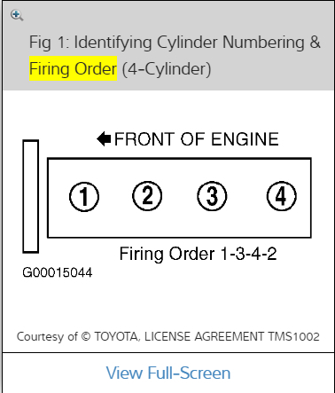

Al, I was going to try and set the timing. I installed my compression gauge into #1 cylinder to know when it was on compression stroke. There was no compression, so I checked the rest. #2, 0 PSI, #3 strong, #4 about 60 PSI. I didn't get the final numbers. So, could this be due to timing where both valves are open at the same time? Why would #3 be strong, #4 weak and the other two zero? Baffled. How can I set #1 to TDC compression with no compression?

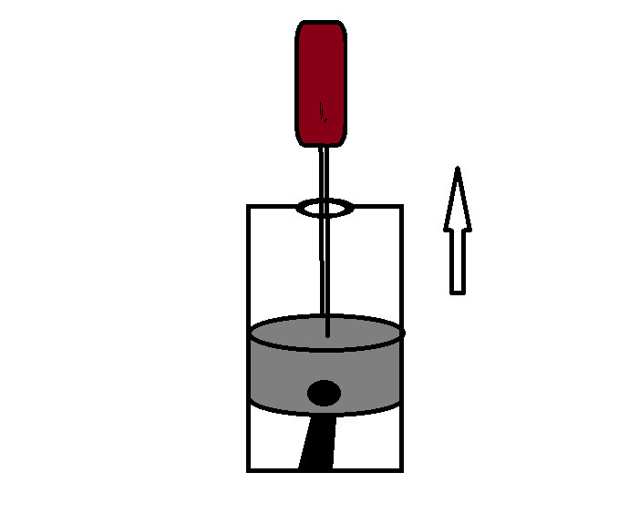

Thats not good. If the chain jumped more than just one or two teeth like what it first seemed, the pistons could have hit the valves. Since the pistons on these engines are straight down, you put a long screw driver down or thin pole until it rests on top of the piston and turn the engine over very slow by hand until the pole moves to its highest point, once it's at its highest point it will start moving back down then you know you're at TDC, for the #1 cylinder the marks on the crankshaft pulley will be lined up too. I was hoping the chain had only jumped 1 or 2 teeth because there was a cylinder back firing through the exhaust, it must have been the one cylinder doing that, Best thing you can do now is rotate the engine by hand, get the number 1 up to TDC and if you have one of those compression gauges that you can take the gauge off and attach an air hose to it. You can put some compressed air into the cylinder and see where it's leaking out. But remember you're not going to have compression right now. The valve timing is off for the most part. You were doing a cranking compression test I assume? Sorry for my crude drawing below, but this is how I would find TDC with a loose timing chain. Crank it over by hand.
Also, you didn't do any damage during your compression test, whatever damage was done, happened when the engine quit running.
The mark on the Harmonic Balancer is for the #1 TDC. And you probably have the valve cover off. Every 1/4 turn of the camshaft is the next cylinder at TDC. So, when you have the 2 cams up on the #1 TDC, if you turn the cam only 1/4 turn, you next cylinder (#3) is up on TDC. The firing order is 1-3-4-2.

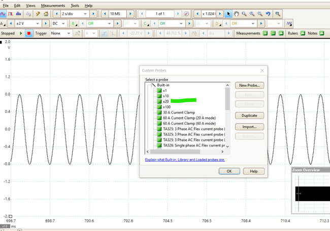

Yeah, that's cylinder #3 that hit 125psi is a bit strange with all the others at 0. At least the valves aren't bent in that one, or it could be that the particular cylinder happened to have the chain slack on the opposite side, so the cylinder sealed up. But it's tough to tell until you get things lined up and see how far off it is. I don't know if you use oscilloscopes, but it's a great way to check valve timing, either doing in-cylinder pressure testing of scoping the cam and crank position sensors and finding a known good waveform for that car (which I can get for you). And comparing the signals. But using a scope takes some practice, If we're going to be exchanging parts id better email you about that instead, but I'll still help you with diagnosing the Camry here. I am curious to see the condition of the engine. I'll see if I can find any other information about the valves, if that's an interference engine or not. It would be really great if it was not.

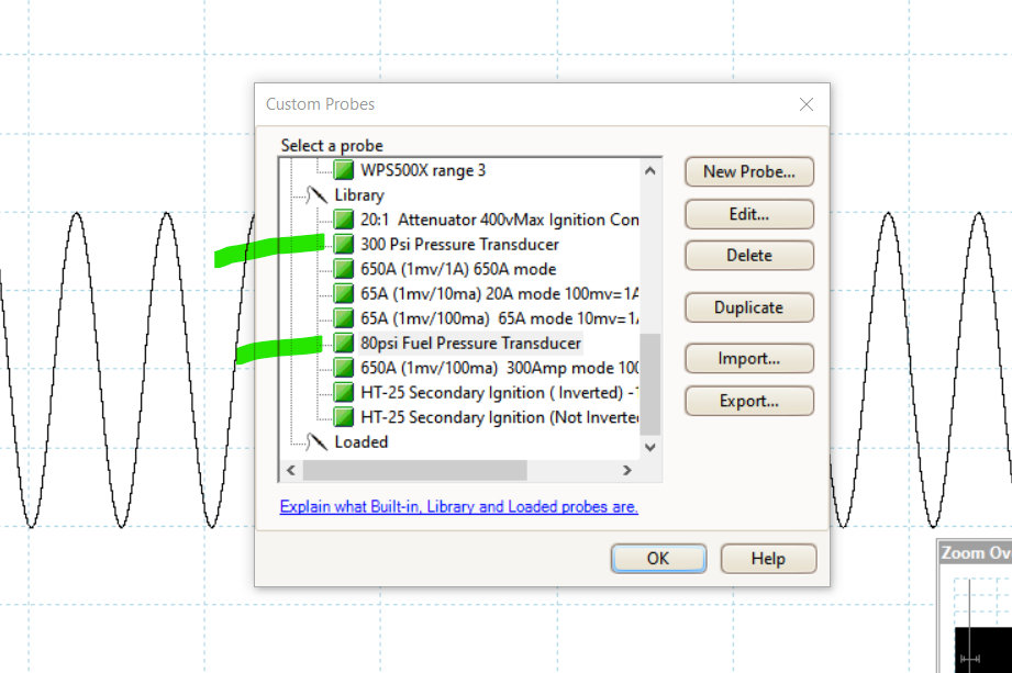

You're exactly right, they act like nothing will go wrong, it's not even the chain stretching so much as it is the chain guides failing, once they break at one of the 2 bolt locations, the guide is flapping in the breeze. As for scopes, if you have a laptop, Pico has a scope 2204A, it's not an automotive scope but it's just over a $150, 2 channel. I'd be glad to show you how to use it and tricks that can save you having to tear motors down to find faults. Their software is free too, you could download it right now to try it in demo mode. I use my scope for everything. And sorry for giving you bad news, it's the worst feeling telling someone there's a major issue with their vehicle.

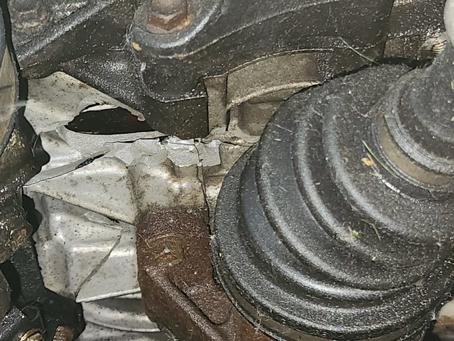

Hi Al, I finally got a look underneath the car and this is what I found: She threw a rod in cylinder number one at least and after that the rest is moot. I'll send you a picture of what I see.

Oh wow, I wasn't expecting it to be that bad. I have seen more rods coming through engine blocks this year than ever in my life. I wonder if this has something to do with oil quality or some other outside reason besides normal wear. It did have a lot of miles on it, but I've worked on some of these that are pushing 280,000 and the engine block is the only sound component left. Thanks for the update. I'll keep that picture for the archives. Sorry to hear the bad news, but thanks for the picture Jeff.

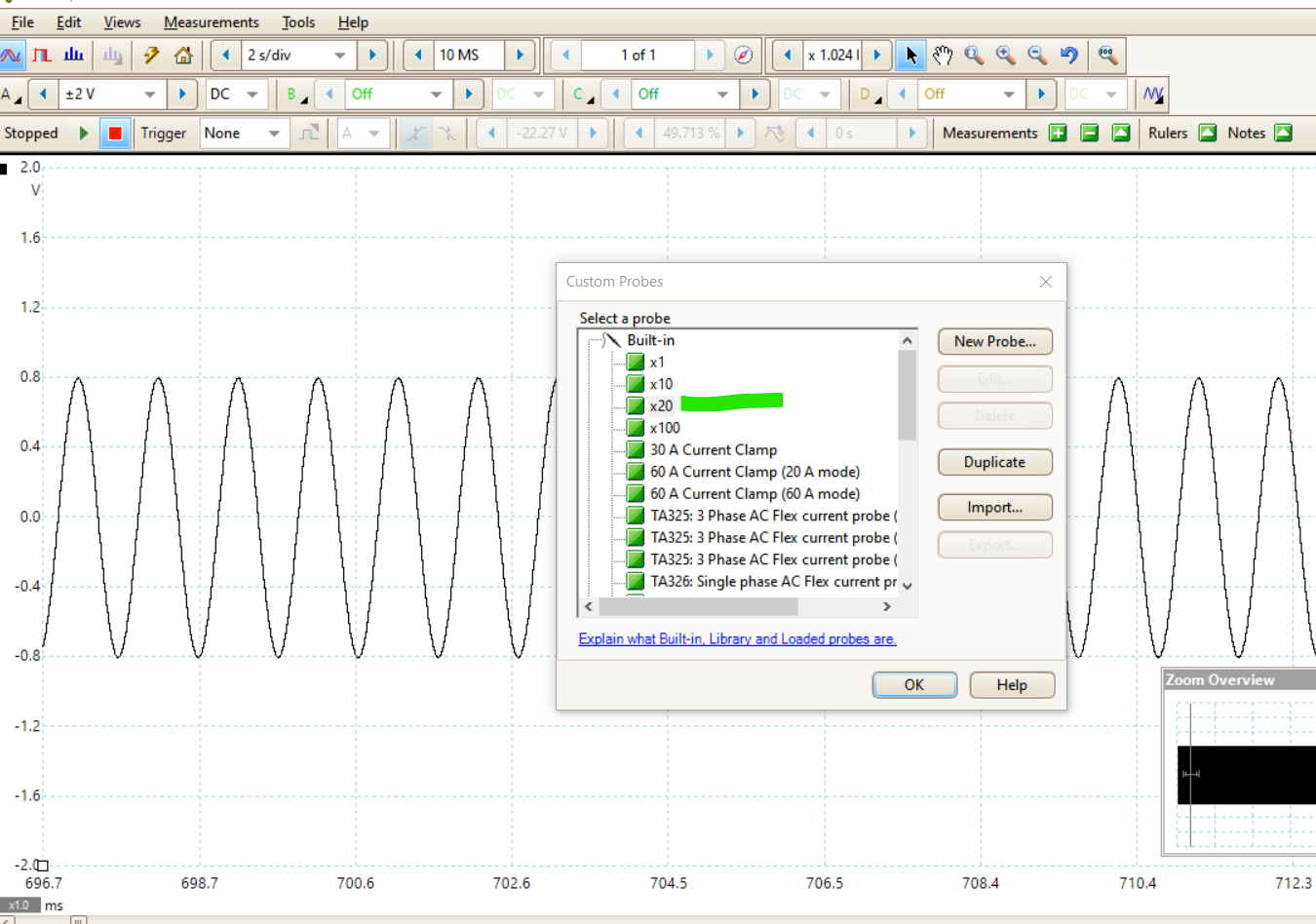

Honestly, I don't know if that scan tool has an oscilloscope built into it, but I saw a video yesterday that was about how some of these aftermarket scan tools can give incorrect data. I posted the video below. But for oscilloscopes I use a Pico Scope, it's a pc-based scope, you can actually go to their website and download and run the scope software. It just runs in Demo mode until you buy one of their scopes, but the Pico does so many different things it's my go to oscilloscope for things that need a very good in depth look at. I also have a handheld Hantek 2D72 which has a multimeter, a scope, and a signal generator built into one. I use that for grabbing quick signals. When I don't want to get my laptop out. But go to PicoTech.com and try the software. It can actually decode CANBUS network data packets. Plus, a million other things. For scan tools, I have an Autel, a TopDon, and a couple older scan tools. The Autel is pretty amazing. Snap On is just so expensive for almost everything they sell, not saying they are not any good because they are, but you pay a lot. The Pico scope also has 3 or 4 pdf files on user information. So, it's easy to learn. I also recommend if you're going to get into using a scope, buy Attenuators with it, at least a couple 20:1. They step the voltage signal down to protect the scope, but you just set the scope on a 20:1 attenuator and it will show the correct voltage. There's a couple of pictures of the Pico 6 software I use, and a second pic is a couple of my own pressure transducers I built that I use for fuel pressure and in cylinder pressure testing. I think for the price of the Solus you could get a couple of other diagnostic tools. If you wanted lessons on using a scope, I would have to do that on the side. I wouldn't be able to do it on here.
