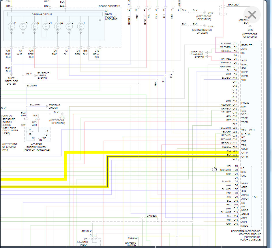

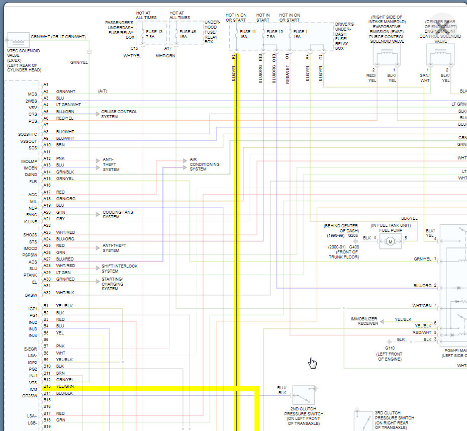

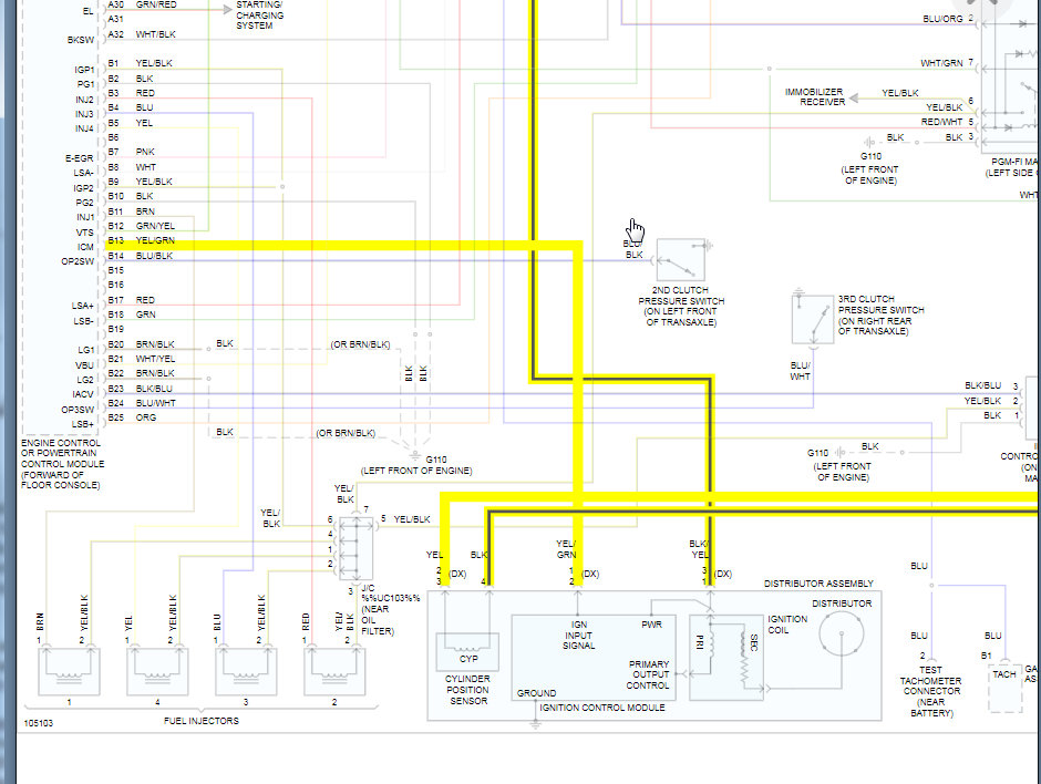

I've replaced the ICM, coil, cap, button, crankshaft position sensor, all fuses are good it's getting fuel. The black/yellow wire is getting power,both wires on coil has power. any suggestions?
Apr 18, 2021 at 7:57 AM
You should have 4 wires on the distributor so we need to check voltage on each of these wires. If you have voltage on the yellow and black wire then that means the fuse is good. So we need to make sure the ignition input is good from the ECM which is should be if the engine cranks.
However, even through you replaced the crank sensor that doesn't mean that the ECM is getting that signal or sending the correct signal so we need to check these as well.
Depending on what we find we may need to replace the ECM but let's cover this first and we can go from there. Let us know what you find with this. Thanks
