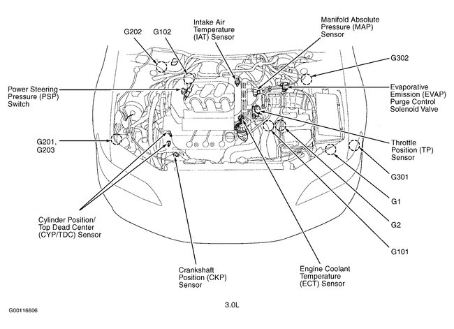

I am trying to help out a grandma. Just wanted to know if top dead center/camshaft sensors both a and b no signal codes would result in a complete no spark situation. She has her grand kids living with her, been without a car for nearly a month and had hack mechanics tells her everything from needs a new computer to I do not even remember. After that they stop showing up. I am in the middle of an engine swap on my truck, do not have any tools not over with that project and I just want to at least give her the actual facts of her problem.
Jan 20, 2021 at 4:59 AM (Merged)
  • 110,244 POSTS
Based on both sensors being bad, yes the vehicle will not run. If you scan the computer and find a P1362 and P1367, chances are they are the issue for the no start.
To confirm the sensors are bad, back probe the harness to determine if there is a 5 volt signal. If there is, check the sensors for resistance. It should be between 1850 to 2450 Ohms of resistance. If it does not fall within the manufacturer's specs, replace them. I have actually found them often times to have no continuity.
I hope you find this helpful. Let me know if you have other questions.
PS: I attached a picture of sensor location if you need it.

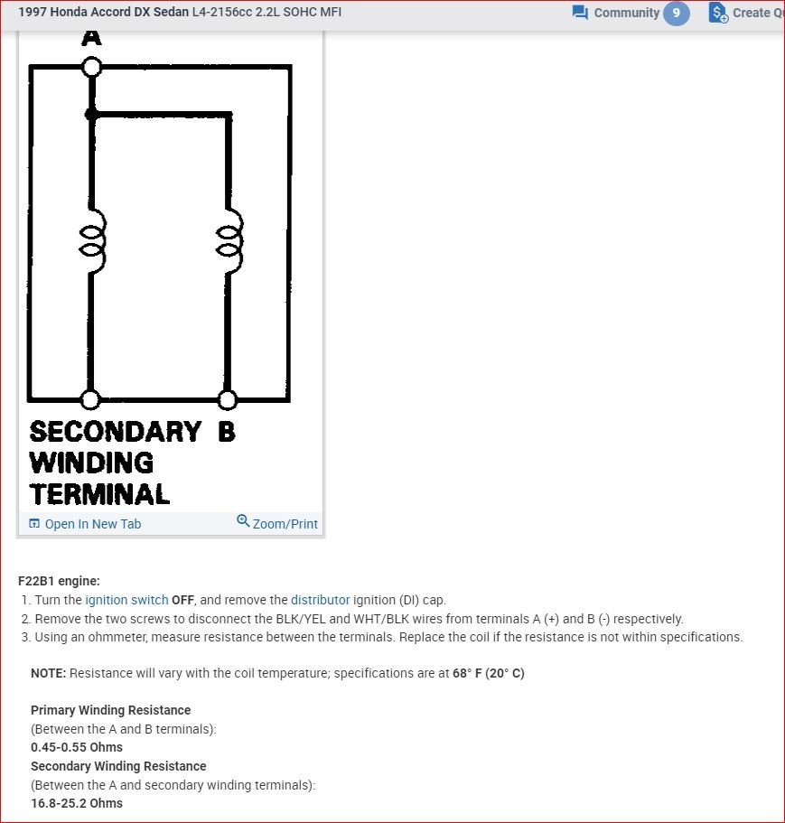

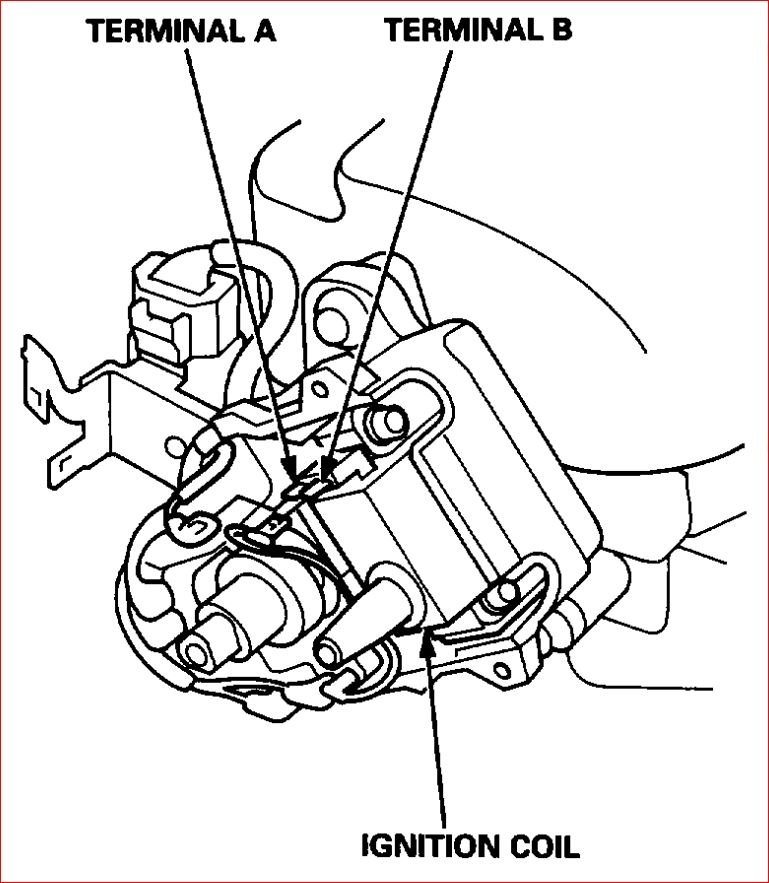

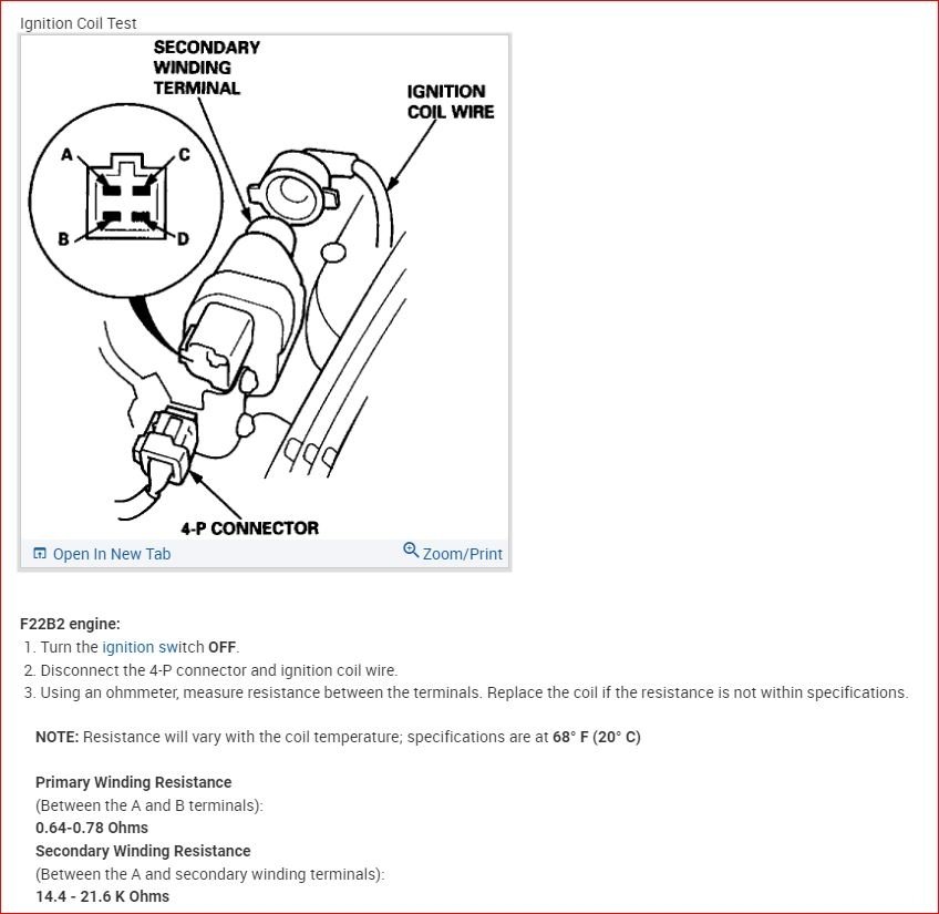

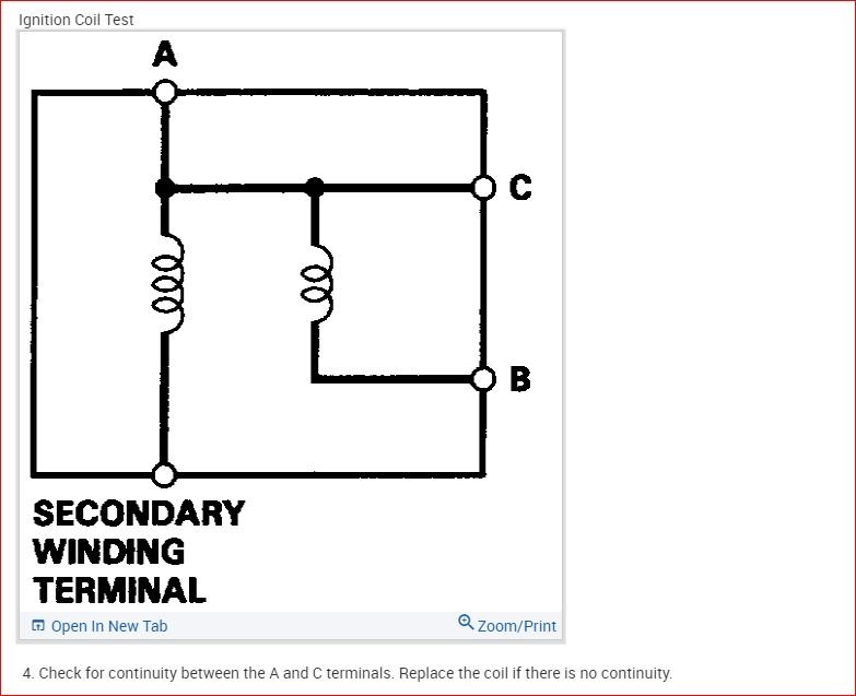

Hi Tyler,
Have you actually tested the coil? This is what is responsible for your spark strength. This is a spark amplifier so if you have a weak spark, it is the most likely cause.
I attached the procedure on how to test these. I have seen too many times when you get a coil out of the box and it fails almost immediately. You need to prove out the coil is ok even if it is new. Otherwise, we will be chasing out tails because we assume new parts are good parts.
https://youtu.be/1zQQy9noYQ0
Please let me know your resistance measurements and we can go from there. Thanks

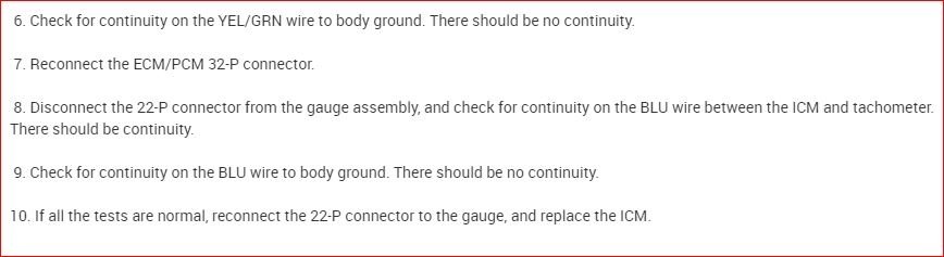

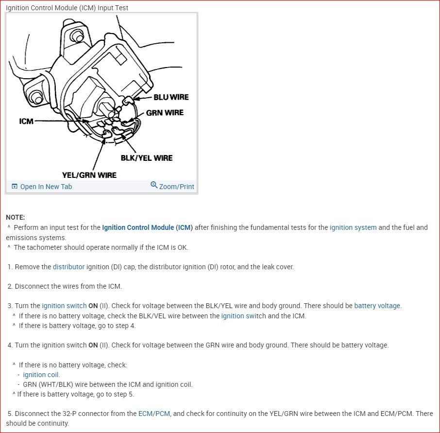

Okay. When you replaced the distributor was the ignition control module included?
Is there any chance that you have a lab scope? I know most people don't but I want to ask.
What I suspect is happening is the control module/igniter is the issue. This will actually mask the issue and make us blame the coil. The coil is responsible for building the primary spark and delivering the secondary but a faulty control module or igniter limits the amperage for the primary, then the coil delivers a weak spark.
Here is the test for the control module but I am hoping you have a scope so we can capture this. Thanks

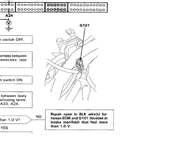

If any repair was carried out on the engine, then you need to check the ECM grounds at the thermostat housing.
Does the Check Engine Lamp shows for 2 seconds and goes of at initial ignition switch ON?
Is there battery voltage at the Black/Yellow wire of distributor with ignition switch ON and while cranking?
Are the dash lights showing while cranking?

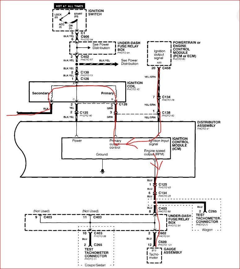

That is great. I would be shocked if the ICM is not your issue. The ICM controls the tachometer as well, which I am sure you knew, and is why you mentioned it.
Here is your power flow for this system. Also, it has its own ground, I know you said you checked grounds but just want to make sure this is one that you checked.
Check out that video and let me know what you find. Thanks
