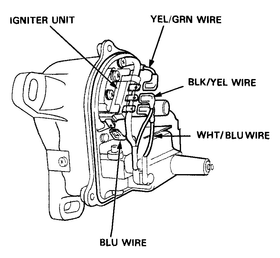

Now, what I think may be the problem is the igniter in the distributor. That will prevent spark if it fails. There is one blue wire that runs between the igniter and the tachometer, but I don't think that will cause it not to run.
Here is a test to run on the igniter to see if it is the problem. Do this and let me know the result. Picture 1 correlates with these directions.
________________________
1. Remove the distributor cap, the rotor and the leak cover.
2. Disconnect the black/yellow, white/blue, yellow/green and blue wires from the igniter unit.
3. Turn the ignition switch ON and check for battery voltage between the black/yellow wire and body ground. If there is no battery voltage, check the black/yellow wire between the ignition switch and the igniter unit. If there is battery voltage proceed to step 4.
4. Turn the ignition switch ON and check for battery voltage between the white/blue wire and body ground. If there is no battery voltage check the ignition coil for proper operation or for an open circuit on the white/blue wire between the ignition coil and the igniter unit. If there is battery voltage proceed to step 5.
5. Check the yellow/green wire between the PGM-FI ECU and the igniter unit.
6. Check the blue wire between the tachometer and the igniter unit.
7. If all tests are normal, replace the igniter unit.
______________________________________
While you have the distributor cap off, inspect the wiring inside for damage. It isn't uncommon for a wire to internally break and fail. You can't see the break because the insulation stays on the wire, so feel them with your hands for weak points that feel like they may be broken.

The car is a 1993 Honda accord with a f22a1, a automatic, 230k, I replaced the head and now I have no spark, I have replaced the coil, and the car ran before having to replace the head. Thank you for your hlep!

Honda very famous for a distributor problem
But you should check all electric connectors check fuses
On the coil check if u have battery + with key on
Let us know
