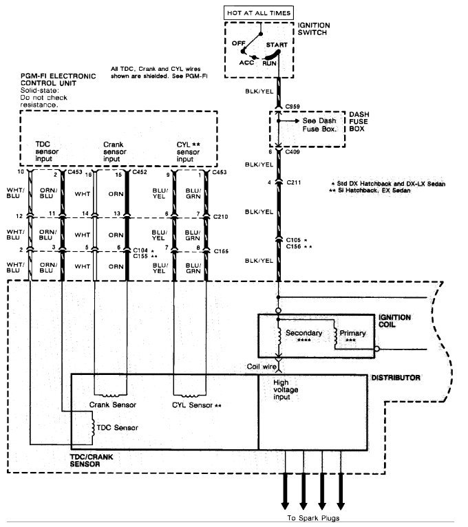

No spark at plugs or distributor?
Was anything done prior to this occurring?

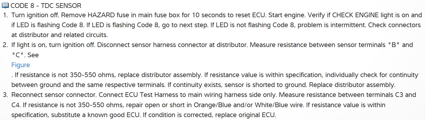

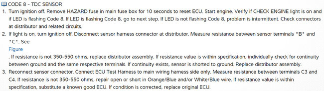

I haven't checked TDC sensor, where is it located? Today I checked the ELD, I read that if there's less than 4.5 volts that I have to check my ECU that it might be fualty... the computer still gives me 20 blinks, should i get another ECU? How can I test it?

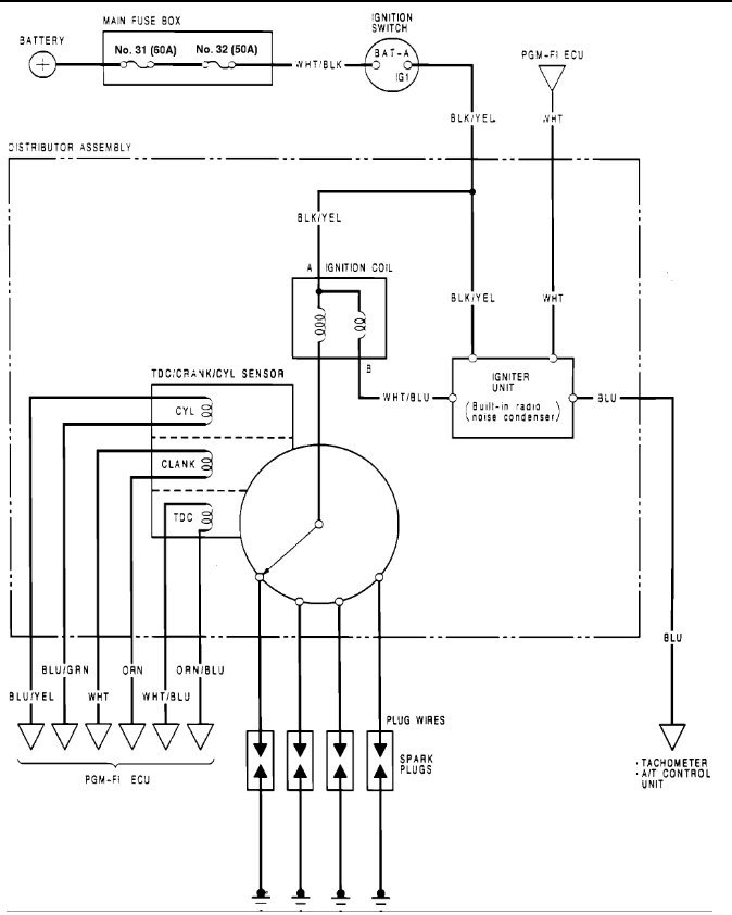

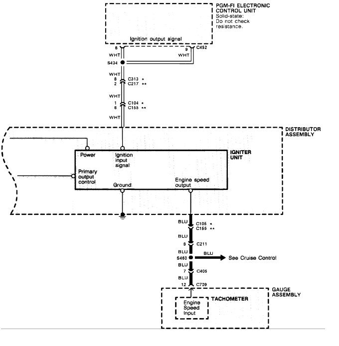

ok i read evey where and tryed everything this is my only hope :) car wont start brought it home keep playing with it and it started ran good 3 minutes and stoped wont start again no spark
replaced new ecu/new relay/new distruber/map has 4.9 volts distruber coil has 12 volts rotor turns no spark all so new wires and plugs just ordered new key swich all fuses are good ecu has no led both sides of case are solid opend ecu no led inside so dont no codes sure could use some help on what else to check

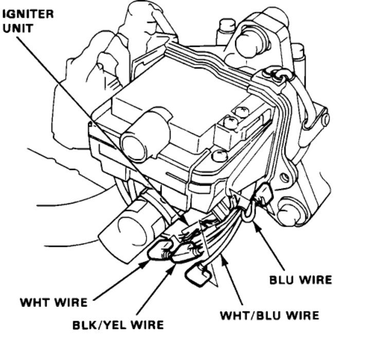

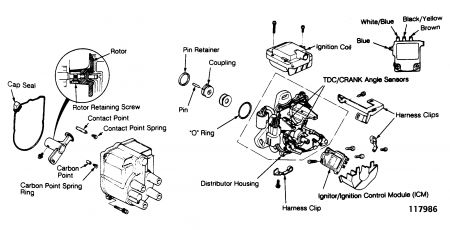

have you checked/replaced ignitor/ICM

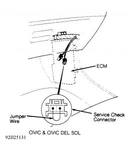

check for codes ..and let me know .. count flashes ...
RETRIEVING CODES
With ignition off, insert jumper wire in service check connector terminals, located behind right side of dash. See Fig. 1 . Turn ignition switch to ON position. Diagnostic Trouble Codes (DTCs) will be indicated by a series of long and short flashes on MIL. The number of long flashes indicates the number in the 10s column. The number of short flashes indicates the number in the 1s column. For example, 4 long flashes followed by 3 short flashes would indicate DTC 43.
