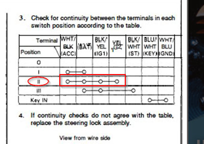

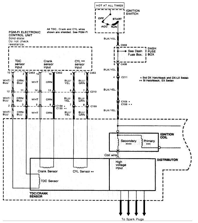

car shut off while in park. cranks fine but wont start. replaced entire distributor assembly, still no spark. pgm-fi tested fine. battery is good.
Dec 1, 2019 at 4:51 AM

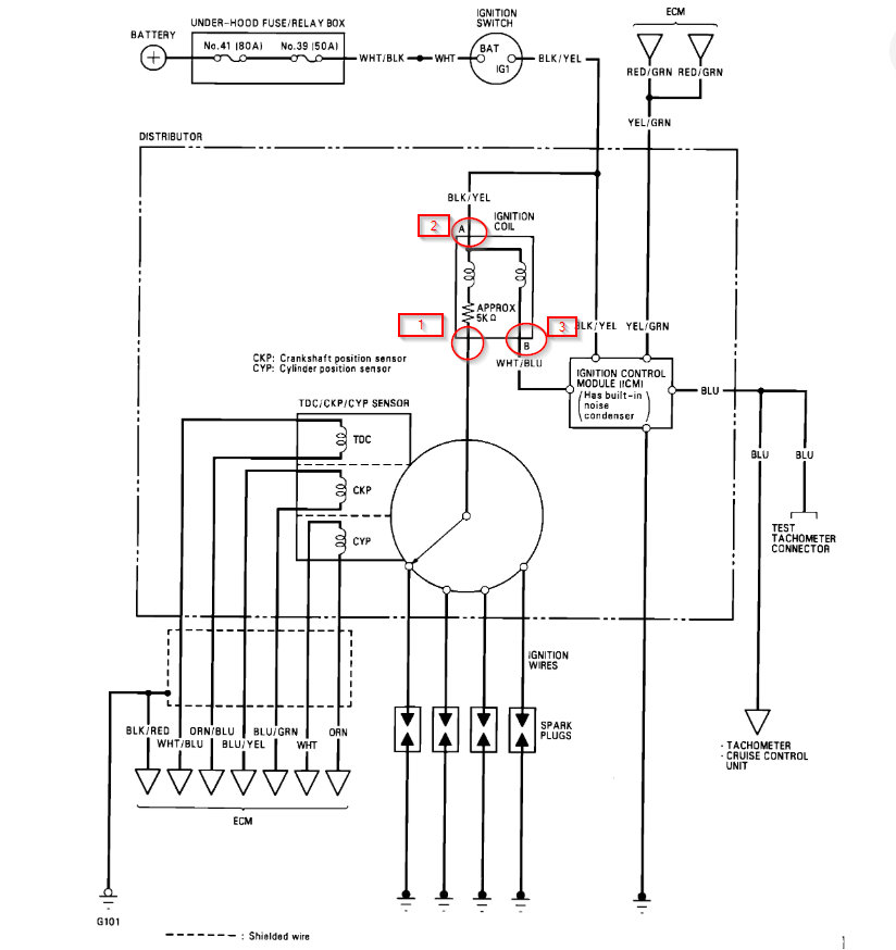

Okay. We need to check and see where we have voltage on the coil. I number the 3 wires that we need to check. This will help determine if the coil is the issue or if the ICM is the issue. Also, it could be a voltage issue to the coil but since the engine cranks I assume this is okay but we need to test just to be sure.
Let me know what you find and we can go from there.

I'm kinda skipping ahead a bit since I've tested from the plugs to the distributor prior to writing. and also entire distributor assembly (including ignition coil) was replaced when this issue occurred. from reading what you have said to others and what I've read online in pretty sure I've narrowed it down to the ignition switch. I'm currently trying to test it but cant figure out which connector is the 7-p in the diagram attached.
Dec 4, 2019 at 11:02 AM

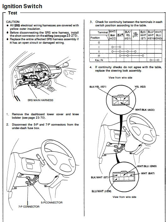

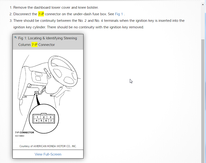

Unfortunately this is the only document I can find on it. However, of the connectors under the steering column it should be the only 7 pin connector so that is the give away that it is it. Also, look for it to have the layout pictured, 3 pins on the top, 4 pins on the bottom.

I found it and tested those, but I'm not sure what they should test at.
Dec 7, 2019 at 1:45 AM
BRIANMF
  • 7 POSTS
the first one tested at 11 ohms and the rest at 1.
Dec 7, 2019 at 1:48 AM
Okay. I am not sure I understand how you are testing this. Take a look at the diagrams. You should be testing each of the terminals in each different key position. Position 0 is no key in the ignition. Position I is in ACC, position II is "on", position III is start, key in is key just in the ignition.
Let me know if this is how you tested it. If it is, all they care about is continuity. If you have resistance (as you do) then it doesn't matter about the actual resistance reading.

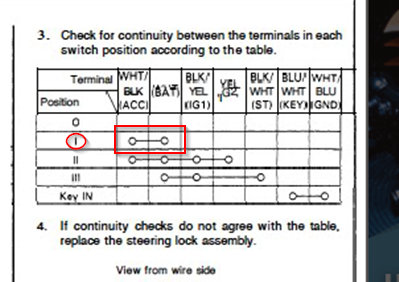

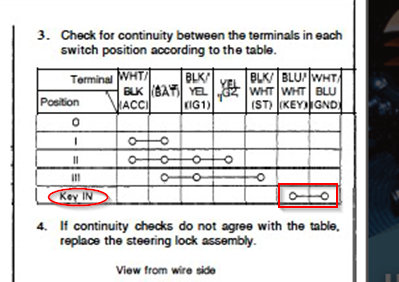

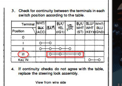

I retested it to make sure I has right readings in right positions and the test for position 1 (white/black acc. and white battery) had no continuity.
Dec 8, 2019 at 12:42 PM

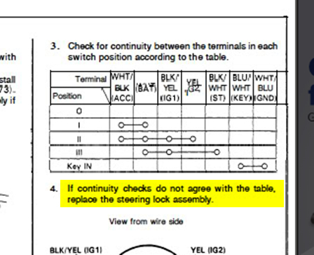

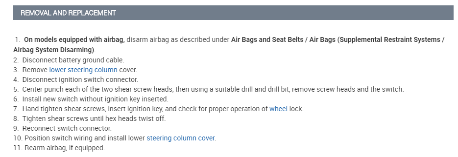

Okay. If this is the case, it looks like the steering lock assembly needs to be replaced. See the highlighted portion.
Dec 9, 2019 at 11:03 AM
BRIANMF
  • 7 POSTS

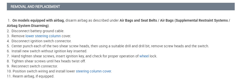

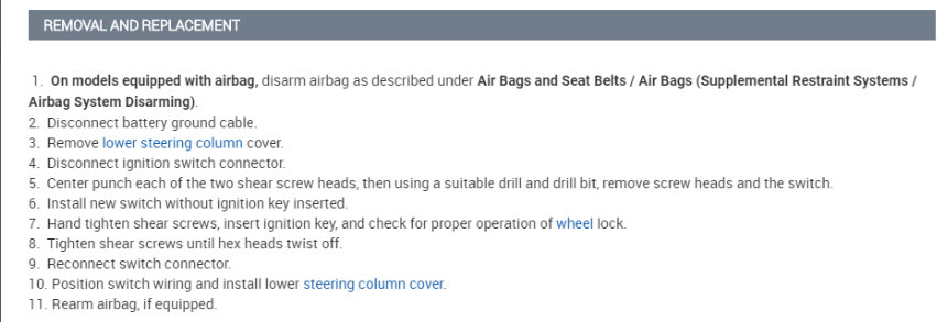

is there anything specific that needs to be done while doing that other than just replacing the part (programming, resetting anything, etc.)?
Dec 9, 2019 at 11:07 AM
I don't show any. The only thing it mentions is rearming the airbag but nothing as far as programming.

  • 55,721 POSTS

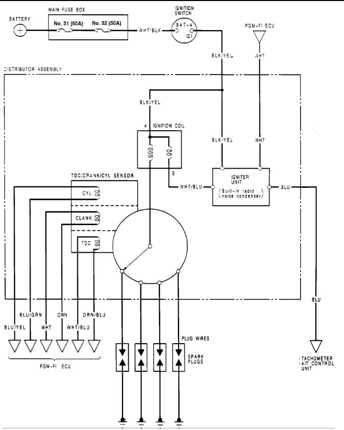

I found this wiring diagram so you can do some testing.
Blk/yel should have power with the ignition on, also disconnect the blue wire and try it in case the tach is shorted out causing the problem.
Let me know,
Best, Ken

I replaced the distributor with a new one. After more searching I've did some more testing. The igniter connectors blk and y have battery v the Blu and what has battery v . The green and y has cont. The blue wire does not is this a indicator of the direction I should take
Nov 2, 2020 at 6:01 AM (Merged)
  • 55,721 POSTS

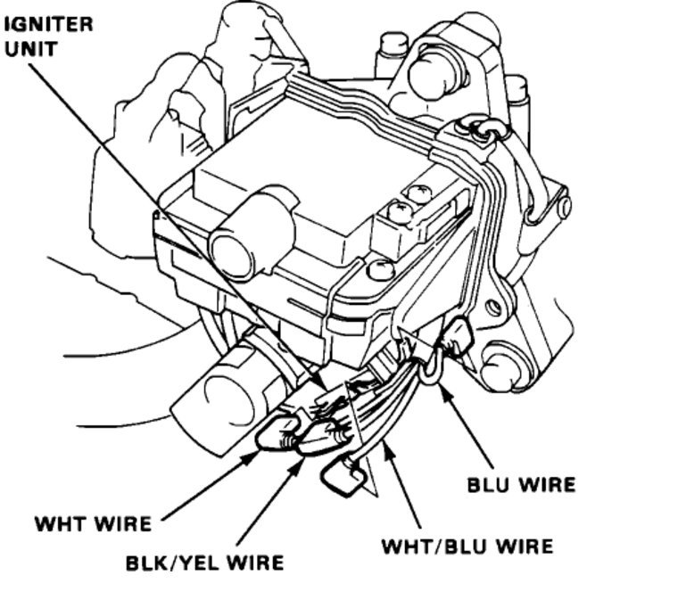

Here is a testing procedure for you.
Perform an input test for the igniter unit after finishing the fundamental tests for the ignition system and fuel emission system. Check for blown No.32 (50 A) fuse in the dash fuse box before testing.
Remove the distributor cap, the leak cover and the rotor.
Disconnect the WHT wire, BLK/YEL wire, WHT/BLU wire, and the BLU wire from the igniter unit.
Use a voltmeter to check for battery voltage between the BLK/YEL wire and the body ground with the ignition switch ON
a) If there is no voltage, check for an open in the BLK/YEL wire between the igniter unit and the ignition switch.
b) If there is battery voltage, go to step 4.
Use a voltmeter to check for battery voltage between the WHT/BLU wire and the body ground with the ignition switch ON.
a) If there is no voltage, check for:
-Faulty ignition coil.
An open in the WHT/BLU wire between the igniter unit and the ignition coil.
b) If there is battery voltage, go to step 5.
Check for continuity between the WHT wire and the body ground.
a) If there is no continuity, check for:
An open in the WHT wire between the igniter unit and the PGM-FI ECU. -Poor ground at thermostat housing (G101 or G151). Refer to Cooling System / Cooling Fan Motor / Diagrams . See: Engine, Cooling and Exhaust\Cooling System\Radiator Cooling Fan Motor\Diagrams\Electrical
b) If there is continuity, go to step 6.
Check for continuity between the BLU wire and the body ground.
An open in the BLU wire between the igniter unit and the tachometer or the A/T control unit. -Poor ground at thermostat housing (G151), left front fender well next to washer bottle (G301) or left kick-panel (G401). Refer to Cooling System / Cooling Fan Motor / Diagrams . See: Engine, Cooling and Exhaust\Cooling System\Radiator Cooling Fan Motor\Diagrams\Electrical
b) If there is continuity, go to step 7.
If all continuity and voltage tests are normal, but the engine won't start, replace the igniter unit.
NOTE : The igniter unit may be covered under the manufacturer's emission warranty. Contact the appropriate agency before replacing.
Please run some tests and get back to us so we can continue helping you.
Best, Ken

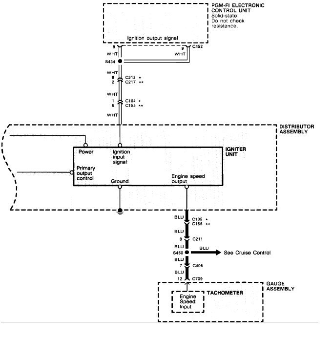

We are missing something, here is a wiring diagram so you can do some testing, if all checks out the distributor is bad and you need another one to get the problem fixed.
Best, Ken

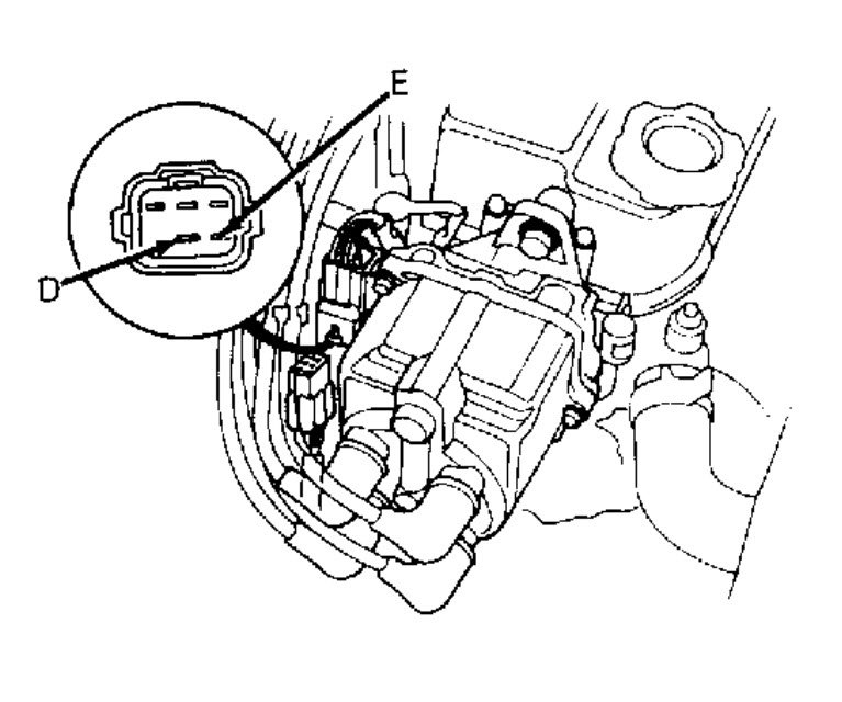

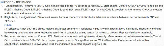

Well I am. Still dealing with the same car that I have spent last month trying to get back on the road
I have replaced the distributor again ( at $222.00 a shot ) only to get the PCM to kick back a 8 code.. I do not know if you have time to go back in the time that we spent in this problem so just let me touch on the shot that Honda must of invented just to up set me. I have a crank no spark problem for my f2f 1.5 automatic transmission no tachometer (I mention tachometer because the blue wire in distributor is still a open ) I have replaced main relay, distributor. And a new ing switch and still no spark. So thinking that I problem got took on the distributor. I took money that I really could not find a real reason to spend and went to the parts house with my weeks pay and bought another distributor (I know, but got so much in this repair what the heck). so I install the new part and checked the timing belt to just be sure that it was not the problem all good. I tried to start the money grabbing beast and all I got out of it was a response of the PCM eight flashes of red eight times. Can you please help me out after spending all that money my wife says I cannot come home, ha ha.
HMAC300
  • 48,601 POSTS
code 8 s TDC so pull hazard fuse in main fuse-box for ten seconds then reinstall see if it starts. if not then it is a distributor or wiring issue instructions in picture. if it is a CRX or CRXF it may be different this is for a base Honda Civic.
